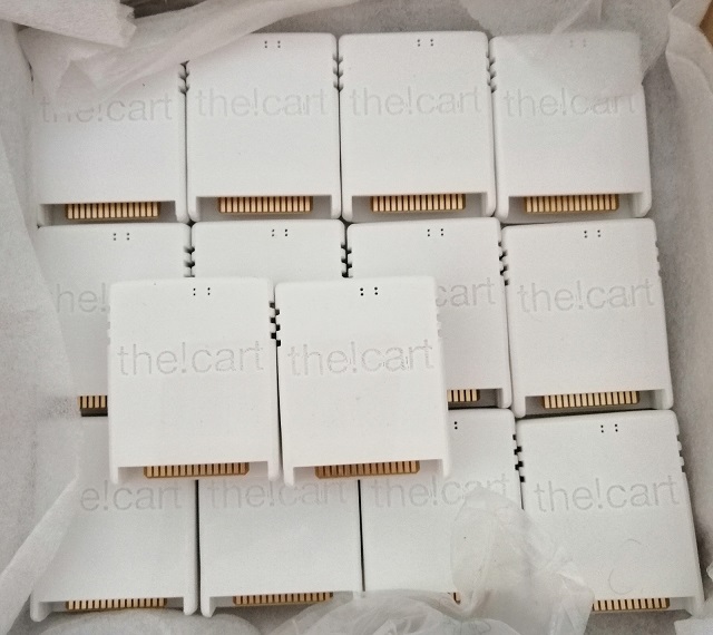

Minor Update: The!Cart Studio now has is own proper 48x48 application icon. Thanks to Mr. Fish for pushing the pixels in the right position.
It should work on Windows, Mac OS and in the Java version.
Also the next batch iof The!Cart s one it's way to Europe.
