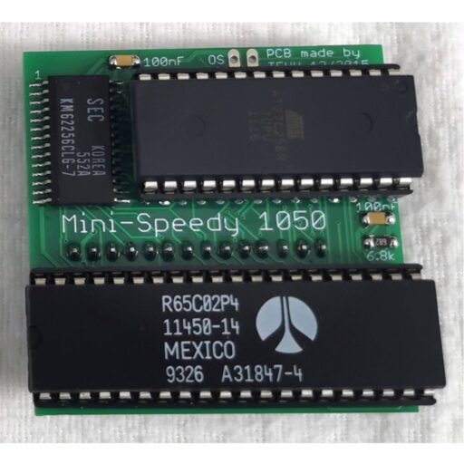

falls es auch die Mini Speedy sein kann, die gibts im ABBUC Shop.....

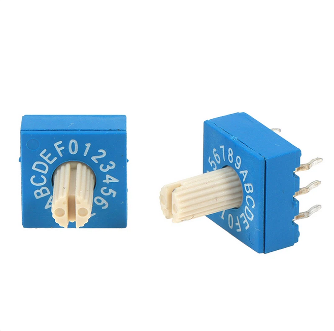

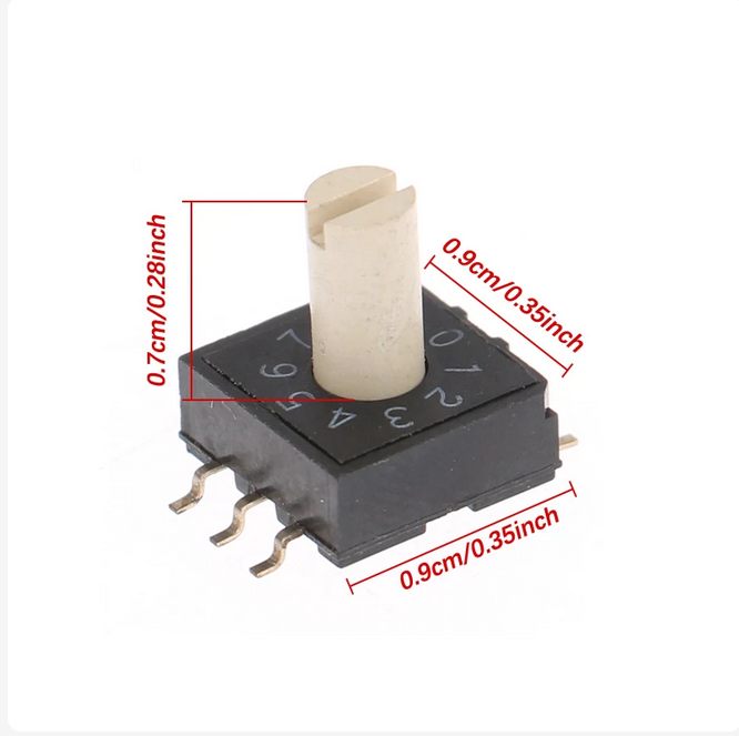

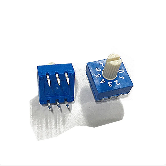

Has existing one from Knitter additional switch on knob?
I found a few smaller 0.9cm x 0.9cm encoders:

Switch:
I guess you cannot use a coded switch, you need a up and down counter as far as I know.
Plus it cannot be just turned left and right but also be pushed to activate the setting.
I guess this thing can be ommited but you will require the reset button at least so you can reset the MegaSpeedy to Flasher upon start and then select the firmware via its menu.

Hi Erhard,
You have totally right. I didn't realize that shown encoders is hard coded and chosen value is represent by DEC/HEX state on PINs.. We need to have steps information with C.W nad C.C.W direction...
I ordered a few encoders to check which will be best for project... At this moment I decided to use the standardized one. Additional thing I added is write protect button with LED indicator. PCB is little bit longer but I plan to print front cover (as replacement part for original one). If anybody has a notice or advice, please let me know :-)
