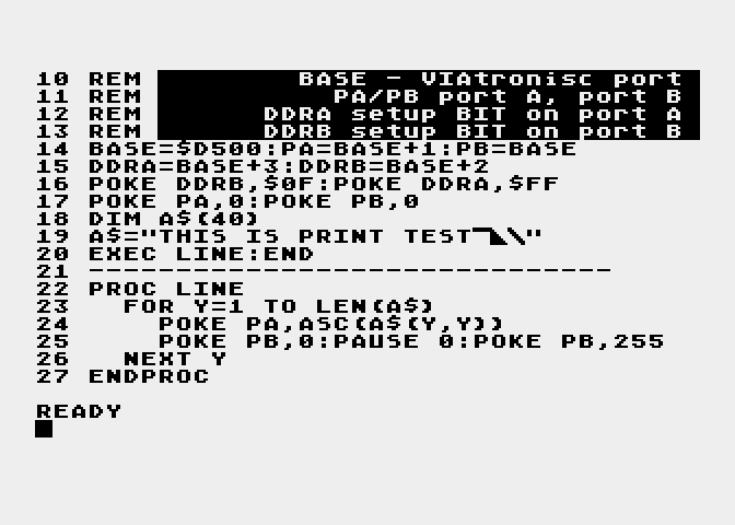

At this moment I use very simple program written in Turbo Basic XL which can send text/graphics to printer from memory. This is nothing spectacularly and anybody might write “driver” for any printer if you have instruction with steering codes. I checked EPSON standard on Star LC-20 whichwas very popular in ‘80-’90 last century...

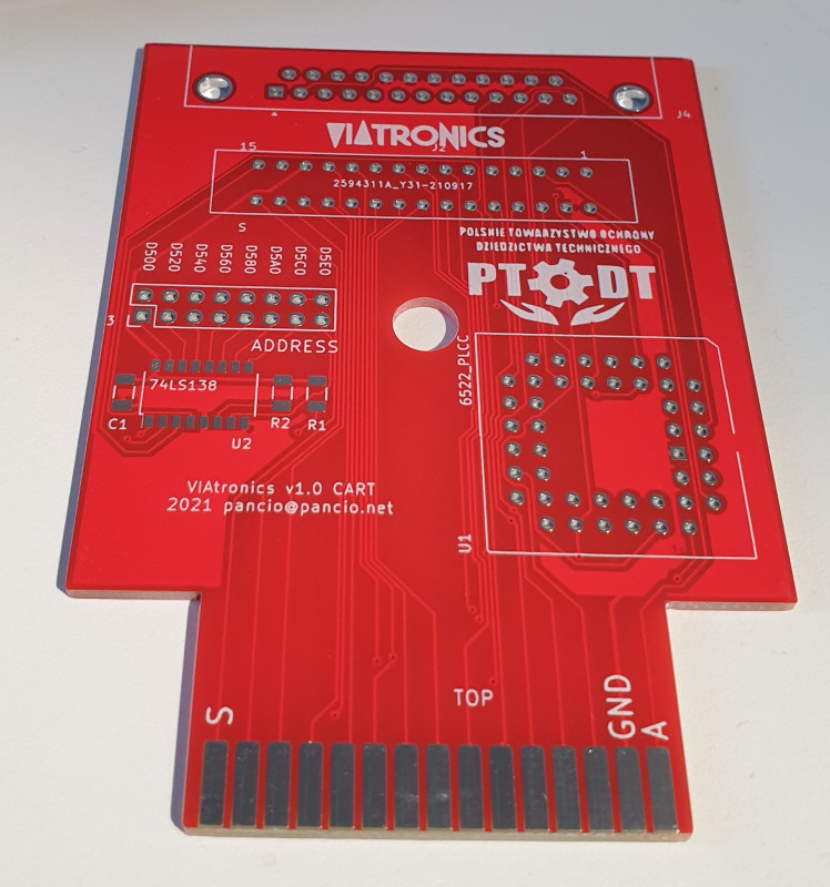

Re: VIAtronics v.1.0
Verfasst: 05.10.2021 10:29
von pancio
Hi Guys,
Today I received PCBs for CART version of VIAtronics:
VIAtari CART version PCB
I'll try to assembly it immediately and confirm work as ECI version soon :-) (I hope).

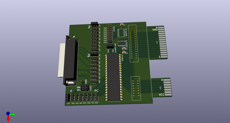

According to someone needs, full pass thru version VIAtronics with vertical PCB was designed. I'm waiting for prototype to confirm it's working too as whole family.
It should be ready to test at the end of November.
