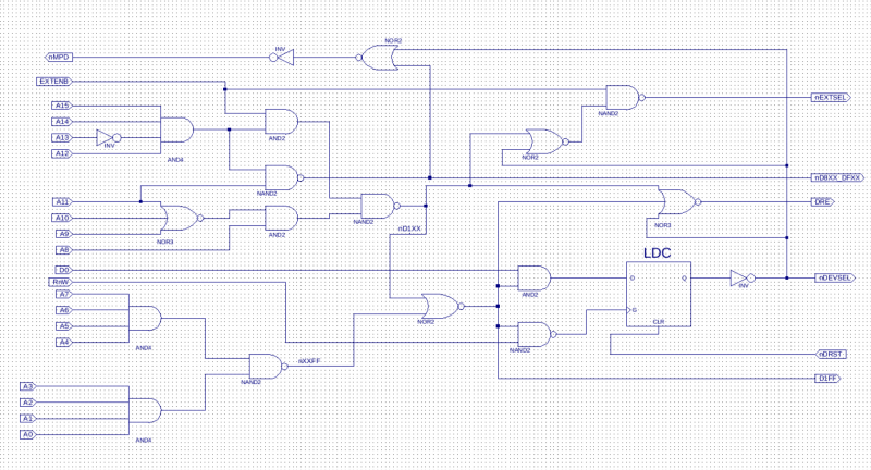

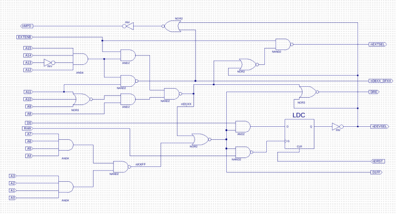

Okay... I read provided by Hias materials and I stared modeling my own ND... Actually shown in Antic's articles project is little bit similar to MIDIcar (according to functionality). At first I'll try to build logic for ND based on XC9572XL Xilinx FPGA:
ND_LOGIC
ND_LOGIC
It's my first time to use XILINX ISE software so I hope not so many issues will appeared :-)

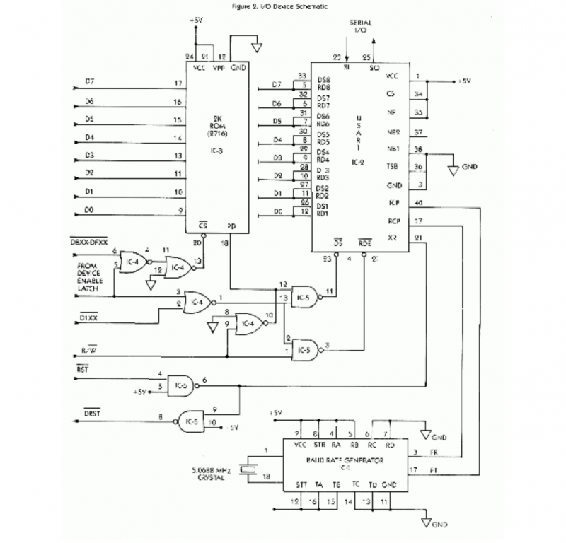

Next step is design schematic in KiCAD with MIDIcar based on:
ND_ROM
ND_ROM
First question...
On schematic above we have input signals:
  • /D8XX-DFXX - should be connected to nD8XX_DFXX
  • FROM DEVICE ENABLE LATCH - should be connected to nDEVSEL
  • /D1XX - should be connected to nD1XX but this signal isn't generated by logic section! Shall I add additional output from FPGA (the /D1XX is available inside logic) or it's typo?
rest signals are clear and easy to connect :-)

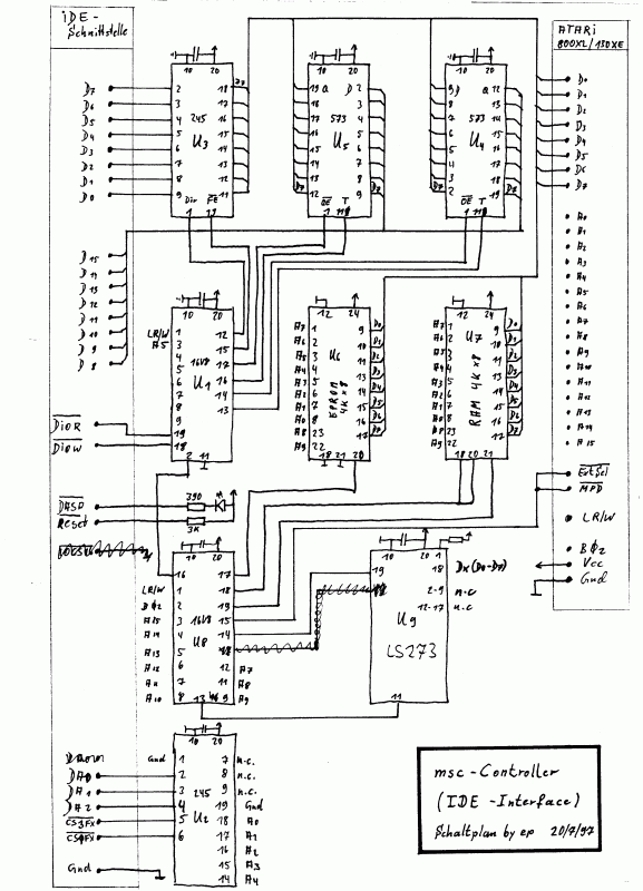

your schematics look more complicated than I remember from the mscIDE controller, but that is maybe due to each gate been drawn indiviudally.
Below please find some -kind of- schematics I once drew from the mscIDE. You can compare it to what your circuit does.
msc IDE schematics (unverified)
Please note that the PBI device ID may be selected by a jumper field that connects one data line of [D0...D7] to U9-Pin18
Best, Erhard
Re: XL/XE bus extenders
Verfasst: 28.10.2022 19:36
von pancio
Hi Erhard,
Shown by me logic for NDPBI is mirrored from the original Antic's article. I implemented it into FPGA because too many discrete gates in original. Presented by you schematic looks much more simple and looks easier to understand. Can I adopt it to my project as a base for PBI ND? I see two PAL/GAL 16V8 ICSs.. could you please show rules or logic inside?
Regards,
pancio
XL/XE bus extenders
Verfasst: 30.10.2022 08:49
von Erhard
I guess those are the original files ...
mscgal.zip
mscIDE GALs
(1.49 KiB) 394-mal heruntergeladen
Kind regards,
