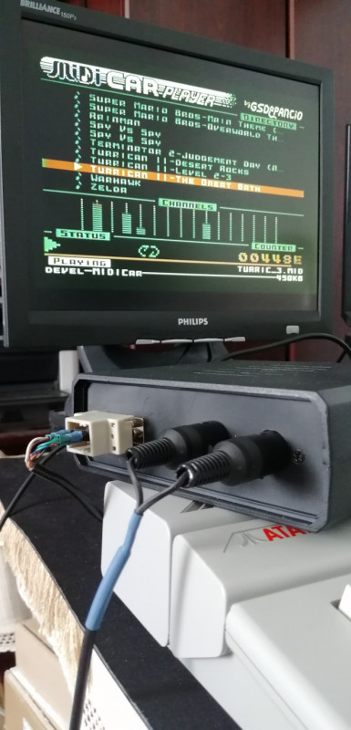

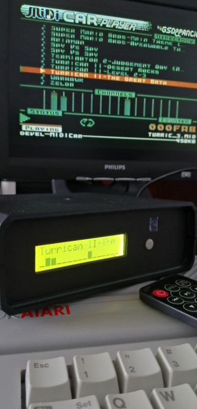

Some images of the final version:
Gadget listens :)
Gadget listens :)
From left: SIO in DB 9 :(, MIDI-In and MIDI-Out jacks.

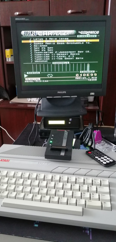

Portrait of the set :)

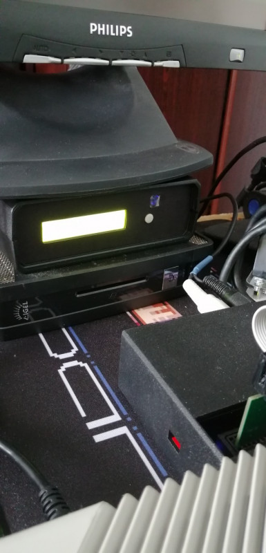

Probably the best place for the gadget ;)

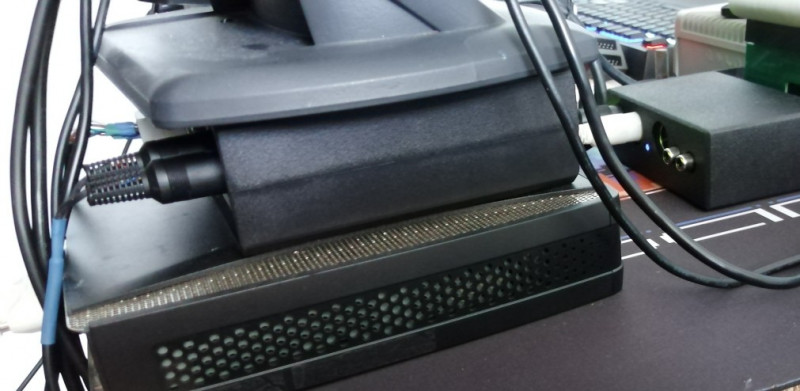

A side view on MIDICar Remote and MIDICar :)

Sikor is selling injection molded SIO connectors. BTW two connectors would be even better. :mrgreen:
I thought about it. I used a small splitter from Mq and with an enclosure (I think) from KKrys. I made a crazy construction on which the whole thing somehow holds together :P
There is a bit of slack, but the SIO plug goes in :)
Now I can polish the whole prototype of the SIO sockets in MIDI Remote.
It will look very respectable :D

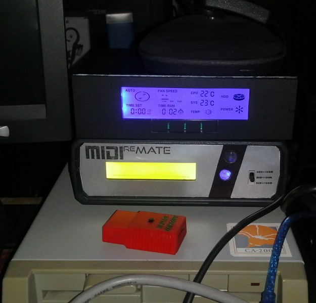

The selection of the interface was supposed to be done electronically, but I did not manage to grasp with the available resources such a solution. A slightly clunkier, but having something of the era, version on a three-position switch. It allows you to choose how to connect the available sockets to each other, and they are as follows:
  • DIN* <> USB
  • SIO* <> DIN
  • SIO* <> USB
The Remote option is only available for the connector with an asterisk. In addition, modes with USB retransmit data from the source at 115200 bits/second. In SIO<>DIN mode, the speed for both connectors is the same and is 31250. I don't know if other speed settings are needed - you can always add such an option if you need it :P The change of interface is signaled by an appropriate message and a quick dimming of the function button.
In addition, this button (its backlight), indicates whether the MIDI Remote is processing any data, such as remote control or data transmission. This is announced by a slow flashing of the backlight.
