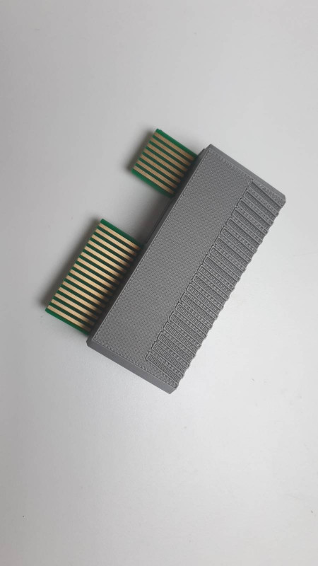

von pancio
Theoretically, using /EXTSEL signal you may switch off internal memory and with external address decoder connect external ram to the CPU bus. You don't need /RAS, /CAS if you will use static ram. Practically, I have one EXTRAM module using CART/ECI build by Zaxon. Works well with my Atari 65XE.
CART/ECI SRAM 512 extension

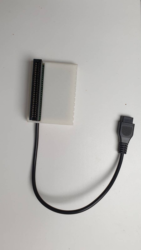

Sure, similar RAMEXT was made for A800XL... by Zaxon :-)
RAMEXT for Atari 800XL
