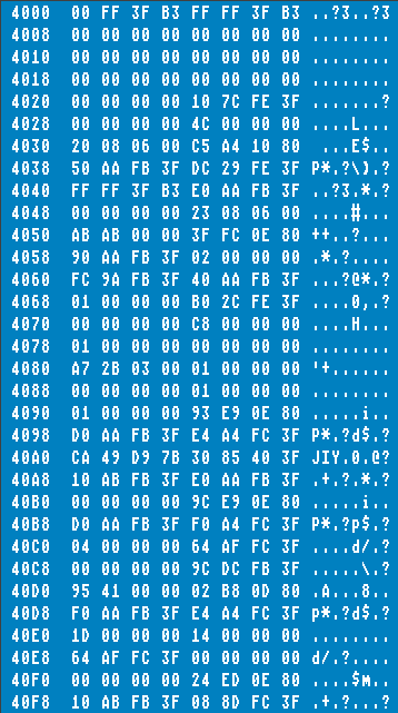

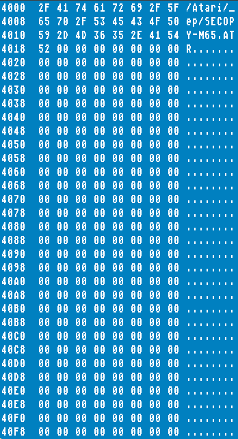

I did some minor first few tests and would like to let you know about things.
Command $DA is named "Get Device Slot Filename" which is not correct as the command returns the filename along with the path (without device).
result of command $da

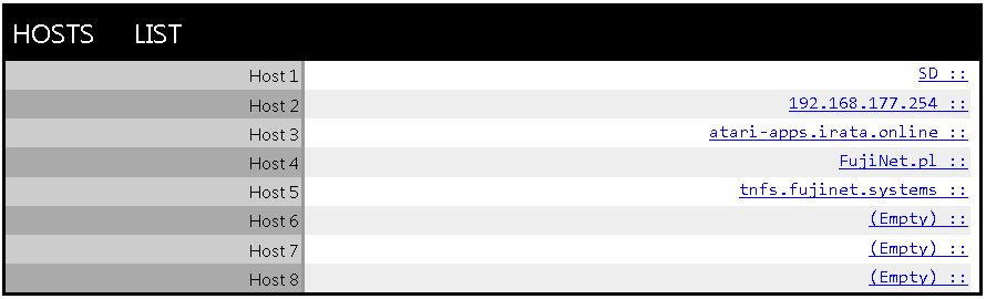

Command $E0 does not work for me as it seems to return garbage. If I understand the description correctly I would expect a certain device slot's contents. Maybe I got wrong what should be returned. In that case please explain the command and data meaning.
host list from web ui
result of command $e0
Command $FE does not return 33 bytes for the SSID but 32, so we get 96 bytes, the 97th being the checksum.
Re: FujiNet Atari Tools
Verfasst: 16.08.2022 22:17
von tschak909
Here is the corresponding code on the ESP32 (firmware) side:
https://github.com/FujiNetWIFI/fujinet- ... .cpp#L1174
```c
// Retrieve host path prefix
void sioFuji::sio_get_host_prefix()
uint8_t hostSlot = cmdFrame.aux1;
Debug_printf("Fuji cmd: GET HOST PREFIX %uh\n", hostSlot);
if (!_validate_host_slot(hostSlot))
sio_error();
return;
char prefix[MAX_HOST_PREFIX_LEN];
_fnHosts[hostSlot].get_prefix(prefix, sizeof(prefix));
bus_to_computer((uint8_t *)prefix, sizeof(prefix), false);
and if we dig into the fnHosts object:
https://github.com/FujiNetWIFI/fujinet- ... t.cpp#L254
/* Returns pointer to current hostname and, if provided, fills buffer with that string
const char *fujiHost::get_prefix(char *buffer, size_t buffersize)
if (buffer != NULL)
strlcpy(buffer, _prefix, buffersize);
return _prefix;
const char *fujiHost::get_prefix()
return get_prefix(NULL, 0);
The _prefix variable here is defined in fujiHost.h as a 256 byte char buffer. set to null initially:
https://github.com/FujiNetWIFI/fujinet- ... Host.h#L23
char _prefix[MAX_HOST_PREFIX_LEN] = { '\0' };
so from the code here, we should indeed be returning the prefix.
(for those wondering what I am doing here. I am trying to show the relationship between the Atari side of things, and the firmware code, so that people can become engaged and start hacking on both sides of it.)
-Thom
