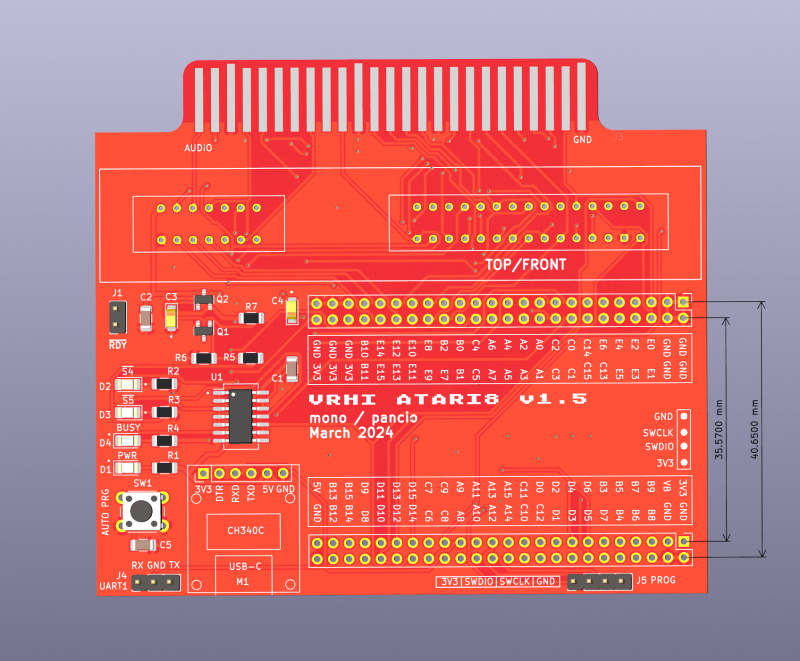

So wie versprochen, hier ein paar Details zur Einreichung von Pancio für den AHC 2024:
Pancio schreibt:
I would like to present my new VRHI device, which is used for programming, reading and cooperation with any Atari XL/XE devices. The main reason why I decided to build it was the need to quickly write to any cartridge, because writing to an Atari takes a very long time... The presented device can do this in a dozen or so seconds (depending on the capacity). Additionally, we can connect any device compatible with Atari to the interface and, if the method of communication is known, we can also control it. We connect VHRI to a PC using a USB cable and, if we need to use a debugger, a serial cable (or another USB). The first tests showed that transmission speeds of 2mbit are possible (reading a 512KB cartridge takes about ~3s), but work is underway to use USB as a faster interface.
My colleague @mono (Jerzy Kut) is involved to the creation of VRHI in its current form and he is the author of most of the communication software as well as the PC library. I designed, built and tested the system at a basic level. Currently, work is underway on the second prototype and speeding up the information exchange process between PC and VRHI.
A few technically details:
- the project was created as a development of the ATARino idea and initially used its PCB (see photo of the prototype),
- the main element of VRHI is a module with a 32-bit RISC-V microcontroller 144MHz with 64KB RAM and 256KB FLASH,
- additional elements include 16Mb of FLASH memory for cartridge data,
- EEPROM memory for configuration data,
- SD card slot (for cartridge images),
- ETHERNET 10Mb connector
- 2xUSB HOST/DEVICE
Not all features are currently supported, but a few are planned...
There is one more cool thing if I use AtarINO... we can use VRHI as a sniffer, PC-controlled freezer or accelerator directly on Atari :-)
I will provide more details soon!
Best Regards,
pancio

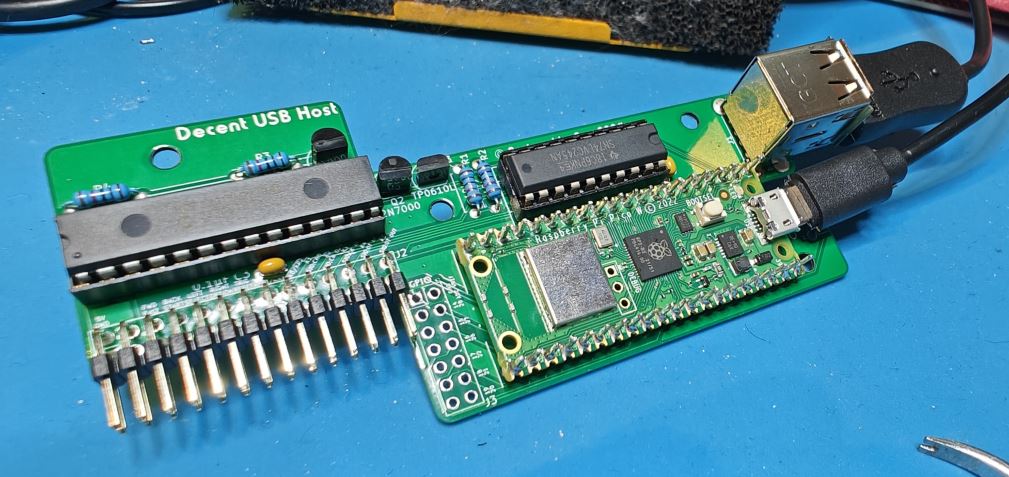

Ich freue mich, hier die zweite Einreichung für den Hardwarewettbewerb 2024 anzukündigen 8-) :) !
Unser - auch nicht ganz unbekannter ;) - Bertrand (aka ScreamingAtTheRadio) hat am 30.07.2024 sein
neuestes Projekt "DecentUSB Host - a USB / Bluetooth / Wifi host for Atari 8-bit computers"
als work in Progress für den ABBUC Hardwarewettbewerb 2024 eingereicht!
Hier schon mal ein Auszug aus seiner Beschreibung (etwas gekürzt):
Disclaimer
This is very much a prototype. Both the hardware and the software are work in progress but the proof of
concept is here.
Summary
The DecentUSB Host aims at being a low-cost extension for Atari 8-bit computers that brings USB, Bluetooh
and Wifi capabilities to the platform. It's open source both in hardware and software to allow the community
to easily build new features.
The device is a multi-function interface to keyboards, gamepads or memory devices in a single board that
costs less than $15 to build.
The Raspberry Pi Pico has been a fantastic booster for retro-computer extensions. Its fast PIO state machines
and its extremely low price enable applications involving precise timing of signals with a much lower barrier to
entry than FPGAs.
Specifically, the Pico-W can act as a USB host, a Bluetooth host, and a WiFi card. By connecting it internally to
the relevant Atari 8-bit buses and signals, we can interface modern devices with our favorite retro platform.
Applications
Once drivers have been built, we should be able to support the following scenarios (non exhaustive list):
- USB and Bluetooth keyboards
- USB and Bluetooth gamepads
- USB and Bluetooth mouses
- USB stick drives and SD cards
Internet access (potentially in a FujiNet-compatible way)
Atari to PC communication (potentially in a SIO2PC-compatible way)
Internal interfaces
The DecentUSB Host board exposes pins that connect to the following signals inside the Atari:
GND and 5V power the Pi and its helper chips
Pokey K0-6, KR1 and KR2: enables the device to simulate a keyboard
Start, select, option, reset: enables console key control, for example through an external keyboard
SIO clock in/out, data in/out and command: enables SIO device simulation
Joystick port 1 up, down, left, right and fire as well as A_POT: enables joystick simulation
Potentially other signals using the remaining free GPIOs on the Pi
External interfaces
USB-A: enables the connection of keyboards, gamepads, memory cards, etc.
WiFi: enables connecting the Atari to a WiFi network
Bluetooth: enables the connection of wireless keyboards, gamepads, etc.
Extra GPIOs: can be used to connect a small screen and buttons to control the device (for example to
select a disk image on a USB stick)

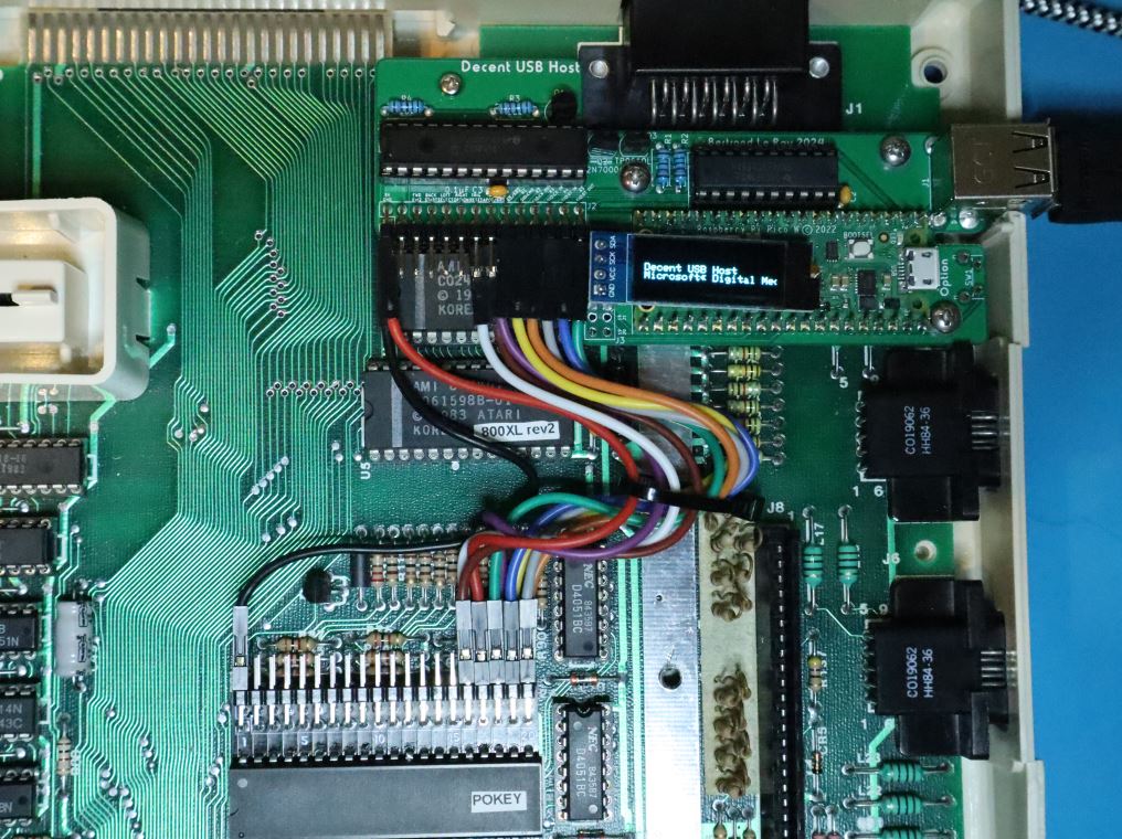

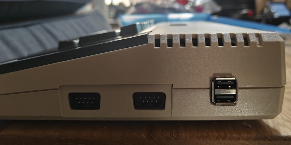

Physically, the board is designed to fit in an Atari 800XL between the ROMs and the SIO port. Optionally, the
case can be modified on the right side behind the joystick ports to let a USB port through. If the user doesn't
want to use USB but only Bluetooth and Wifi, the board can operate without case mods.
In a XE computer, the board can be fitted closer to the keyboard connector. The optional USB port can be
exposed to the outside through a case mod that lets the new port through the right side of the case in front
of the joystick ports
In other machines such as the 600XL or XEGS, the back of the case can let the USB port through. If necessary,
there could be optimized versions for each model or form factor

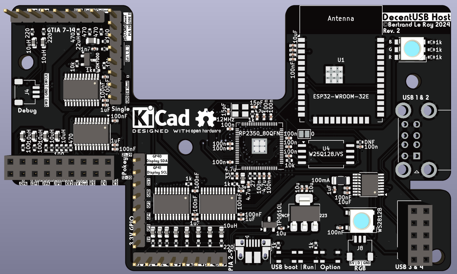

Future developments
Hardware
The prototype relies on the Pi to host a USB port on GPIOs using the USB host library. One of the
disadvantages of this approach is that we're using the Pi's computing resources to wait for USB data. The USB
host library supports only one USB port and can only work in a blocking or polling way, meaning that it's very
difficult to handle other tasks while waiting for USB data without missing any of it.
For those reasons, the next version of the hardware will include a specialized USB hosting chip such as the
Microchip PIC16(L)F145X and a 2-port USB hub chip such as the Microchip USB2422 2-port USB hub
controller to have two active USB ports without having to connect a hub.
The prototype was all through hole components, which is great for experimentation. The production version
of the board will use SMD components, which are easier to source and will allow for an even more compact
design.
I might also add enough GPIO extenders to plug into the PBI
Software
The software for the board is currently highly experimental and only establishes a proof of concept. It can
detect USB devices being added and removed. It recognizes any USB keyboard and can read its inputs. It can
map USB keystrokes to Pokey signals. It can scan the Pokey keyboard pins and simulate keystrokes (albeit
imperfectly at this time because it does so in Python).
Over the next few months, the code will be extended and rewritten to use PIO state machines, which are much

Ein paar Bilder vom Prototyp:
DecentUSB 01.JPG (186.54 KiB) 26712 mal betrachtet
DecentUSB 02.JPG (101.17 KiB) 26712 mal betrachtet
DecentUSB 03.JPG (49.09 KiB) 26712 mal betrachtet
Und noch ein Youtube-Video dazu: DecentUSB Host - a USB / Bluetooth / Wifi host for Atari 8-bit computers

I wanted to give an update on my project... I've entirely redesigned the board for rev.2:
RS2350 chip instead of Pi Pico (not yet widely available, expected by the end of the year)
ESP32 for WiFi + Bluetooth
4-ports USB hub chip on-board
One dual-USB port can be mounted directly on the board, is positioned to stick out flush in a 800XL case.
Two additional ports use the standard PC connector for panel-mounted USB ports
Support for the 2 joystick ports (including paddles), keyboard, console keys, and SIO port
Level shifting on all lines
1 Neopixel built-in + port to add an arbitrary number of additional pixels
RGB activity LED for the ESP32
Atari connectors optimized for the ASIC chips pin layouts: ribbon cables will be much easier to route
Protection added to Atari pins as necessary (reproducing the Atari schematics) so direct connection to chips is possible instead of soldering to vias or connectors
Expansion port for the leftover GPIOs and an optional OLED display
Programming through micro-USB port to upload new firmware
Debug port
Buttons on the board for flashing new firmware, option and run
Power supply decoupled and protected so power can be supplied by the programming USB port or from the Atari motherboard and everything can be kept connected simultaneously
Components selected for availability and low-price from JLCPCB
All pins labeled clearly on the board
I can't get this fabricated just yet because RP2350 chips are not yet widely available, but I will as soon as I can.
I'm in the process of rewriting and expanding the firmware in C and PIO assembly, taking maximum advantage of the two cores and state machines in the RP2350.
