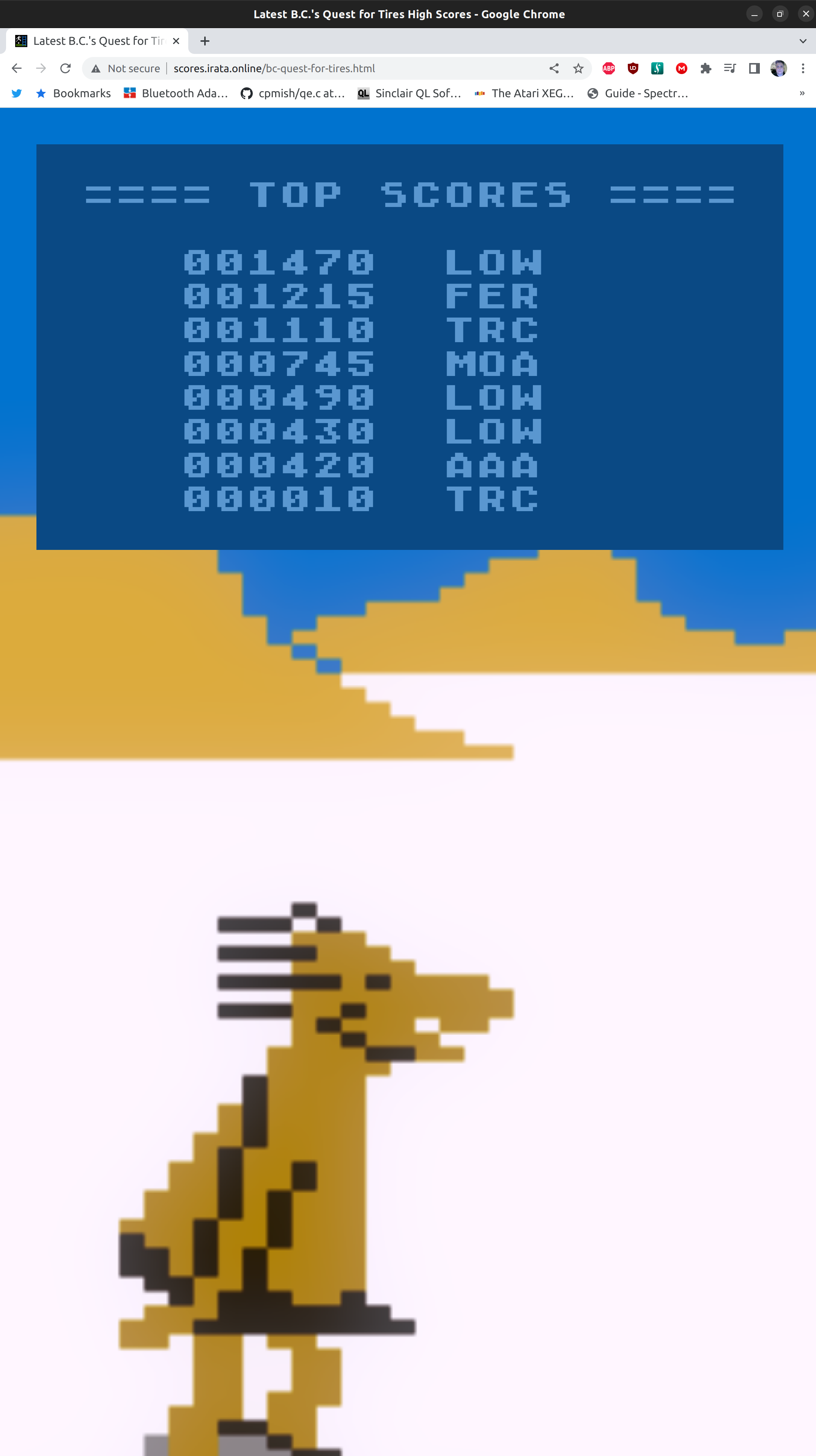

The current crop of high-score enabled games on apps.irata.online:
-Thom

ok, actually applied a consistent design style to each of the high score pages, based on screenshots from each game, what do you all think?
Since portrait displays have dead space for pages like this, the game backgrounds are placed to better utilize it.
