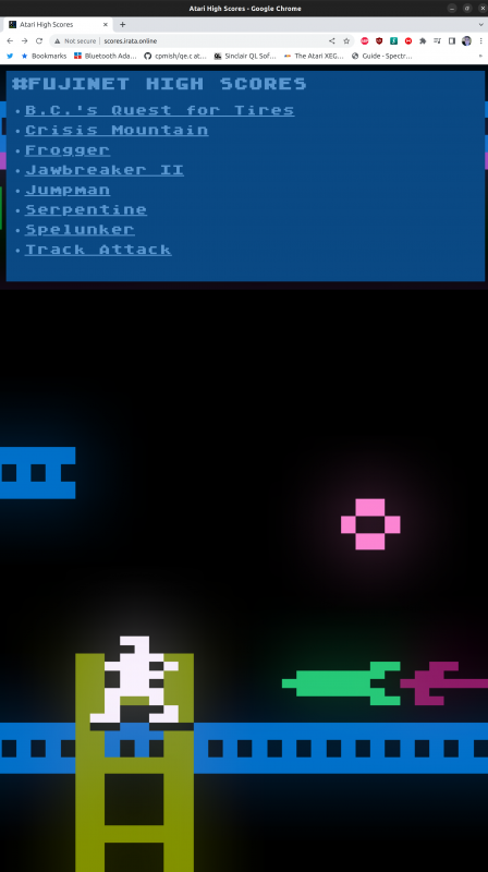

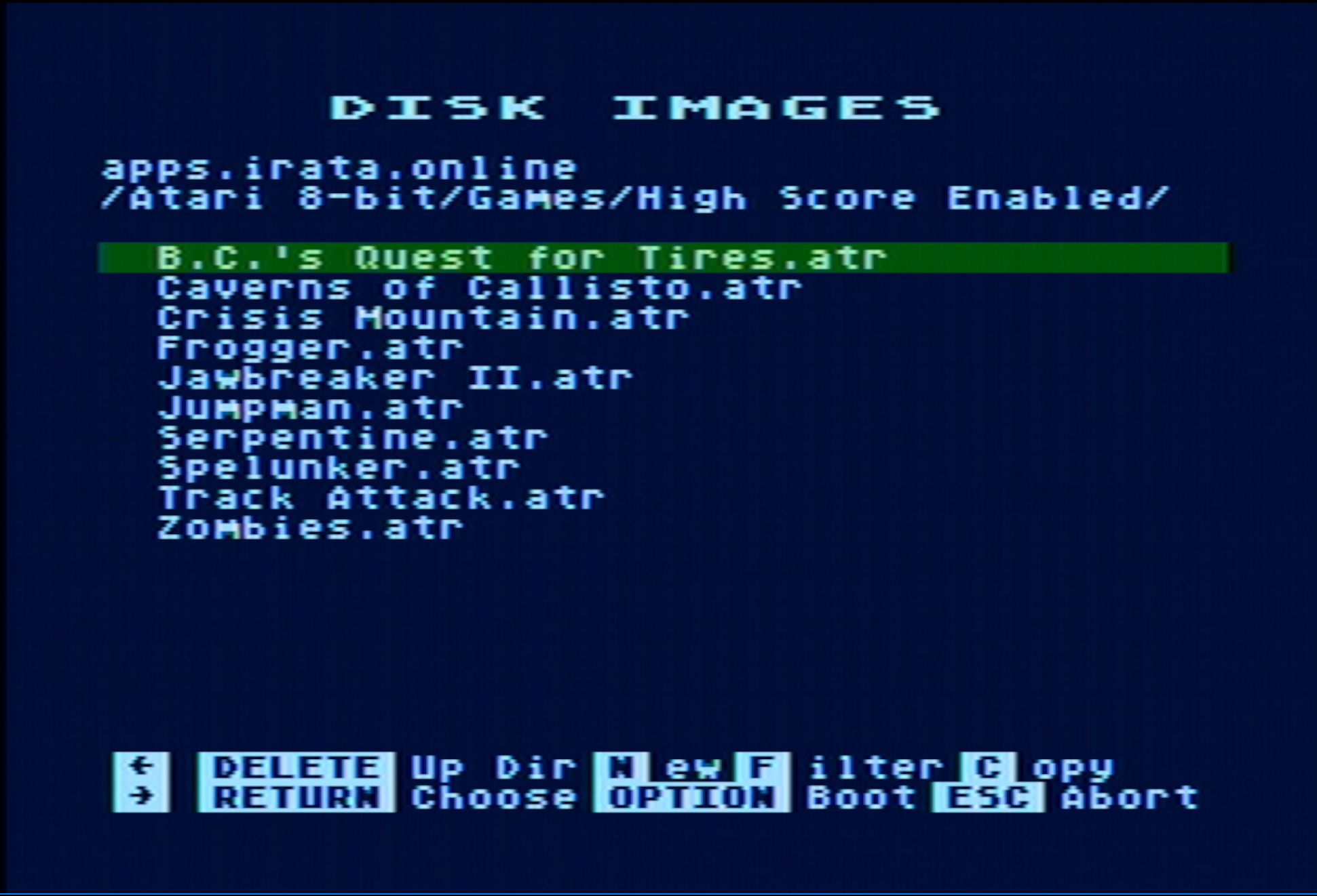

The current crop of high-score enabled games on apps.irata.online:
-Thom

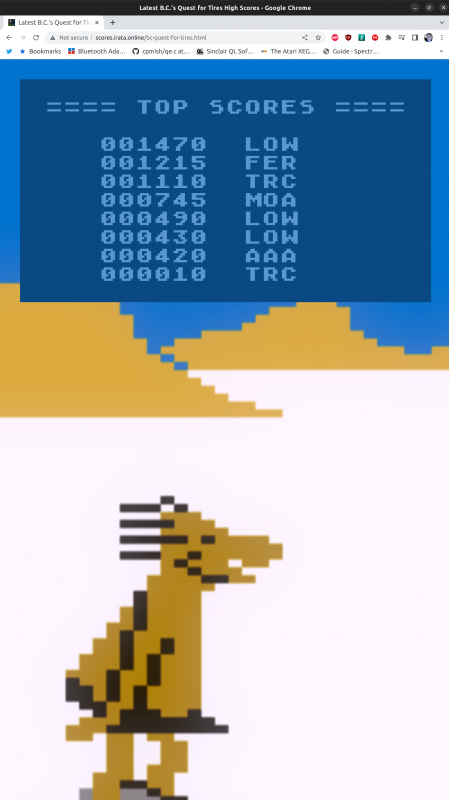

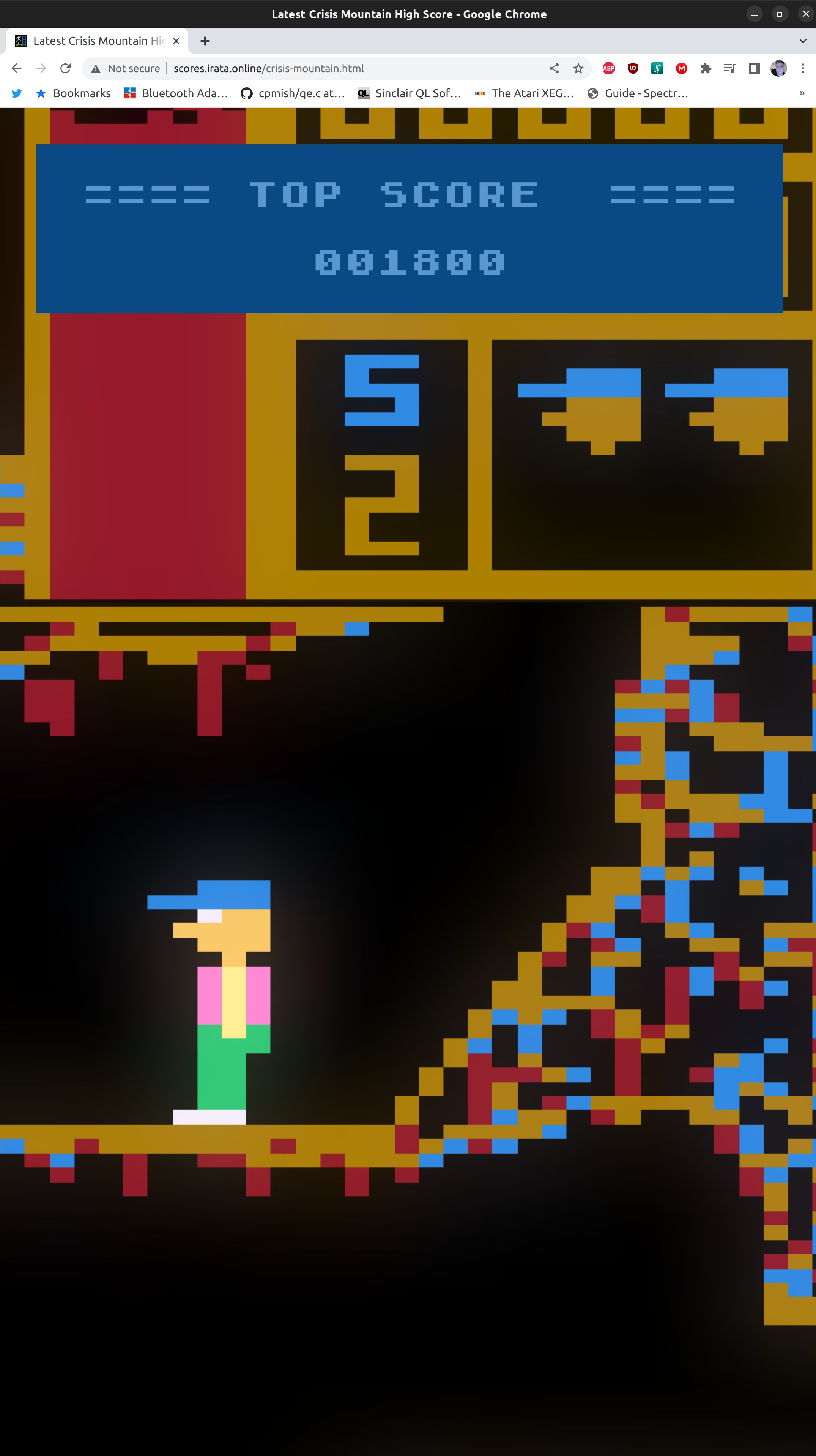

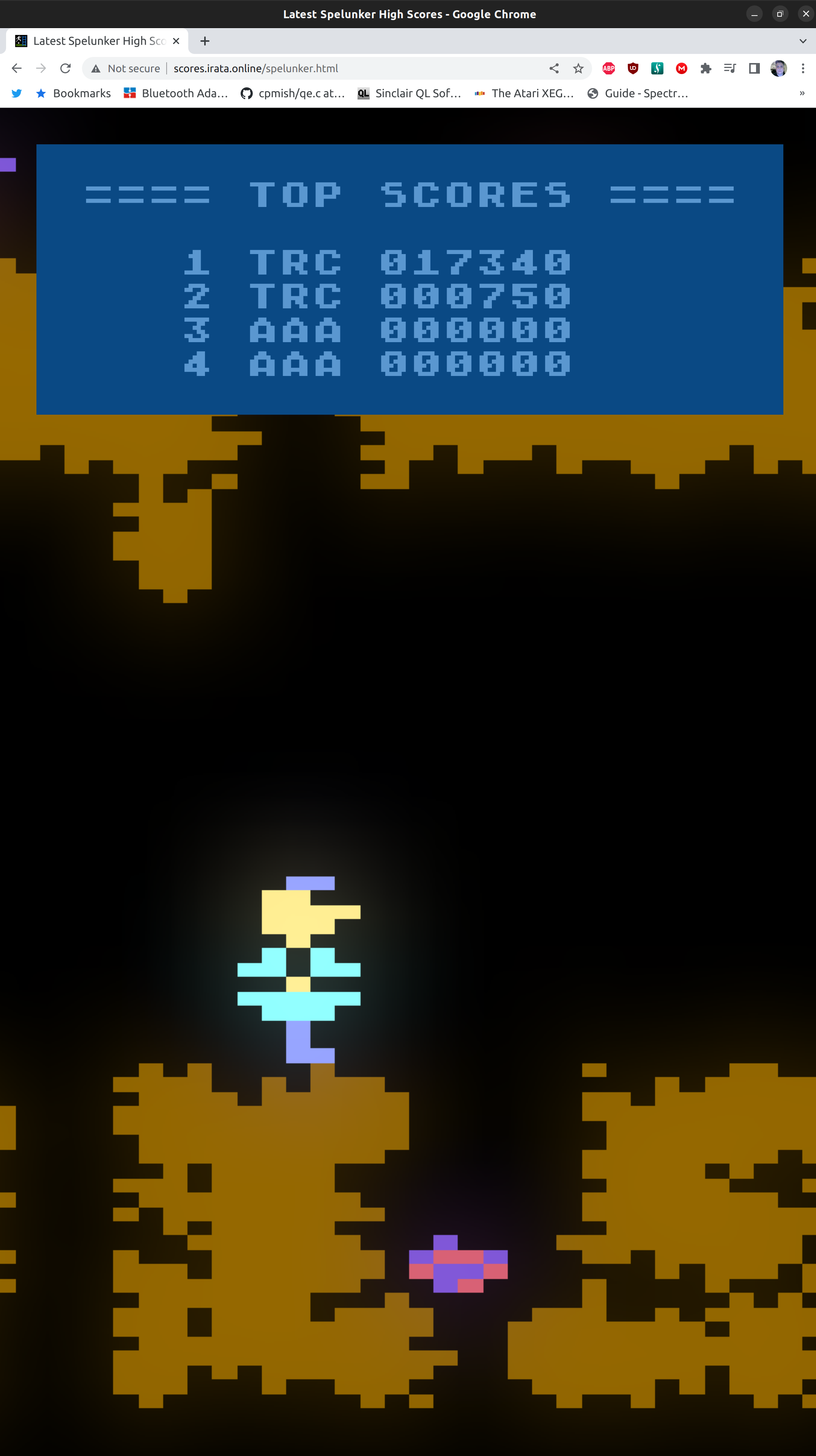

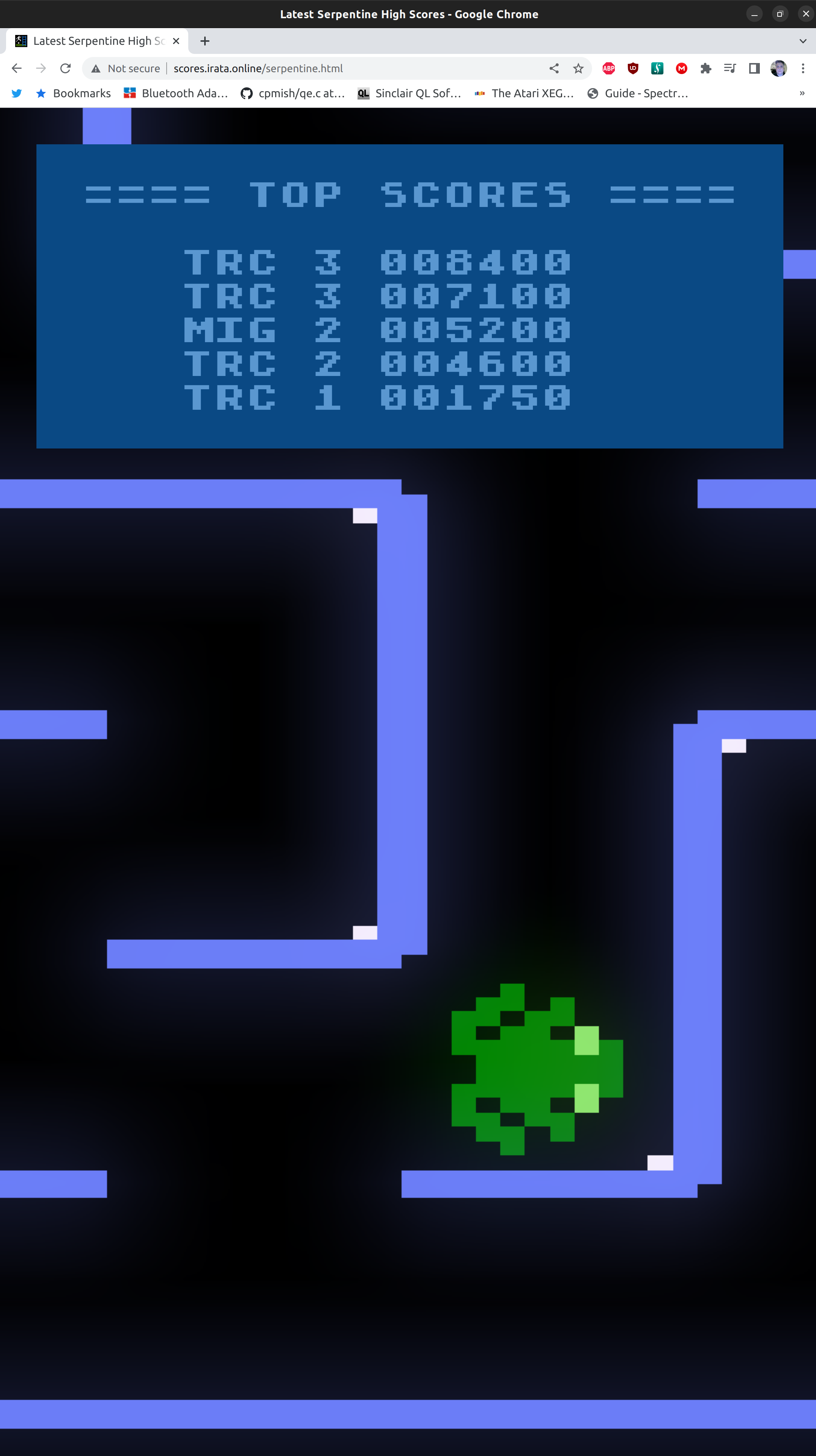

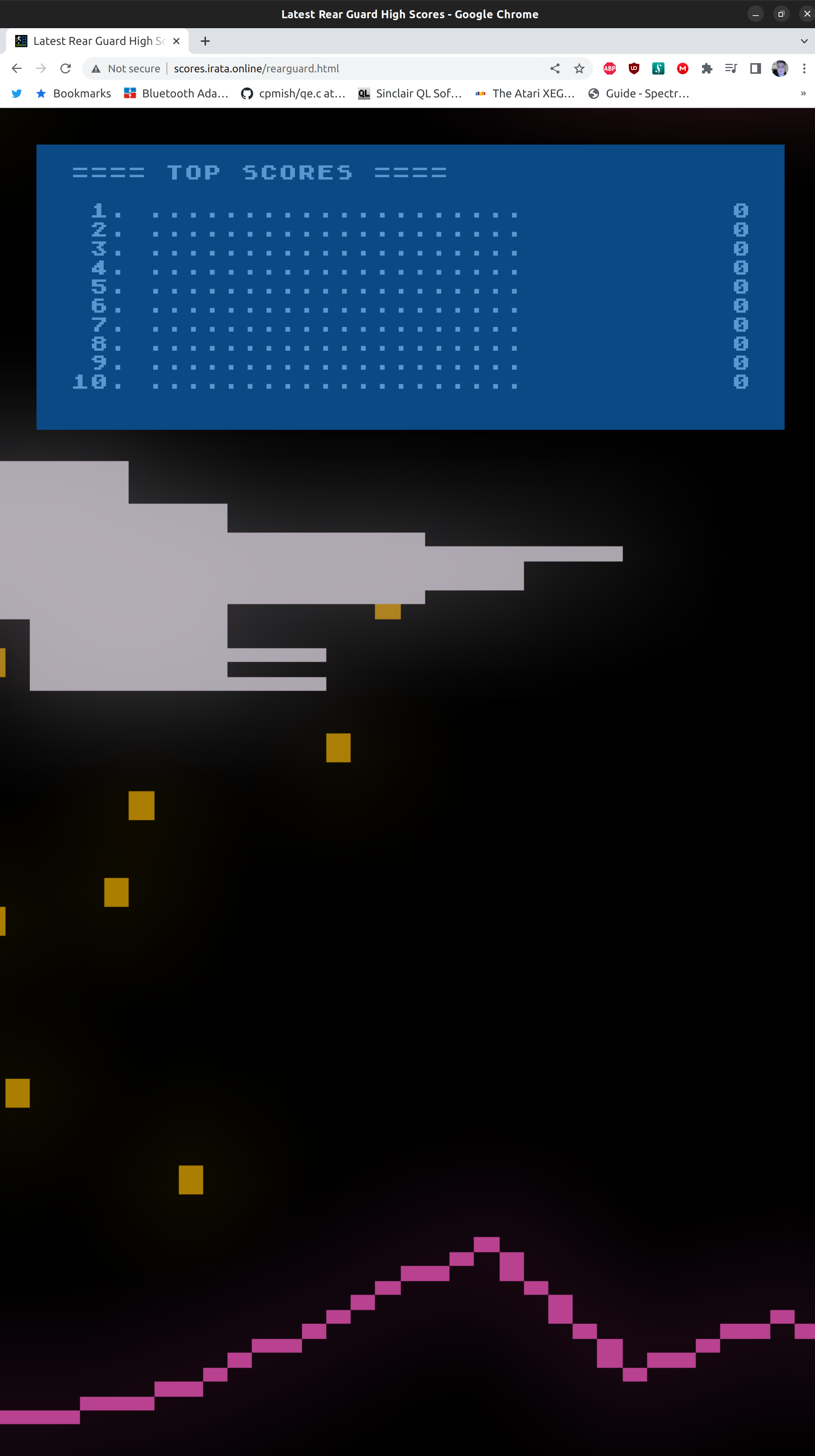

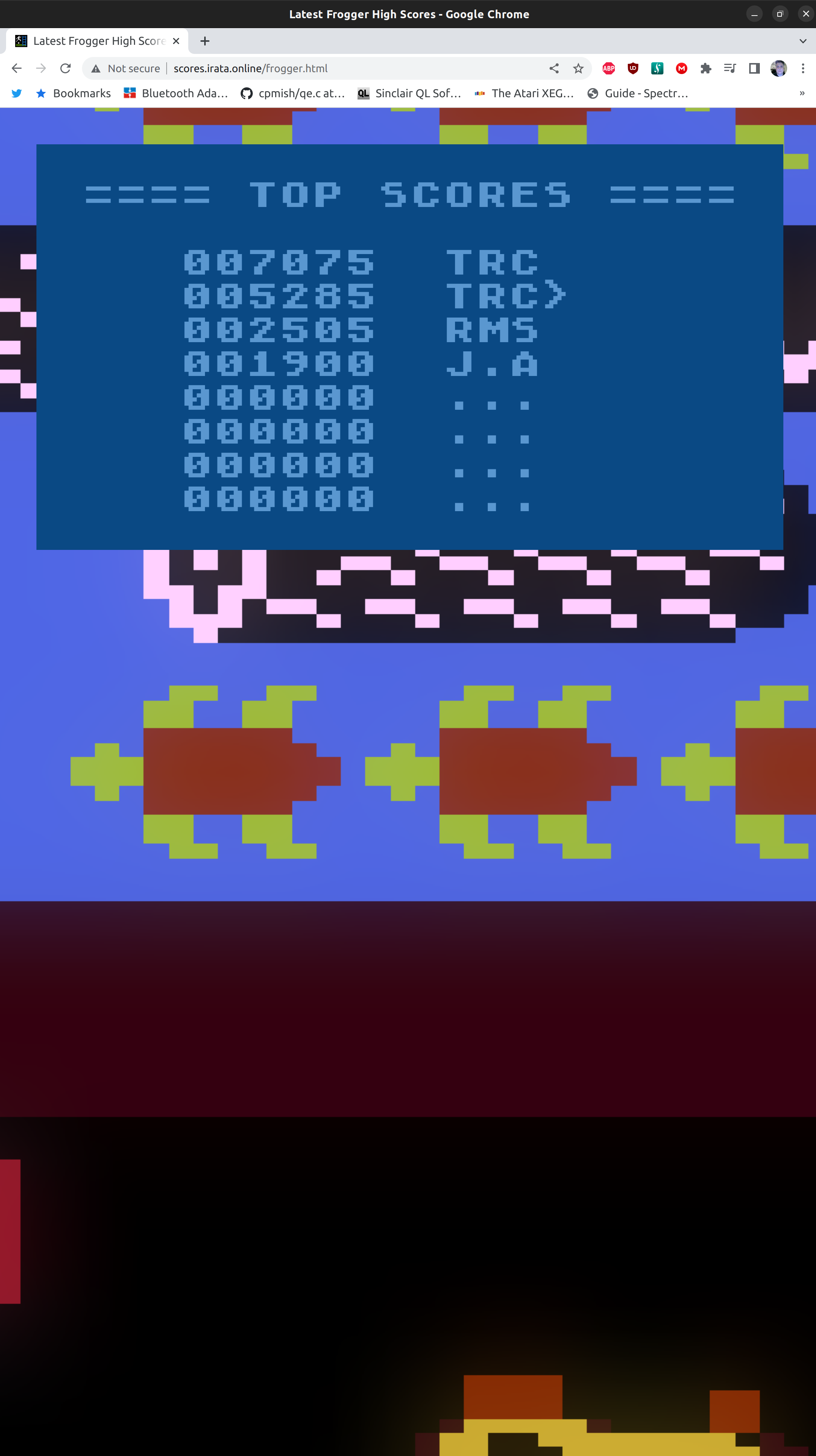

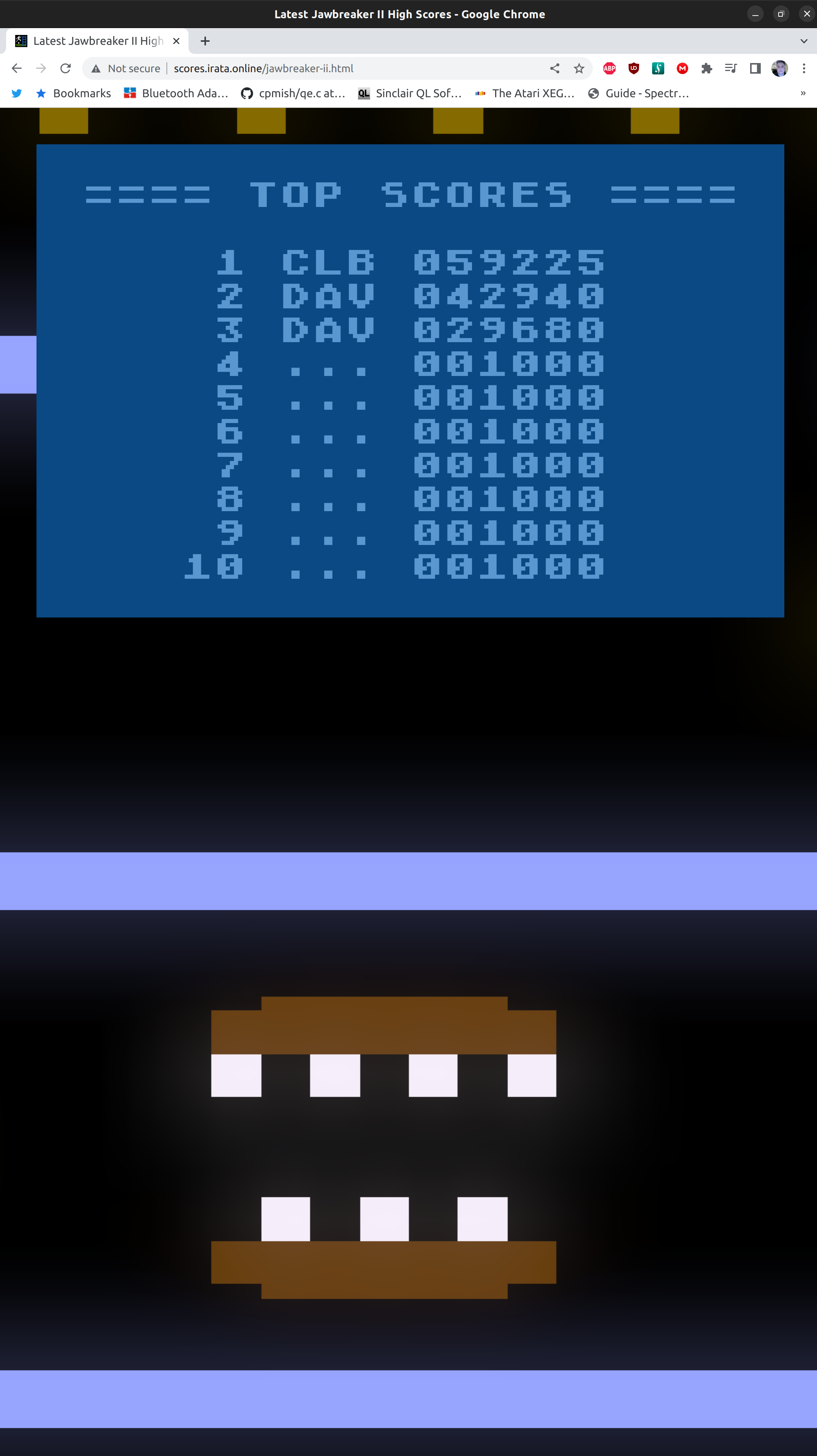

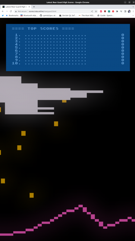

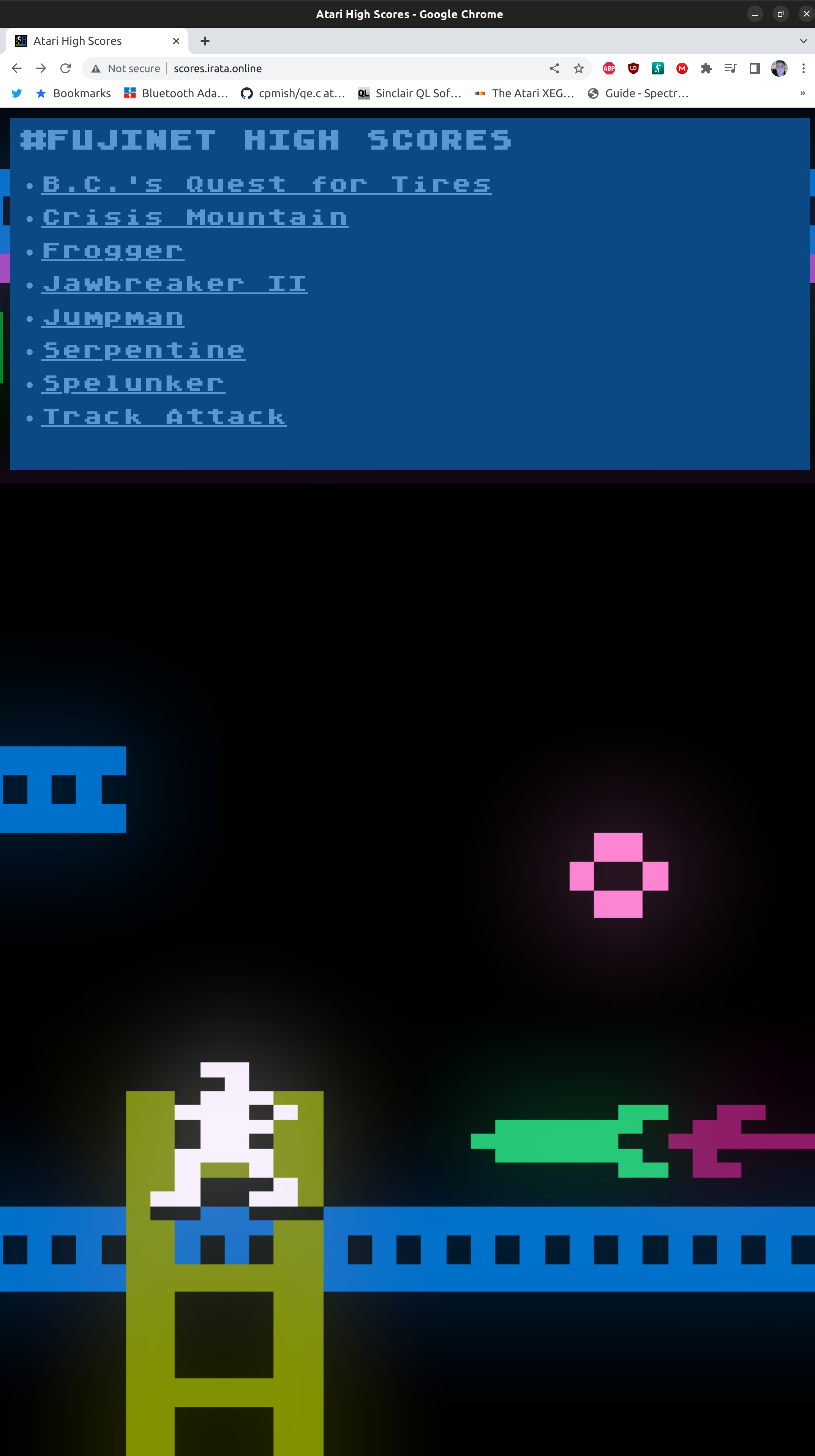

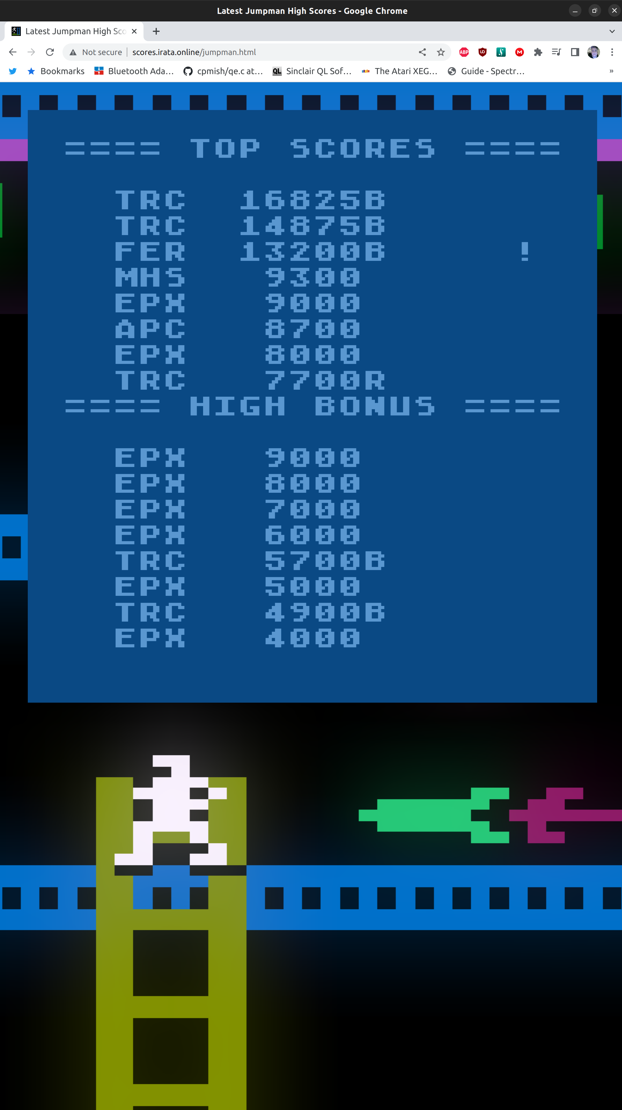

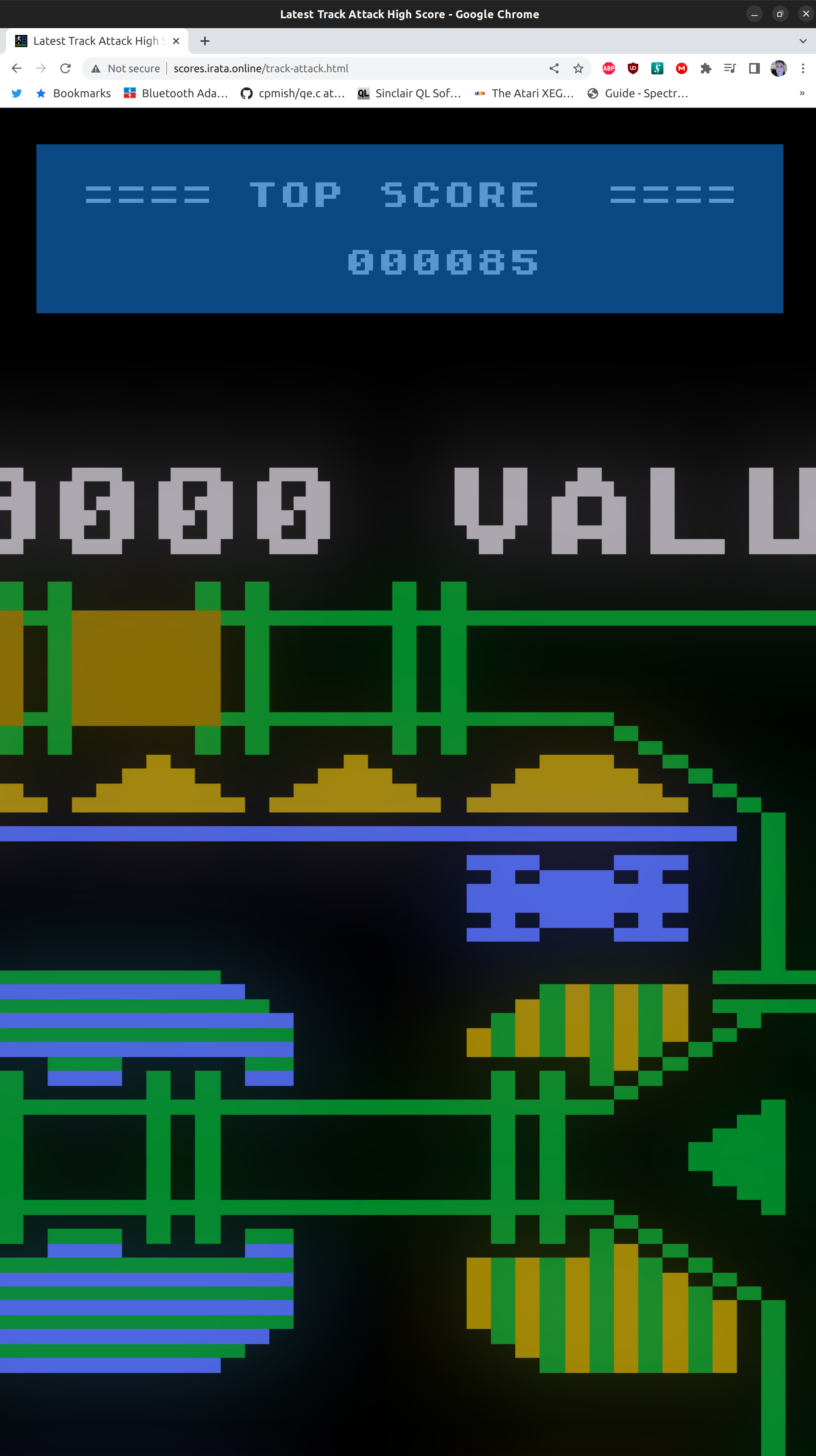

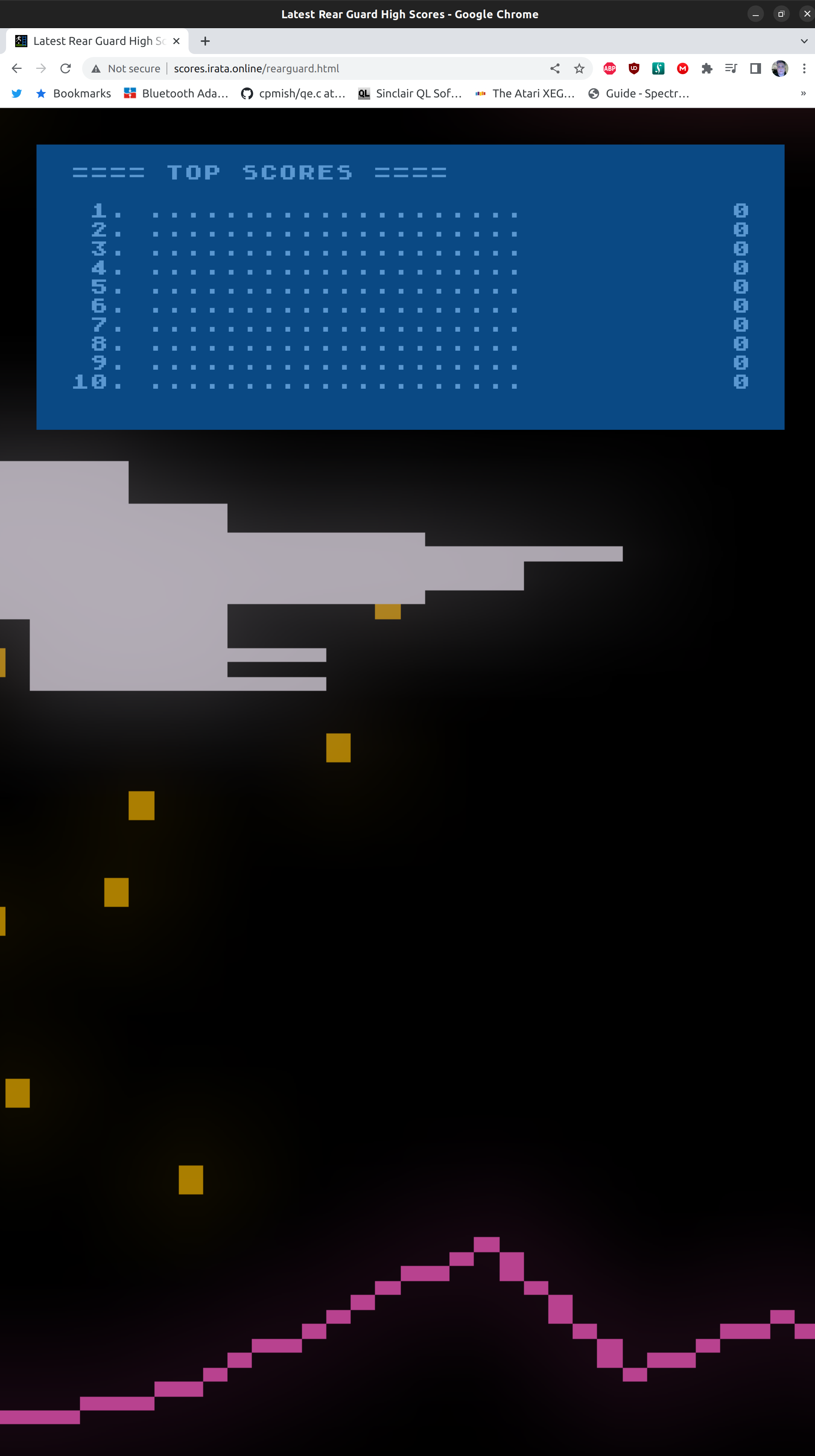

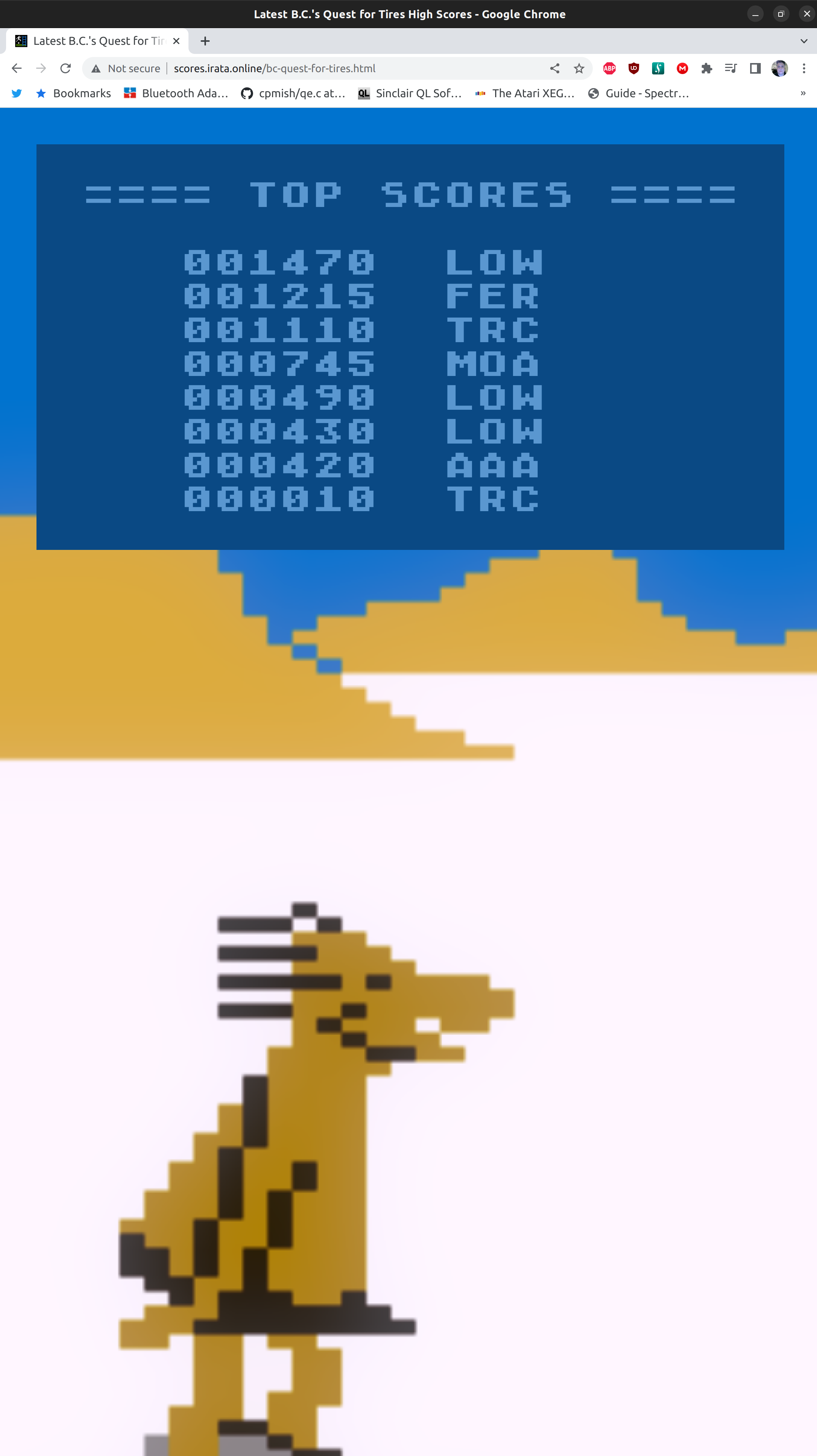

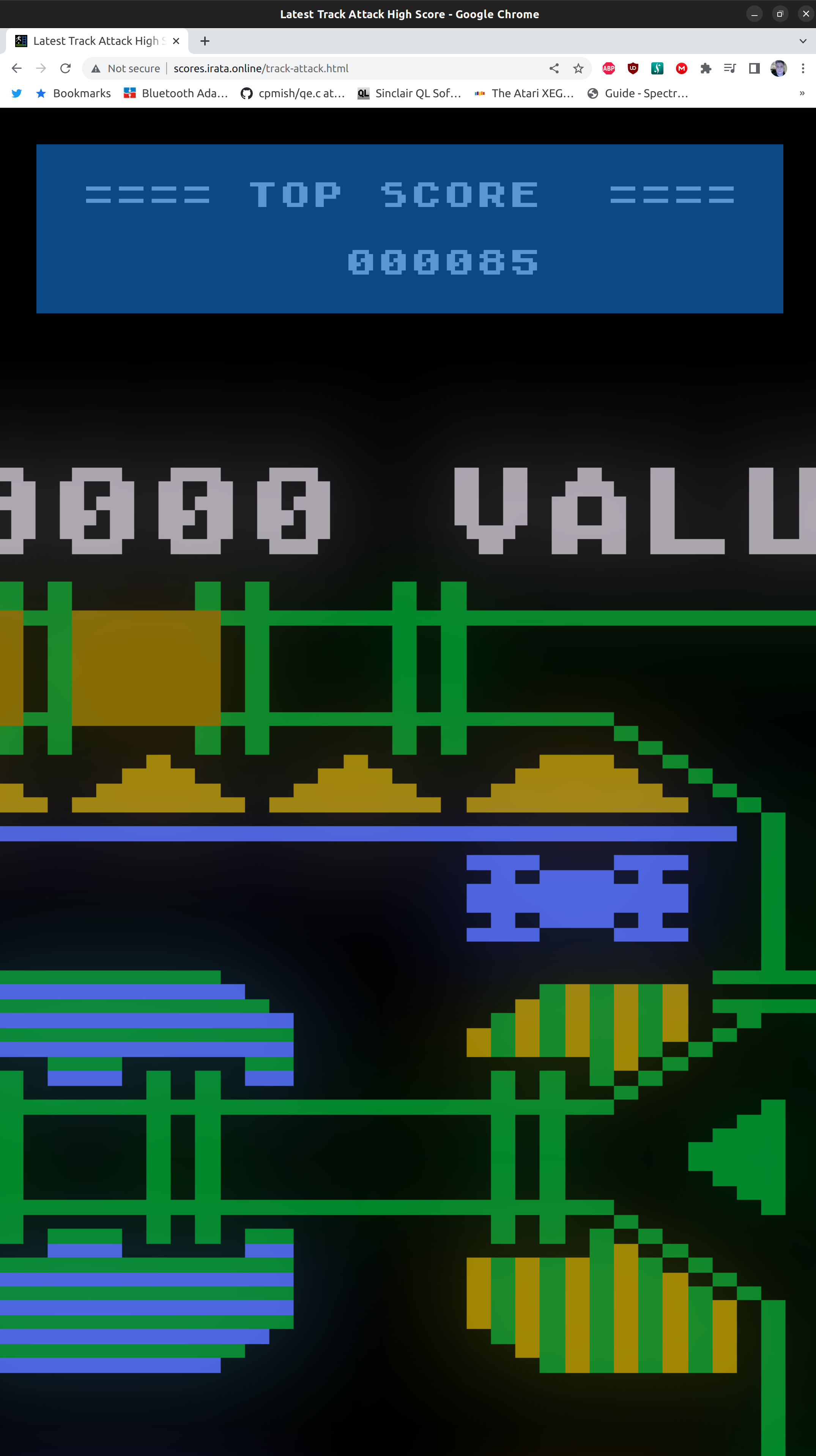

ok, actually applied a consistent design style to each of the high score pages, based on screenshots from each game, what do you all think?
Since portrait displays have dead space for pages like this, the game backgrounds are placed to better utilize it.

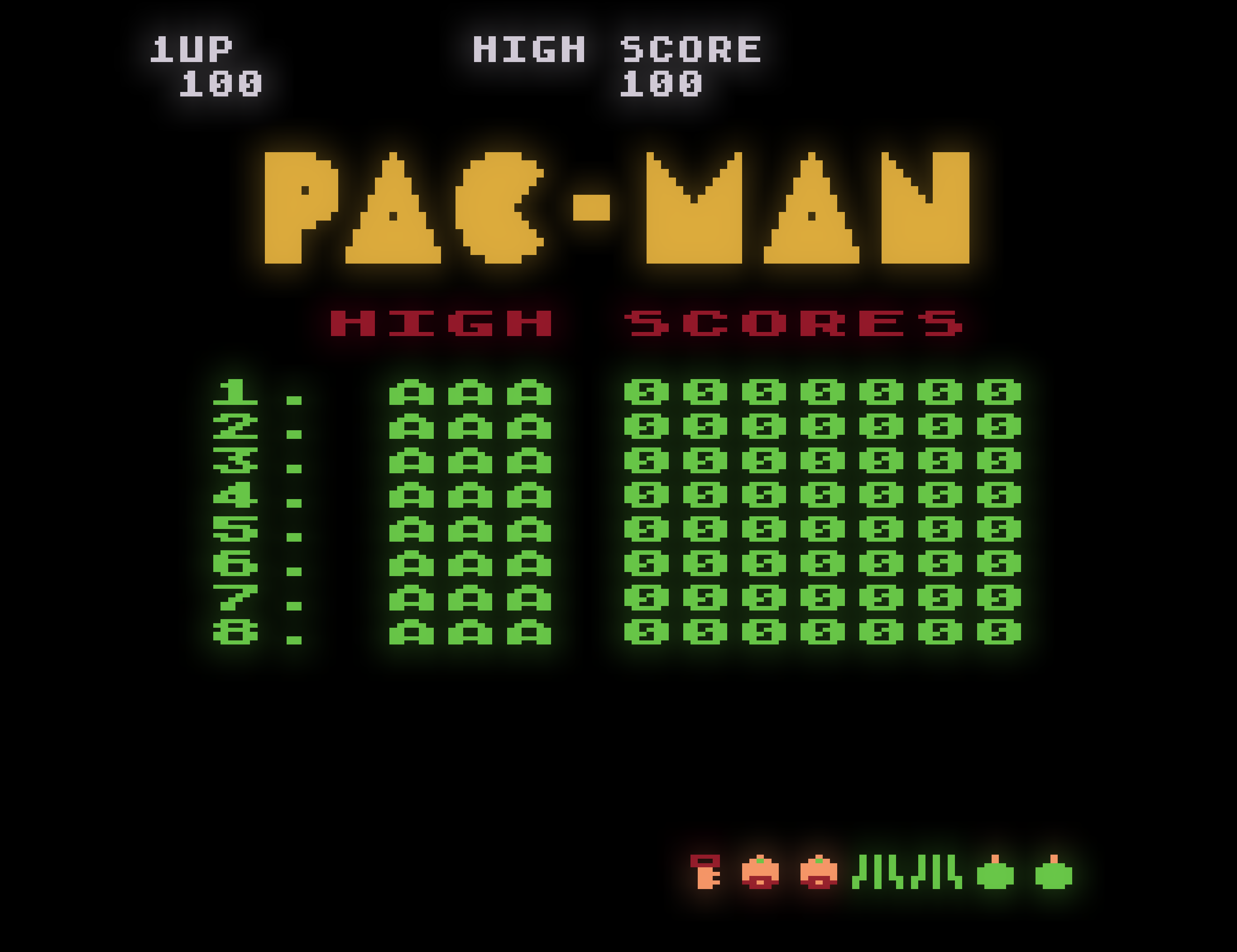

I have started to experiment with grafting high scores into existing games, starting with Pac-Man, which had its source code found in 2018.
starting with some display code.
If anyone wants to hack along, the code is in github:
https://github.com/FujiNetWIFI/fujinet- ... ts/pac-man
(the following is my opinion)
This is what can happen, when source code is preserved, and why I feel that retrocomputing projects should be open source.
-Thom

#FujiNet #atari8bit #highscores Adventure Intl's Rear Guard has been High Score Enabled.
TNFS: apps.irata.online/Atari 8-bit/Games/High Score Enabled/Rear Guard (BASIC).atr
Scores: http://scores.irata.online/rearguard.html #retrogaming Scott Adams
