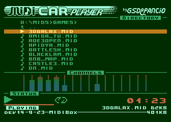

MIDICar Player dev-140923.
MCP dev 140923.png (7.63 KiB) 62261 mal betrachtet
mcp.atr
(130.02 KiB) 570-mal heruntergeladen
Novelties:
  • track time minutes:seconds view (request from @patjomki)
    It wasn't easy, but it worked out. For now, only the time from the beginning of the song is available.
    The 'T' key toggles time presentation modes: Hex MIDI Ticks, Dec MIDI Ticks, Min:Sec (as default) , Off;
  • when you load a song, next to its name (in the status bar) its size in KB appears (request from @Pancio :) )

  • Simple view
    This can be achieved by pressing the 'I' key. The selector is then retracted and the music handling closes in the current directory or playlist.
    Passing a parameter, e.g. (SDX system)
    Code: Alles auswählen
    -MCP MISSON.MID
    will start the program in just such a Simple view.

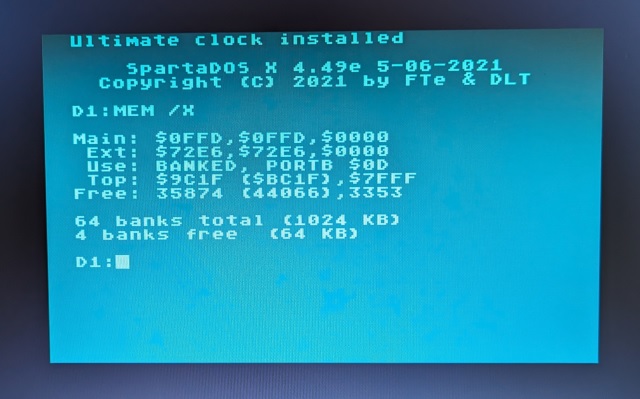

Today I tried this latest version with my 800XL that is now equipped with a 5V modification at the pbi bus.
While the program is running fine on my 600XL with my 800XL there are some errors.
After loading a midi file the file is not played instead it is immediately "STOPPED". When I try to load the same file again I get an error message "I/O ERROR #97"
Any ideas?

Both computers are equipped the same way. There are only two differences
1. The 800XL has a 5V modification at pbi
2. The 800XL also has a rapidus installed but completely disabled.
Apart from that both computers have vbxe, u1mb, pokeymax3, sophia2 and an avgcart with sio cable equipped.
Configuration:
1088kb Rambo, XL OS 1.3, Atari Basic C (but disabled with option when starting mcp), no SpartaDOS X, VBXE disabled, PBI BIOS disabled, Pokeys Single, Covox disabled, PSG disabled, SID disabled
Pressing X doesn't really help. One or two notes are shown to be played (but I don't hear anything) then the 800XL freezes. 600XL is running fine.
Midifile is the one I already posted thunder.zip few messages above

I just realized that the MIDICar Player 1.6a with MIDIMaze driver shows on my 1088XEL only 89K free memory available.
In U1MB menu I enabled 1MB (I flashed an image from FJC containing SDX 4.49e for 1088XEL on U1MB).
Any idea?
[EDIT]
I tried on my XE and:
1) When SDX, PBI and HDD are disabled in U1MB and SDX is enabled in the SIDE2 cart, and I start MPCar Player, it shows 1033 KB free memory
2) When SDX, PBI and HDD are enabled in U1MB and SDX is disabled in the SIDE2 cart, and I start MPCar Player, it shows 89KB free memory
In both cases, I enabled 1MB in U1MB.
Is this a bug ?

Does the same thing occur in the DEV version of MCP at your site?
You can download the DEV version from this thread. There are two. One with the IRQ patch, the other without. The patch is applicable for 6502/6502C processors, which have a bug related to IRQ and NMI interrupts. Please see if the memory detection problem also occurs in this version, as the emulator indicates the correct amount of memory.
One more thing.
MCP will not work with the AXLON memory extension!

Beitrag von Montezuma »
PeBe hat geschrieben:
10.10.2023 20:46
The DEV version shows even less memory available (64KB).
10.10.2023 20:46
It has nothing to do with AXLON.
Memory detection issue is related to U1MB settings ( http://atariki.krap.pl/index.php/Ultimate1MB ).
As I mentioned before - if SDX, PBI and HDD is disabled in U1MB settings, and SDX is enabled in SIDE2 cart, MIDICar player properly detects available memory. Otherwise not.
Do you have U1MB ? Perhaps Pancio could help you with testing (he has an ATARI with U1MB).
PeBe
Beiträge: 35
Registriert: 25.06.2022 14:55
Has thanked: 25 times
Been thanked: 32 times
Re: MIDICar Player
Beitrag von PeBe »
Montezuma hat geschrieben:
10.10.2023 21:44
10.10.2023 20:46
Yes, it will show less when from the DEV version, the program requires extended memory, i.e. on 64KB it won't run - Sorry, progress has its victims too.
10.10.2023 21:44
10.10.2023 20:46
I suppose it has nothing to do with AXLON. It's just an indication that MCP doesn't work with this type of memory extension in any release.
10.10.2023 21:44
Memory detection issue is related to U1MB settings ( http://atariki.krap.pl/index.php/Ultimate1MB ). As I mentioned before - if SDX, PBI and HDD is disabled in U1MB settings, and SDX is enabled in SIDE2 cart, MIDICar player properly detects available memory. Otherwise not
Detection of extended memory is based on two ways:
- for computers without SDX by the way presented in Atariki ( http://atariki.krap.pl/index.php/Obs%C5 ... 4%99ci_RAM )
- and for SDX systems, where memory is detected by SDX routines.
So maybe I'll ask it in a different way.
Under SDX, with all optisions enabled, as shown by the `MEM /X` command.
Are there any free banks?
If not, the problem could be the RAM-DYSK being loaded during SDX startup.
On the other hand, if there are free banks, then the error is actually somewhere in the MCP program loader.
10.10.2023 21:44
No. I do not own a U1MB. I can talk to @Pancio in terms of testing.
Montezuma
Beiträge: 102
Registriert: 18.06.2021 23:04
Has thanked: 122 times
Been thanked: 64 times
Re: MIDICar Player
10.10.2023 22:12
You are right - there are only 4 free banks available:
SDX manual says:
"If there is no custom CONFIG.SYS in the boot sequence, the standard setup from the
CAR: device will install one ramdisk as drive O: and build the directory structure on it."
and I don't have CONFIG.SYS
Montezuma
Beiträge: 102
Re: MIDICar Player
Here is a solution for other users who are not familiar with SDX (like me).
I assume that the first HDD partition (configured with FDISK) is D3.
Copy original CONFIG.SYS from CAR to D3:
D3:TYPE CAR:CONFIG.SYS >>CONFIG.SYS
Edit the file
D3:ED CONFIG.SYS
Delete the line:
DEVICE RAMDISK
In U1MB menu, change CONFIG.SYS configuration from default to D3.

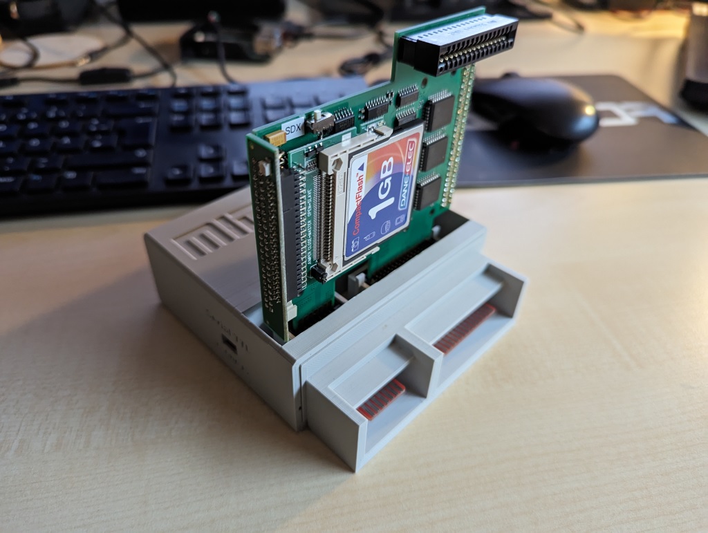

MIDICar + MyIDE2
Beiträge: 2015
Has thanked: 1007 times
Been thanked: 616 times
Re: MIDICar Player
Hello pancio
pancio hat geschrieben:
12.10.2023 07:50
Is exist cartridge of MyDOS?
Yes. But it contains a modified version of MyDOS 4.53/3. You put it in the computer, boot the computer and then, while the computer is on, remove it from the computer. After that, the version of MyDOS running on the computer is just like the version of MyDOS 4.53/3 that is loaded from disk. Video61 sells them. This version of MyDOS has been patched by the same guy that wrote MyDOS 4.55.
Sincerely
Beiträge: 1256
Has thanked: 961 times
Been thanked: 506 times
Re: MIDICar Player
12.10.2023 11:40
MIDICar + MyIDE2
I miss SDX and RTime-8 carts in the cart slot. :mrgreen:
