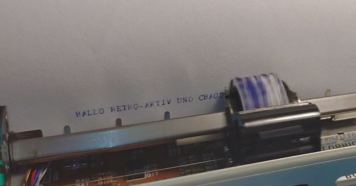

Hi again, as I wrote before it works fantastic.
Yesterday we did the first test and I was surprised about the quality of the letters on the paper.
But it was difficult to refill the ink to that small roller and to find the correct amount of ink.
I think everyone need to try it which is the best.
For me it was fantastic to see this over 40 year old technology running at our Retro-Aktiv meeting.
By the way, today I ordered four more of the "Retrieve 1027 Letterband" to have some on stock because I don't know about the durability of that first new one which is actual mounted in the printer.
See picture of the first test, yesterday evening we had better results but no photo

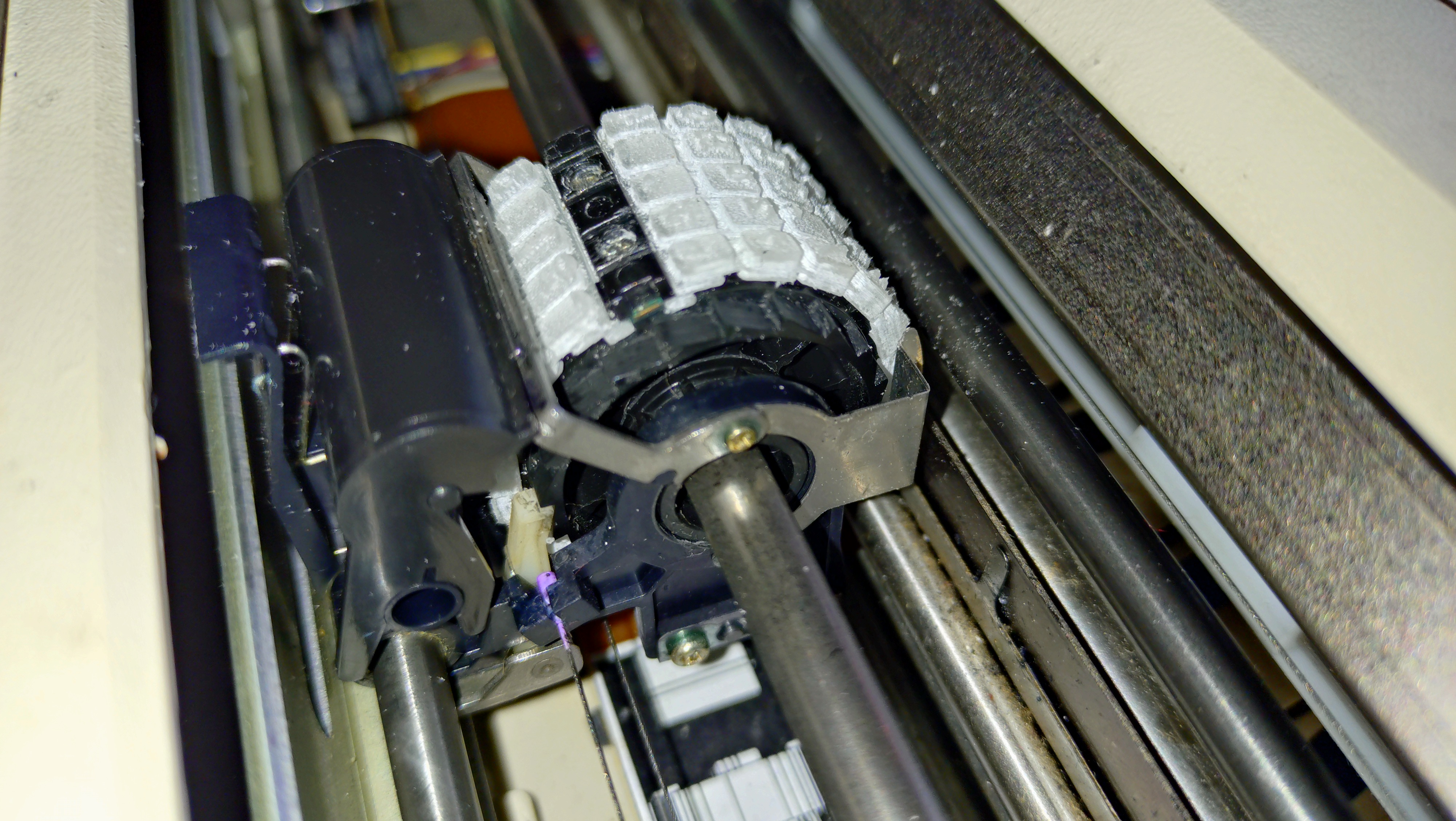

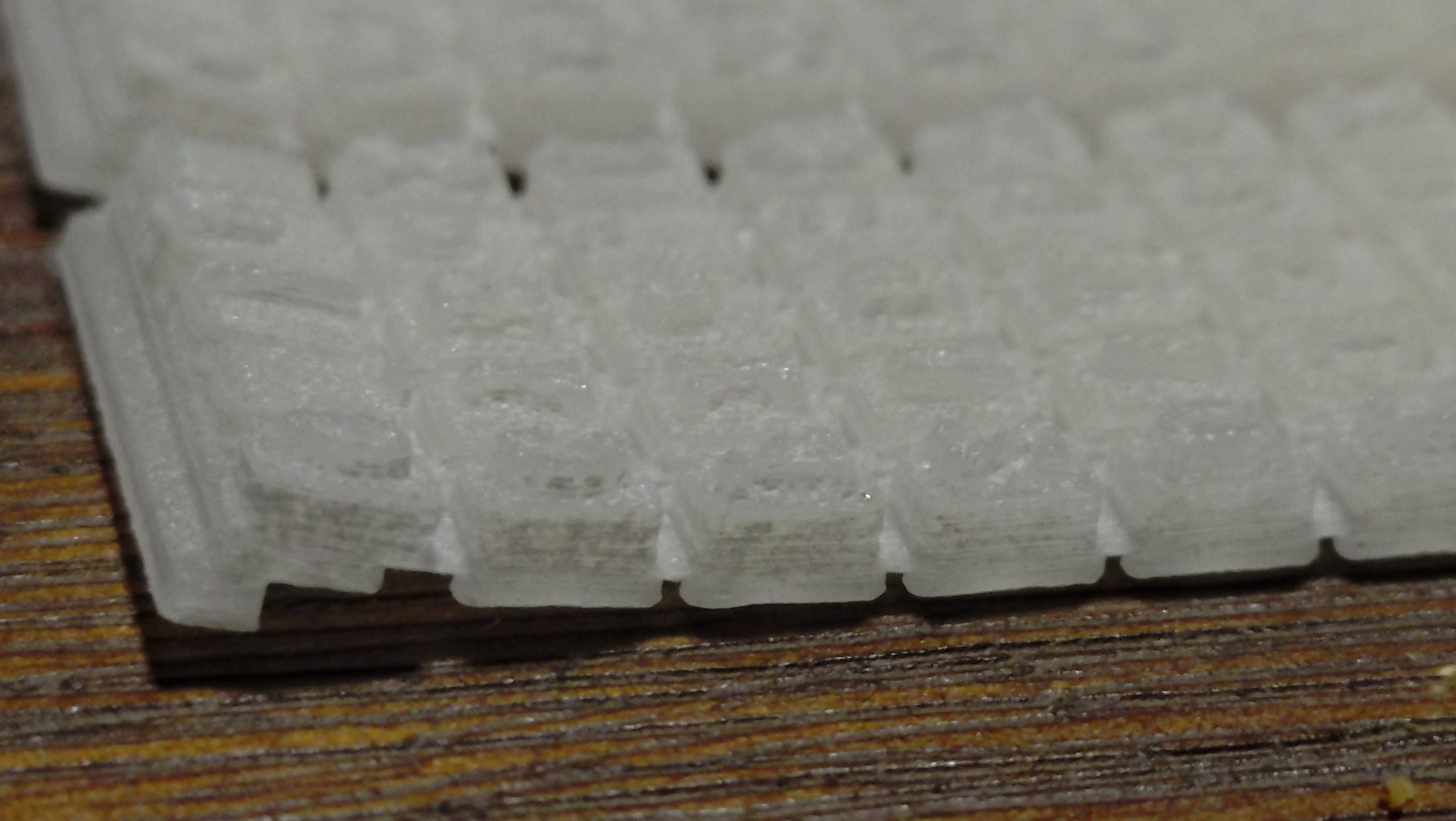

Hier noch Fotos der ersten Bestellung :
- Dateianhänge
- 20241014_195950736.JPG (2.22 MiB) 9355 mal betrachtet
- 20241014_200110587.JPG (1.08 MiB) 9355 mal betrachtet

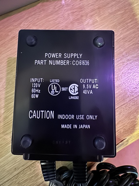

Re: Suche: Netzteil für Atari 1027
I have (I seems like) an original PSU for my recently bought 1027 and it is 9V AC w/ 40VA which is similar to the 1050 one.
- Dateianhänge
- IMG_8389 Medium.jpeg (90.08 KiB) 9278 mal betrachtet
- Torti
- Beiträge: 10
- Registriert: 08.10.2024 18:54
- Has thanked: 1 time
- Been thanked: 4 times
Yee, 9V and 4A.
The PSU is similar to the City 1050, but the 1050 has another plug size.
It's quiet easy to change the plug, but I am looking for an original one.
Yours is only 120V Input, is it the U.K. Version?
But you can use a 230V/110V Converter like this one: Nedis 230V/110V Converter

UK has 230V (but a special Power plug), 120V is US Version.
Yup, only 110v but once I get the letters band printed, I'll connect with a 110->220 converter and try to use the printer.
