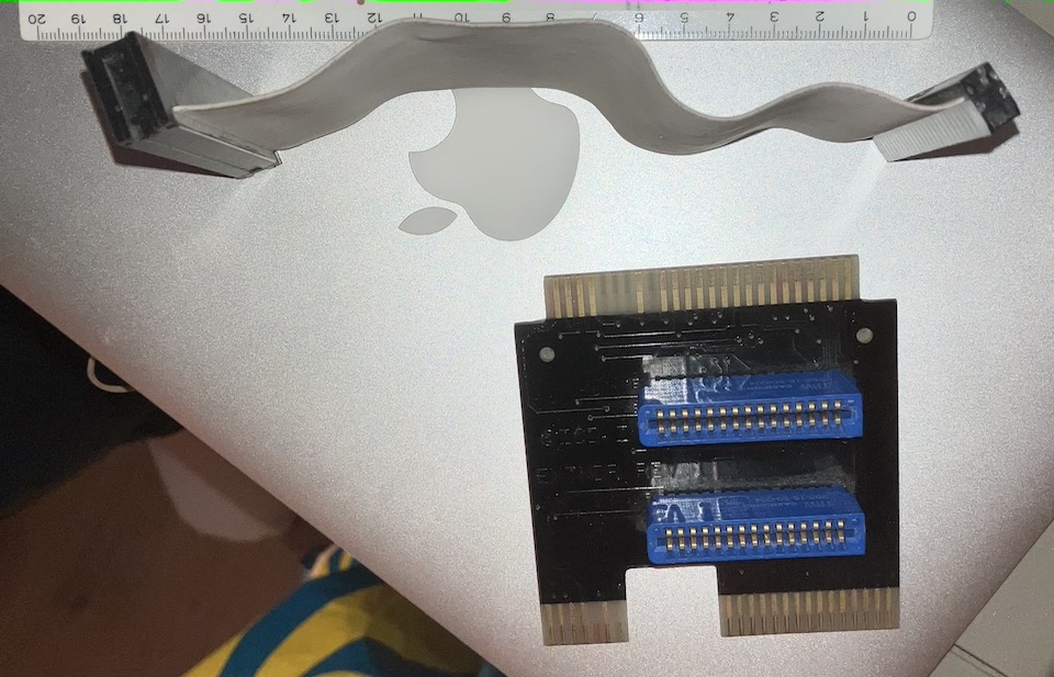

Hello Pancio
pancio hat geschrieben:
01.05.2022 00:54
... how long ribbon cable may I use to avoid ghosts and noises on the signal lines?
I can't not tell you, but here's a picture of the MIO Extender and the flat cable that came with the BlackBox.
Sincerely

That's good think!
Is this documented somewhere or should I arrange this board from the scratch? Probably I should because it's little big and without IDC but I'm asking rather about connections (it's one to one or with some additional parts/crosses on the PCB). Very cool idea.
Sincerely,

Feel free to reuse the adapter boards we created for the Turbo Freezer 2011. Design files in eagle format are here:
https://www.horus.com/~hias/freezer/tur ... -files.zip

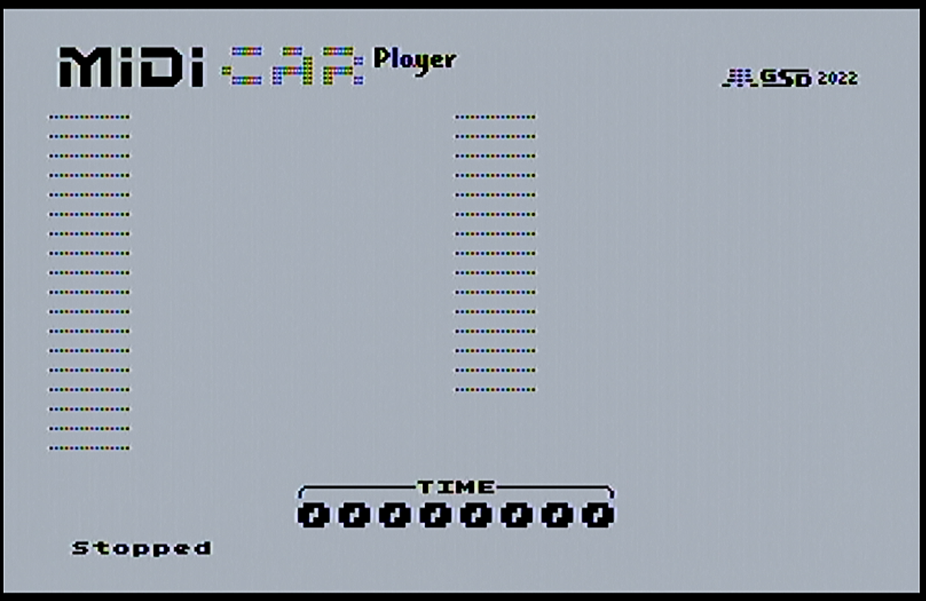

... but in mid time... PeBe made Player:
https://youtu.be/WFJyBG27bxg
https://youtu.be/zaZjuhLNJ2A

Some other examples with newest PeBe's player:
https://youtu.be/qR9-LIQzzs4
https://youtu.be/A3Tuogv8Hg4
Now player can play MIDIs bigger than 42KB... the limit is 1MB.

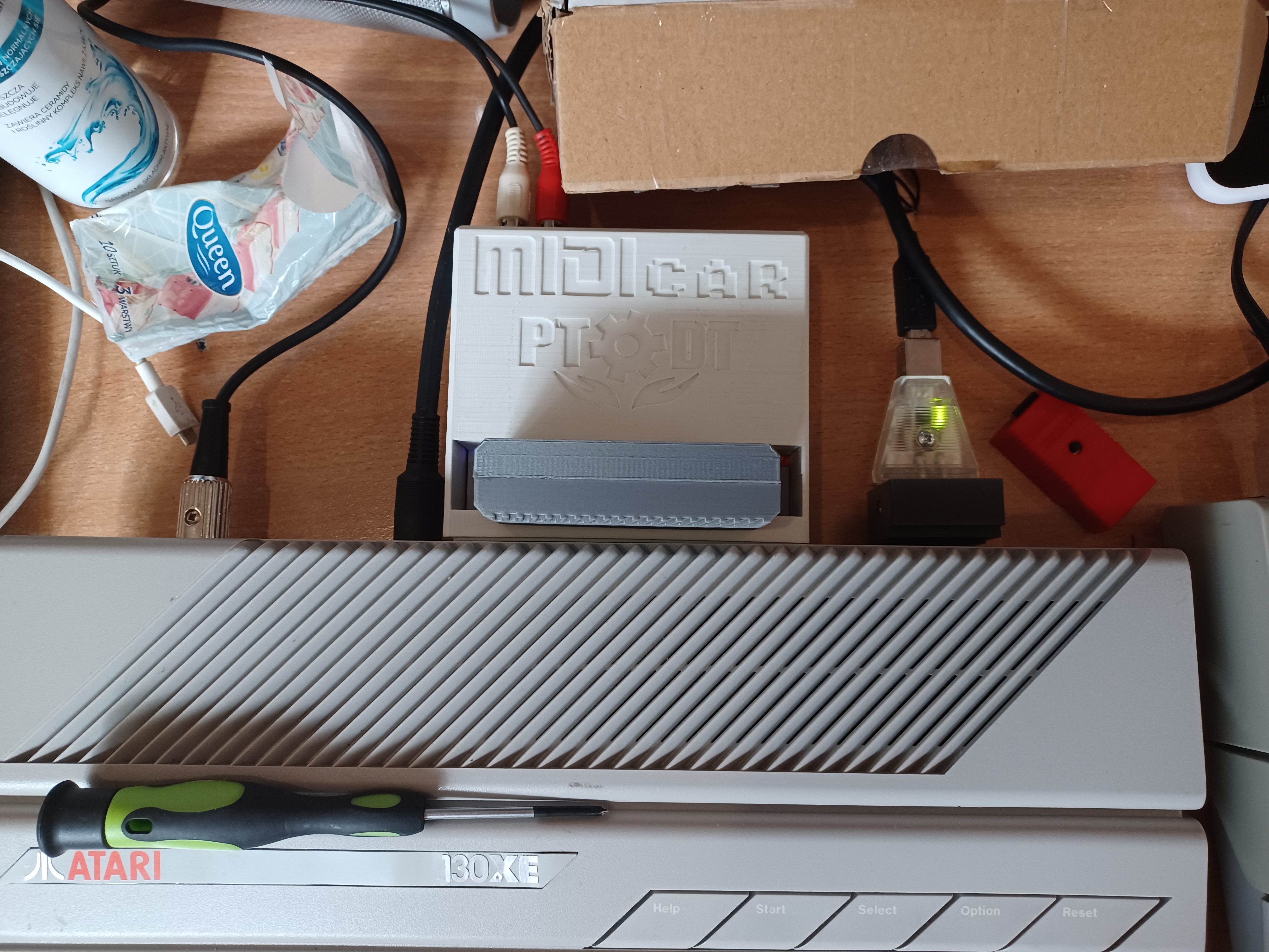

Hi Guys,

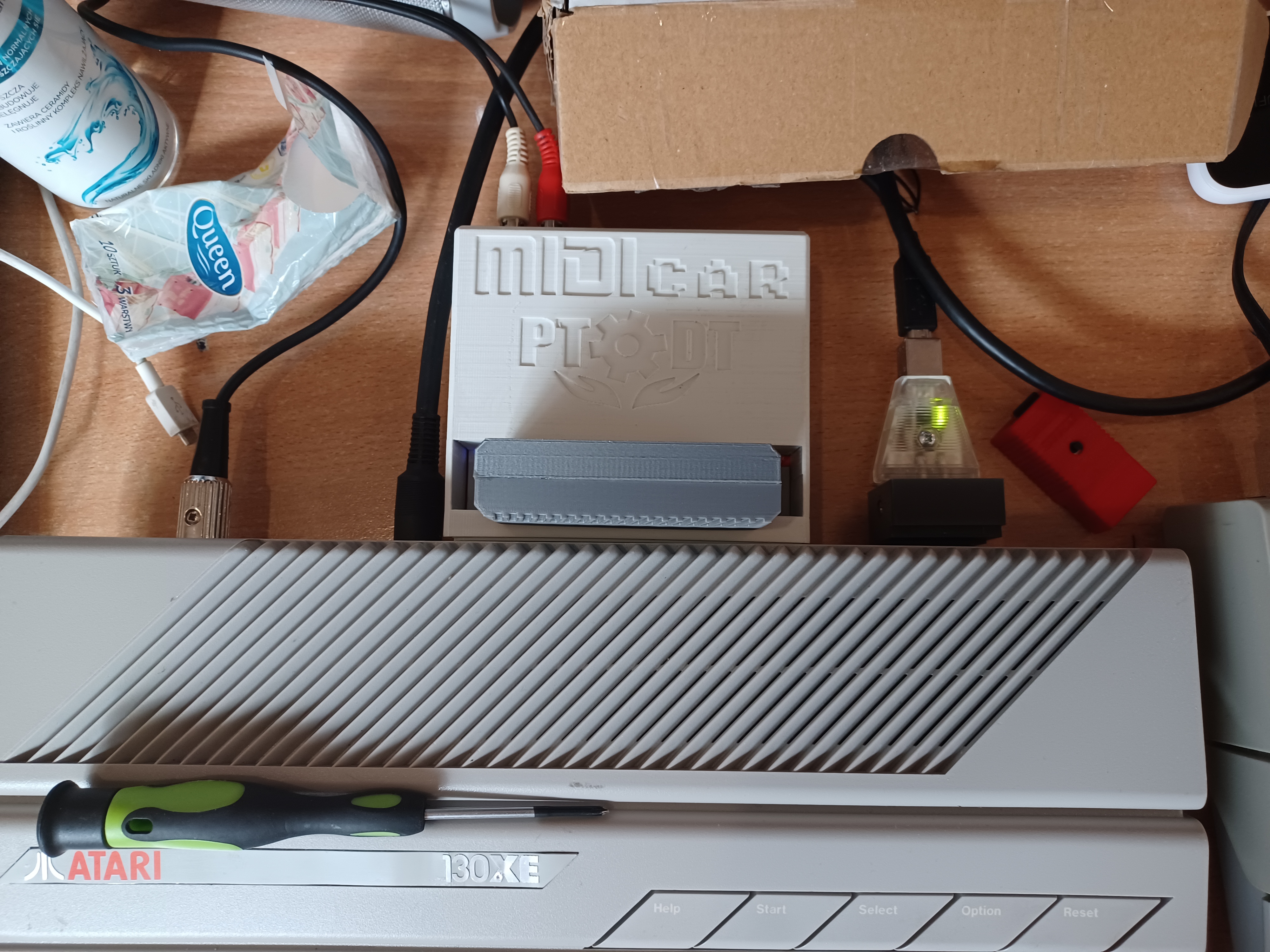

Our friend Kkrys made prototype case for MIDIcar. Someone of Atari users might see it on Lost Party 2022 (Licheń Stary, Poland). Of course, this is only prototype... we will plan to design a few models available with other colors variants too :-) The third photo shown that it's possible use MIDIcar with external memory expansion (512kb in case) so you don't need to modify stock Atari to enjoy most midi files :-)
Regards,
pancio

Re: MIDIcar – independent, easy to use MIDI player/recorder
Very cool 8-) !
This is one of my favorite "must have" things in the near future 8-)

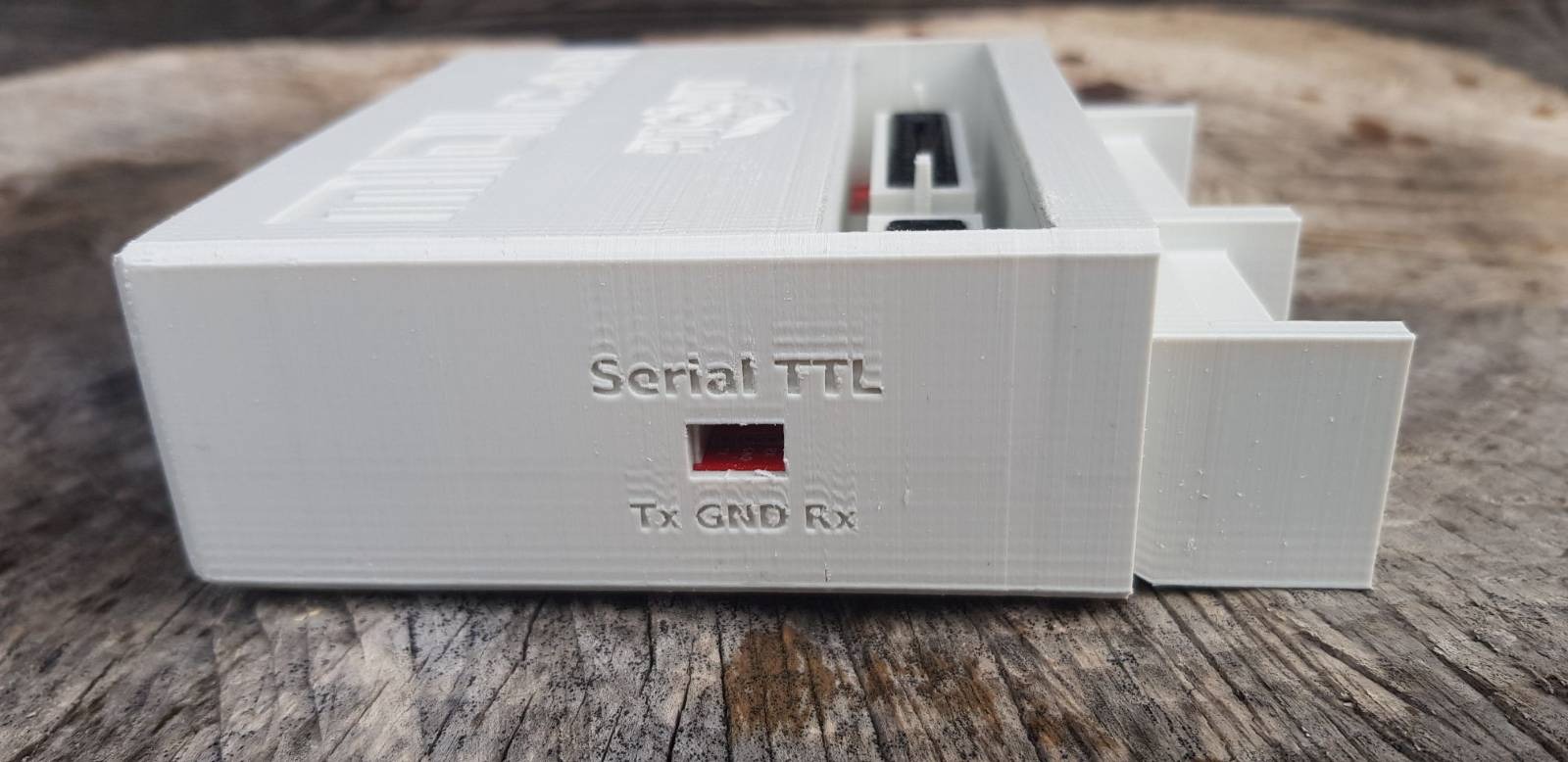

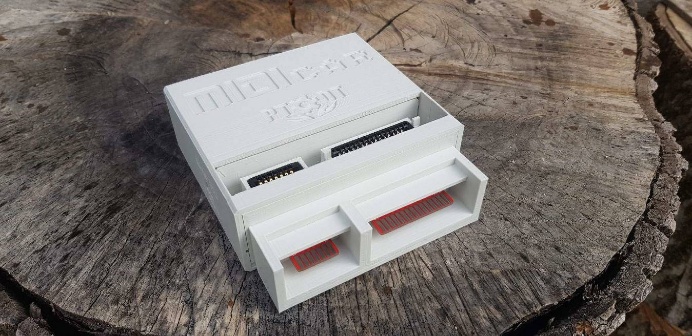

Anyone friend is willing to help to develop... I'll give rest from of development PCSs for free after ABBUC competition. So be in touch :-)
last case (hot print):

A few renders - just for fun (or resin case in the future):
revision 1.0.3 will be equipped with TTL<>USB-C converter based on CH340E for high speed serial...

MIDIcar SERIAL connector first usage:
midi-debug-via-serial.mp4
(27.85 MiB) 1387-mal heruntergeladen
used as debugger for MIDI data.. but the most probably feature is very high transfer (theoretically 2Mb/s) It might be good alternative for SIO2PC...

The MIDI Thru port is very close to the video cable. Won't that cause any problems if somebody tries to use plug a cable into the MIDI Thru port?
BTW have you tried to plug one MIDIcarXL into the back of another? And a third into the second? :mrgreen:
Sincerely
pancio
Beiträge: 321
Registriert: 31.08.2021 07:31
Has thanked: 313 times
Been thanked: 318 times
Beitrag von pancio »
Hi Mathy,
Yes... sorry I know - hobby is very important but family too :-) The reason why XL version was made is that I don't know when I'll finish common model for both XL/XE with additional middle board as we discussed in other very good topic: viewtopic.php?f=3&t=1035
So, gerbers and full project files is available on my page - anyone is willing to do it by himself. I'm not sure, XL version will be made by us and available in shop. I may prepare three modules because have a free PCBs from prototyping process. If anyone is interested in - let me know privately.
According to MIDI ports positions... well it's compromise between PCB length and usability... there is no issue with connecting passthru cable but it's looking little bit strange :-)
not yet... because I've only one MCpbi assembled at this moment. Will try, be sure :-)

Little announce according MCplayer:
https://www.youtube.com/watch?v=95PjqzHXih0
Just one more notice... MIDIcar PBI version is capable to play with SIDE2, IDE+ or AVGcart together! :-)
