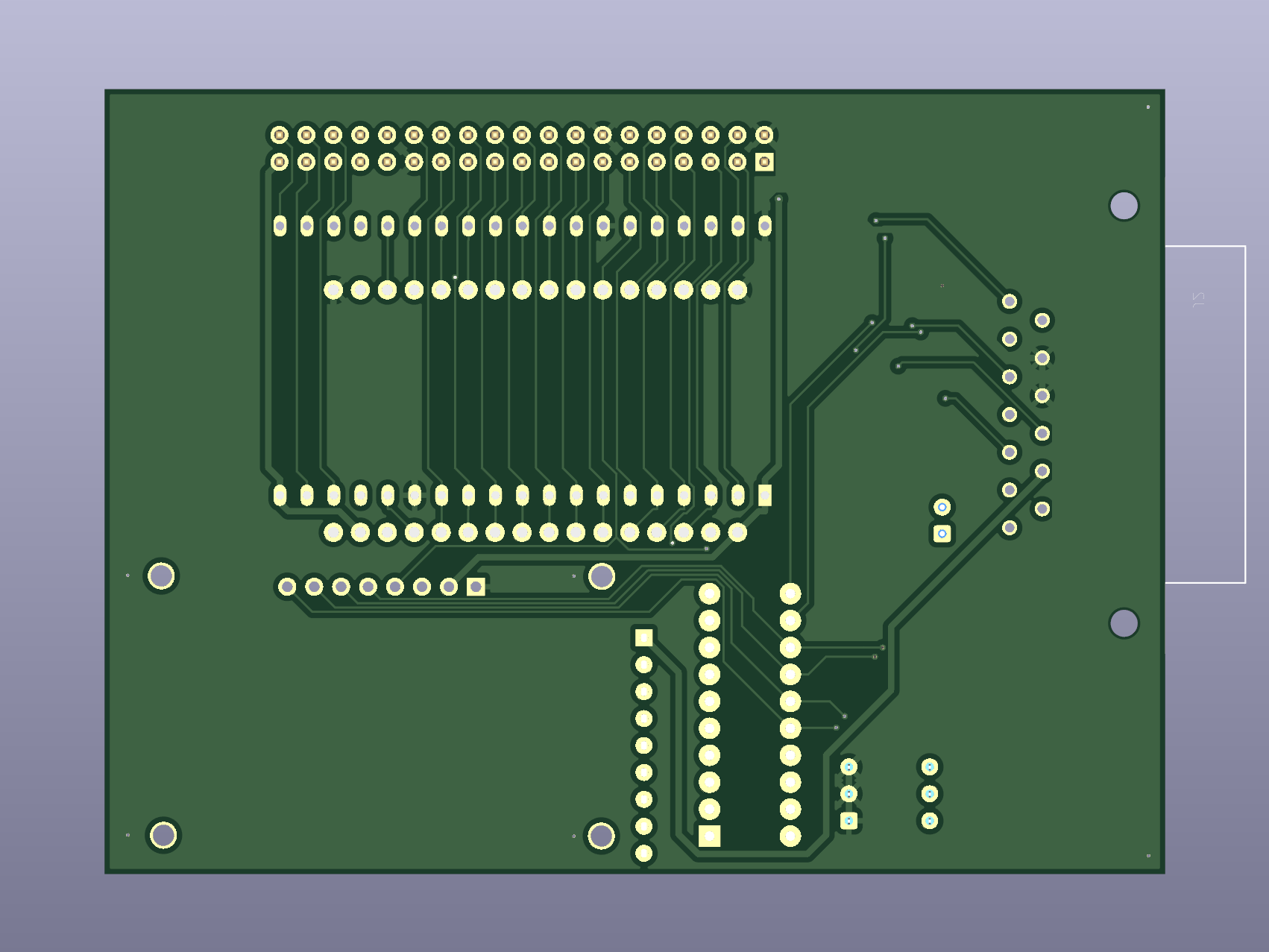

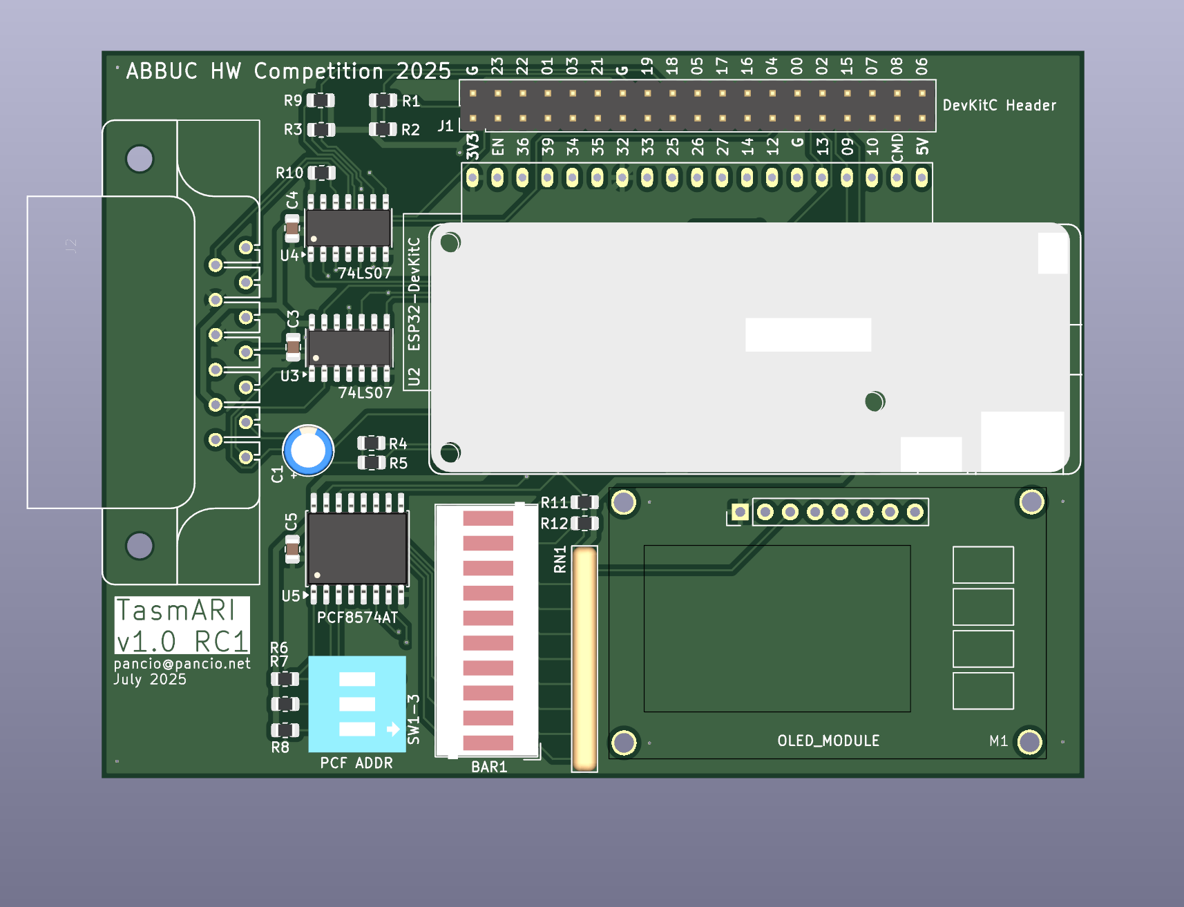

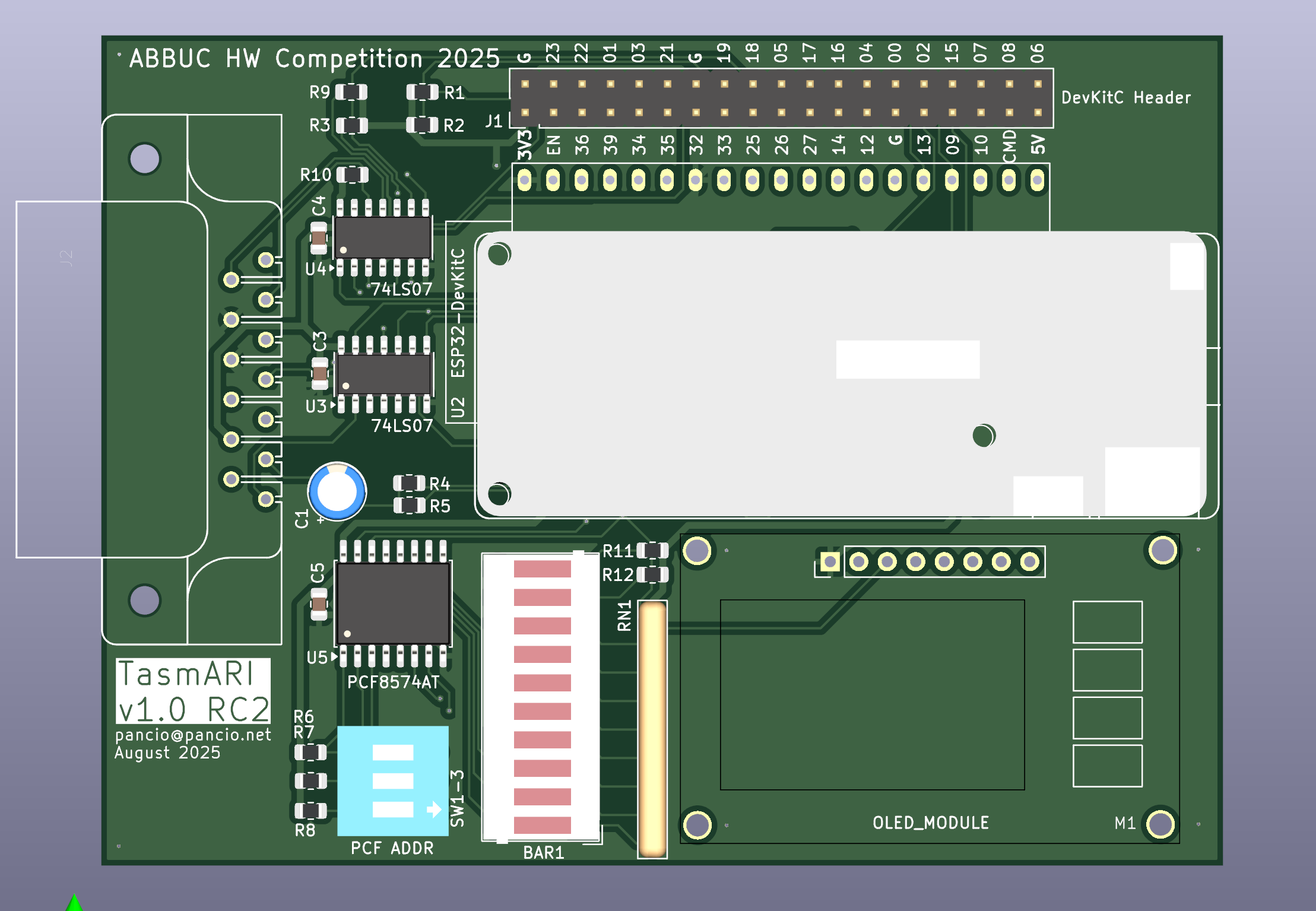

PCB-Visualisierung erstellt in KiCAD:

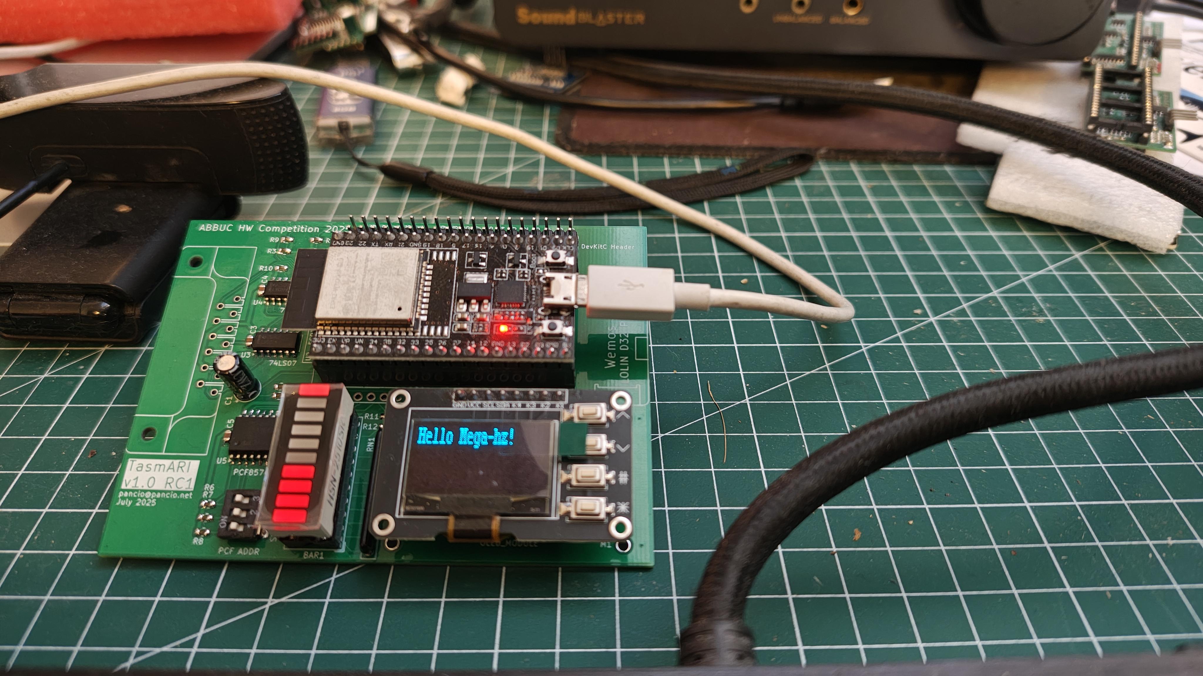

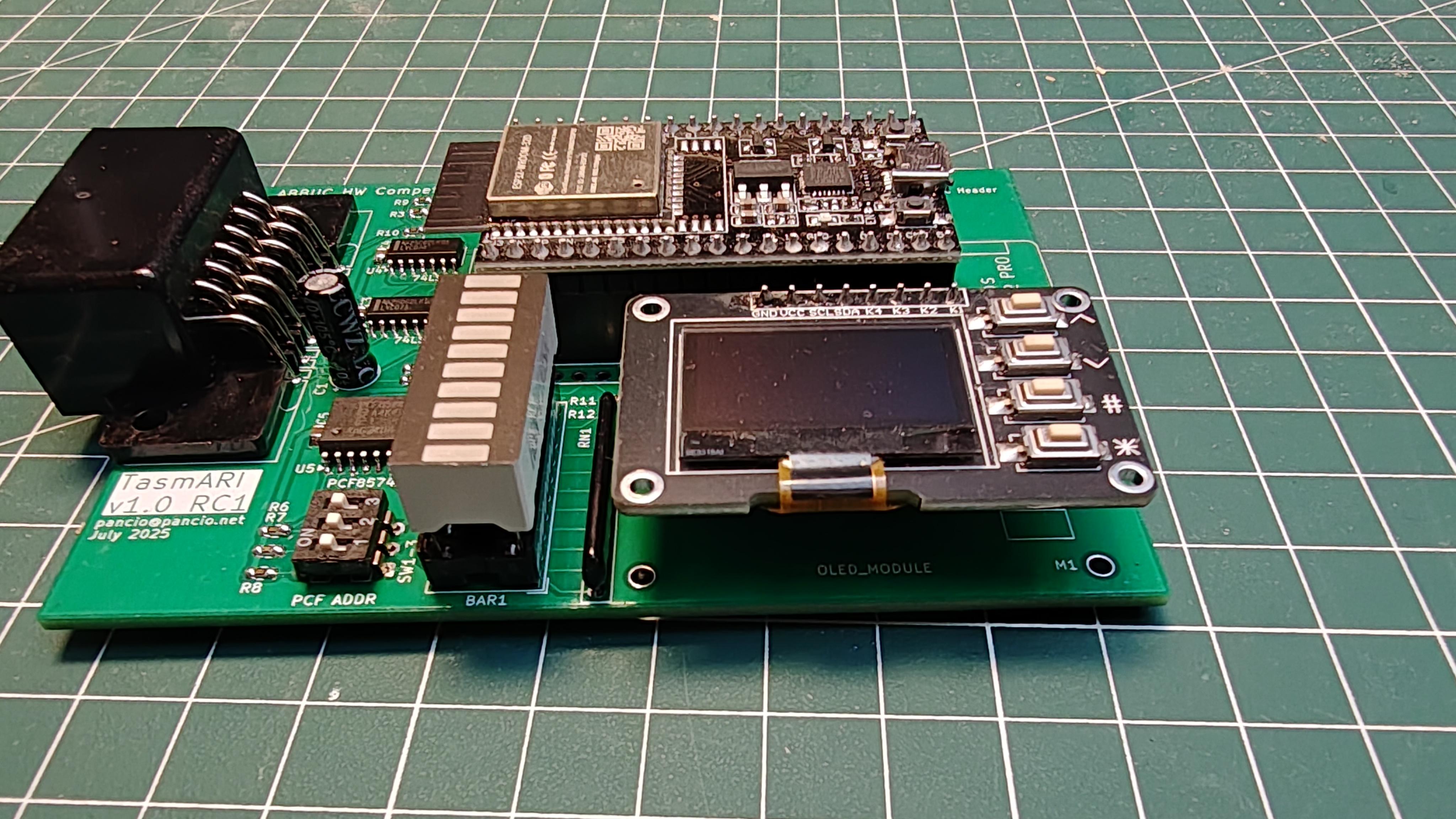

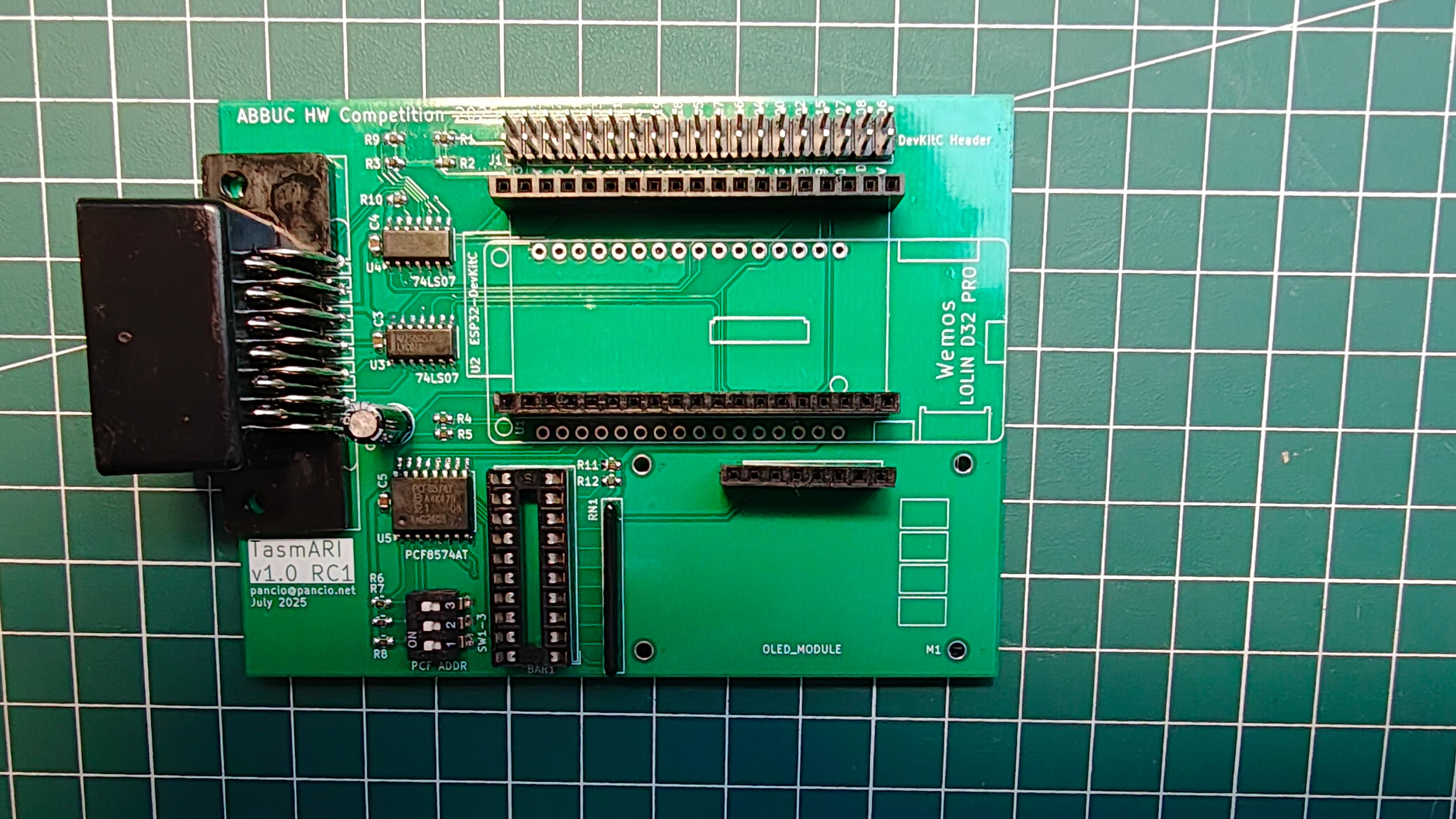

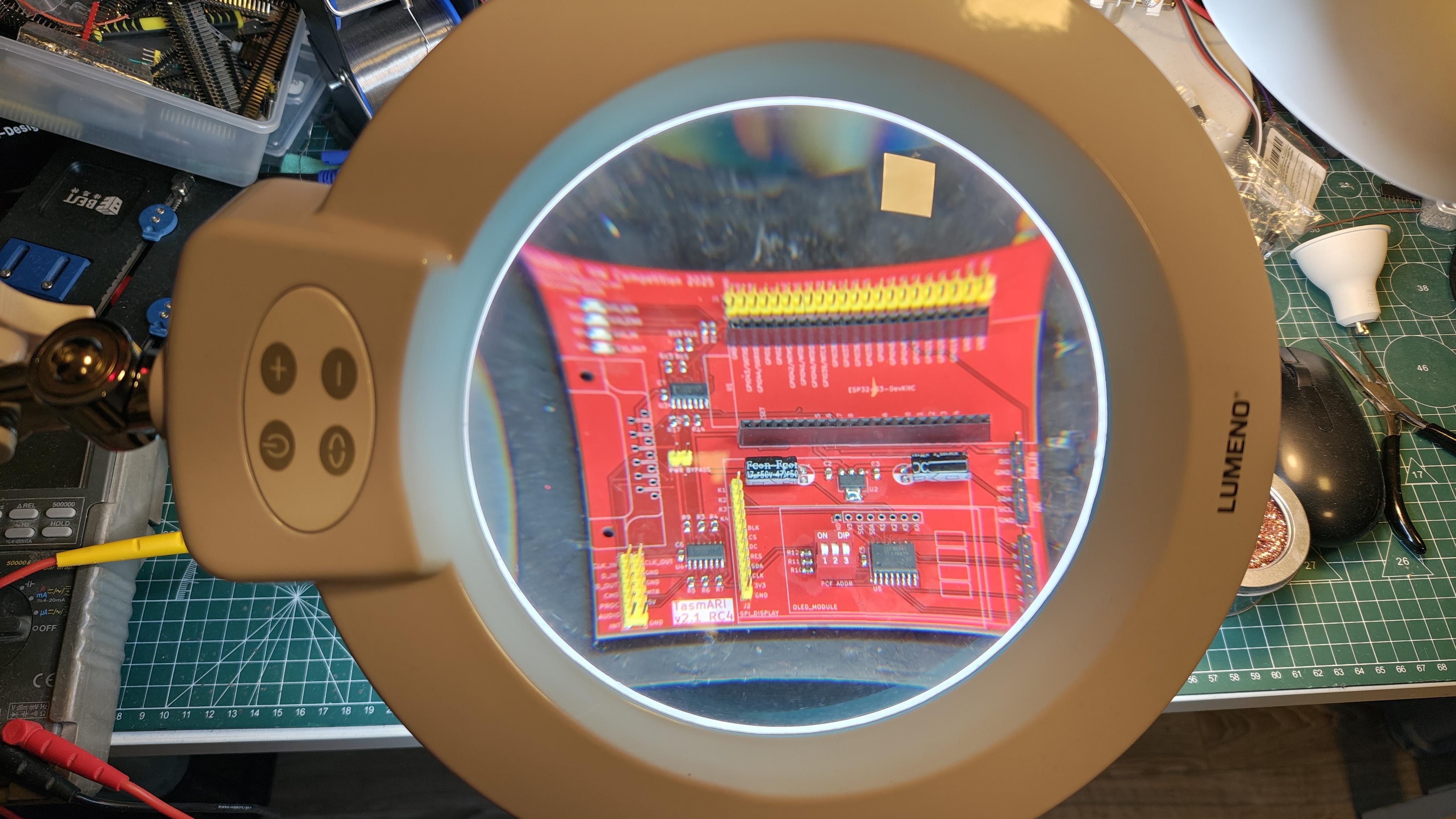

Und die fertige Prototypplatine, gestern geliefert und schnell zusammengebaut:

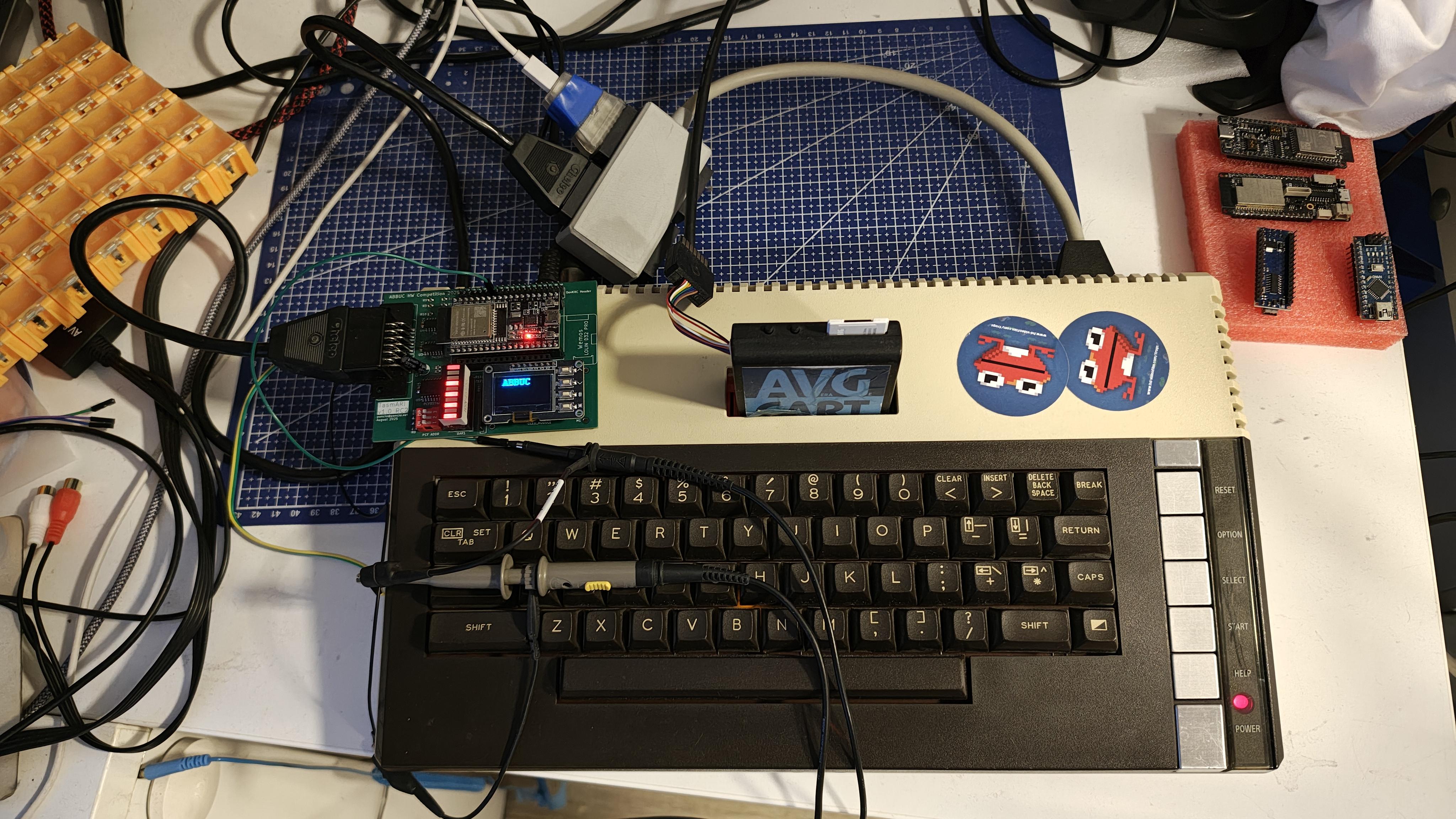

Erster Test (ohne Atari)

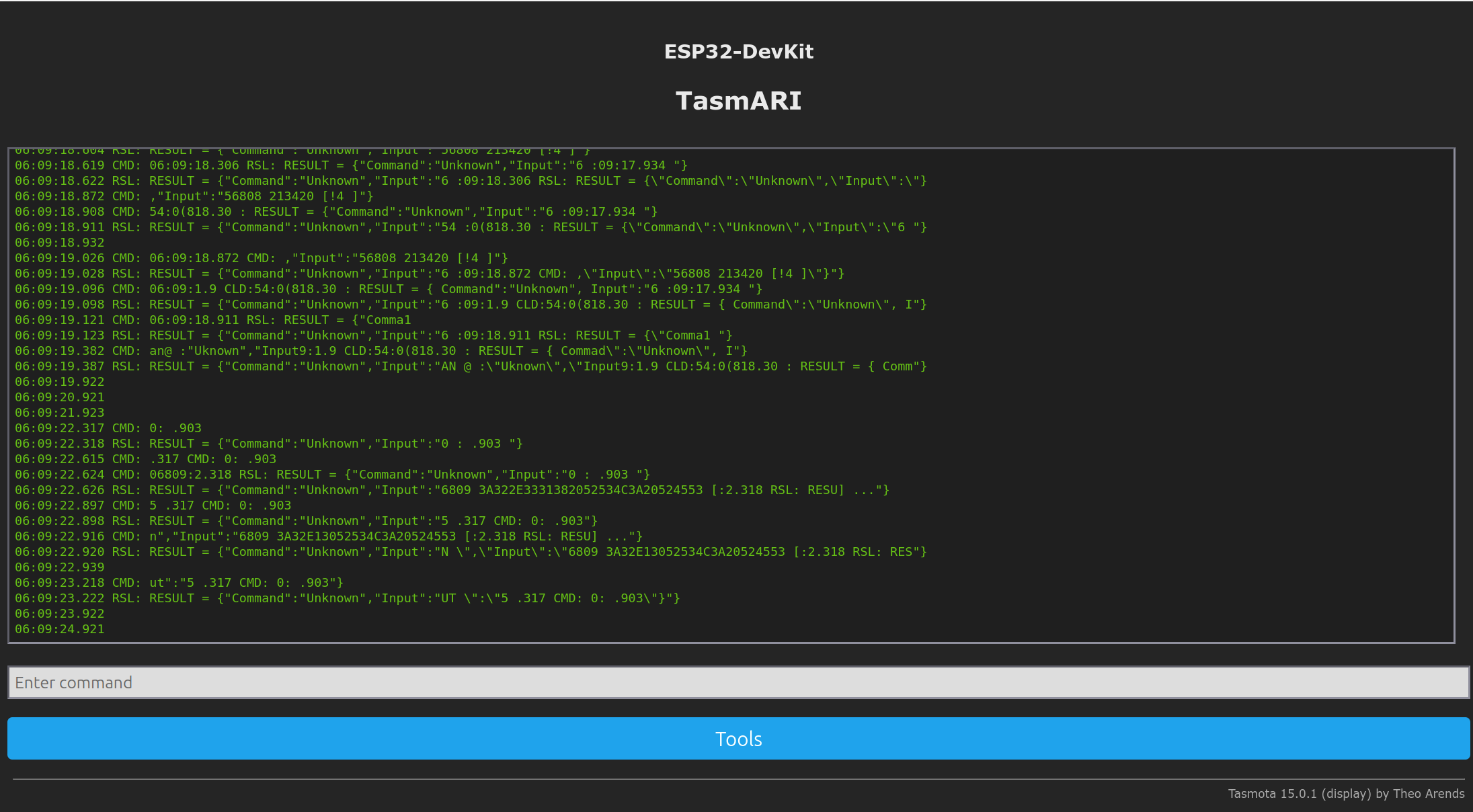

The principle I adopted for communication between Atari and Tasmota OS is very simple: a simple program in Berry listens on the serial port and everything that comes in is interpreted as a command for Tasmota.
This time, the Tasmota operating system surprised me... it turns out that in serial-bridge mode, which is used for communication between the Atari and Tasmota OS, it intercepts and attempts to execute everything that appears on the console, while I assumed these would only be messages coming from the Atari. Interestingly, when I use the ESP32 module without the Tasmota PCB, the problem doesn't occur! I again began to suspect strapping pins.
It also turns out that the problem disappears after 10 minutes and the Atari can take over communication with Tasmota OS! That's a clue – I already know that logging from the serial port can be disabled via the SerialLog option, but it's not very pretty... I'll have to look into this a bit more.

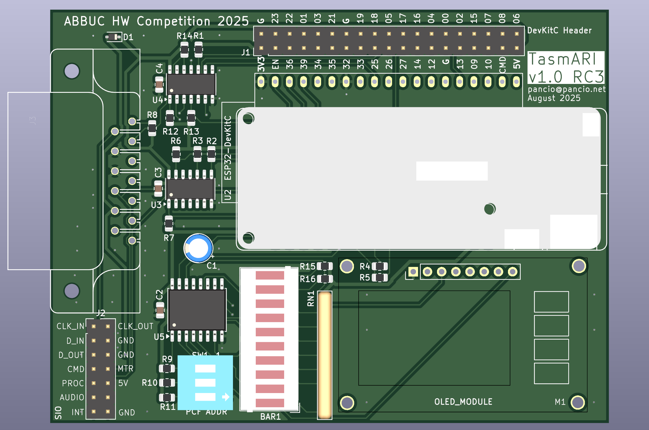

After reading a few pages of the ESP32 documentation, I rebuilt the wiring diagram, added some pull-up resistors, designed the RC3 version, and am waiting for the boards – they should arrive this week. We'll keep fighting :-)

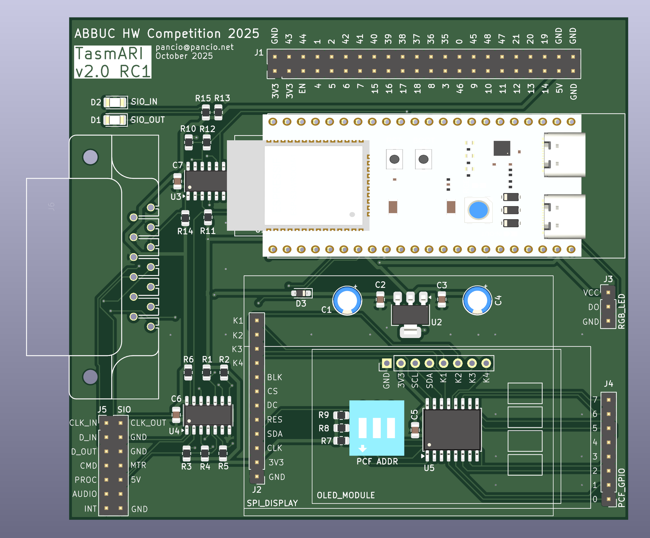

Just a quick update today regarding the change in the execution module. I decided to use the ESP32-S3, which has more features – especially more GPIO pins, which aren't specifically assigned to specific functions like the basic ESP32. The ESP32-S2 allows for greater operational freedom and easier development. Unfortunately, there's also a downside: the ability to play Atari sounds via the SIO_AUDIO input is gone (the ESP32-S2 doesn't have DACs). I'm not worried about this, though, because I can always add an external DAC via the I2S bus – which I'll do if the prototype works :-)
The current PCB is designed to support three different displays (two with buttons) – this will allow for greater flexibility in your own designs. I also dropped the LED bar indicators. Instead, I added a separate power supply :-)
