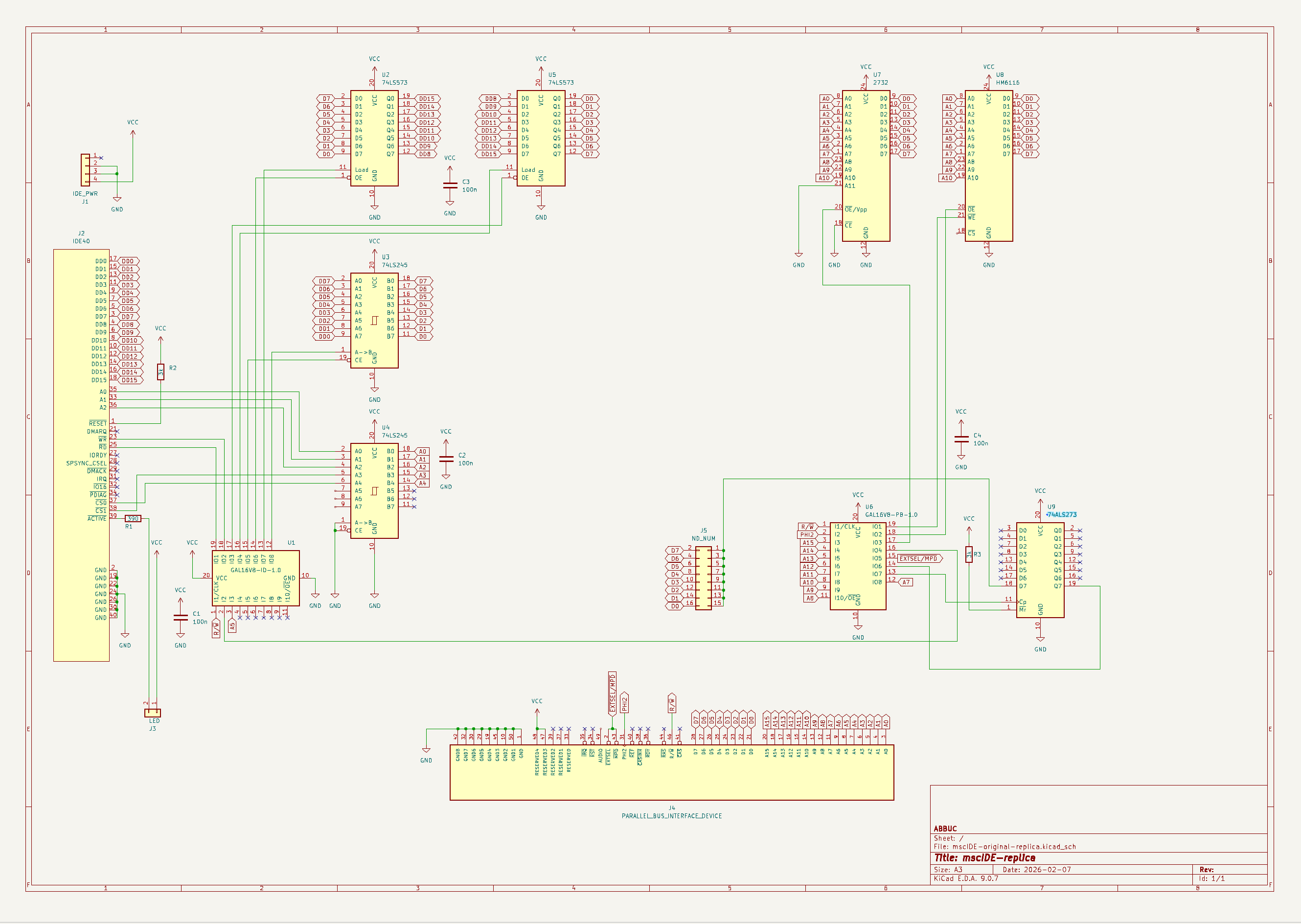

Hi Guys,
Could you please say something more about this device? I understand, it's general IDE which can work with HDD. Is it similar to existing devices like IDE+?
EDIT.
I forgotten.. some kinds of information I received from @Erhard in this topic:
viewtopic.php?f=3&t=1035
What do you thing.. maybe the short series should be made? With who I should contact to ask about details?
Best Regards,
EDIT.
Best Regards,

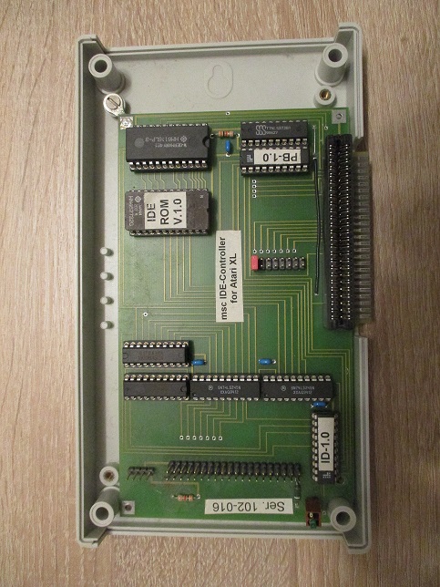

Re: MSC IDE Controller
I am trying to resurrect MSC-IDE but it looks like the computer tries to kind of boot (short noise pulse) and then hangs.
After a while the display list is corrupted and screen looses sync. Tried with and without cd-rom, (no hardddrives/CF yet)
power is supplied.... stock Freddie XL.
My plan is to read the eprom, both GALs, check ram on a PC using chineese reader/programmer, as those chips are usual suspects after almost 30 years laying in a drawer.
Somehow I was able to find just schematic, utilities and GAL content.
Is there a chance to get hold of the EPROM so I can burn it to new chip ?
- pancio
- Beiträge: 321
- Registriert: 31.08.2021 07:31
- Has thanked: 312 times
- Been thanked: 318 times
Two years ago I started replica of mscIDE in cooperation with FlopyDoc. Now I'm involved with a few projects but I want to return to it. Have almost all materials, docs, PLD images and ROM but need to again review project because during work I added some modifications. I suppose you don't want to make new PCB so probably with original PLD firmware/ROM will be work. Will find it in mid time.
Edit.
Found it.
BR,
pancio
Edit.
Found it.
BR,
pancio

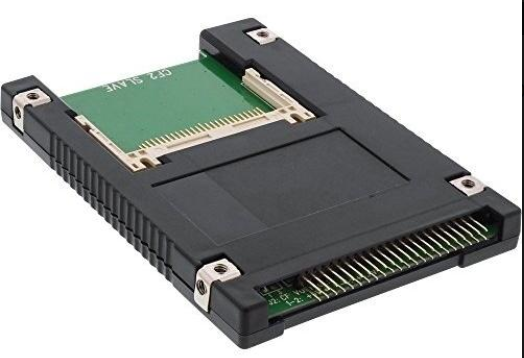

MSC IDE Controller
Btw, I noticed that modern stuff like SD2IDE or SATA2IDE Adapters to not work correct with an IDE+2.0 but CF2IDE does.
So it may be a good idea to exquip the MSC IDE with compact flash.
Best, Erhard
I suggest connecting the interface to an Atari, start a debugger (like Bug/65) on the Atari, switch on the PBI device by writing its address to $D1FF (?), write testbytes to Atari RAM and the controller's RAM and perform a compare. Do this in a loop.
Best, Erhard

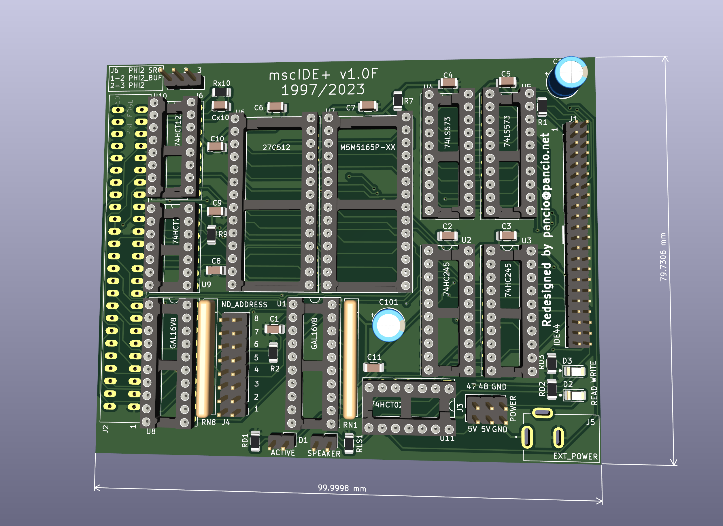

- Beiträge: 1343
- Has thanked: 162 times
- Been thanked: 433 times
MSC IDE Controller
I have an early version of Pancio's pcb and I can confirm that it worked in general.
There was a problem with the IDE bus in so far that due to maybe spikes on some chip select signal not all the IDE device bytes were read from / written to properly.
In addition LS bus transceivers worked better than HCT, if I remember correctly.
But I didn't have a CF card by then ....
I have no idea why your Atari does not start at all. Do all chips on the MSC have the correct orientation?
Does your Atari provide power to the MSC?
Best, Erhard
Best, Erhard
Update: the computer now boots after a delay (as expected), because I don't have my CF adapter yet and nothing is connected (and IDE cdrom as slave is not enough).
It looks like program inside the IDE connector GAL was corrupted, maybe eprom content too, but as resoldering and cleaning the ATARI BUS pads did not help
I had to to reheat the solder of all PCB components to make computer boot .
When the CF adapter arrives I will do further tests, but currently I have 3 different ROM files for the IDE board,
- The one I've read from the device - maybe corrupted.

I also used a cf2ide-adapter like this:
If I remember correctly, there were no problems with the hard drive starting up time during ATARIs bootup.
This MAY be due to how the EPROM was burned. Some burner software allows you to set how unused bytes should be set.
There may be two (identical) files; the data comes from two different folders in my archive where I have collected information I found about the msc board. It is quite possible that I saved a ROM dump with identical content under different names in the two folders.
Another possibility: If the identical file was in a zipped folder in the downloaded ZIP file, it is probably just the file from the “original ZIP file that I downloaded somewhere, now in the newly compiled ZIP file” that has already been unzipped (and I haven't deleted the original ZIP file). This is likely to apply to several files.
Another another possibility: I read one file myself, the other is from the msc-homepage.
I hope that was understandable and not too confusing...

It's as you say. Two years ago, Erhard and Walter and I worked on mscIDE. The project was intended to be a replica of the original solution, but we also considered modifications. Unfortunately, lack of time halted the work, even though a version was created and launched by Erhard. I'd like to revisit this topic someday because I really like the idea and the fact that it's based on NewDevice technology.
If anyone has the original version, I'd be happy to buy it... or borrow it from you for testing. Of course, you'll receive the replica for free for your help.

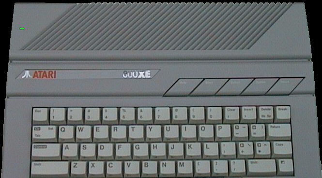

Ich hab einen XE, wo ein msc IDE inklusive HDD eingebaut sind und meine Erfahrung ist wie folgt:
1) HDDs brauchen relativ viel Strom, besonders beim Anlaufen, was auf das Atari Netzteil, den Ein-/Ausschalter und den Bootvorgang des Rechners Einfhluß hat
2) HDDs steppen. Beim Steppen brauchen die besonders viel Strom, weil die ja auch schnell steppen. Ergo extreme Spikes in Form von Sappnungseinbrüchen auf der Stromversorgung des Atari, was mindestens Bildflackern verursacht und durch Elkos in der Spannungsversorgung nicht wegzubekommen ist.
3) Der msc IDE adressiert in CHS. Bei vielen zuletzt erschienen IDE HDDs sind die CHS-Werte kaum noch in Erfahrung zu bringen, wenn sie überhaupt CHS können.
4) Die Größengrenze liegt bei 2 (oder 4 ?) GB, mehr adressiert der msc nicht.
5) IDE SSDs gehen auch nicht, sie funktionieren fehlerhaft am msc IDE. Vom Gefühl her kommen die schlecht mit dem unsauberen Bustiming des A8 mit msc IDE klar und verpassen dann entweder Bytes beim Datentransfer oder erkennen mehr Bytes, als wirklich schon gesendet wurden.
6) Mit einem IDE-SDcard Adpater funktioniert nicht einmal das IDE+2.0, mit einem IDE-CF Adapter dagegen hervorragend. Bei IDE-CF muß ja auch keine Protokollübersetzung stattfinden, da CF-Karten ja quasi einen IDE-Port haben.
Abgesehen davon sind allein größentechnisch CF-Karten hervorragend geeignet, mit auf der Platine untergebracht werden zu können und das paßt dann auch noch in den Rechner - vorausgesetzt, die (neue) msc-Platine hat eine entsprechene Paßform.
Das msc IDE war/ist schon recht cool, aber eine echte HDD zu verwenden ist keine gute Idee.

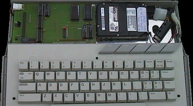

Hier mein XE mit eingebautem msc IDE, wie ich das damals gelöst hatte:

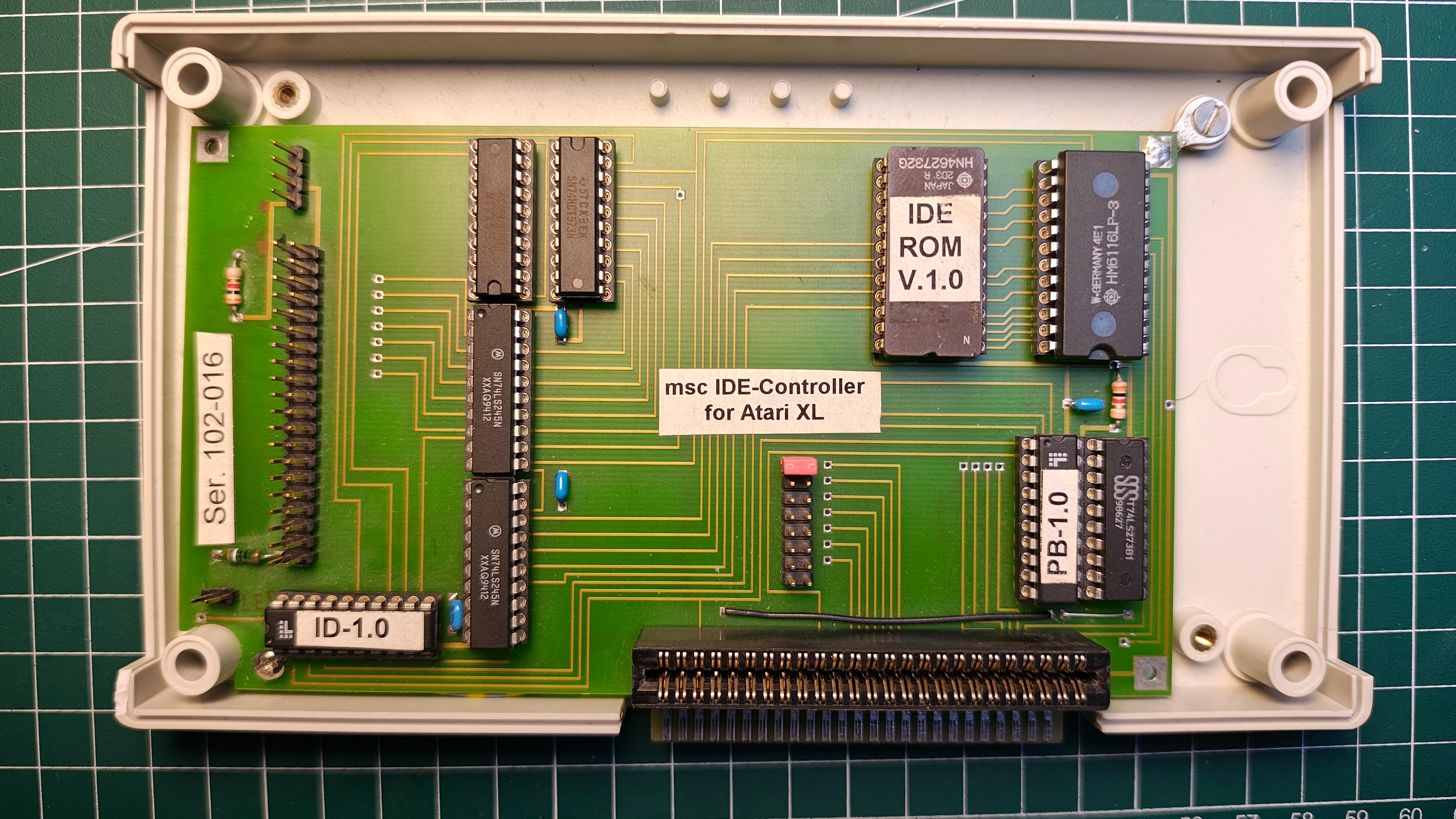

Good afternoon Guys,
Thanks to @Edelro, I had the opportunity to analyze the original mscIDE with serial number 102-016, which you can see in the first post of this thread. It took a while, but I finally managed to redraw all the connections. I also managed to make a copy of the contents of the EPROM and GAL chips.
I haven't had time to compare firmware with the ones sent above yet, but I definitely will, because at first glance, you can see that the chip in this version (1.0) is different from the one Erhard and I were working on. And since there are changes in the connections, the GAL firmware will also be different. I'm attaching the raw schematic and a dump of the chips. Perhaps it will be useful to someone at this stage.
For your convenience, the diagram shows the connections as the circuits are arranged on the board...
Best regards,
pancio
EDIT.
I used Gemini to disassemble the ID-1.0 JED. The schematic shows:
R/W Differences: Gemini claims that the fuse map sent by JED shows no activity for Pin 1 (R/Wˉ). This means that decoding occurs regardless of whether the processor is reading or writing data. Similarly, pin 4 appears in the equations but is unused!
this is very strange... or Gemini is wrong as he usually does...
