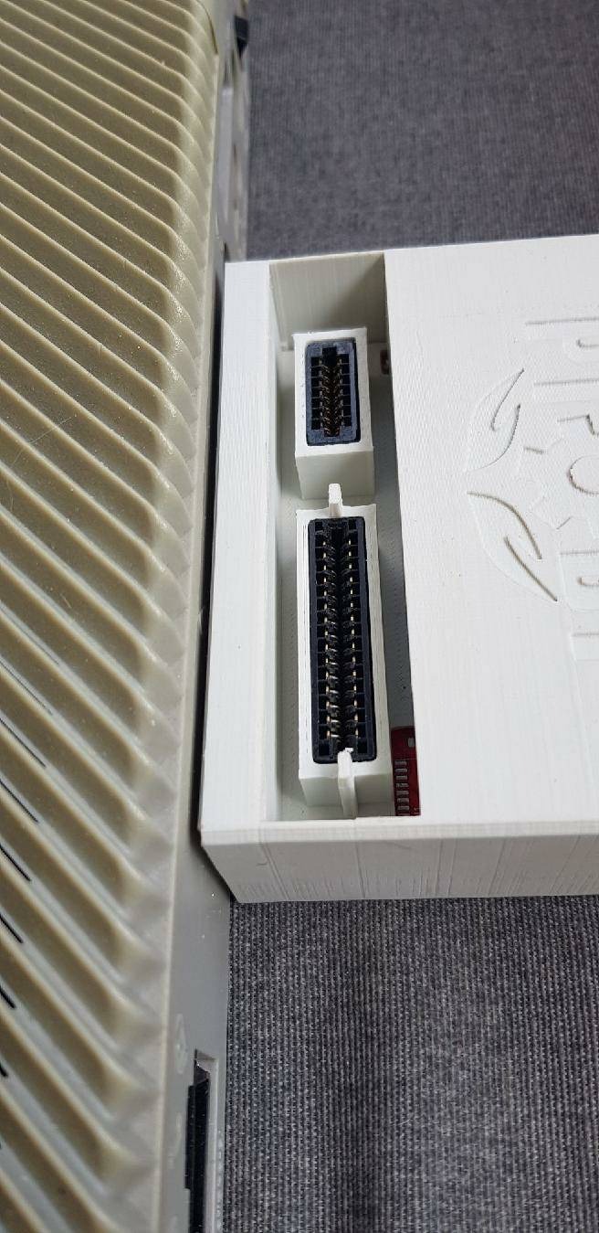

Re: MIDIcar – independent, easy to use MIDI player/recorder
Hi Guys,
Our friend Kkrys made prototype case for MIDIcar. Someone of Atari users might see it on Lost Party 2022 (Licheń Stary, Poland). Of course, this is only prototype... we will plan to design a few models available with other colors variants too The third photo shown that it's possible use MIDIcar with external memory expansion (512kb in case) so you don't need to modify stock Atari to enjoy most midi files
Regards,
pancio
Regards,
pancio

Hello Friends!
I know... so much time... but it was happened MIDIcar for XL computers It's very stable and working without any issue with IDE+ under SpartaDosX...
Enjoy!
Enjoy!

Hello Pancio
Just this weekend I was thinking that we hadn't heard from you in a while.
The MIDI Thru port is very close to the video cable. Won't that cause any problems if somebody tries to use plug a cable into the MIDI Thru port?
BTW have you tried to plug one MIDIcarXL into the back of another? And a third into the second?
Sincerely

Hi Mathy,
Yes... sorry I know - hobby is very important but family too The reason why XL version was made is that I don't know when I'll finish common model for both XL/XE with additional middle board as we discussed in other very good topic: viewtopic.php?f=3&t=1035
So, gerbers and full project files is available on my page - anyone is willing to do it by himself. I'm not sure, XL version will be made by us and available in shop. I may prepare three modules because have a free PCBs from prototyping process. If anyone is interested in - let me know privately.
According to MIDI ports positions... well it's compromise between PCB length and usability... there is no issue with connecting passthru cable but it's looking little bit strange
not yet... because I've only one MCpbi assembled at this moment. Will try, be sure
Regards,
pancio
