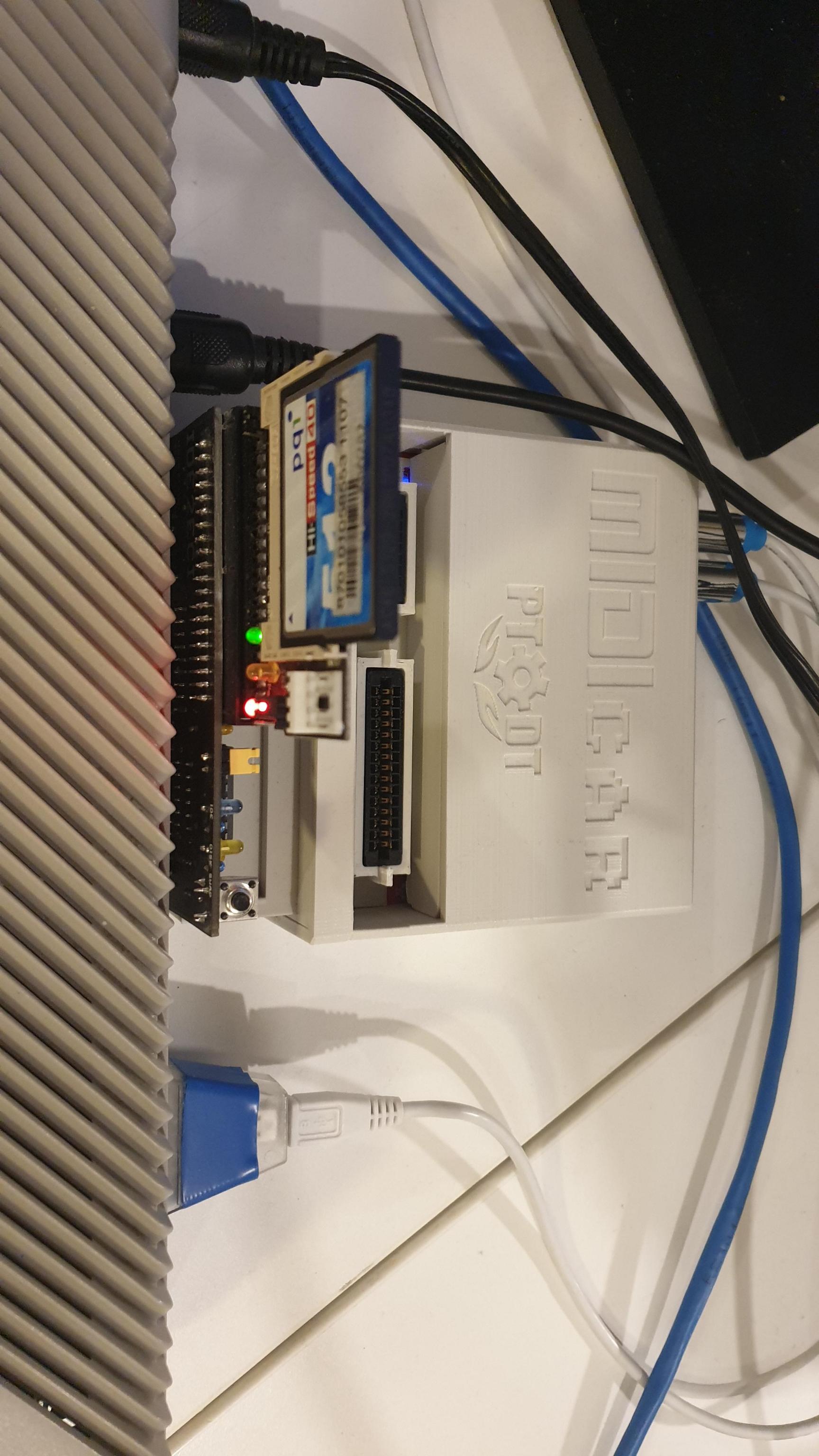

As you said, it's very good to have two or more stacked devices to be more convenient. For example, MIDIcar + IDE2ECI + U1M = very good set and working fine. But if I tried to use external SpartaDosX cartriodge, AVGcart or SIDE2 with verically slot in MIDIcar - ATARI doesn't recognice it. I'm very frustarted because MIDIcar hasn't any components in conflict with listed above devices. So, only one thing which I should consider: Power and signals distribution... Probably used by me wires thikness is too small (0.4mm for signals) and 0.6 for power. That's fact - big FPGA might consume more power as we suppose... In case, I made oter PCB with much more thikness wires and I'll confirm (or not) problem solution.
The other question which we should consider is to build buffered bus for each signal. I did it in the past with partially success, so maybe it's time to return to project? :-)
Working fine:
- IDE2ECI (very cool, very fast data load from CF)
- Freezer 2011
- SYSCHECK 2.2
- Zaxon's RAM ext.
Not working at all:
- SIDE2
-AVGcart (I need to solve it!)
- UNOcart
-SpartaDosX cart

maybe I can try to help with the SDX cart since I own an original.
I guess your setup was like the MIDIcar plugged into an XE and the SDX plugged into the MIDIcar's cart slot?
What exactly does happen if you boot the Atari this way? For example does it boot correctly and just works like SDX was not plugged-in or does it lock-up somehow?
The first things I would check is:
- does SDX work correctly if plugged-in directly into the XE?
- how are the contacts of the SDX cart (gilded or tinned, clean)?
- power off things, open Atari, connect MIDIcar but not SDX, measure cartridge slot contacts for 1:1 connection from inside Atari and module slot on MIDIcar (do not rely on schematics or other things working properly)
My SDX formerly caused problems because it had a faulty PAL which only worked at certain temperatures.
In addition SDX was very susceptible against dirty contacts and cleaning those with alcohol or a rubber helped a lot
The contacts in the XE's ECI and cartridge slot get oxided very often (I wish they had used gilded contacts). Get yourself a bit of cardboard, fold it as thick as a pcb is and clean those contacts by pushing the cardboard into the slots in and pulling it out several times (DO NOT MOVE SIDEWAYS). You will see dark grey stuff on the cardboard.
Did you put sufficient capacity on the MIDIcar's chips to minimize noise on the power lines (like 100nF ... 470 nF near chips' Gnd and Vcc terminals)
What address space does MIDIcar use? I may have a SDX PAL fuse file to reassemble and check against.
Kind regards, Erhard

General, MIDIcar is plugged directly to Atari. If you plug other device like Sparta or AVG, computer is going to standard reboot process (doesn't see cart). I tested this configuration with other cartridges... e.g. from 80'-90'years - many works properly. That's I suppose it's issue with power distribution. It will be much more easier if you will see schematic but unfortunately I can't distribute full data before ABBUC HWC. Just after final I'll do it.
According to PCB design. Yes, I used 100nF capacitors for all ICs close to power lines. MIDIcar can use addresses from on $D1XX and $D5XX with $20B window - base address is fully jumpered. So we have no conflict with Sparta at all.
I'll prepare some parts from design and will show these just after work for better view.

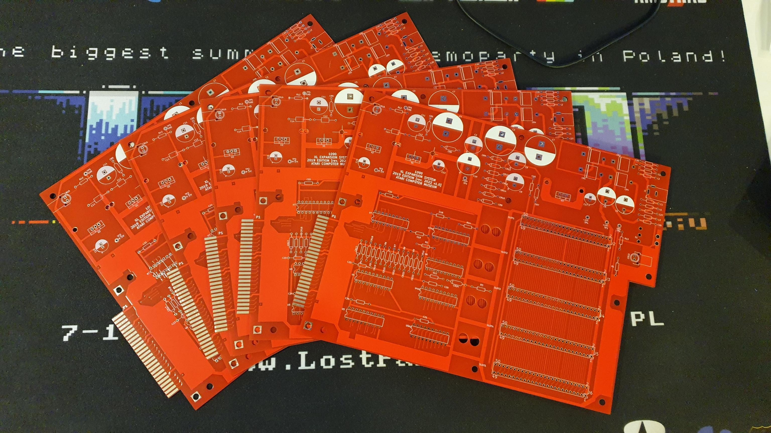

Are you thinking about PBI device mapping implemented in Atari? No, MC using only two addresses from $D1XX or $D5XX. Follow attached schematic from VIAtari or VIAtronics - similar method I use with MIDIcar:
There is only one address area used by MC, depend on CCTL/D1 chosen on addresses bus.
I added some thicker connections with version 1.0.2 and drop GND fields between signals. I hope it will be enough. I'm waiting for PCB (on way from China):
Of course v1.0 and v1.0.1 has thinner connections...

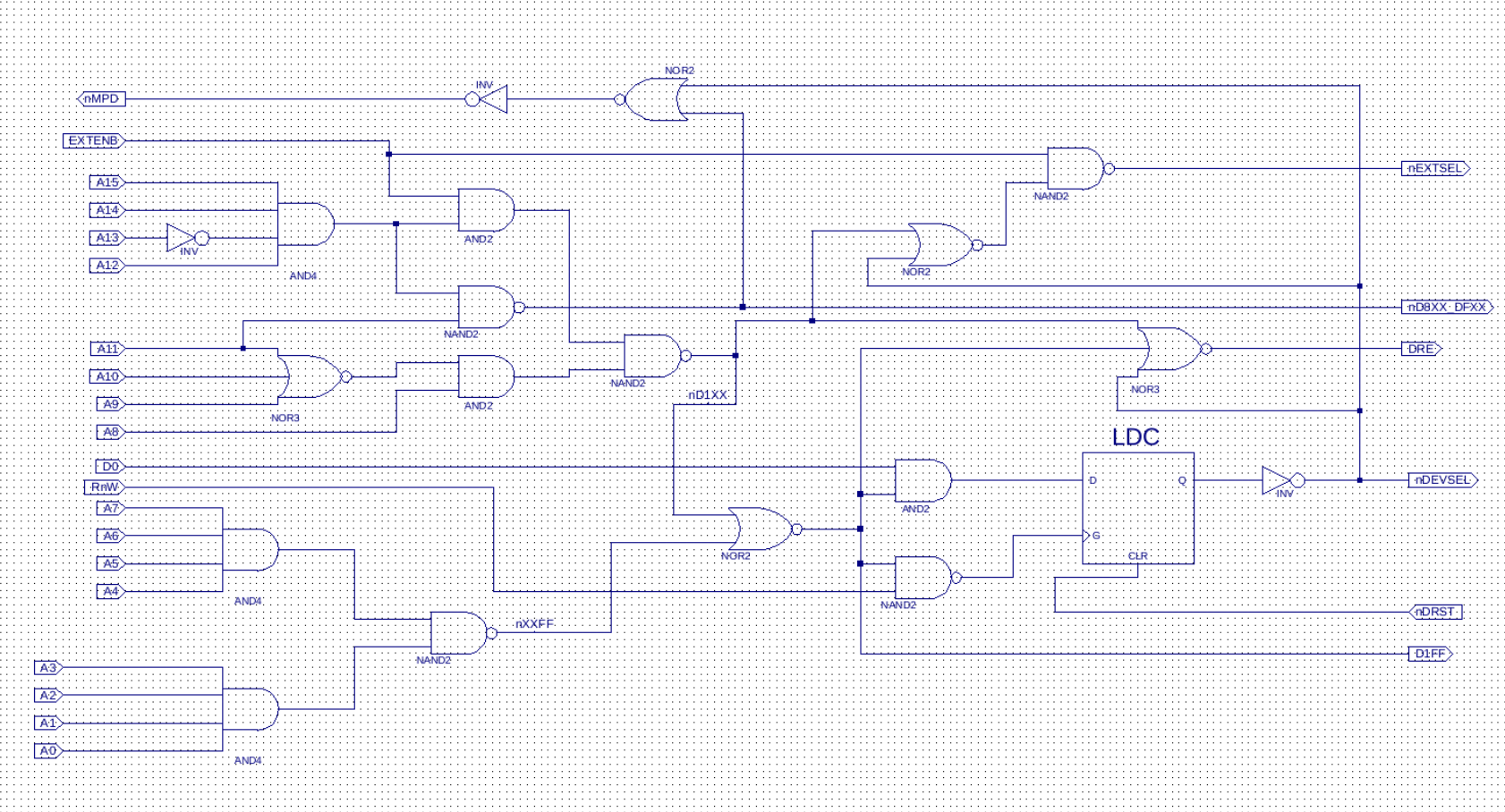

If you see the schematic from https://abbuc.de/forum/viewtopic.php?p=9827#p9827 on the left side you have jumper J10 - it's base address for MC you may use only one $D1XX or $D5XX. I realize that using $D1 I might conflict with some kinds of devices using this page for his own registers but there are very rare and not occupied all addresses. That's a reason why I used 8 $20B areas to choose. Probably no one have so many devices connected to PBI (and using 'new_device' technology). Moreover, MC is very simple device connected like any other 65/68 chip to the bus which is visible by two registers only. I'm not using additional ROM and NEV_DEV initialization (especially I'm not using PDVREG ($D1FF/W) to init NEW_DEV) because MC isn't NEV_DEV at all. Additional fact why I'm using D5/D1 is that those signals are available on CART/ECI slots, so the decoder was very simply to do. In near future I'll prepare MC CART only so only D5 will be available...
There is little bit better situation for PBI - in case we haven't signal /CCTL ($D5) and I decided to build full decoder, so it's possible to use other than $D1XX, $D5XX base address like mentioned by you $D6XX. I'm afraid about backward compatibility with MIDIcar (CART/ECI) because PeBe's player checking only D5 and D1 base address....
I'm not an expert with ND technology but if it's easy enough to do I'll adopt this to my future project. I would like to invite anyone to participate :-)

Could you try using D6xx with MIDIcar for a test against SDX? I guess a signal is available on the ECI.
that's my fault. D6xx is only available at the ECI using the new 130 XE rebuild board.
pancio hat geschrieben:
17.10.2022 19:08
I overlooked that this is a jumper. I took that two inputs. But now that is clear.

Okay... I read provided by Hias materials and I stared modeling my own ND... Actually shown in Antic's articles project is little bit similar to MIDIcar (according to functionality). At first I'll try to build logic for ND based on XC9572XL Xilinx FPGA:
ND_LOGIC
ND_LOGIC
It's my first time to use XILINX ISE software so I hope not so many issues will appeared :-)
Next step is design schematic in KiCAD with MIDIcar based on:
ND_ROM
ND_ROM
First question...
On schematic above we have input signals:
  • /D8XX-DFXX - should be connected to nD8XX_DFXX
  • FROM DEVICE ENABLE LATCH - should be connected to nDEVSEL
  • /D1XX - should be connected to nD1XX but this signal isn't generated by logic section! Shall I add additional output from FPGA (the /D1XX is available inside logic) or it's typo?
rest signals are clear and easy to connect :-)
For better view I attached all articles as one PDF...
THE PARALLEL BUS REVEALED.pdf
(350.39 KiB) 221-mal heruntergeladen

your schematics look more complicated than I remember from the mscIDE controller, but that is maybe due to each gate been drawn indiviudally.
Below please find some -kind of- schematics I once drew from the mscIDE. You can compare it to what your circuit does.
msc IDE schematics (unverified)
Please note that the PBI device ID may be selected by a jumper field that connects one data line of [D0...D7] to U9-Pin18
Best, Erhard
Wenn man sein Alter hexadezimal angibt kann man gleich wieder Bäume ausreißen :-)

Hi Erhard,
Shown by me logic for NDPBI is mirrored from the original Antic's article. I implemented it into FPGA because too many discrete gates in original. Presented by you schematic looks much more simple and looks easier to understand. Can I adopt it to my project as a base for PBI ND? I see two PAL/GAL 16V8 ICSs.. could you please show rules or logic inside?
Regards,
