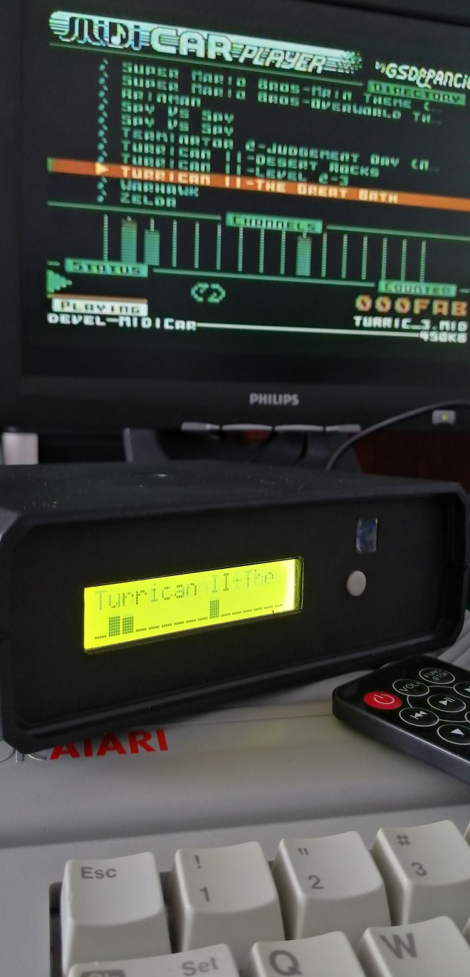

I'd like to introduce you to a gadget that is quite closely related to the world of MIDI and the MIDICar device - but not only.
MIDI Remote is an external device whose main purpose is to be able to control MIDICar Player (in its latest version) via remote control. In addition, it also allows you to present the title of the currently playing song, and visualize the MIDI data stream you are listening to.
It uses the MIDI protocol for communication, which is natively supported by MIDICar or via the SIO connector, allowing it to be used with other MIDI devices, such as MIDIBox or MIDIMate.
The remote control can be used to control program functions such as Play/Pause/Stop, next/previous track, type of song/list looping (loop mode), moving through the list, changing equalizer parameters for DreamBlaster S2 (volume, low, mid, treble)
Summary
Type of device: Gadge
Purpose: Atari 8-bit, MIDICar Player >=1.6.
Compatible with devices: MIDICar, MIDIBox, MIDIMate.
Available connectors: MIDI-In, MIDI-Out, SIO (in the form of DB9 socket - I had one).
Other: LCD display, IR receiver+pilot, function button :)
Power supply: 5V from SIO connector or external DC power supply.
Current consumption: 45mA (35mA when, backlight is off).

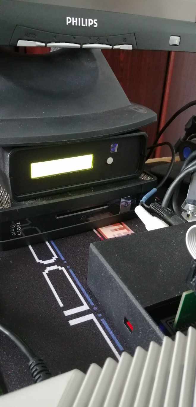

Some images of the final version:
Gadget listens :)
Gadget listens :)

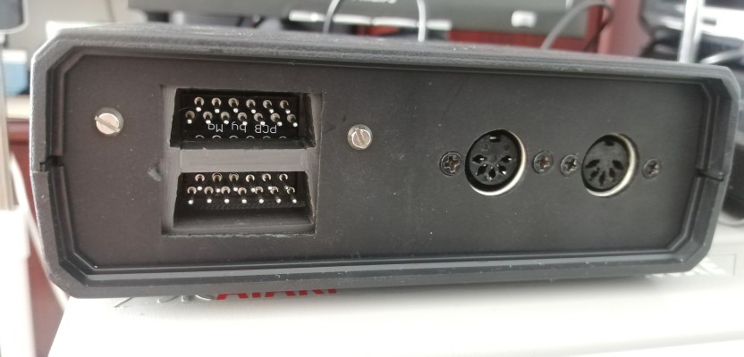

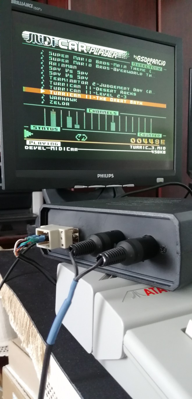

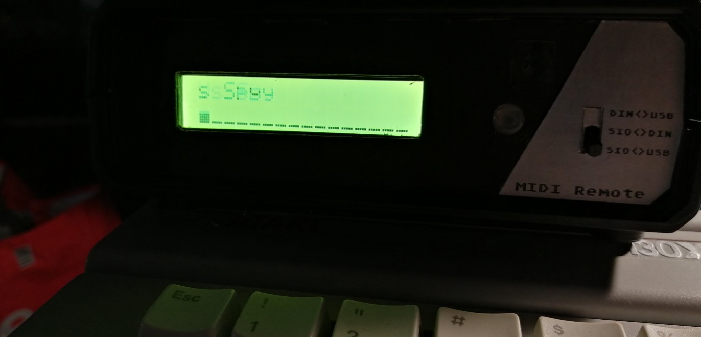

From left: SIO in DB 9 :(, MIDI-In and MIDI-Out jacks.

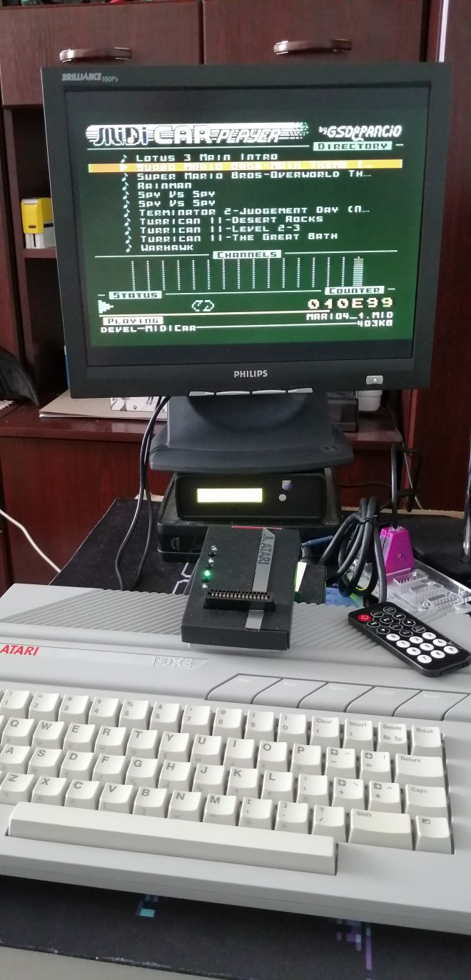

Portrait of the set :)

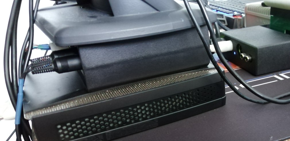

Probably the best place for the gadget ;)

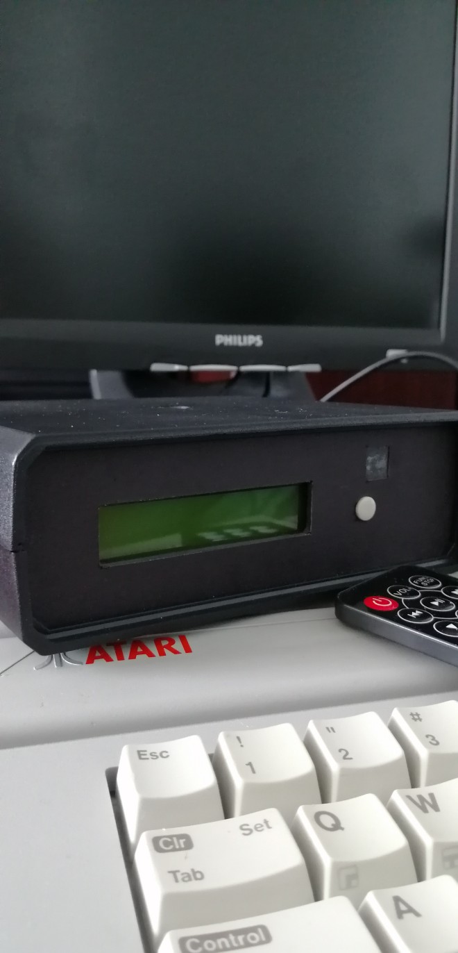

A side view on MIDICar Remote and MIDICar :)

Hello PeBe
PeBe hat geschrieben:
19.07.2023 17:46
Sikor is selling injection moulded SIO connectors. BTW two connectors would be even better. :mrgreen:
Sincerely

So far, I'm making everything from the resources I was able to gather when there was still work. For now, demonstratively, it has to be as it is :( Well... If you don't have what you like, you like what you have ;)
I understand. But will there be a final version with (two) SIO ports? And will you sell a ready-to-use product or will you publish the files we need to reproduce it?
Sikor is selling injection molded SIO connectors. BTW two connectors would be even better. :mrgreen:
I thought about it. I used a small splitter from Mq and with an enclosure (I think) from KKrys. I made a crazy construction on which the whole thing somehow holds together :P
There is a bit of slack, but the SIO plug goes in :)
Now I can polish the whole prototype of the SIO sockets in MIDI Remote.
It will look very respectable :D

That looks very nice already. But wouldn't it be easier to remove the SIO plugs from the SIO connectors if the connectors would be next to each other instead of over each other?

Mathy hat geschrieben:
20.07.2023 21:09
As this is a prototype, I had to (I'll repeat myself here) choose from what I had available (but in such a way as not to destroy it) and, in addition, adapt to the housing I had.
Perhaps you are right that the sockets being next to each other gives more comfort in handling the plugs. Well...
When designing a case dedicated to a gadget (in 3D), one can be tempted to refine it better.
The same goes for the front of the gadget. The function button, too, should have been done differently.
It was to be a fixed part of the casing, with a "U" shaped notch that, when the device was switched on, was illuminated (the diode for this illumination is physically in the device).
As you can see, there are quite a lot of design ideas, but the lack of resources to make them, causes some to be abandoned.

I fully understand your situation! What I am trying to do is get the final release as easy to use and as good looking as possible. That does not mean that you have to build it like that. But it would be nice if the PCB gives us the option to realize it like that.
Sincerely

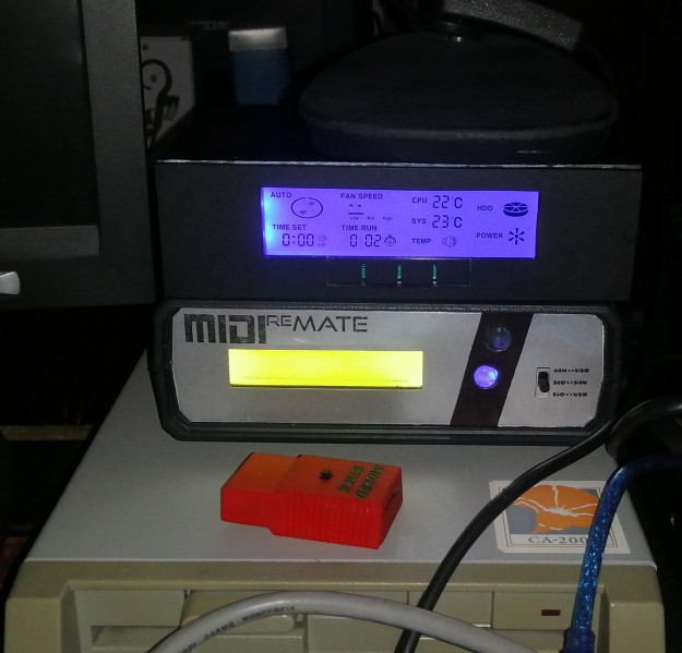

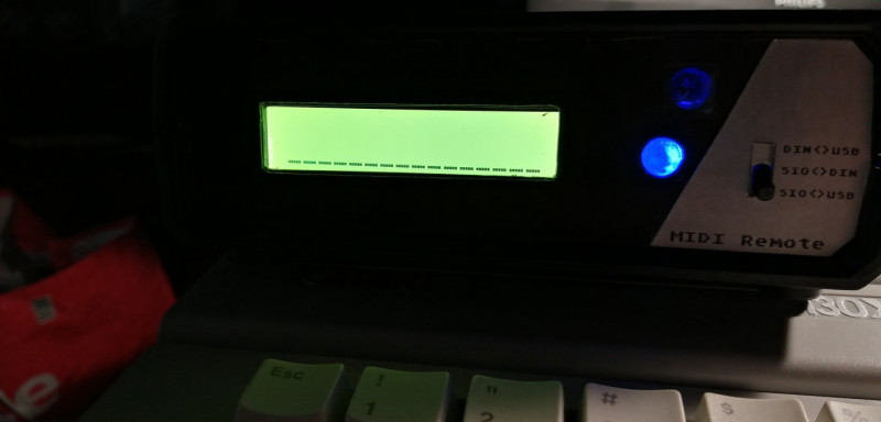

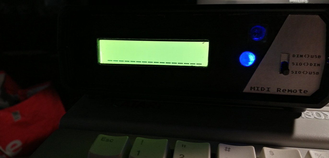

  • DIN* <> USB
  • SIO* <> DIN
  • SIO* <> USB
The Remote option is only available for the connector with an asterisk. In addition, modes with USB retransmit data from the source at 115200 bits/second. In SIO<>DIN mode, the speed for both connectors is the same and is 31250. I don't know if other speed settings are needed - you can always add such an option if you need it :P The change of interface is signaled by an appropriate message and a quick dimming of the function button.
In addition, this button (its backlight), indicates whether the MIDI Remote is processing any data, such as remote control or data transmission. This is announced by a slow flashing of the backlight.
The interface works wonderfully with PC software (via USB connection) giving unnoticeable latency (<2ms) Some fluctuations may be audible to the trained ear, but I'm working on eliminating them.
Soon I will try to prepare a video with a short presentation of the changes made.
Greetings to all, PeBe
