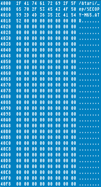

Command $DA is named "Get Device Slot Filename" which is not correct as the command returns the filename along with the path (without device).
result of command $da

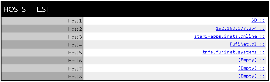

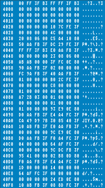

Command $E0 does not work for me as it seems to return garbage. If I understand the description correctly I would expect a certain device slot's contents. Maybe I got wrong what should be returned. In that case please explain the command and data meaning.
host list from web ui
result of command $e0
Command $FE does not return 33 bytes for the SSID but 32, so we get 96 bytes, the 97th being the checksum.

reading your comment about what I found out about command $E0 I am not sure if you are saying that the gibberish I got as a result is a correct answer or not.
Best, Erhard
tschak909
Beiträge: 249
Registriert: 17.08.2021 00:22
Has thanked: 5 times
Been thanked: 204 times
Re: FujiNet Atari Tools
Beitrag von tschak909 »
It should be blank.
It's a good idea to run the FujiNet flasher, and to turn on the monitor, so you can see commands that go to the FujiNet and how it responds.
-Thom

host prefix
I am not sure if I understand what the "host prefix" is. Maybe if you gave an example?
@Dietrich
Dietrich hat geschrieben:
18.08.2022 17:26
you can use command $f4. This returns 8 paths
I am merely looking for a command, that returns the contents of a single given host slot ... maybe there is none which would mean that no URI can be longer than 32 bytes?
Best, Erhard
Dietrich
Beiträge: 120
Registriert: 20.09.2021 20:59
Has thanked: 20 times
Been thanked: 79 times
Beitrag von Dietrich »
Yes, there is only command $f4 to get hostnames - and this returns all hostnames. So I suppose, hostnames can't be longer than 32 chars (or maybe 31 chars + string terminator $00).
"Host prefix" means only the prefix for all relative filepaths, i.e. the current directory. FCD sets this, and all file/directory commands use the current directory.

The Get Host and Set Host prefix commands were intended to be used by the FCD command.
Given a host slot, it sets the prefix for that host slot. This means that any path you put there would automatically get prepended to any host slot command (such as FLS or FMOUNT), so that you don't have to type the whole path when using FLS, FMOUNT, etc.
-Thom
Beiträge: 1264
Registriert: 04.11.2021 15:52
Has thanked: 155 times
Been thanked: 396 times
FujiNet Atari Tools
Beitrag von Erhard »
it must be very difficult to provide an example ...
Are you saying that I can set a certain host slot to
a8stuff.somedomain.tld
for example?
If so I do not understand why the command supports 256 bytes of data regarding the fact, that a host slot entry can be no longer than 32 bytes.
tschak909
Beiträge: 249
*deep-breath*
because it's not meant to hold a hostname.
It's meant to hold a path.
e.g.
FCD 1,/Games/Action/Atari/
this would send a $E1 command to the fujinet with the string
"/Games/Action/Atari/"
so when you did an FLS 1,*
it would automatically prepend /Games/Action/Atari/ to the path to give
"/Games/Action/Atari/*"
or for FMOUNT:
FMOUNT 1,1,R,Defender.atr
It would actually use the filename:
"/Games/Action/Atari/Defender.atr"
This is why the buffer is 256 bytes long.
-Thom
