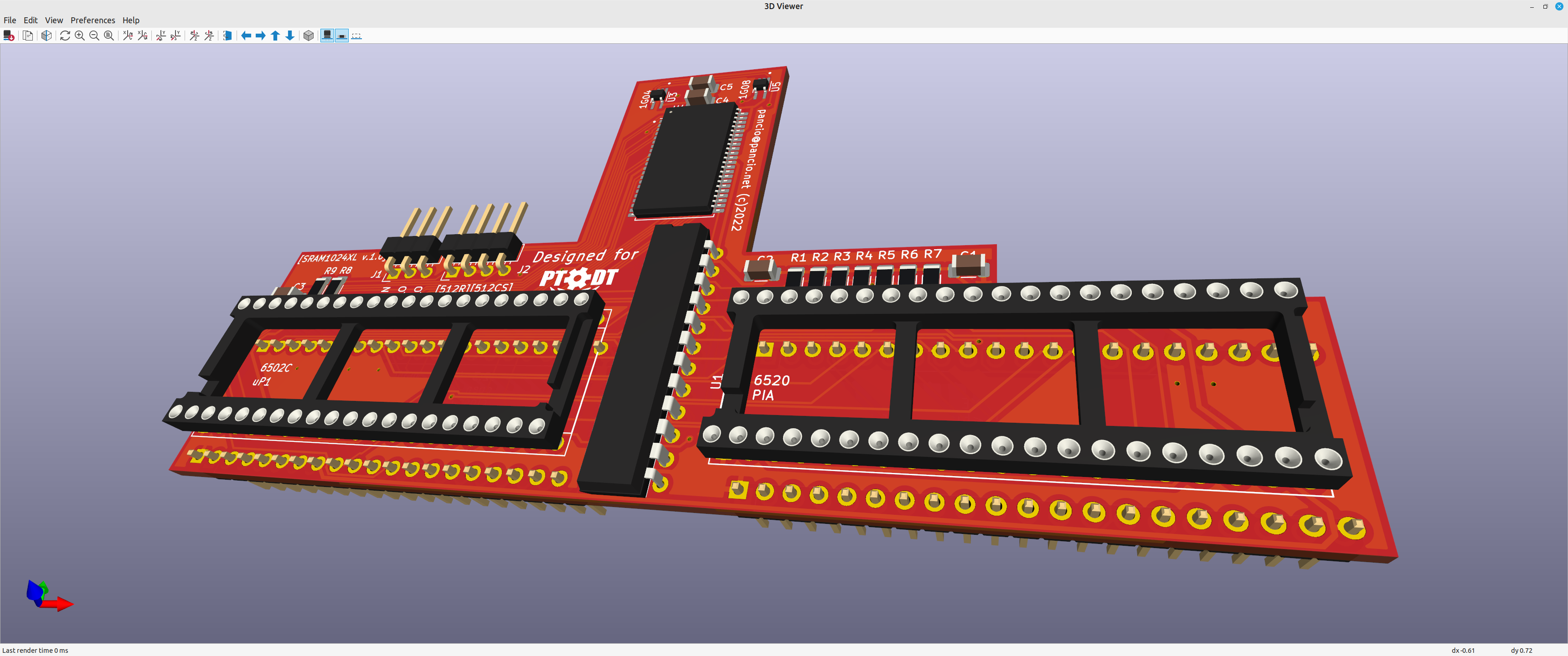

Hi Guys,
I would like to present my new project - memory extension 1024KB (not so modern but new) which is based on my mentor's - Matthias Reichl aka Hias - SRAM 512KB, released in 2010. I hope it will be good alternative and cheaper than existing... The main purposes were lower price and simplify installation inside Atari 800XL. Project is in production stage and will be tested when PCB will arrived from China. The idea for 1024KB is completely the same like with Hias's solution but I added a pair gates for additional PIA PORTB bits. If everything will be good, project will be available as open hardware under Creative Commons License (and probably sell on the market too). I hope it's good news :-)
