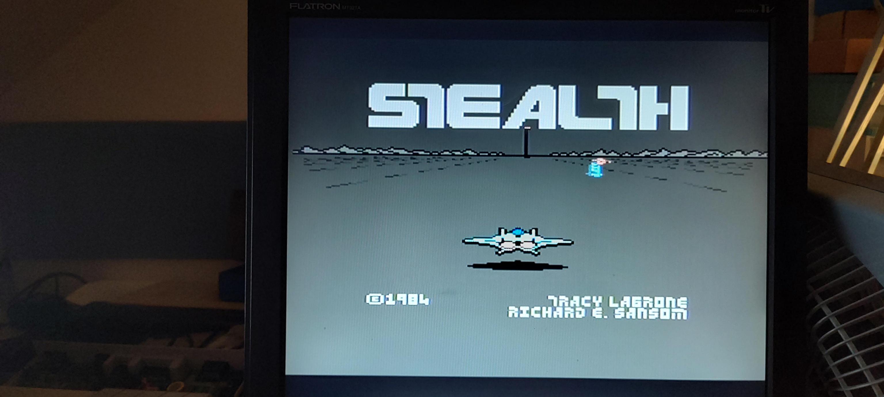

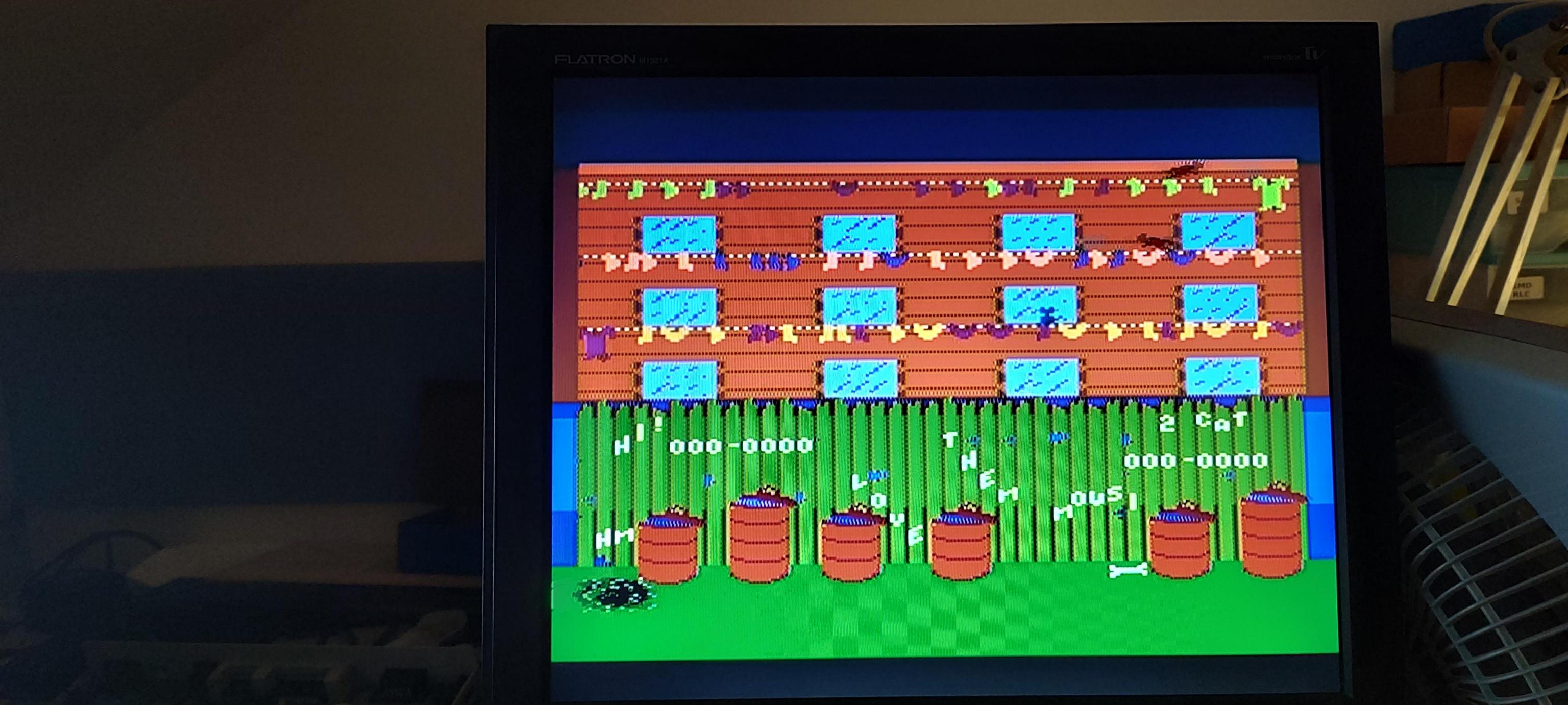

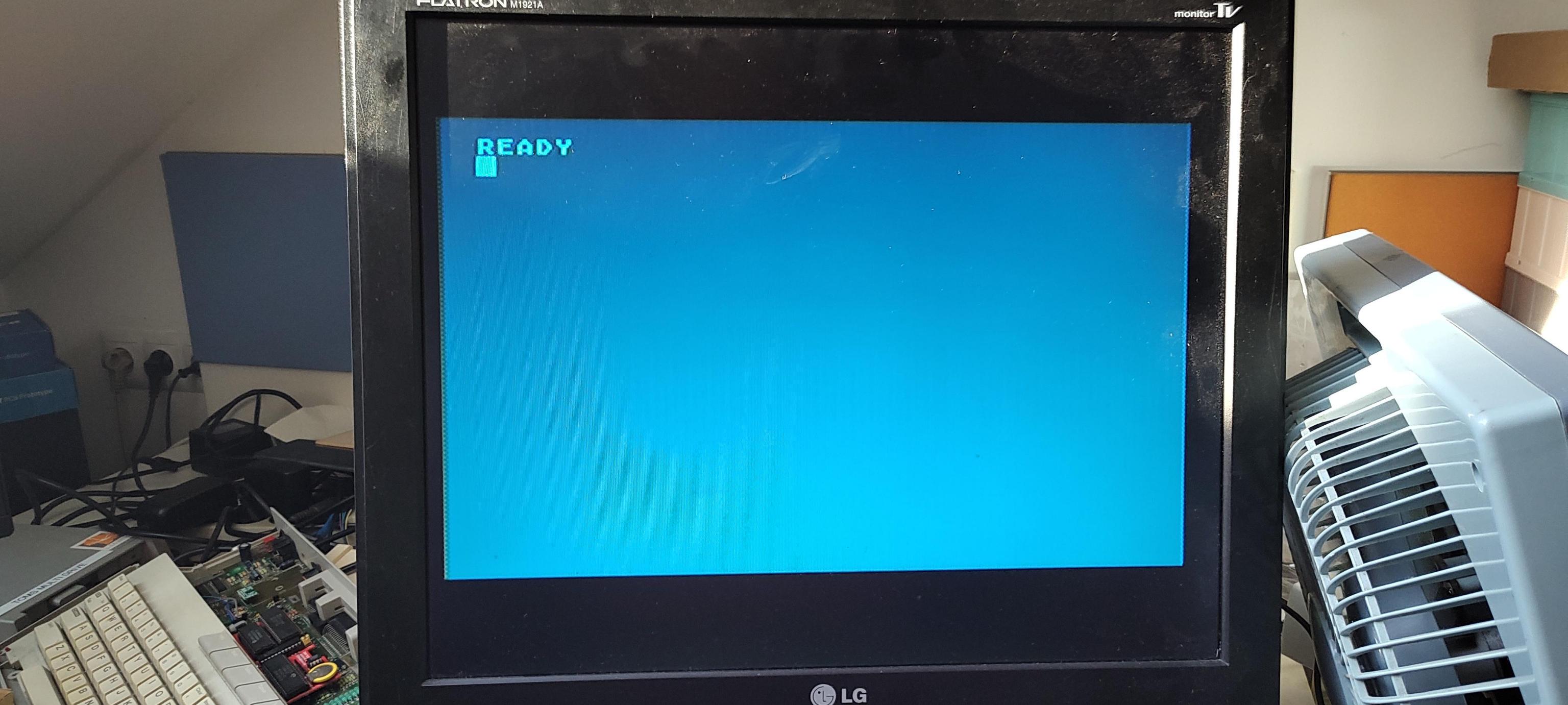

We will see that gap on the middle of grey scale was eliminated. More over, text is really sharpen than before. Above screenshots were taken from my Composite->HDMI->USB grabber - that's so many colors you see :-). Below I added a few real photos make with A800XL NTSC (Yes, it's working fine with each system!) and FF v1.0, so that you can evaluate the results yourself...
Really sorry because of mess on the desk :-)
