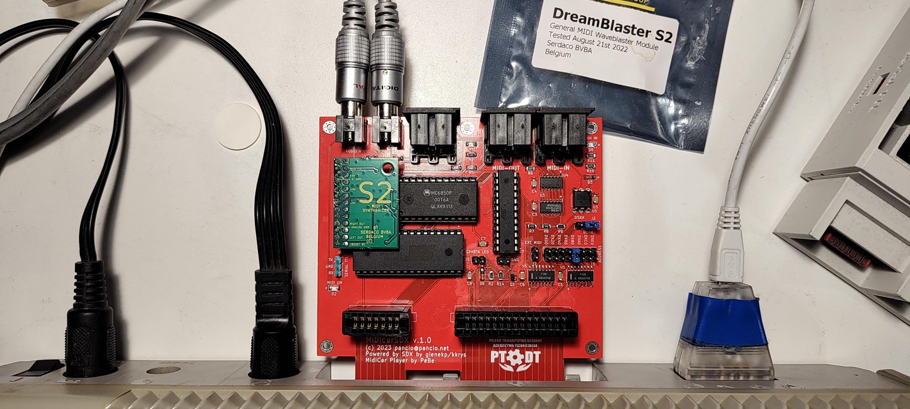

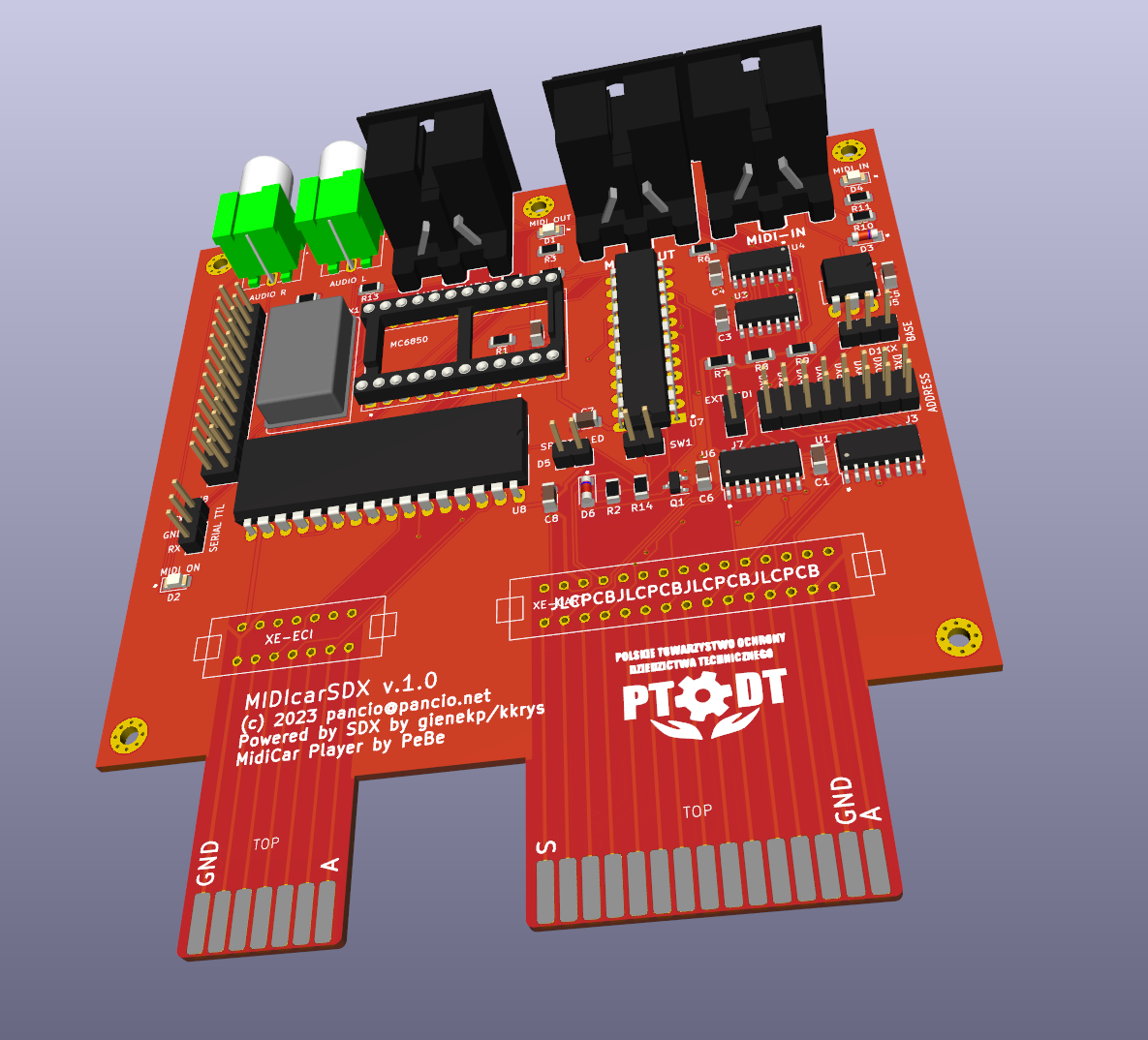

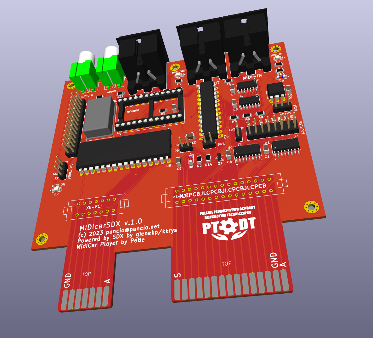

Hi MIDI freaks!
I would like to introduce new version of MIDIcar device called MIDIcarSDX. It's combine MIDIcar, MaxFlash128+ and SDX. Due to this combination, MDIcar is ready to work immediately after switching on, and the program necessary for MIDI playback is available on the CAR device paired with SDX. Moreover, is possible to use other than SDX DOS if we re-flashing EEPROM on board. Many thanks to:
gienekp -author of MaxFlash128kB+ cartridge and GAL program.
kkrys - author of very usefully reset modification for MaxFlash128kB+, this feature can enable/disable SDX whenever you want.
PeBe - author of the best MIDIplayer program!
PCB is under production, if prototype will be work I'll add full documentation to Public Domain project web page!

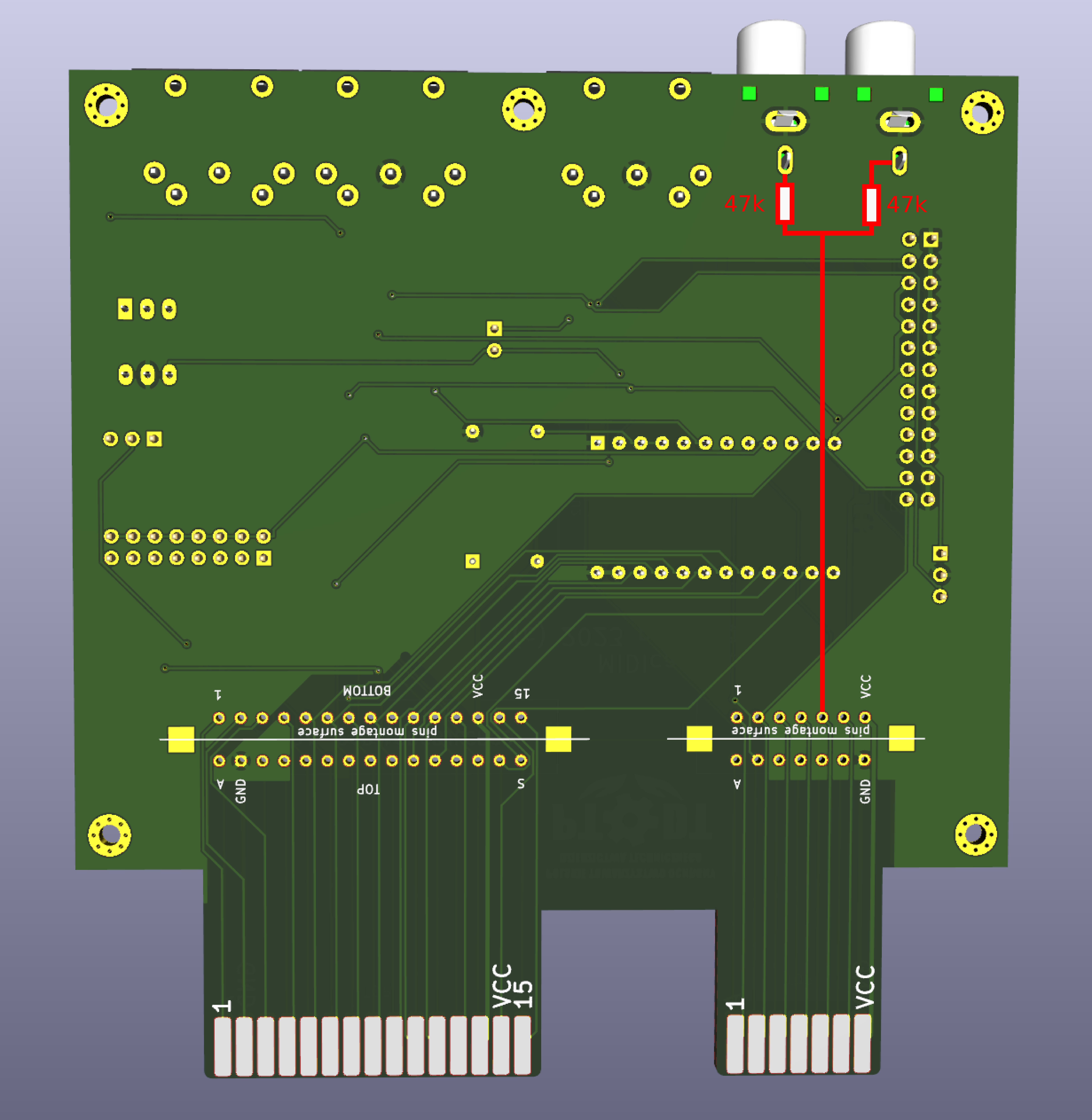

MIDIcar – simple audio mod
Beitrag von pancio »
When MIDIcar was under development I didn't realize that someone want to have audio output from MIDI on TV/Monitor. Though, best audio should be only on RCA but of course it's possible to have "poor" Audio on DIN-5 Monitor output as well. You need two resistors 43k-47k, 10cm thin wire(like kynar) and 5 minutes with iron tool...
MIDIcar CART/ECI Audio mod
The same way if you want to have audio using MIDIcarPBI...
BR,
pancio

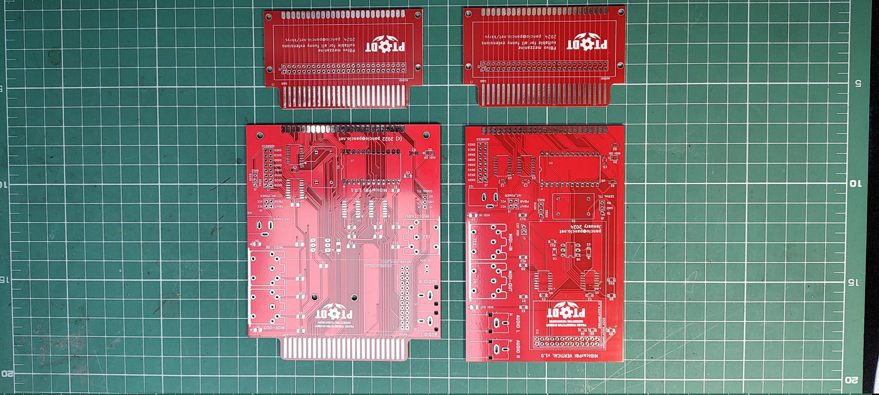

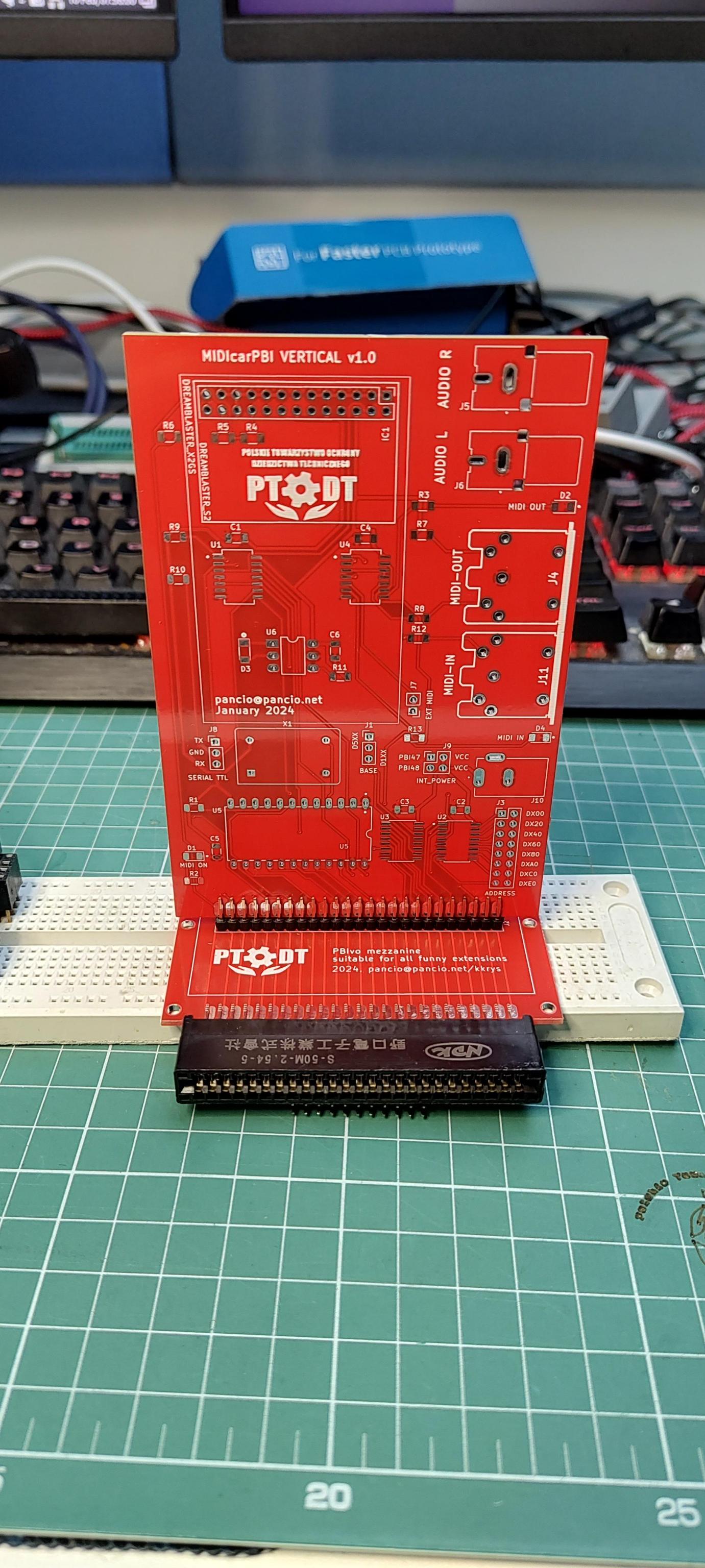

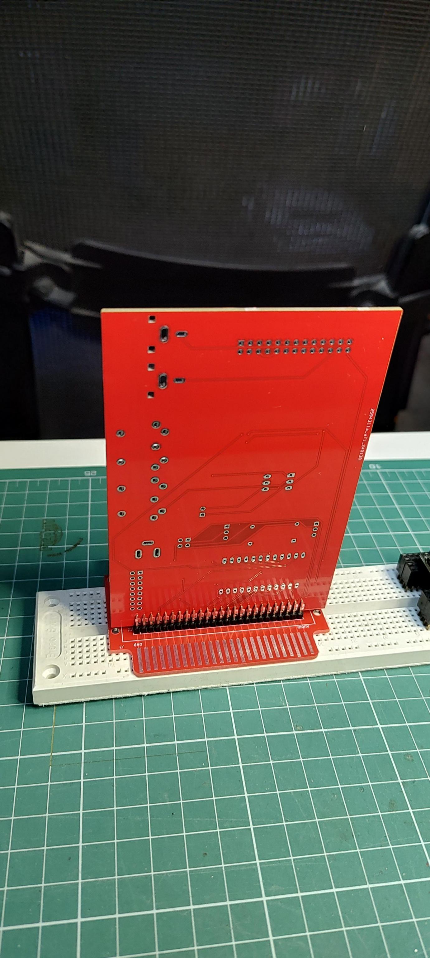

I would like to update anyone interested in MIDIcar development... I decided to make new version which will be universal for XL and XE series (600XL include). Additionally, universal mezzanine board for other projects was made (called PBIvo for PBI, and XEvo or XAvo :-) for CART/ECI - in development now). The main goal was achieve smaller size and possibility to use with other equipment connected on the back of Atari. On the picture you will see the old PCB for XL (on the left) and the newest one or right. I hope it's good idea and new approach will be accepted :-)
MIDIcar PBI vs. MIVIcar Vertical PCB's
MIDIcar Vertical front view
MIDIcar Vertical back view
Probably a few pieces will be available as ready to use devices for buyers but... I would like to say that anyone can download the schematic, PCB design (Gerber files) for each version presented and make it themselves, without any restrictions (except for commercial sale). If you are willing to cooperate, do not hesitate and contact me :-)
pancio

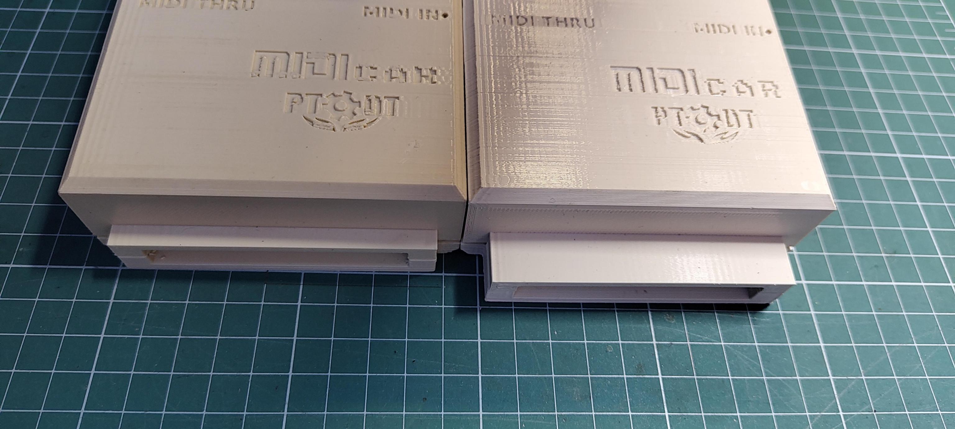

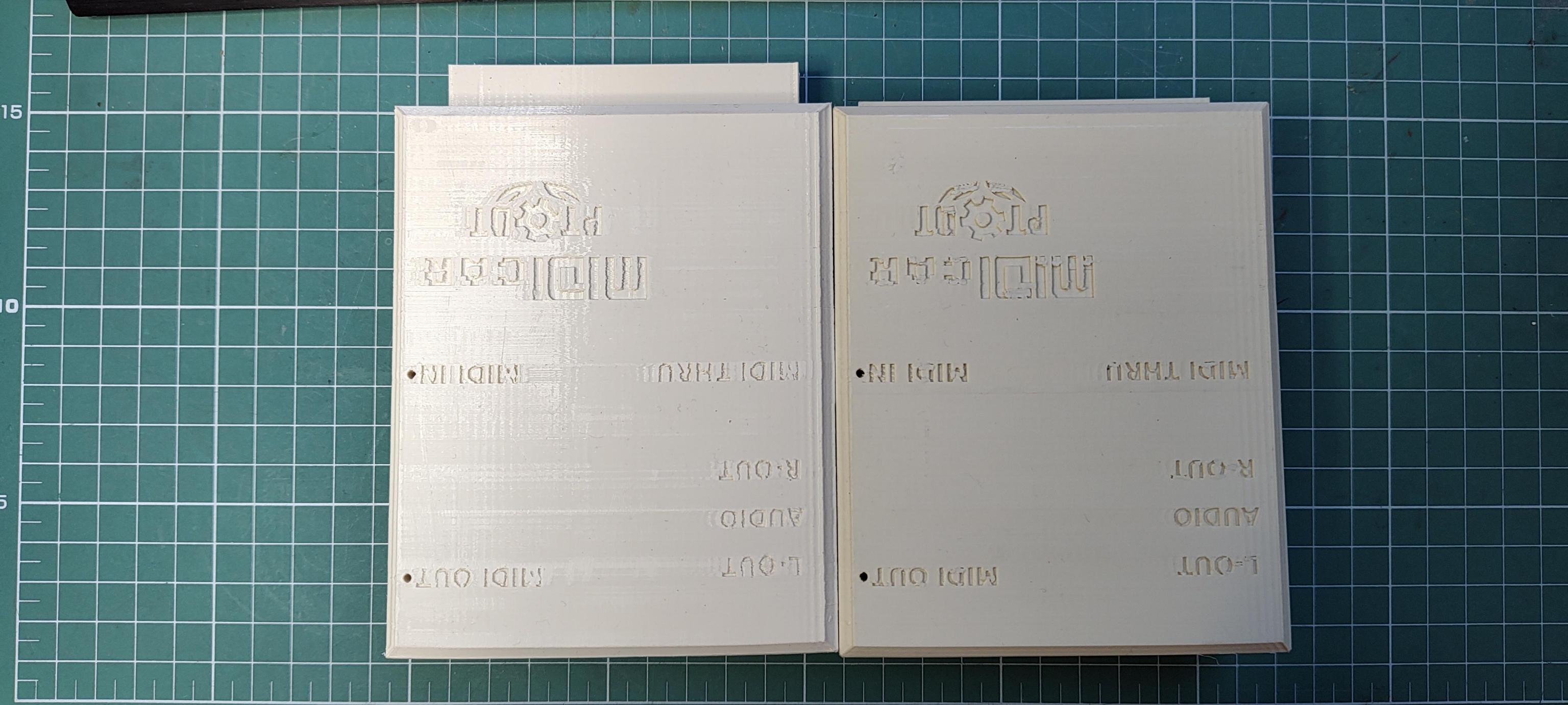

Mit dem Gehäuse passt aber die PBI Version MidiCar nicht am Atari 800 XL
pancio
Beiträge: 318
Registriert: 31.08.2021 07:31
Has thanked: 304 times
Been thanked: 306 times
Re: MIDIcar – independent, easy to use MIDI player/recorder
There is adopted for Atari 800XL without steel plate above and bottom PBI edge. You are second person I know that still have this plates. We modified the case to fill Atari 800XL and 600XL with these plates and made only one piece. If you want to have it I may print it for you.
The longer version is more stable but of course I understand that someone want to have original Atari with full steel cover inside..
pancio
