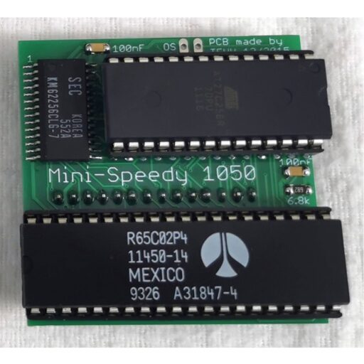

falls es auch die Mini Speedy sein kann, die gibts im ABBUC Shop.....

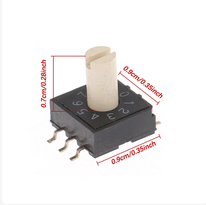

If somebody could come up with an alternative for the, in my eyes, huge dial/knob/selector, that would be very much appreciated! Smaller would be better in this case.
Sincerely
Sincerely

Re: Suche / Ich werde kaufen / I want to buy / Mega Speedy

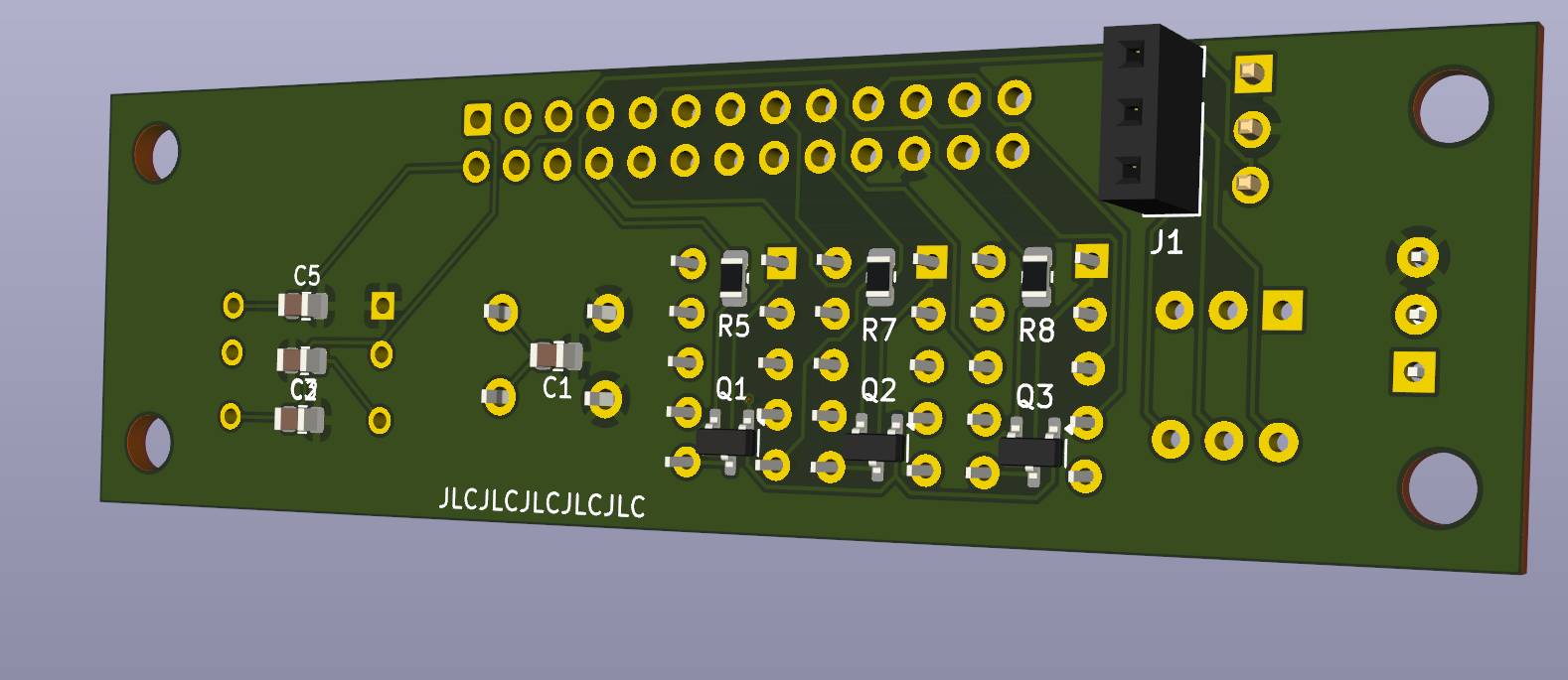

Hi Mathy,
I'm during refreshing PCB for megaspeedy so it's time to come up with alternatives to the smaller selector. Do you have something in mind?
Many thanks to Erhard for very constructive advices and help!

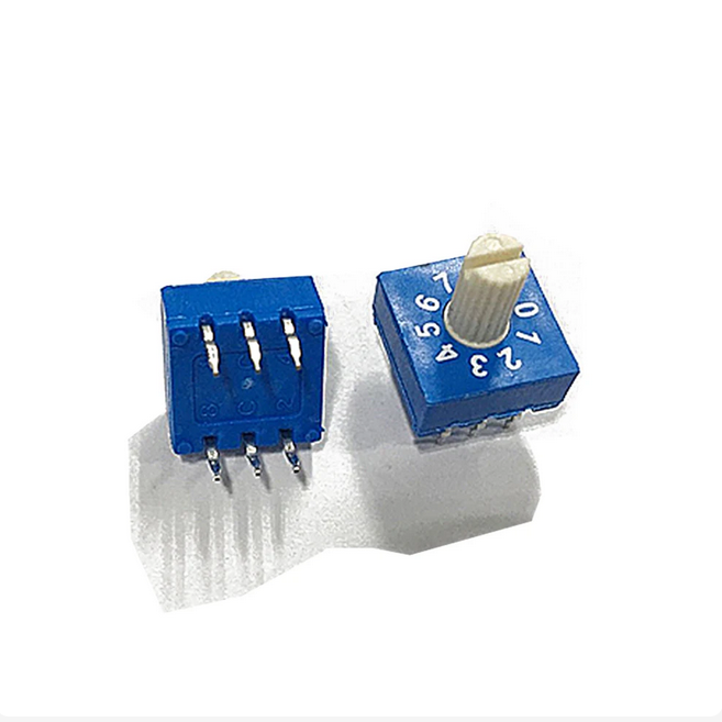

Has existing one from Knitter additional switch on knob?
I found a few smaller 0.9cm x 0.9cm encoders:

Switch:
I guess you cannot use a coded switch, you need a up and down counter as far as I know.
Plus it cannot be just turned left and right but also be pushed to activate the setting.
I guess this thing can be ommited but you will require the reset button at least so you can reset the MegaSpeedy to Flasher upon start and then select the firmware via its menu.

Hi Erhard,
You have totally right. I didn't realize that shown encoders is hard coded and chosen value is represent by DEC/HEX state on PINs.. We need to have steps information with C.W nad C.C.W direction...
I ordered a few encoders to check which will be best for project... At this moment I decided to use the standardized one. Additional thing I added is write protect button with LED indicator. PCB is little bit longer but I plan to print front cover (as replacement part for original one). If anybody has a notice or advice, please let me know :-)
BR,
pancio
Question to admin: Maybe we need to move this topic to Hardware Forum?

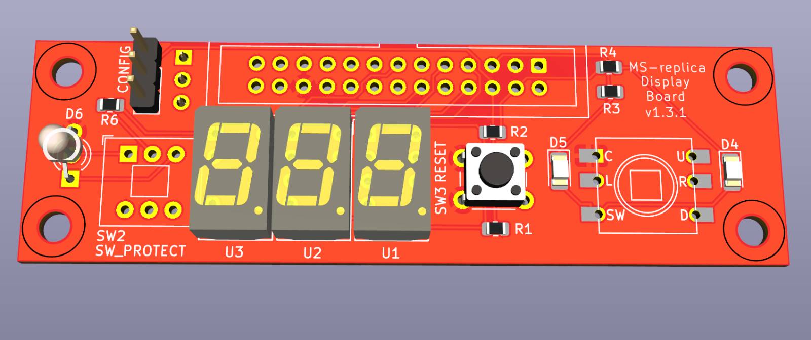

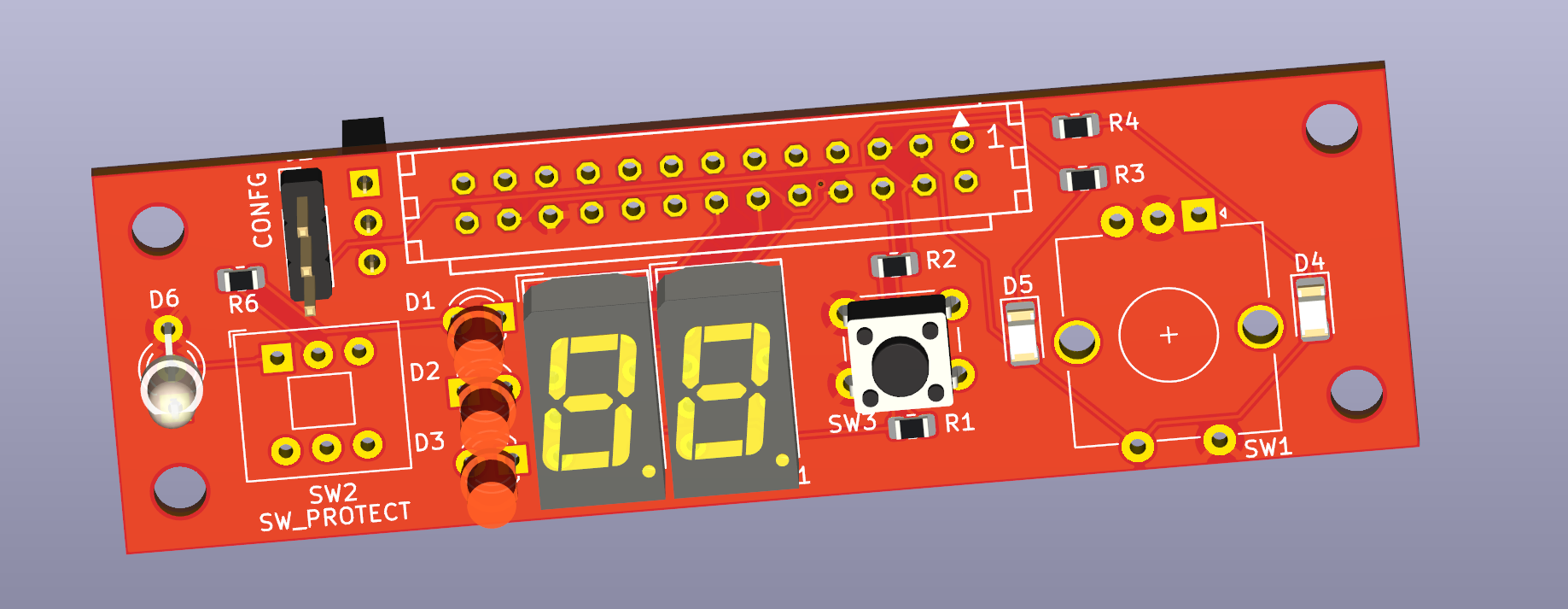

maybe someone wants a drive ID switch as well.
I'ld prefer a 3 digit 7-segment display. The leftmost one should replace the three density LEDs. Use the lower, middle or upper bar to show density. The dot or vertical bars could visualize the write protect state.
See my email about 7-segmet size.
Good idea! I'll propose some new variant soon :-)
BR,
BR,

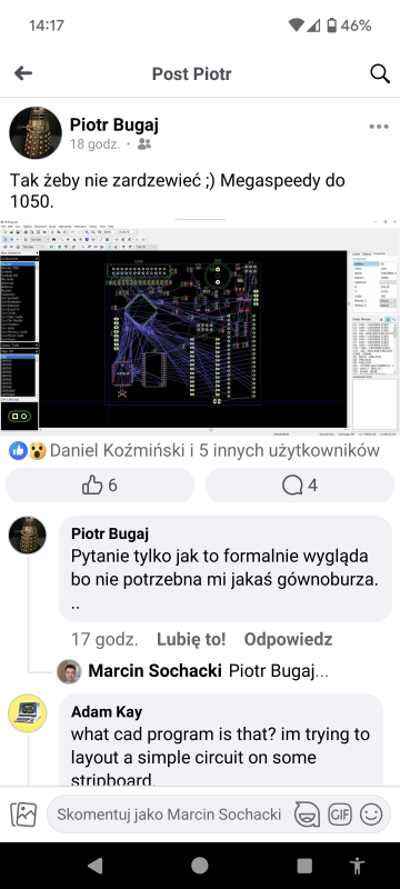

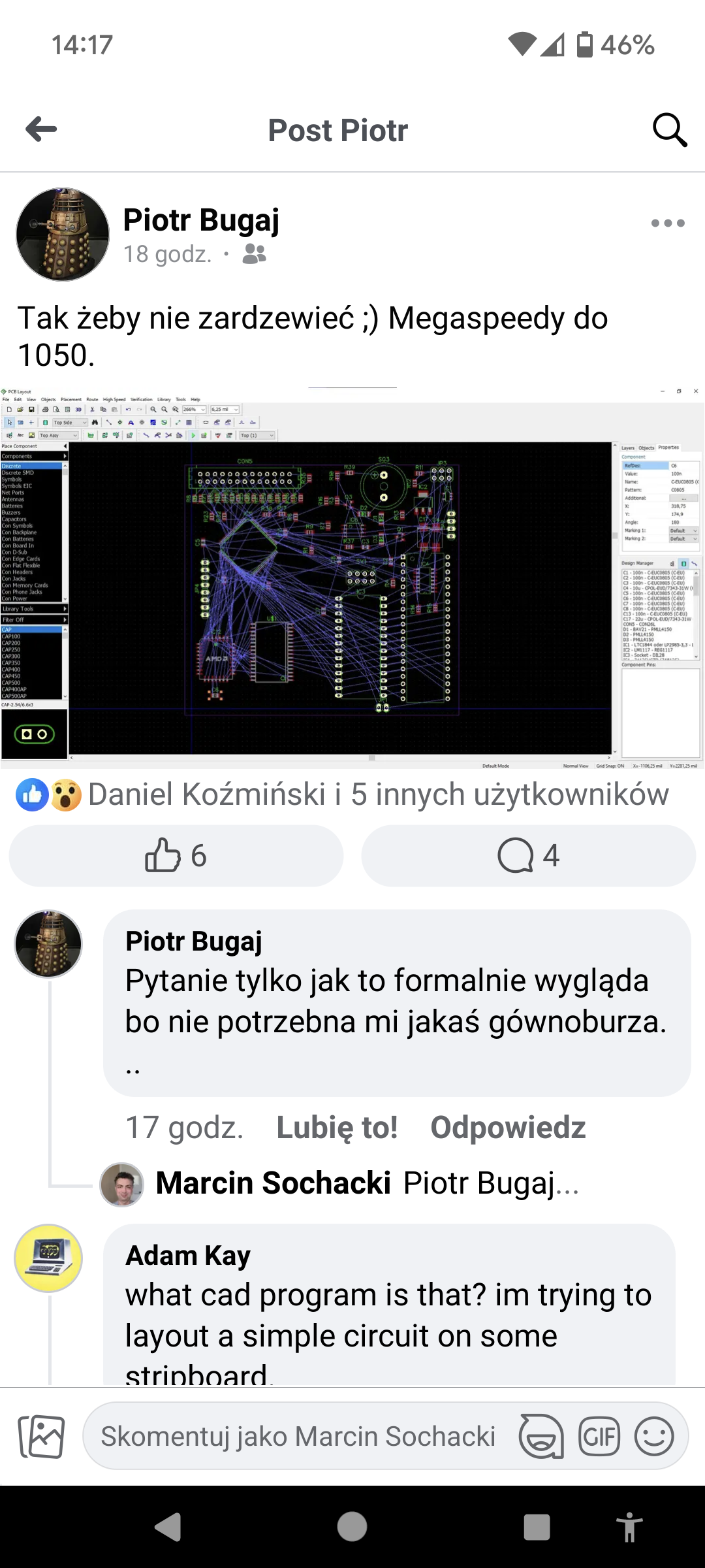

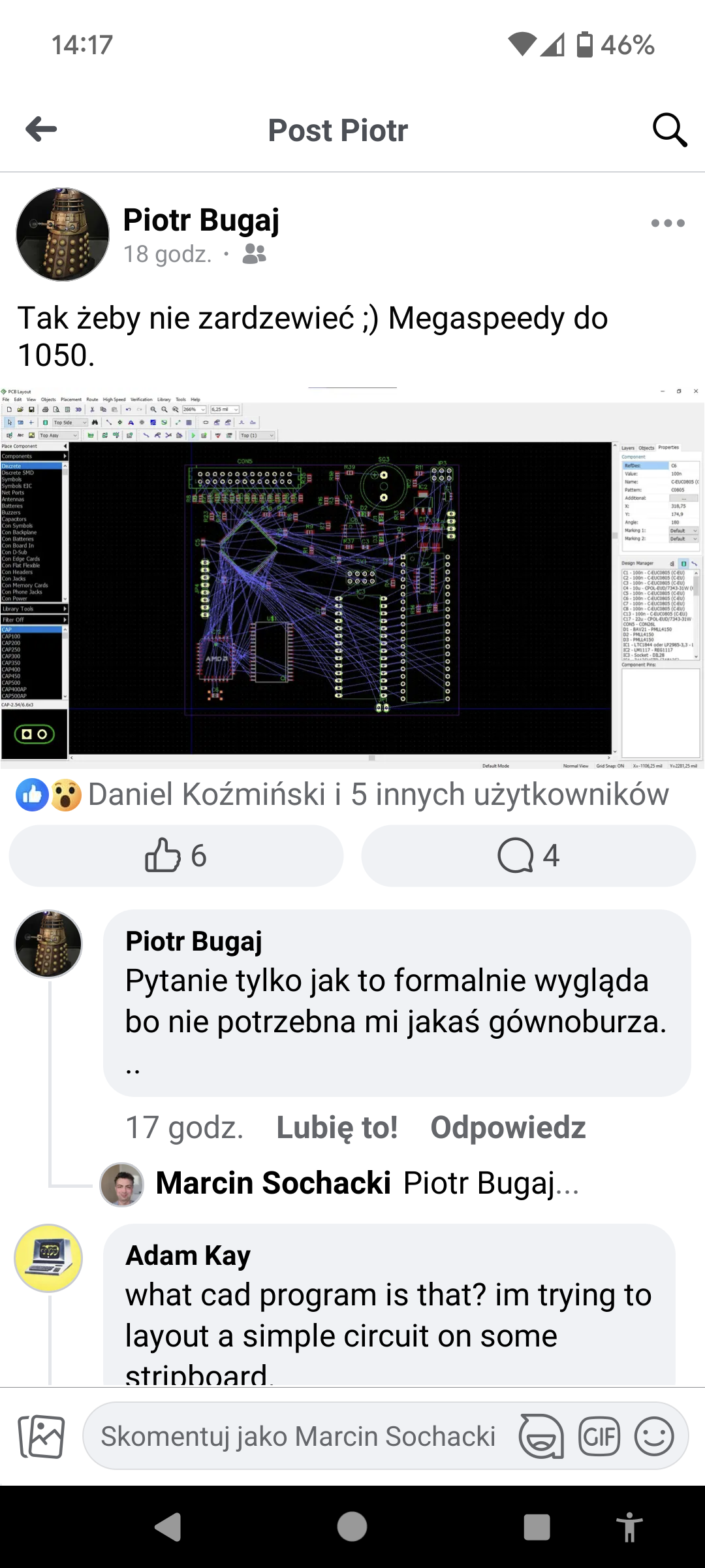

Piotr Bugaj aka "zaxon" does very interesting things, but sometimes without barriers, like the author's property, and sometimes on the Atari forum, especially in Poland, we have a kind of war because of unethical practices... I don't like it... I usually ask authors before making a replica, and I never do it for commercial sale. Of course, it is possible to make a replica for interested people, but always with the authors' consent. This is my main rule.
The sentence in the screenshot shown refers to the question asked in an ironic way and more or less means "what is the formal status of MS? Because I am not going to listen to shitty comments...."
Extremely sad.
Extremely sad.

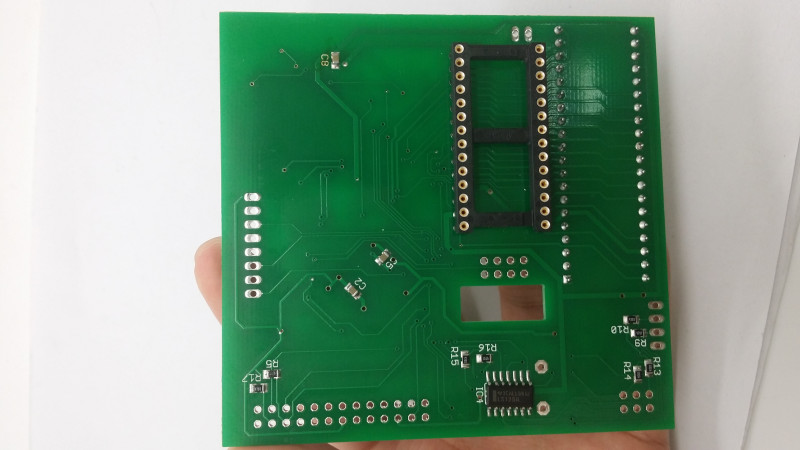

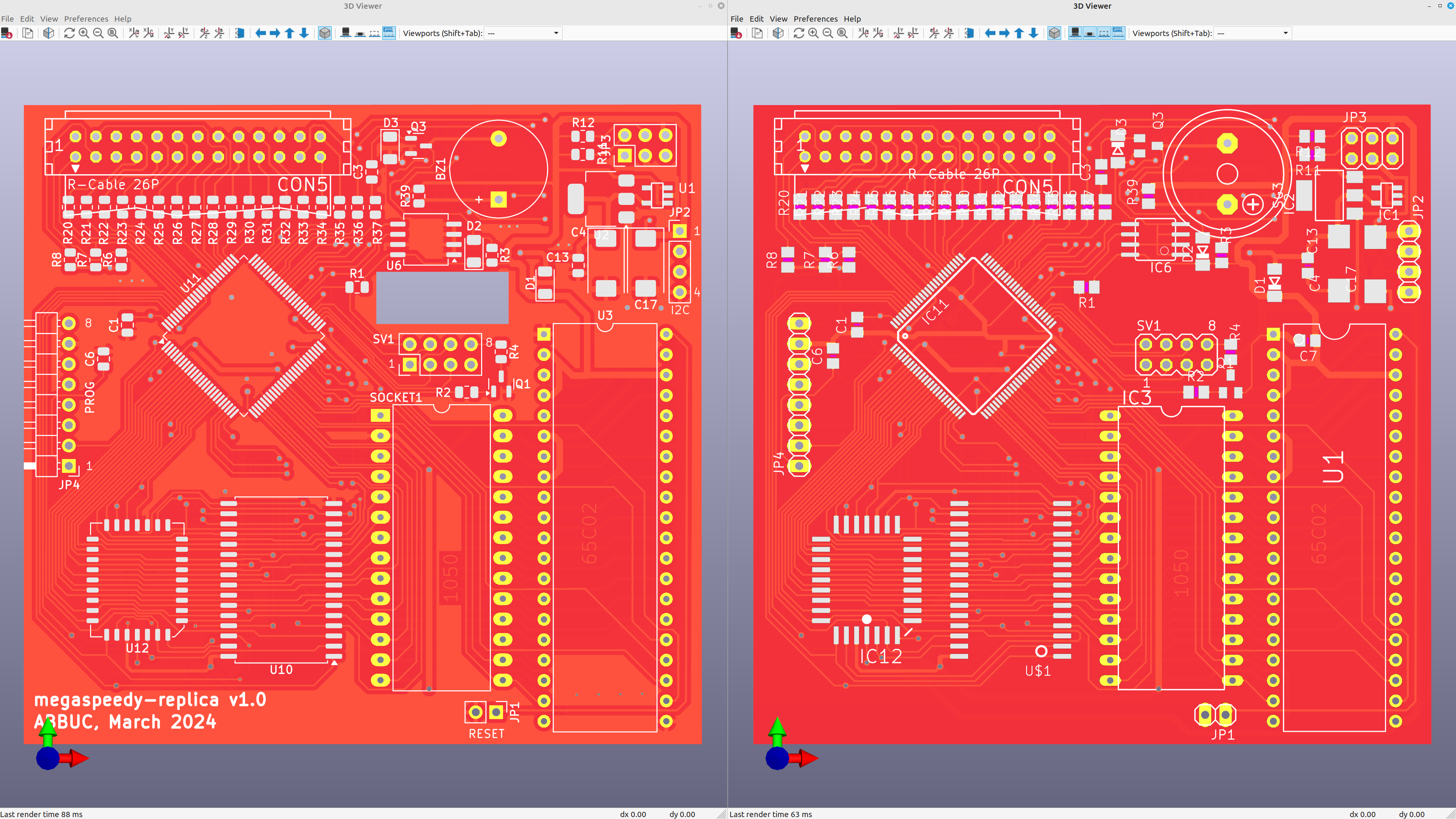

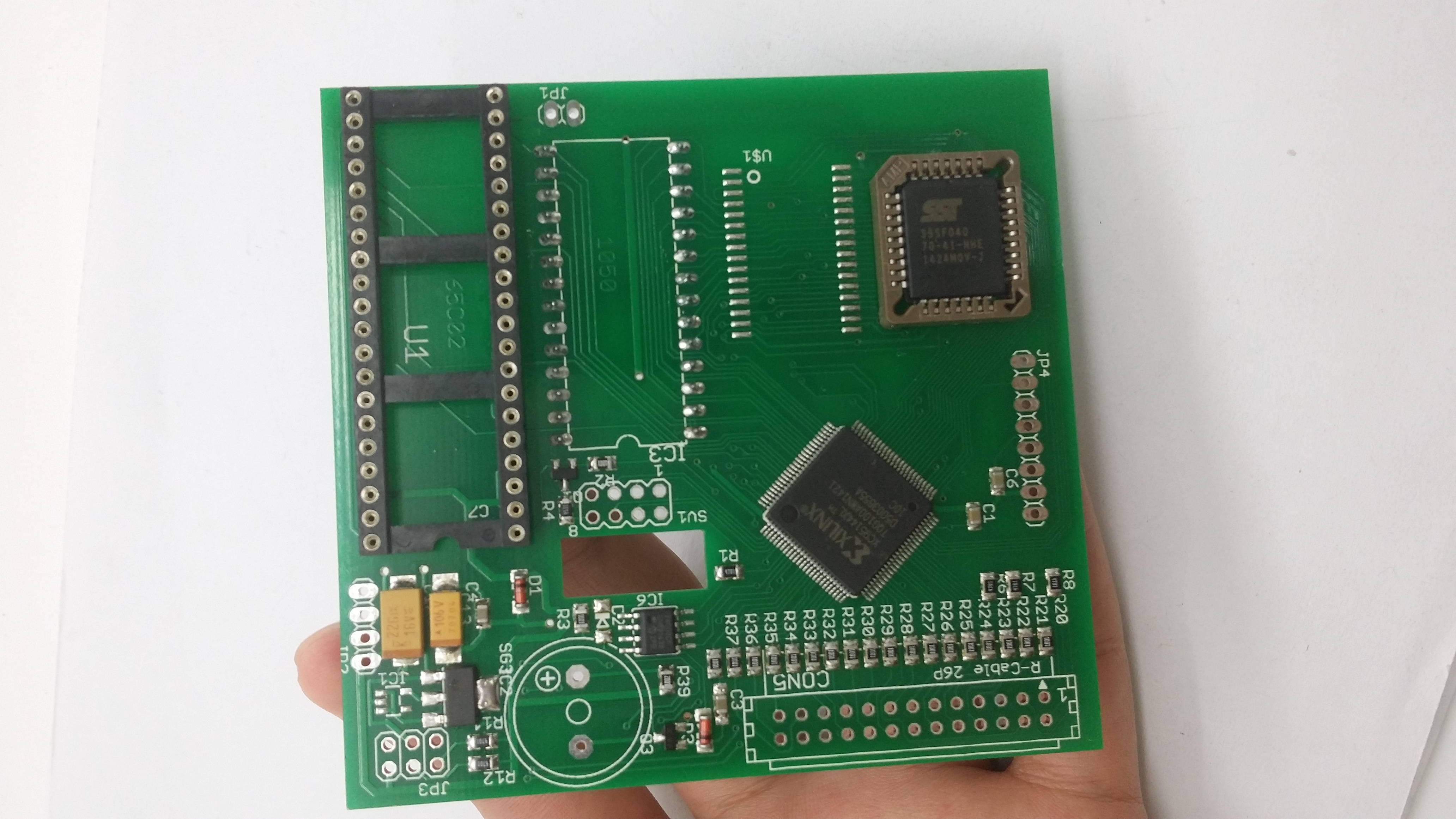

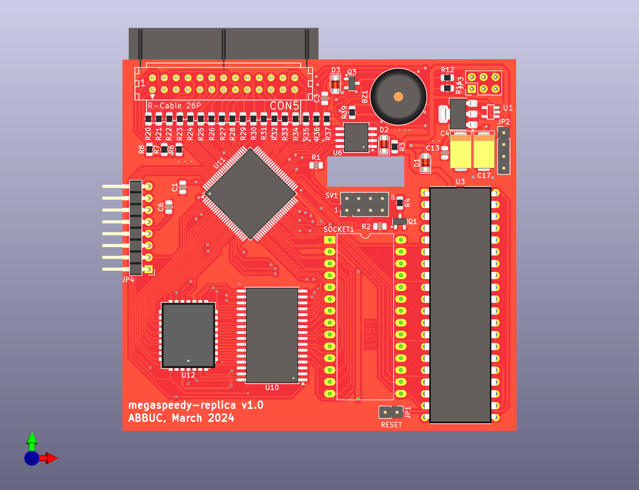

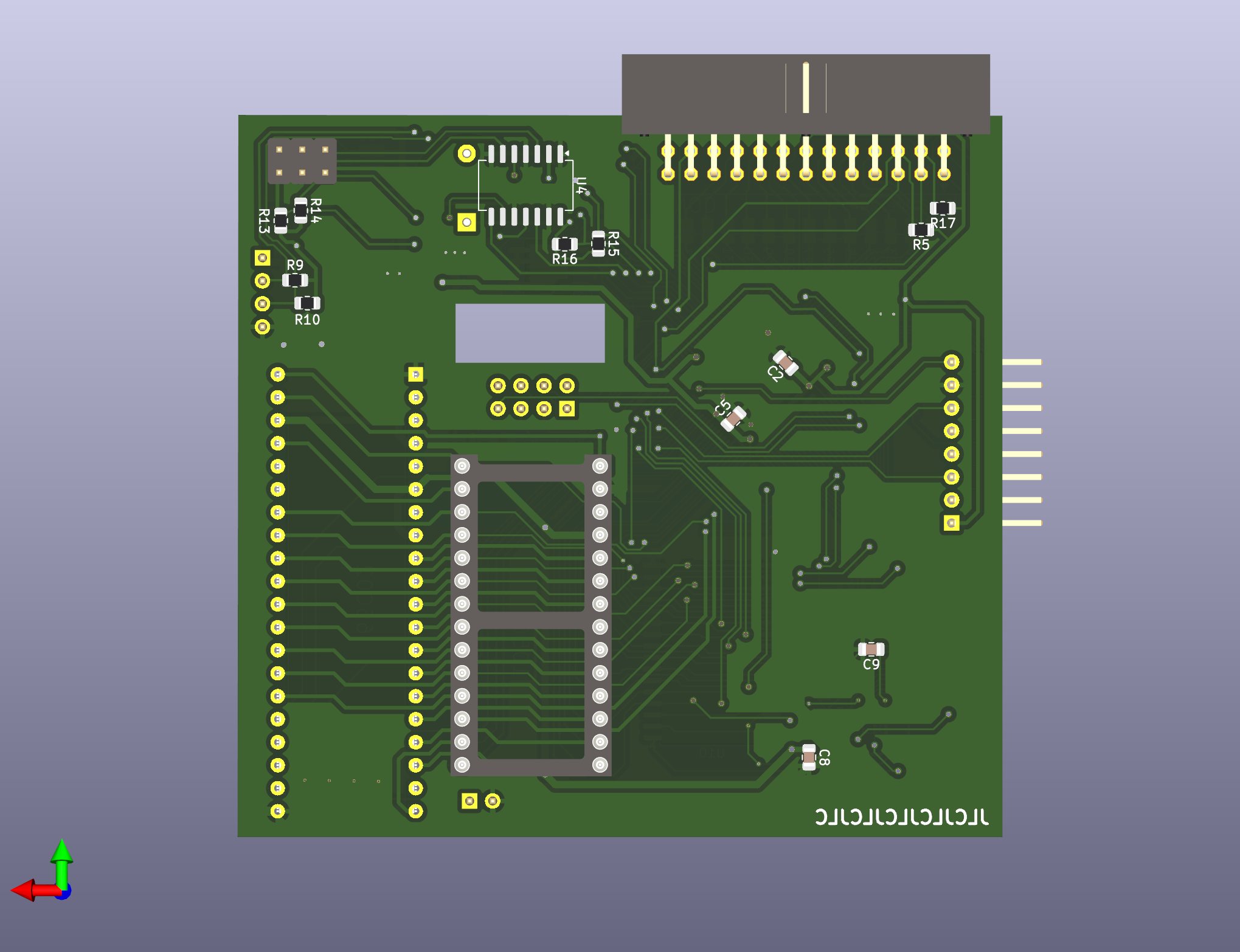

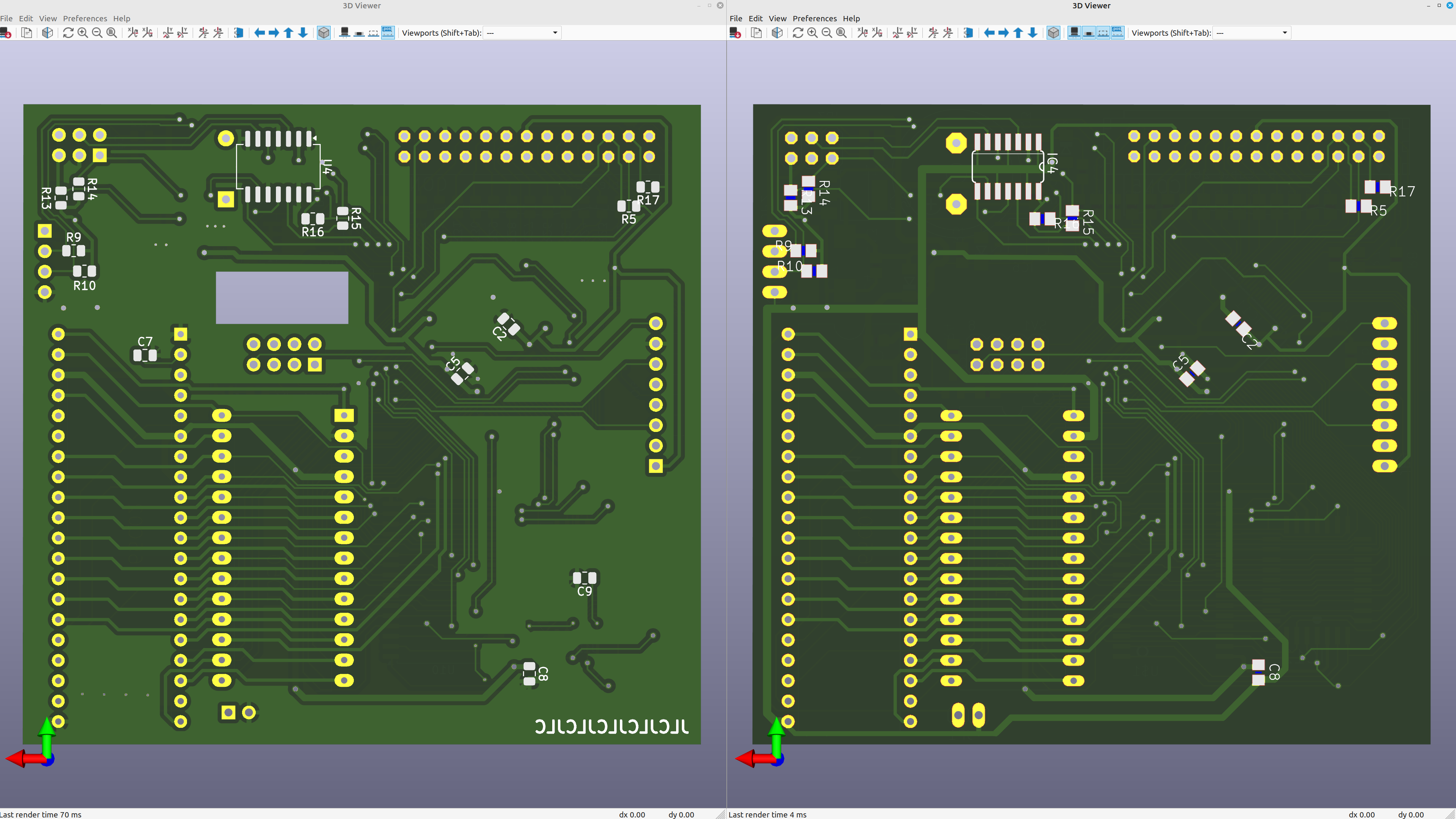

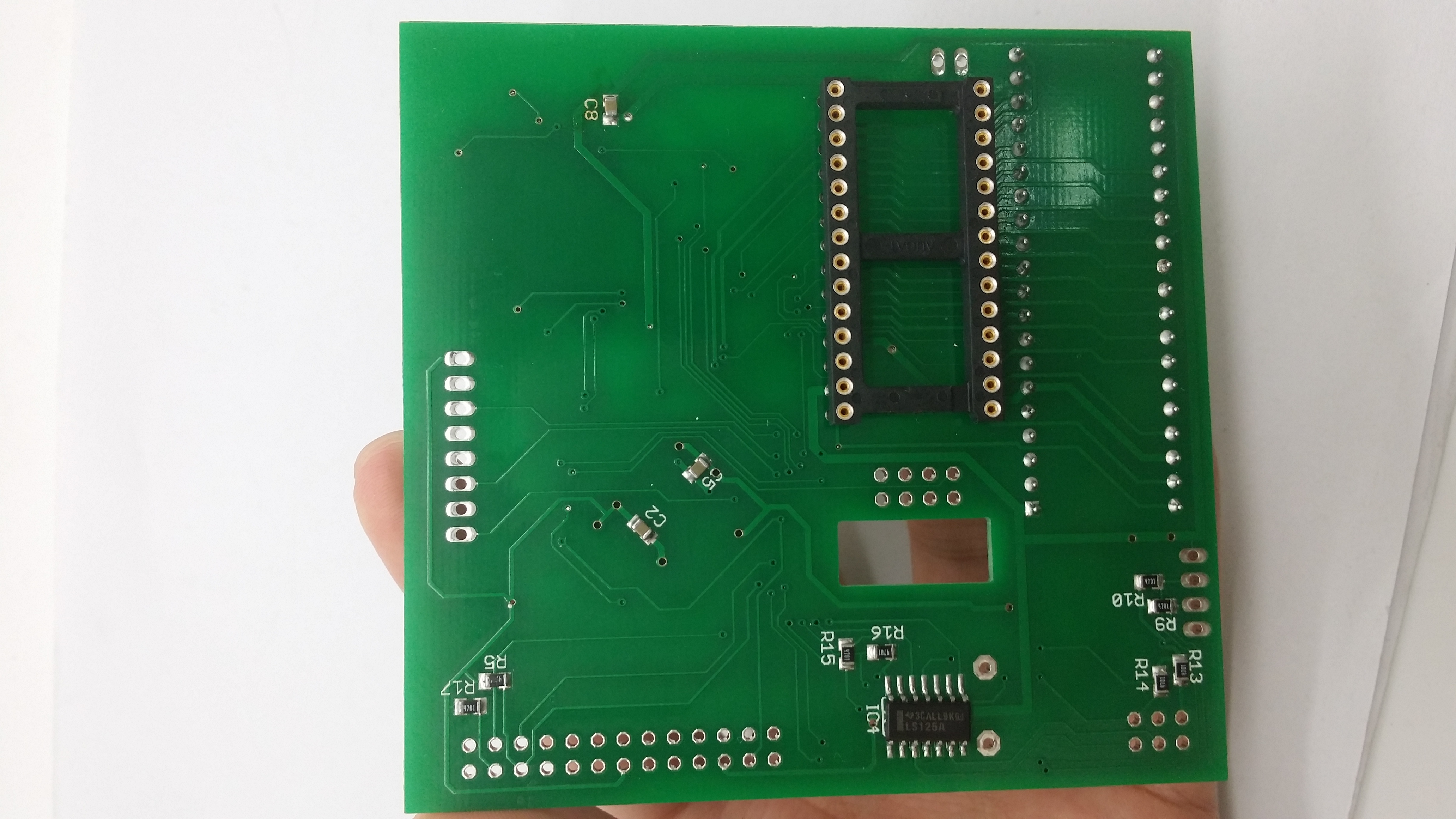

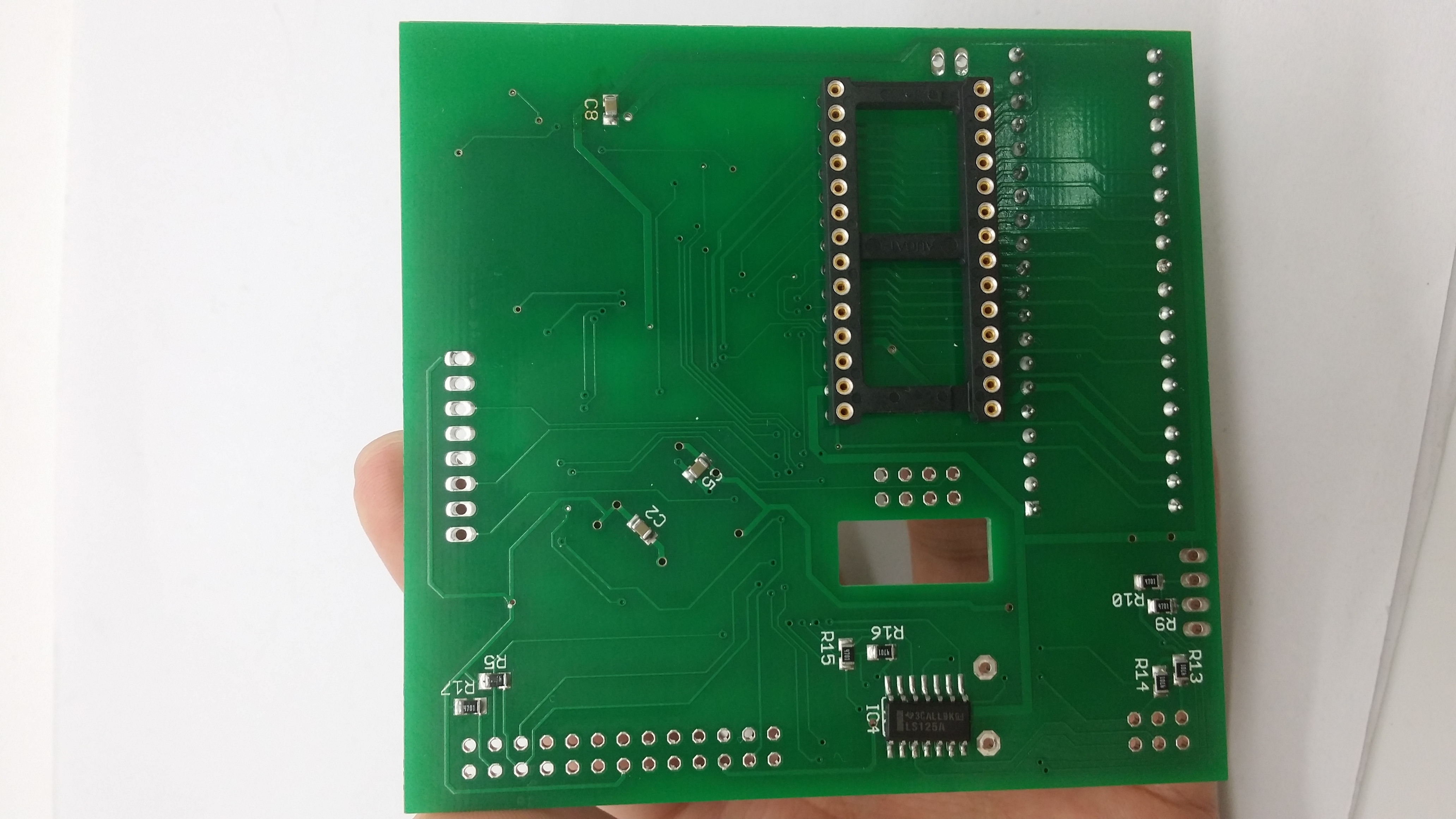

Pretty finished... Looks like the original, but I added a few modifications and rerouted some wires. Changed outlines to be compatible with standard KiCAD, added one capacitor under SRAM... It should be 1:1 compatible with the original PCB as I tried to have almost the same component positions. While working, I found a few minor issues in the schematic and PCB design, but all of them do not affect the main working of MegaSpeedy, so I must say: VERY GOOD WORK guys (MegaHz, Hias, Guus and everyone involved in the project) - this is a beautiful piece of hardware! :-)
Special thanks to FloppyDoc - as a colleague, he helped me collect all the data and advised me on many topics!
If the test on the new PCB goes well, I will make all the data available for you to use.

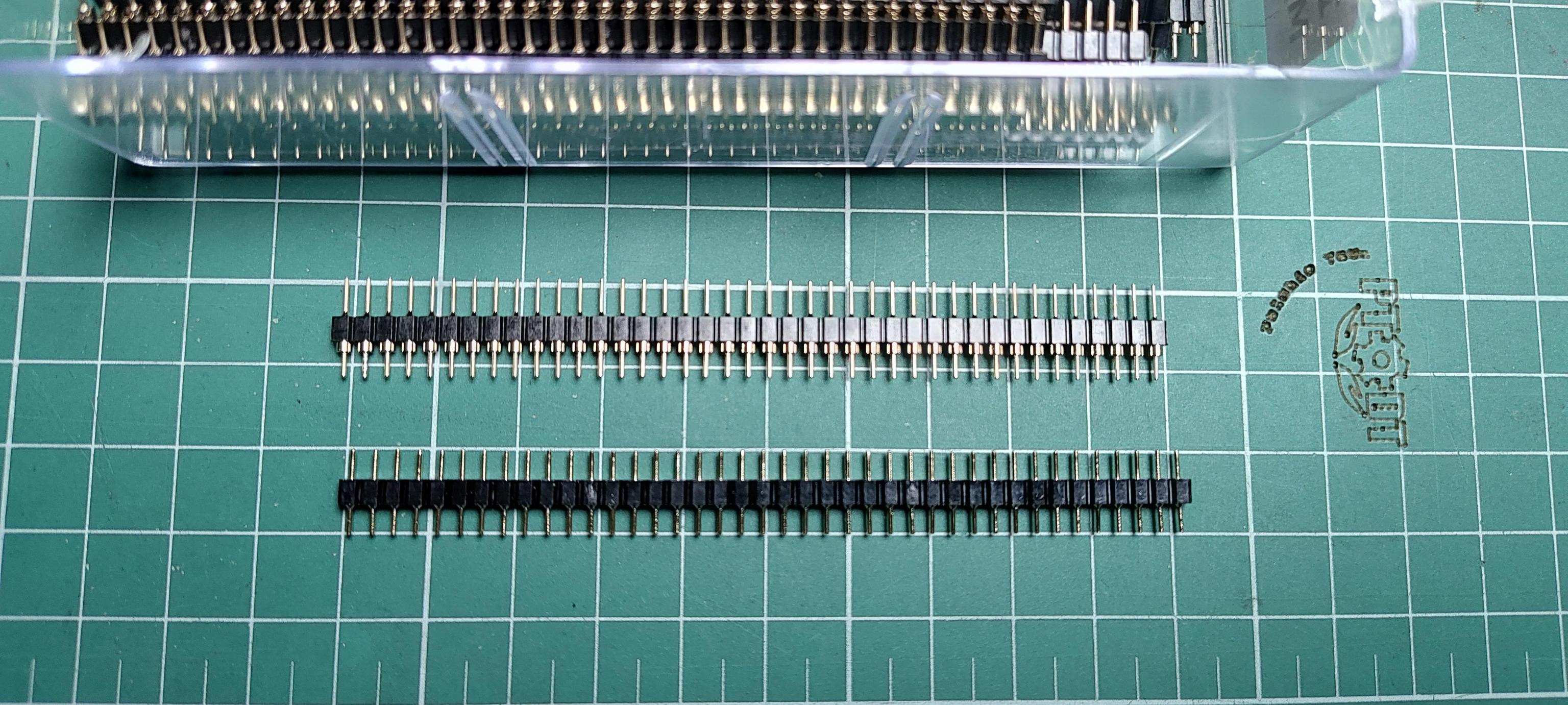

Is possible to use pin header like this? (and use original socket from 6507)
BR,
BR,
perfectly correct. Though I wouln't use that old leaf-spring-socket to plug-in the MegaSpeedy. In my 1050 I replaced the socket on the 1050 pcb with a high-precision one.

Great,
Thank you Erhard for confirmation.
I checked schematic and PCB delivered by Wolfram... it's look perfectly! The issues which I found earlier are not existing on provided design. Please look on attached pictures. Just cosmetic changes on my side were made :-)
What I'm changed:
- added capacitor close to FLASH memory,
- relocated a few resistors and show description on soldermask,
- flip to bottom side capacitor under 65c02 to avoid mechanical conflict with socket,
- expose all components description,
- added cut layer for XTAL,
- added GND polygons.
From logical point of view I swapped A15-A18 signals for SRAM - now it's like A15-A15, A16-A16,..., It's doesn't matter for working device but I love good order :-)
Schematic, PCB-design and gerbers are attached.
I need to a while to present changes on DISPLAY module....
BR,
Hi again,
please make sure that the holes are not too small for the components (pin rows, IC sockets and stuff).
When I populated my XL-remake the soldering points and the holes within were really tiny ...
Best, Erhard
Best, Erhard
- pancio
- Beiträge: 321
- Registriert: 31.08.2021 07:31
- Has thanked: 311 times
- Been thanked: 317 times
Thank you for notice. I tried to use standard components as usually. We will see soon, PCB is under production. In mid time, my colleague KKRYS is working on front panel design - to avoid damage the original one.
A few fresh news from MegaSpeedy Replica...
...new panel was made. This time we are using little joystick instead encoder. Additional 3 diodes were changed to additional 7-display module. It will be use to show other values than floppy density in new version.
BR,
pancio
BR,
pancio
