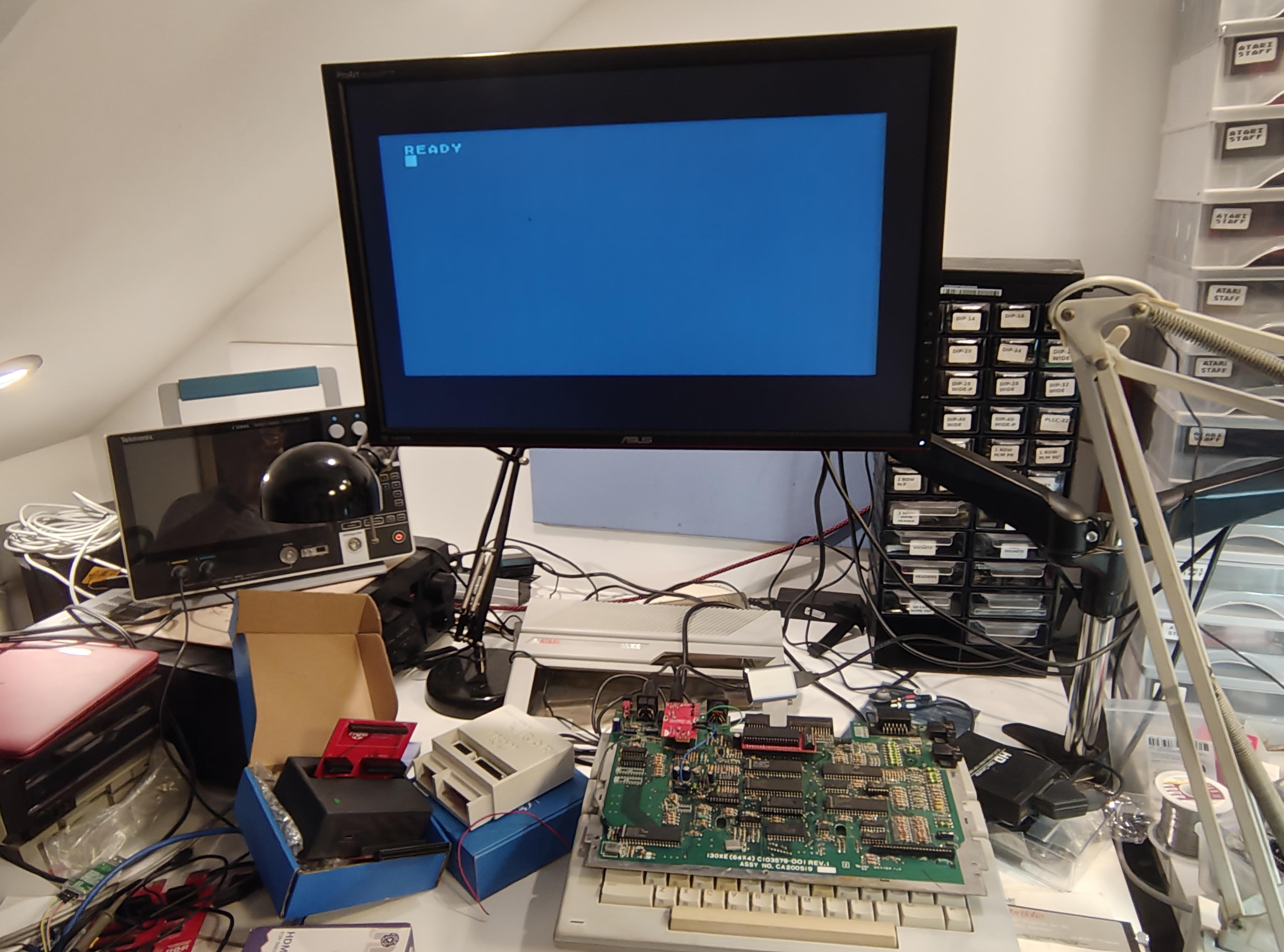

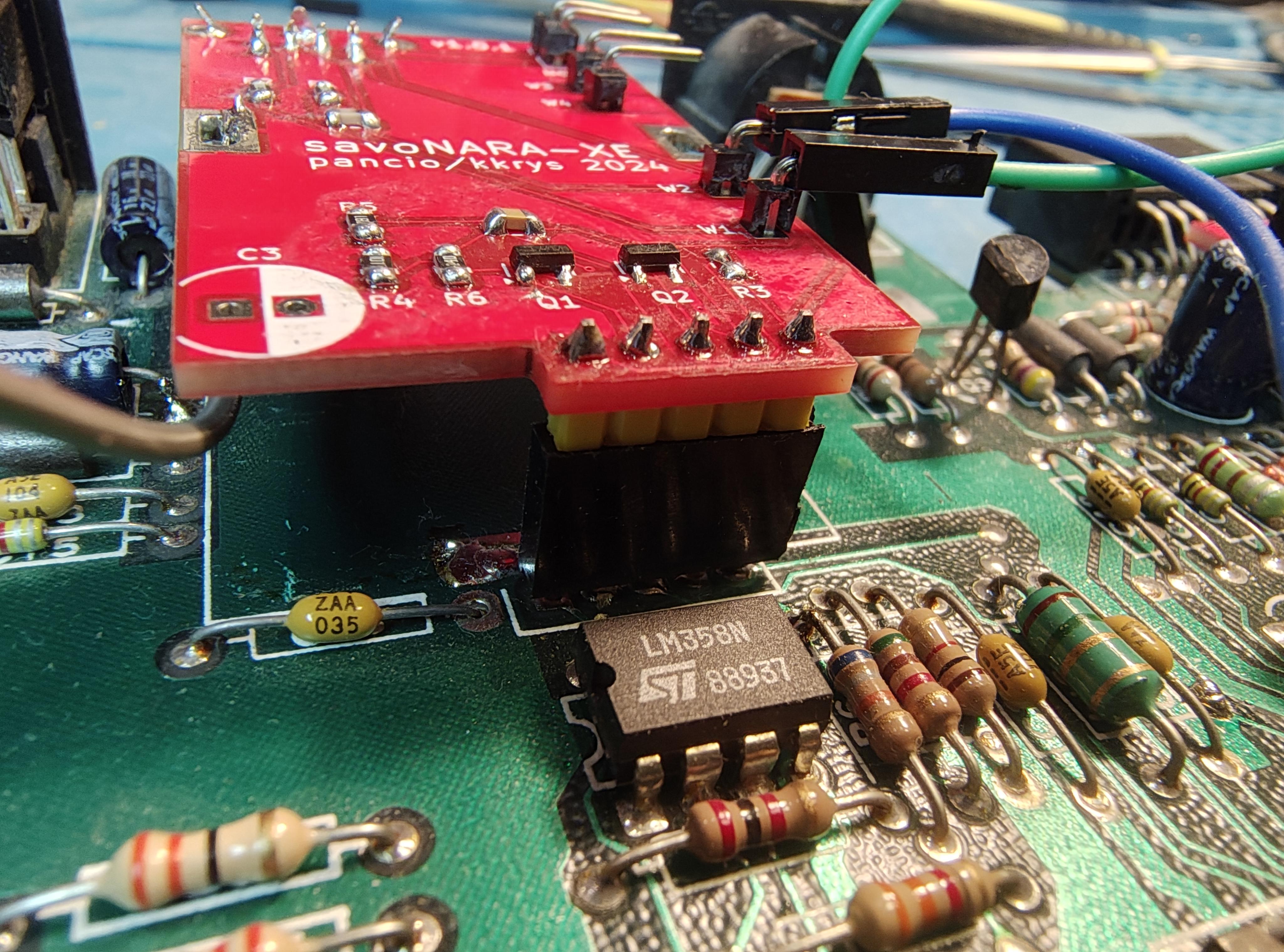

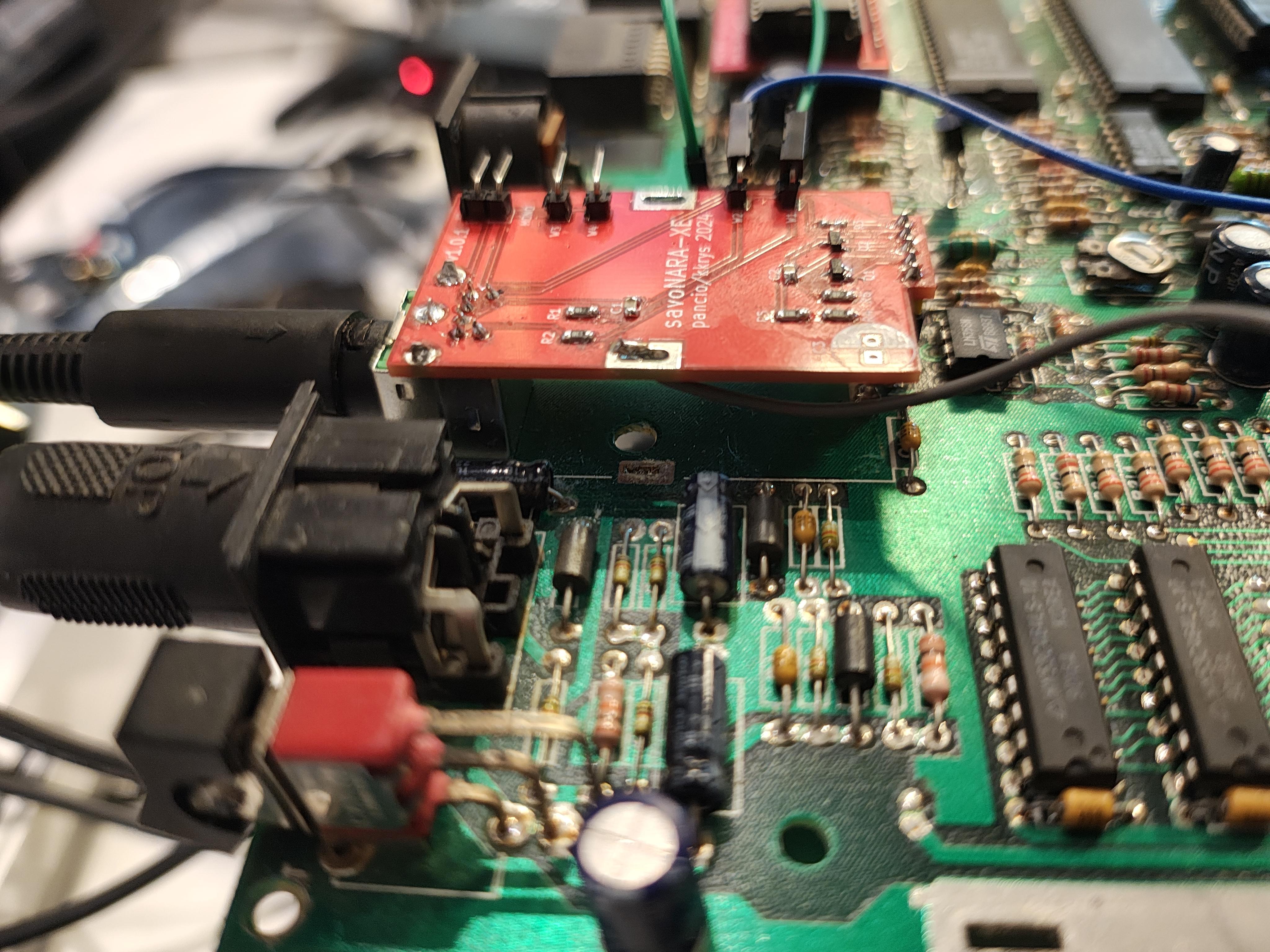

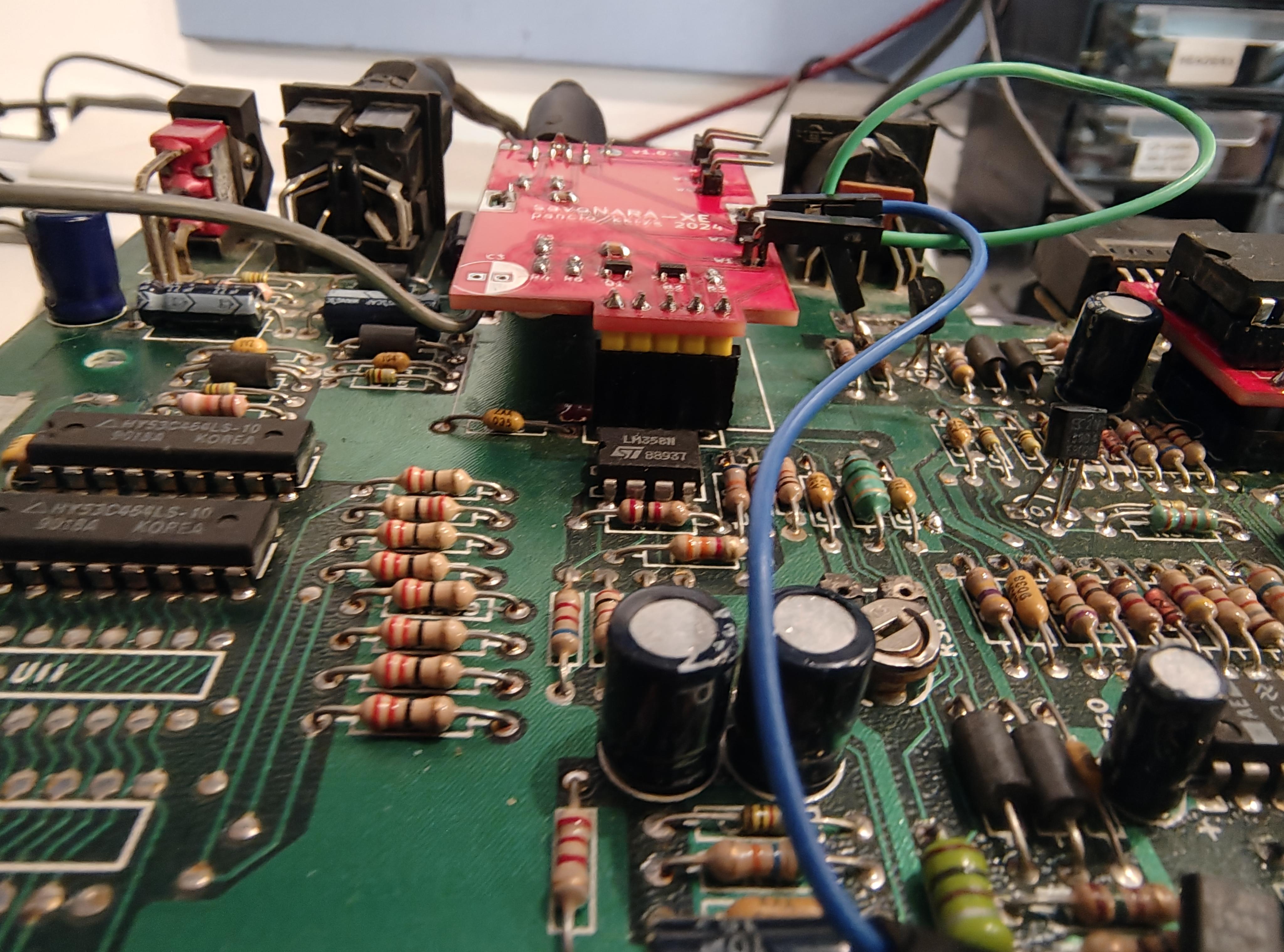

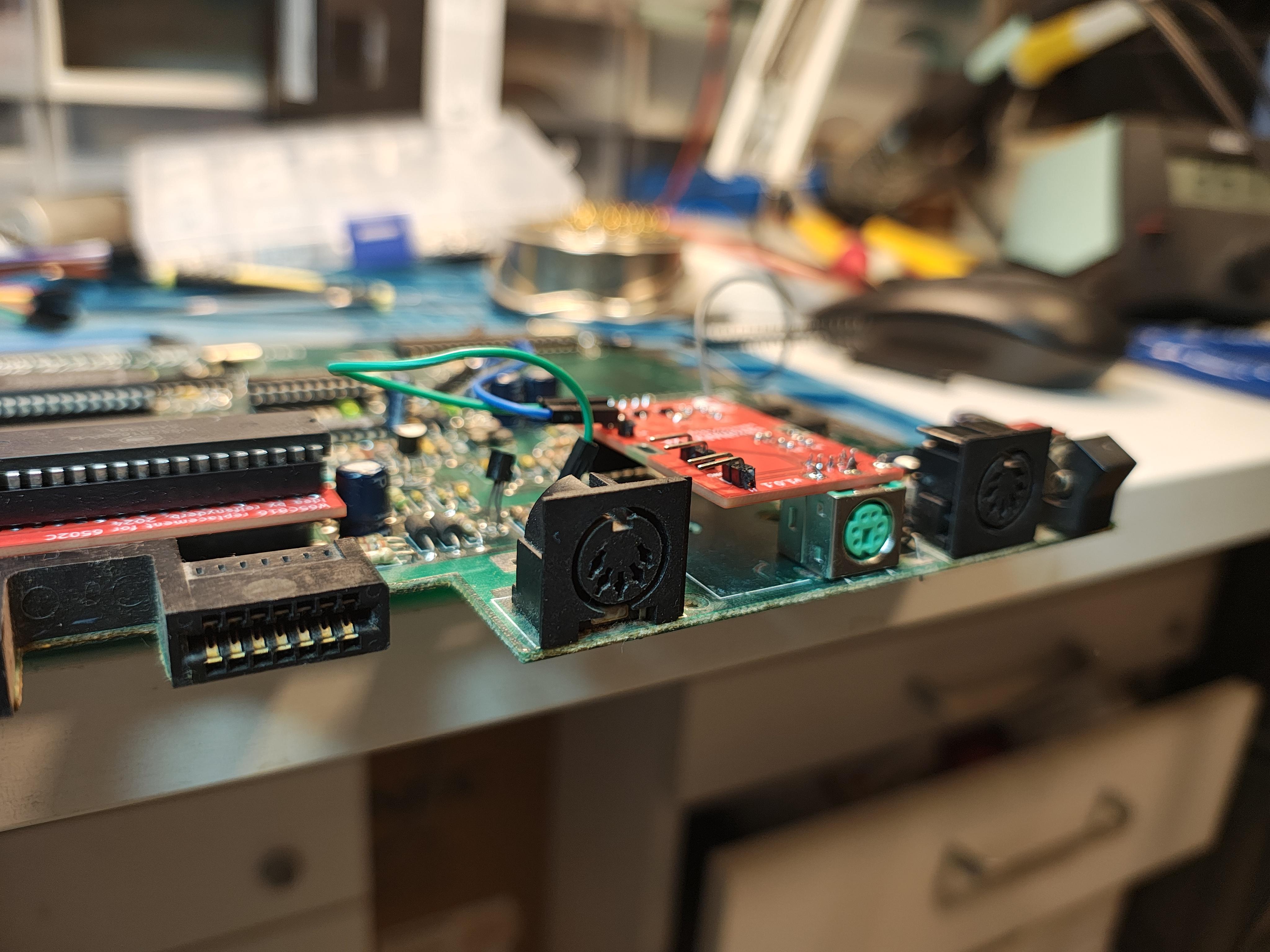

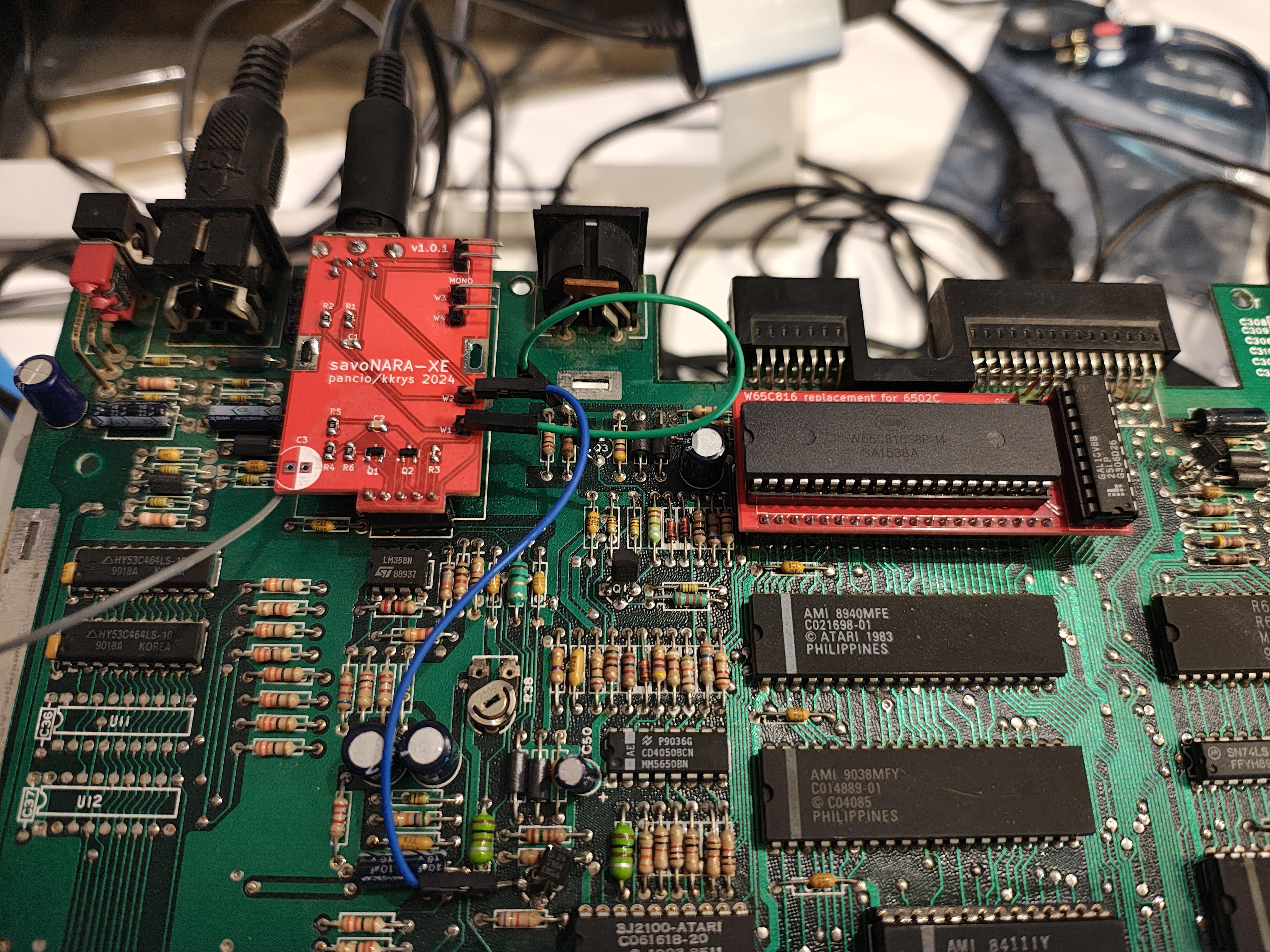

Hello,
I've long break from Atari because of workload but i found a few hours to check very simple mod...
Today I managed to build and run a very simple interface that allows you to easily display the image from Atari via HDMI on any monitor/TV with stereo sound. It is a simple alternative to solutions installed in the computer such as VBXE or Sophia. It does not provide such a good image (especially as Sophia) but allows for very pleasant work and play with our Atari. For details, please visit my website.
Have FUN!
Have FUN!

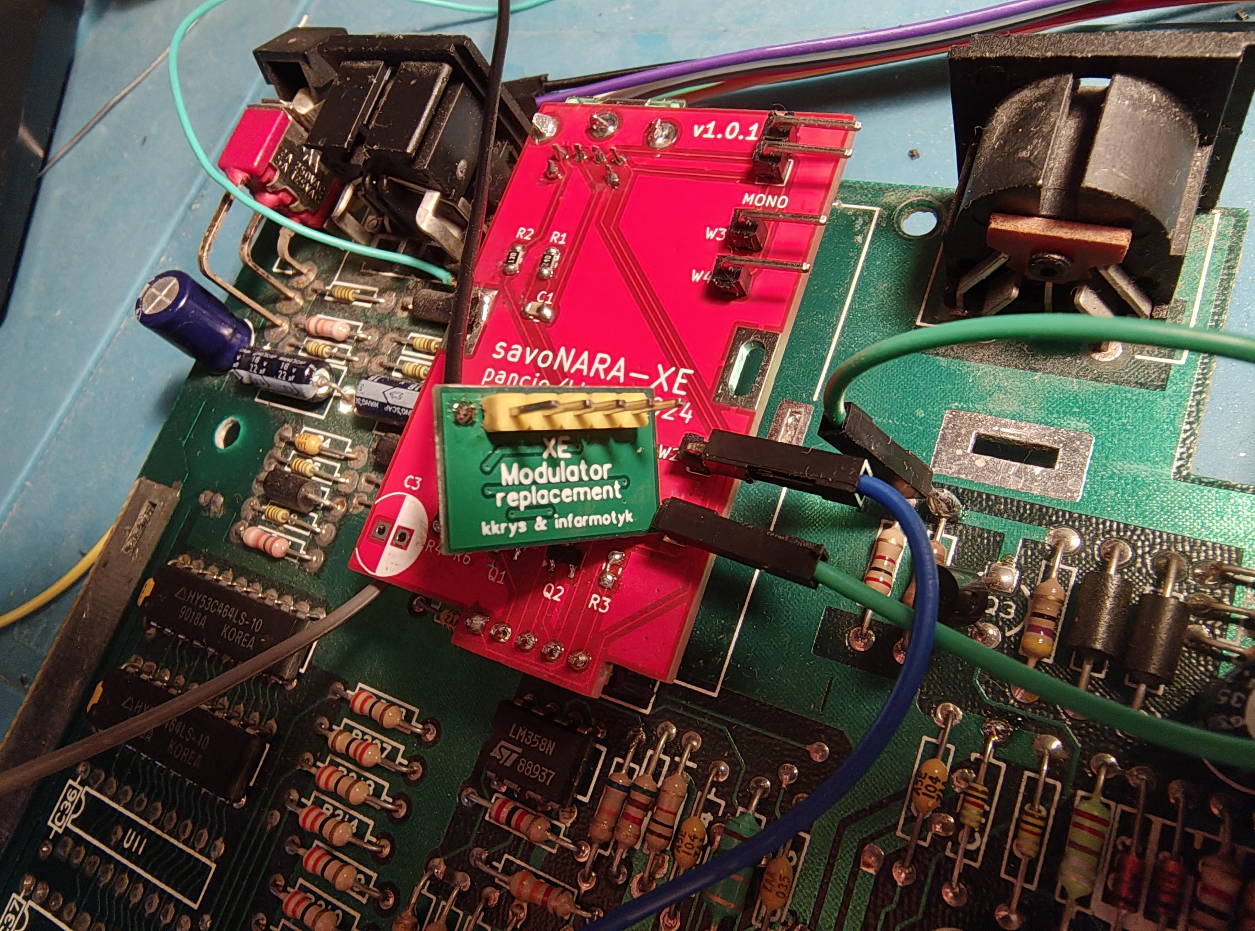

The main reason why we added additional components to PCB is reconstruction for COMPOSITE signal which is lost when modulator is drop from the Atari. So you may use standard monitor as always and use signal from miniDIN6 for ScanDoubler HDMI. Author of idea to recover COMPOSITE is my colleague KKRYS. He made easy interface called Easy Modulator Replacement in the past.

In this particular case it's replacement but PCB is prepared for "turbo" mode... We will se if it's possible to speed it up!andymanone hat geschrieben: ↑10.11.2024 20:09@Pancio:
Btw.: Nice Sally replacment ;).
Higher clocked or standard clock?
BR,

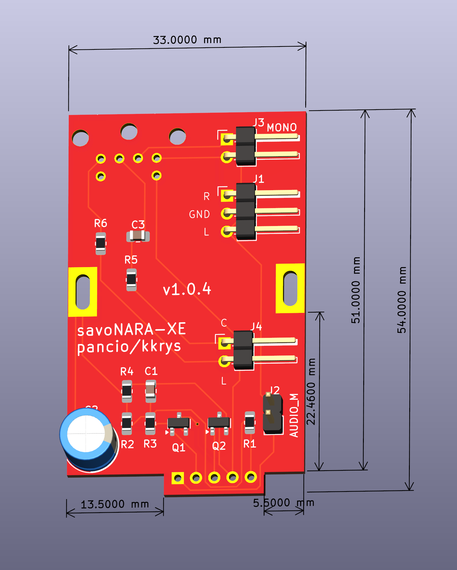

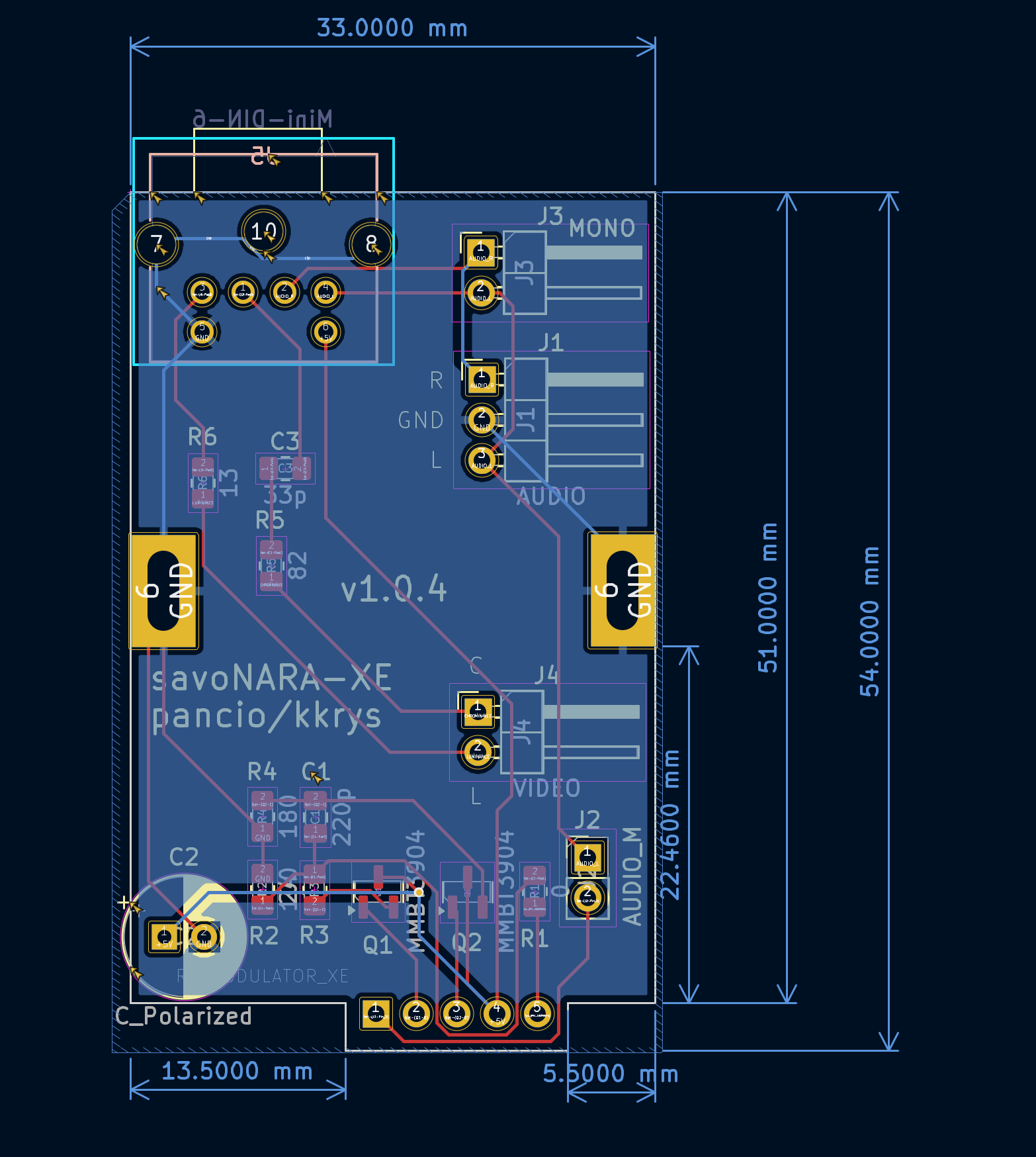

That's right. This extension only replaces the modulator but also provides LUMINANCE and CHROMINANCE signals, stereo sound and power to the Atari outside. Why?
Because in this situation you can use one HDMI converter with multiple Atari - until now to get an HDMI signal (or rather VGA/DVI) you had to use an expensive device. The mod is an alternative form of a scandoubler mounted inside. klaVO - Easy video mod with HDMI with audio stereo... The mod also provides power to this scandoubler.
I preferring use scandoubler inside but somebody's have more than one Atari and want to use these with HDMI - it's possible to install SavoNARA into these and use only one scandoubler. That's advantage. Nothing else... Maybe one more thing... you don't want to damage housing e.g. with bigger hole for HDMI/SCART/DVI socket.

It's funny story... SavoNARA paraphrasing word 'sayonara' and 'SAVO'. The 'sayonara' from Japanese means 'goodbye' and 'savo' means: 1. mold removal liquid, 2. very expensive small PCB made by Piotr D. Kaczorowski with 10 wires and miniDIN socket using for VBXE to transmit signal to TV equipped with SCART socket thru very expensive cable.
So, SavoNARA is junction from these definition and means 'Goodbye SAVO!'
Why I decided to develop SavoNARA (it's too big word to define tons of work I need to spend with so tiny and funny device :D ) ?
The functionality is similar but SAVO cannot produce video signal without VBXE. Moreover, SAVO eliminates the possibility of using the original monitor socket (cuts out the COMPOSITE signal) and broken backward compatibility. When author of SAVO start selling his solution forgot to say that SAVO can't work without VBXE... MAny people bought it and were very disappointed. The SavoNARA is my response to the ignorance of the author of SAVO and treating the community as naive buyers. It's nothing personally, just retro scene event :-)
Why I cannot use the same cable?
The answer is simple - because I don't want to go to war with the author of Savo, who is known for intimidating everyone with law firms and high costs. Besides, SavoNARA is an interface between Atari and scandoubler and SAVO uses more signals (RGB + 2xAUDIO) - there is no compatibility here.
Additionally, the intention behind SavoNARA was to use only one HDMI cable (with a scandoubler) - no other cable on the market offers such a possibility...
Of course you can use SavoNARA as SAVO, but it is a regression and degradation of functionality and completely pointless.
