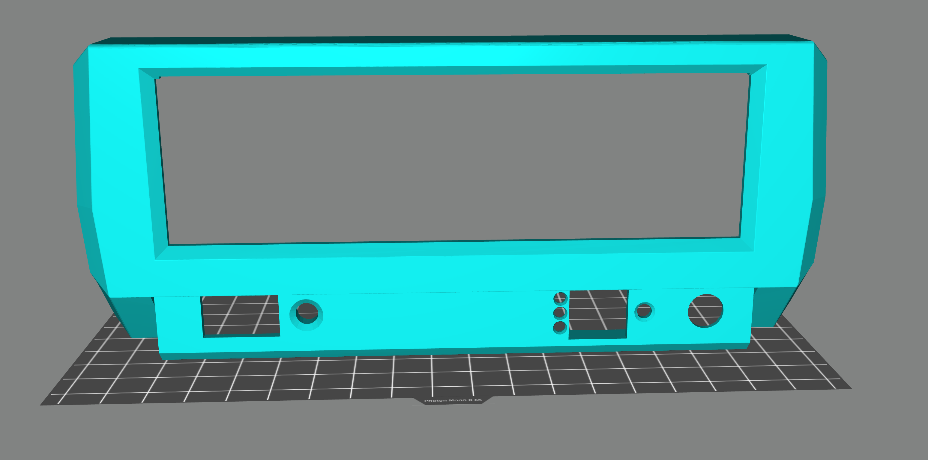

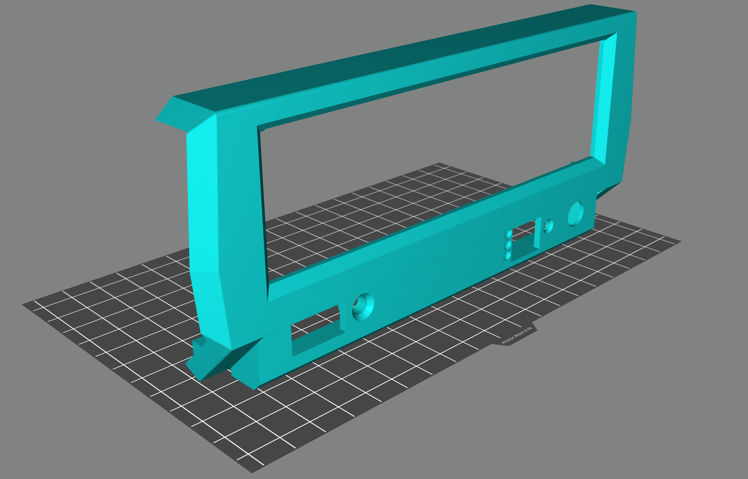

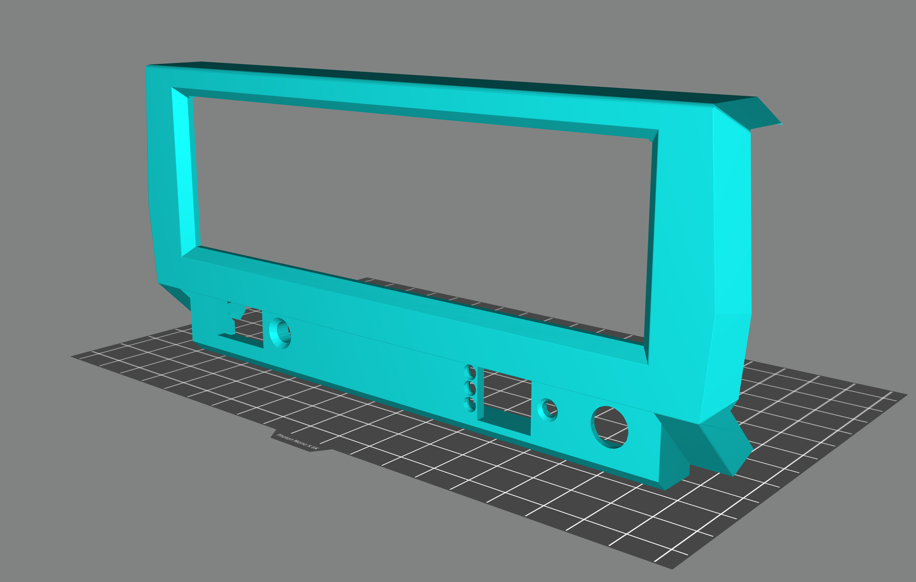

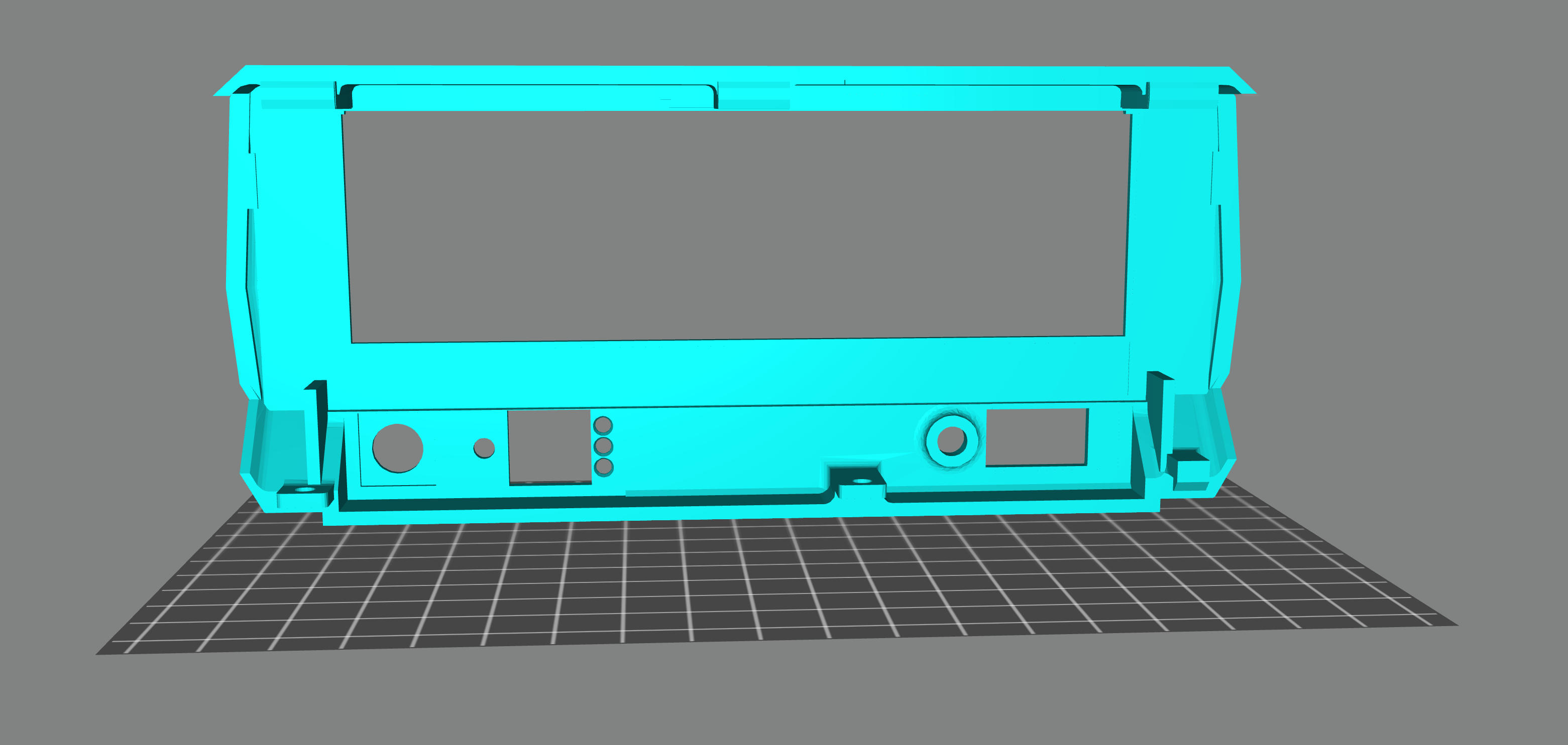

If you still looking for very good panel which fit MegaSpeedy you may use made by KKRYS project. It's completely redesigned and reinforced construction. If you are interested to but it, just let me know.
Some photos:
viewtopic.php?p=24316#p24316
Best Regards,
Some photos:
Best Regards,

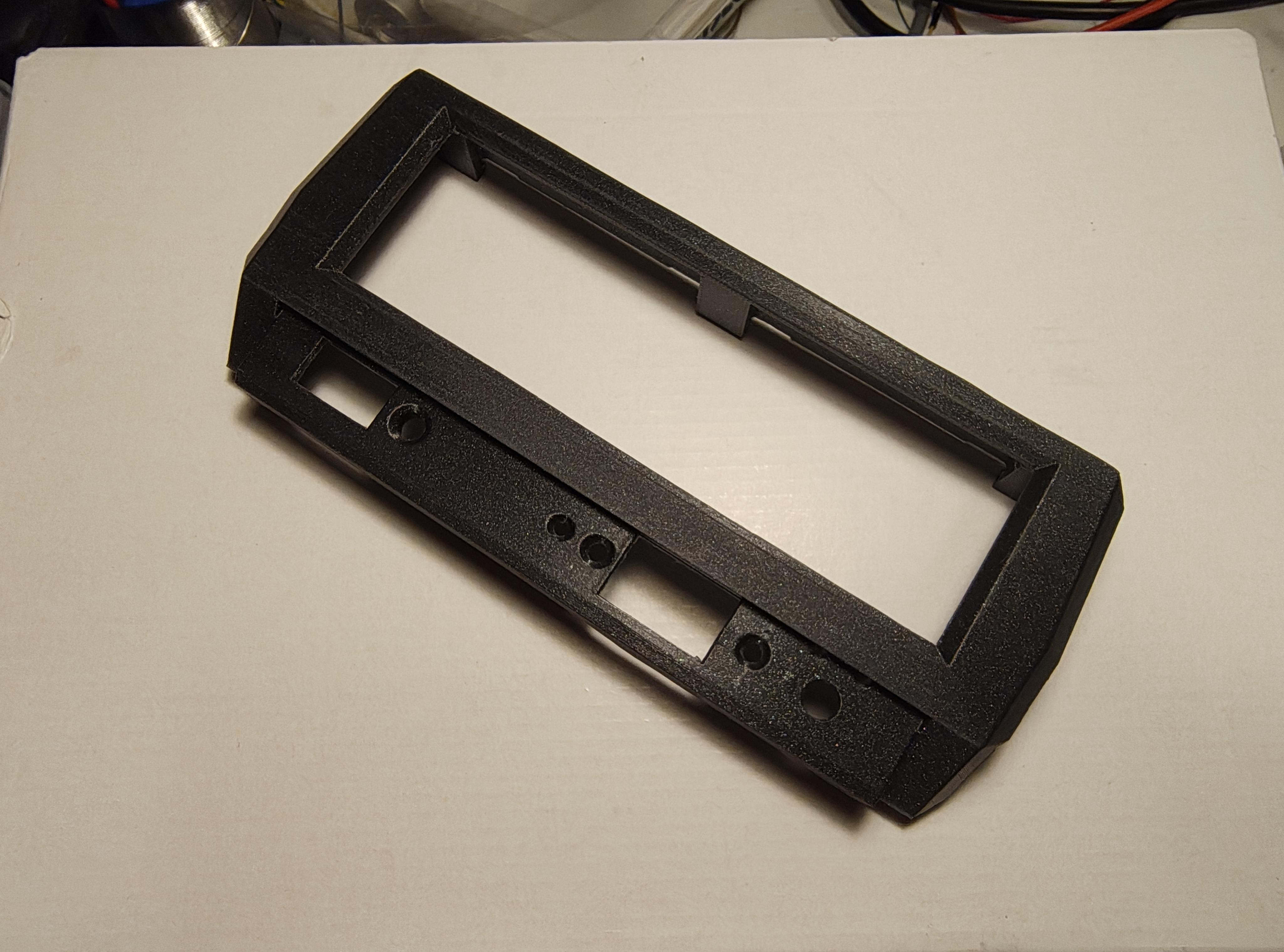

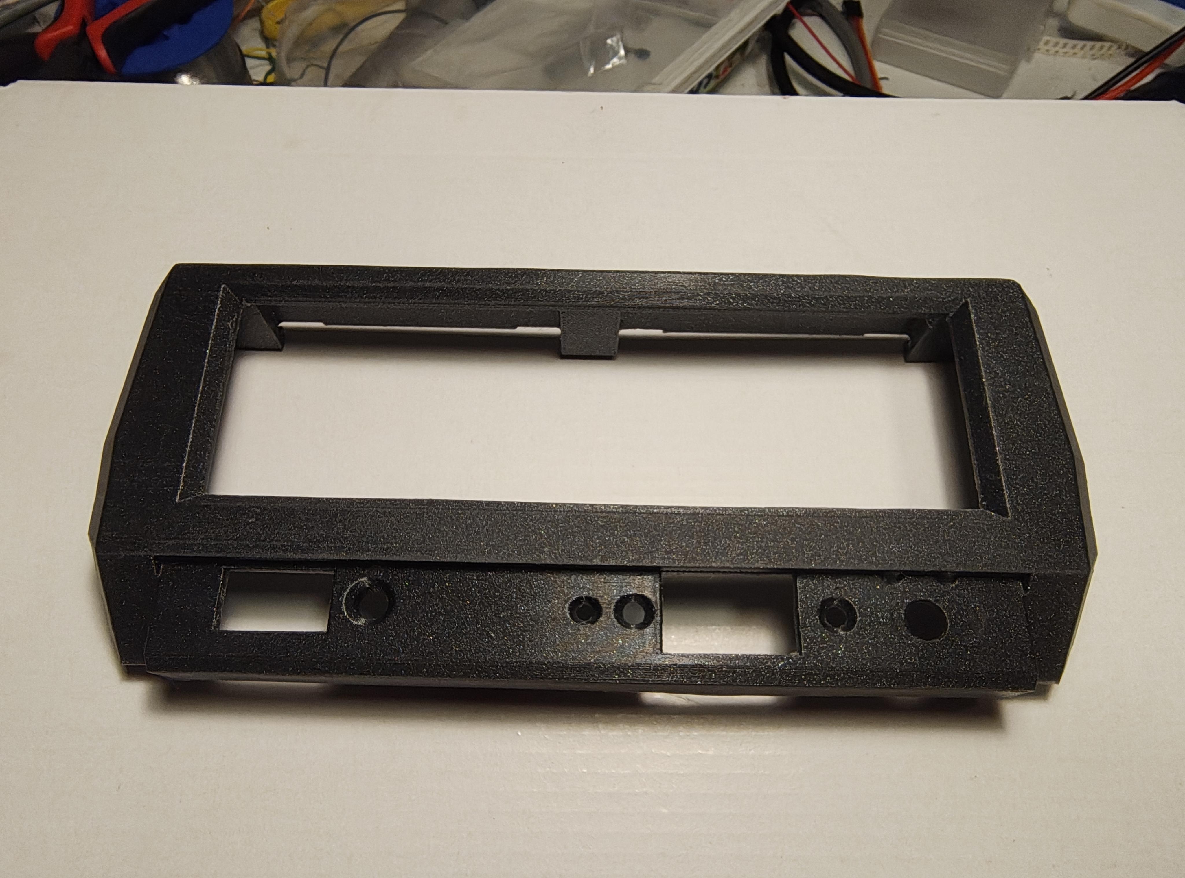

Re: Mega Speedy 2024 Front Paneel-kompatibel?

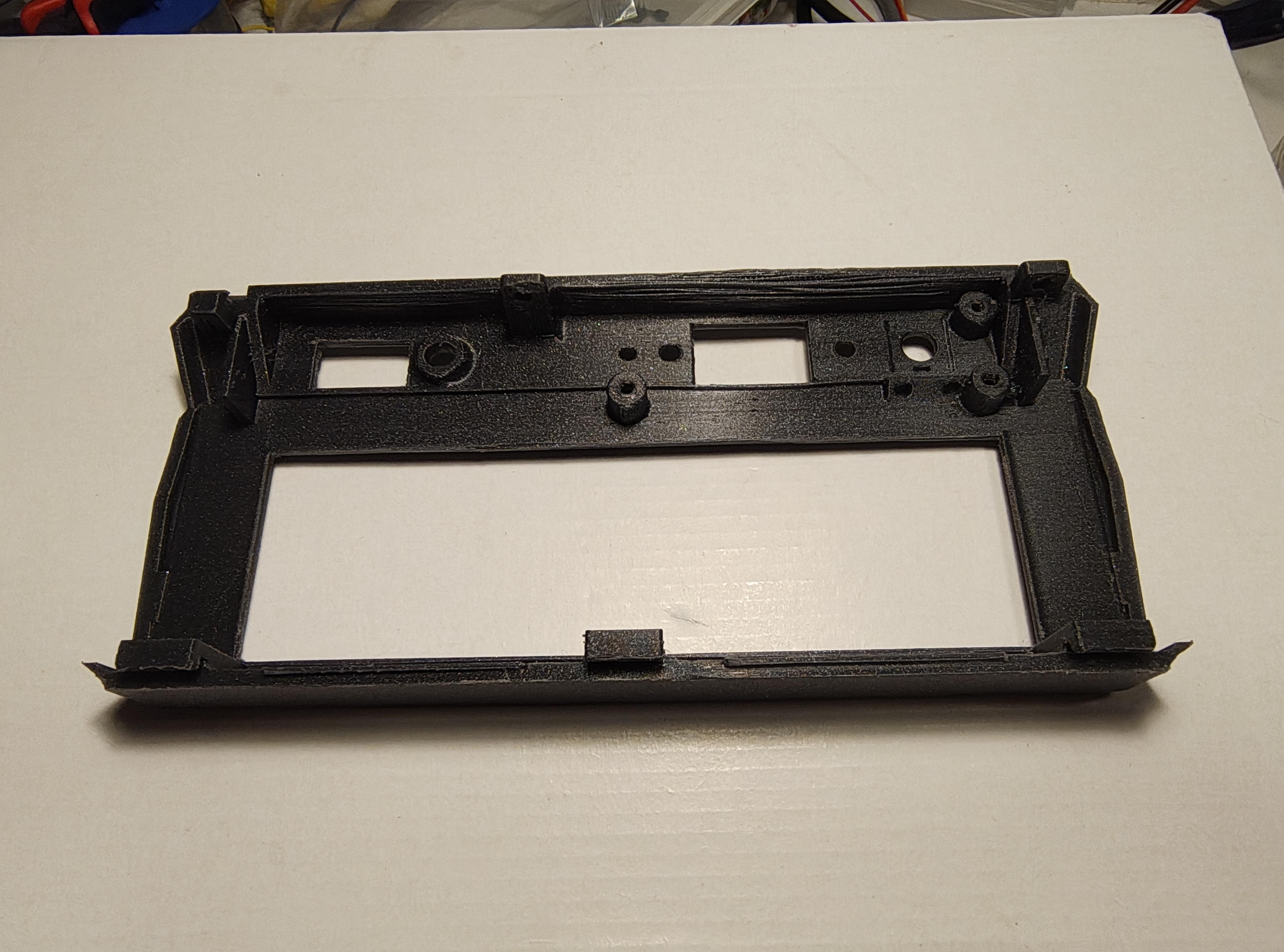

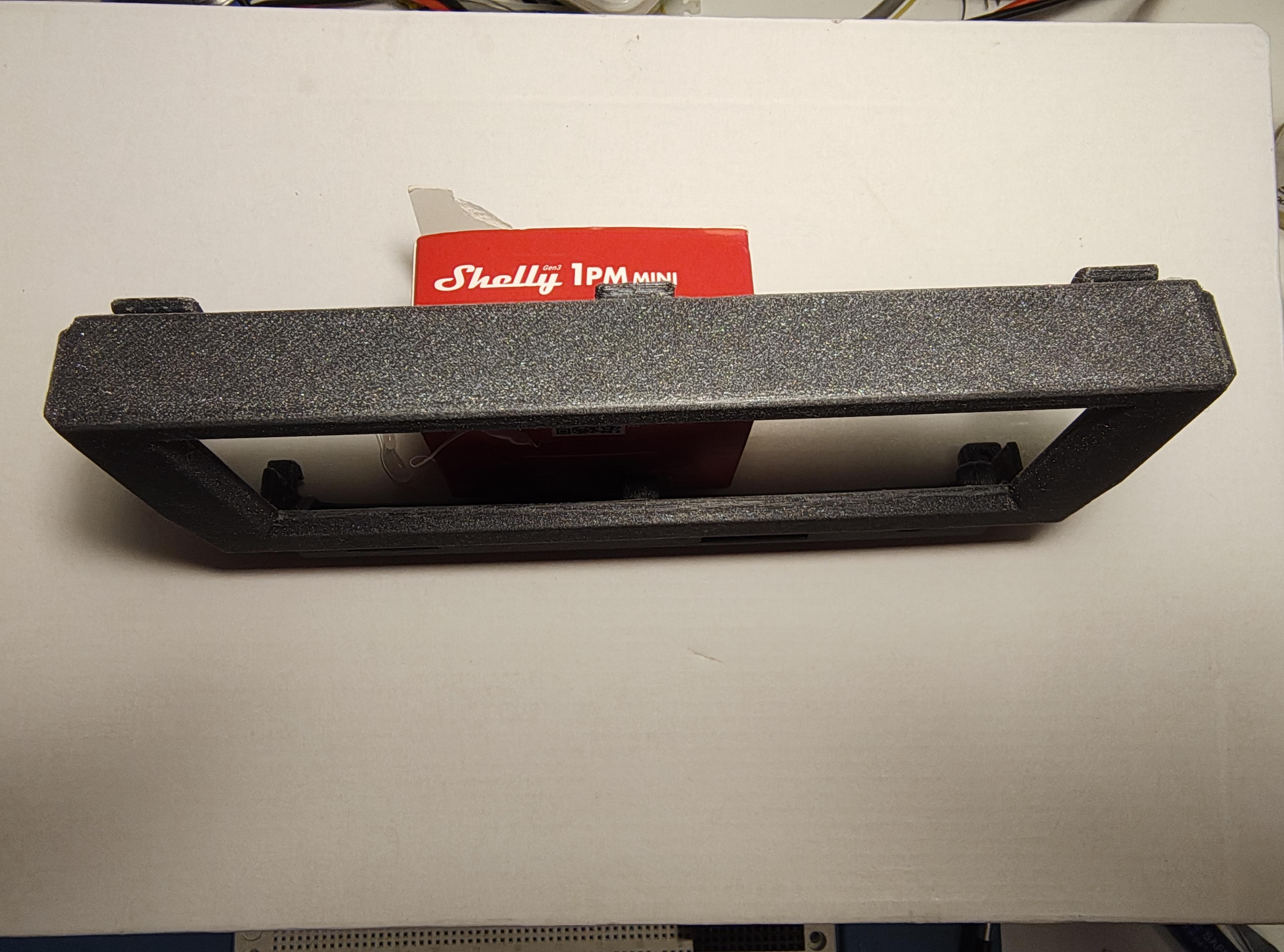

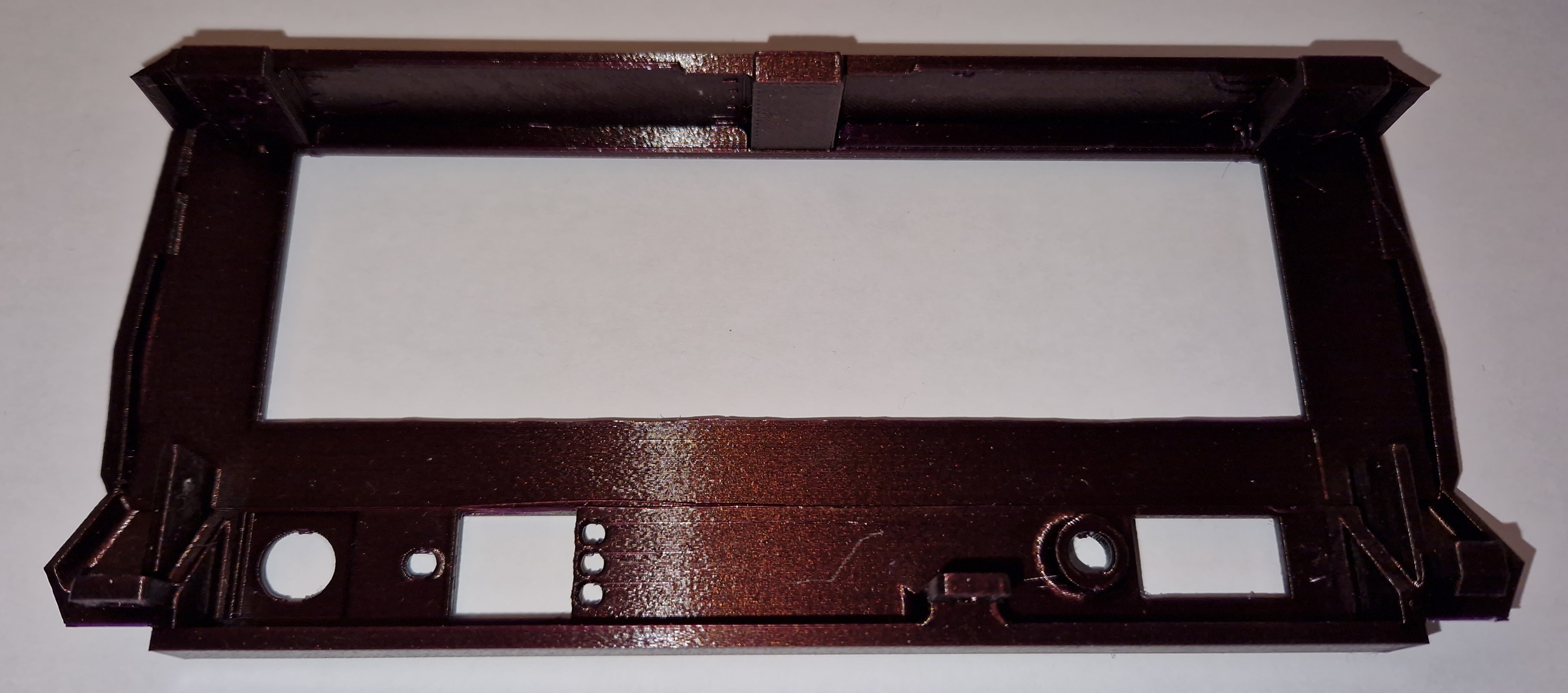

I´ve made one quick print (Standard quality, 0.2mm, 2 perimeter, 15% grid infill, 0.4mm nozzle) using Prusament PLA Mystique Brown:
Looks good, the bezel fits very well with my 1050 cases lying around. Unfortunately I haven´t any MegaSpeedy here, so I will sent this print to Franky (thread starter) for a test. He will tell us, if this one fits also better than the Galtron version
Until today nobody (?) found a really good matching filament color for this Atari specific brownish part (same like Atari XL machines). I´ve tried five different brown filaments, but most of them are more like chocolate (higher amount of red in the color´s appearance). Better matching filaments are wood-filling ones, but you can´t print them with good details, wood-filled filaments are more for simple decoration objects. Until today also at some threads talking about this topic at AtariAge nobody has a real good find. Maybe here?
PS: The not-so-good bottom part of the hole for the drive itself was me - a little heavy usage of the deburring tool to remove the supports
Mein PN Eingang ist hier abgeschaltet. Kontaktaufnahme bitte per EMail (siehe Avatar

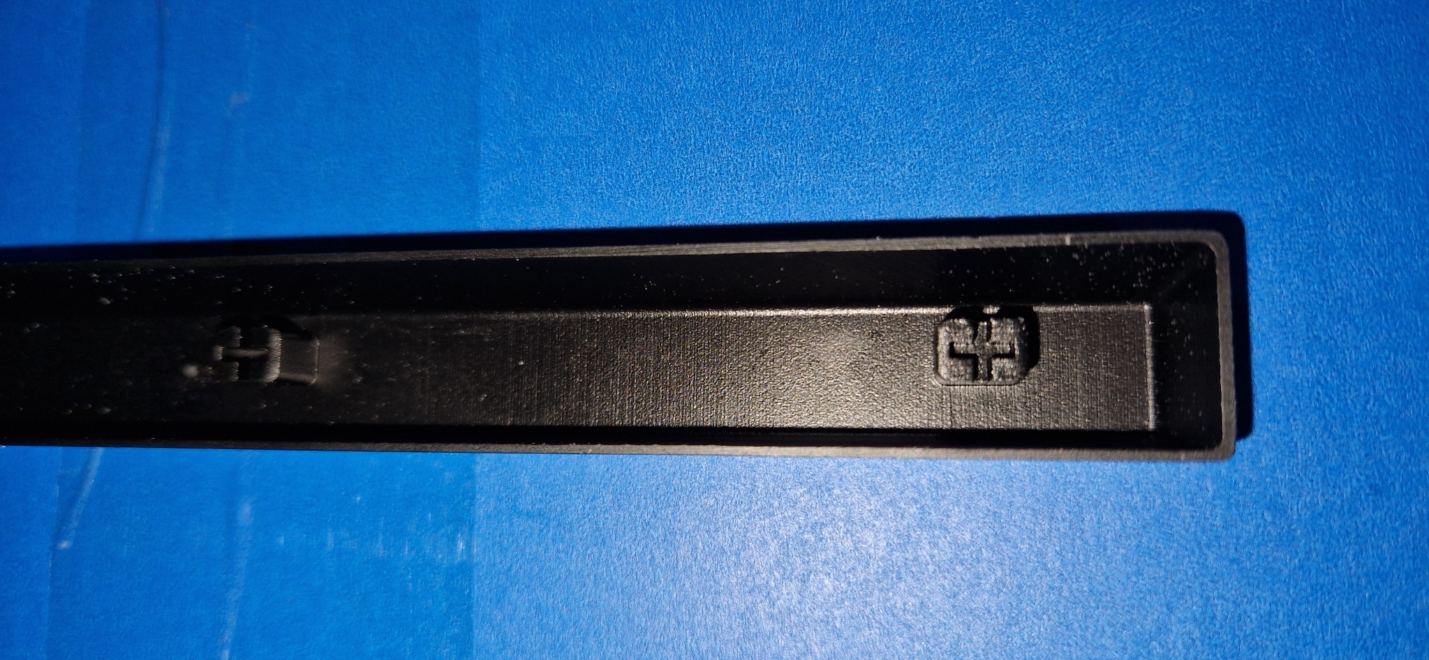

i have ordered 2 peaces at JLC3DP made in gray/black Resin.
We will see about Quality...
(and also ordered SPACE-Keycap for the new Keyboard)

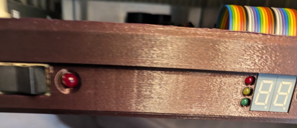

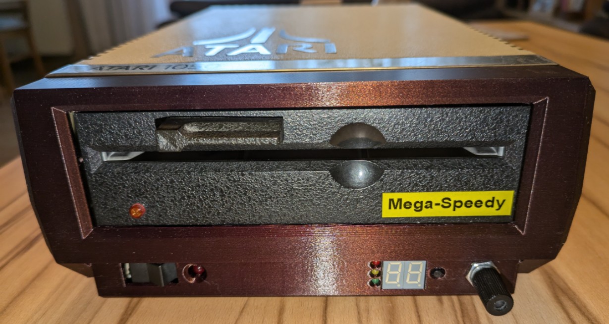

Ich habe den Einbau der von pancio entworfenen und von gedruckten Mega-Speedy Frontblende getestet.
Das Wichtigste: Ich konnte die Frontblende ohne Nachbearbeitung einbauen! Das schließt nicht aus, dass dies der eine oder andere tun möchte, um die Laschen zum anschrauben oder die Haken zum Einhängen der Blende etwa leichtgängiger gestalten möchte.
Das Fenster für die Leuchtsegmente, die Löcher für die 3 LED´s der Megaspeedy, sowie die Aussparungen für den Taster und die Power-LED passten auf Anhieb! Toll!
In dem Video sieht man, dass sich die Blende etwas hin- und herschieben lässt. Da ist in der Spritzgußblende eine feinere Erhebung, die das verhindert. (Gelb markiert.) Ich denke dass man auf den Gnubbel aber verzichten kann, da das Teil ja eh angeschraubt wird und damit fest wird und für 3D-Druck auch vermutlich zu klein/ungenau ist.
Einzig auf der linken Seite passt das Gehäuse nicht ganz mit der Blende zusammen. Warum, kann ich nicht sagen. Rechts passt es besser. Ich kann aber damit leben.
Ich freue mich jedenfalls sehr, dass es bei mir ein Ende mit der unfachmännisch erstellten alten Frontblende hat. Der 3D-Druck ist halt besser geworden.
Danke pancio und tf_hh für die gute Arbeit!!!

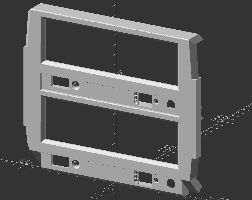

Hier mal ne Sonntags-Abend Spielerei mit OpenScad:
Ein Ansatz für bastelfreudige

Nice to see that Bezel is ok... but I'm not an author of project. Bezel was designed by my colleague Kkrys as for all my toys :-)
Best Regards,
pancio
Best Regards,
pancio

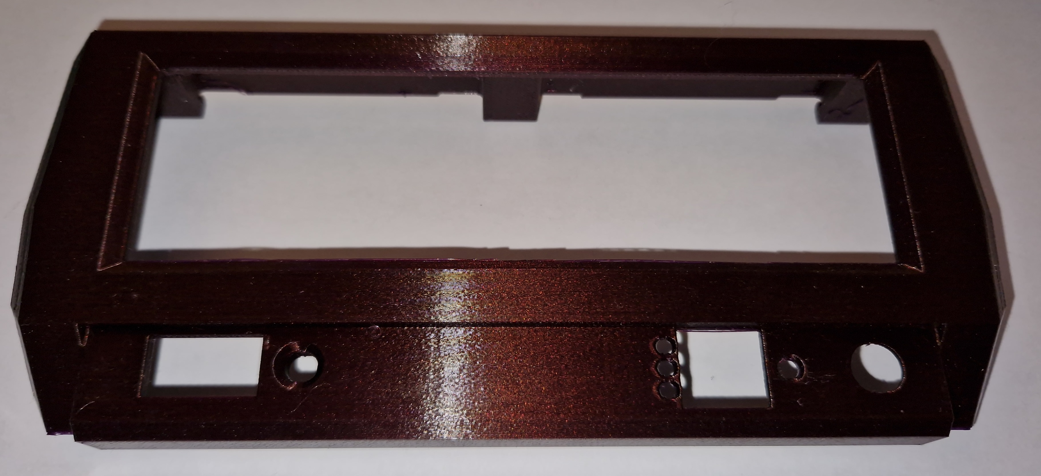

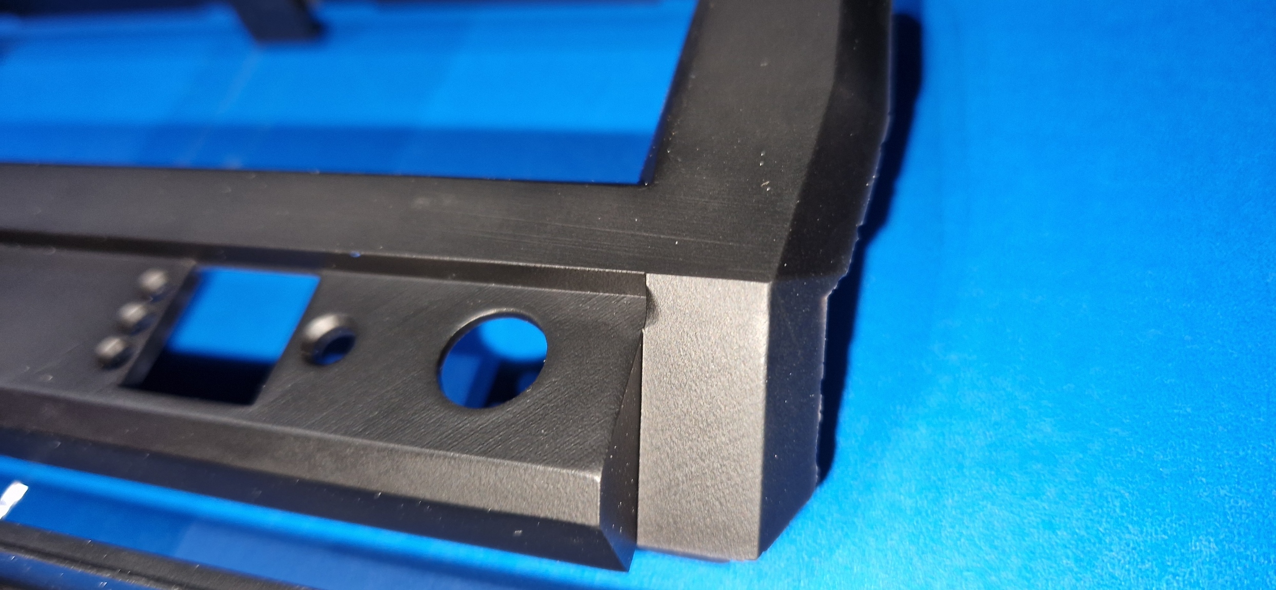

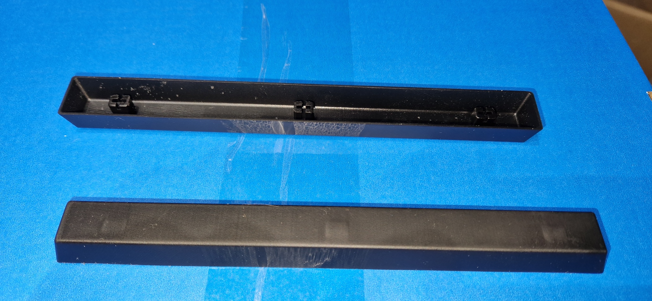

So, heute sind die bei JLC3DP bestellten Frontblenden (und Space-Tasten) angekommen!
UNGLAUBLICH gute Qualität!
Die Frontblenden sehen aus wie frisch aus dem Spritzguß !
Auch wenn sie nicht braun sondern mittel-schwarz (gibt noch dunleres Schwarz) sind,
sehen die echt top aus!
"Anprobiert" hab ich die noch nicht, aber das ist schonmal ne super Sache!
Gekostet haben die 15$ plus den teuren Versand..
Schaut hier:
Schaut hier:

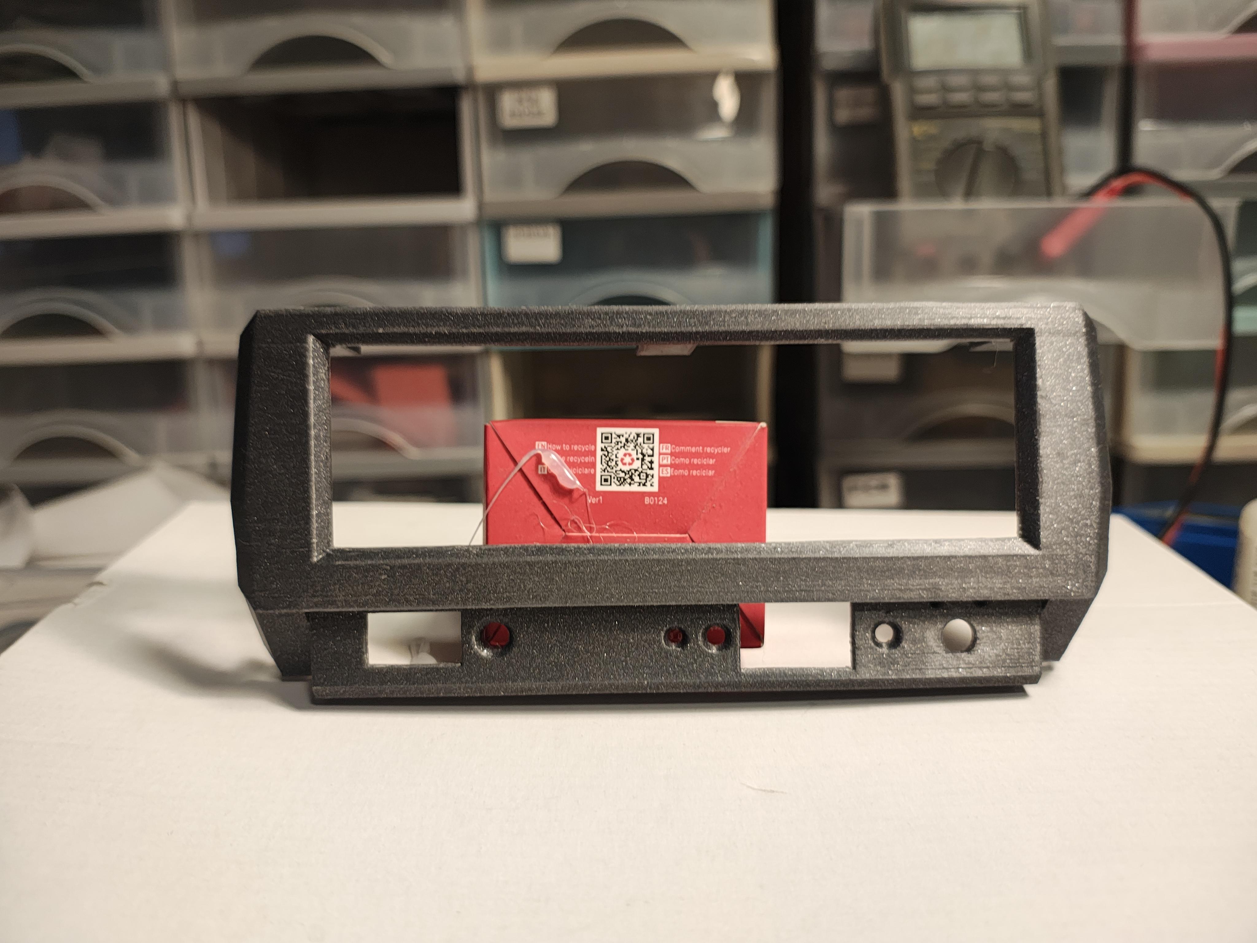

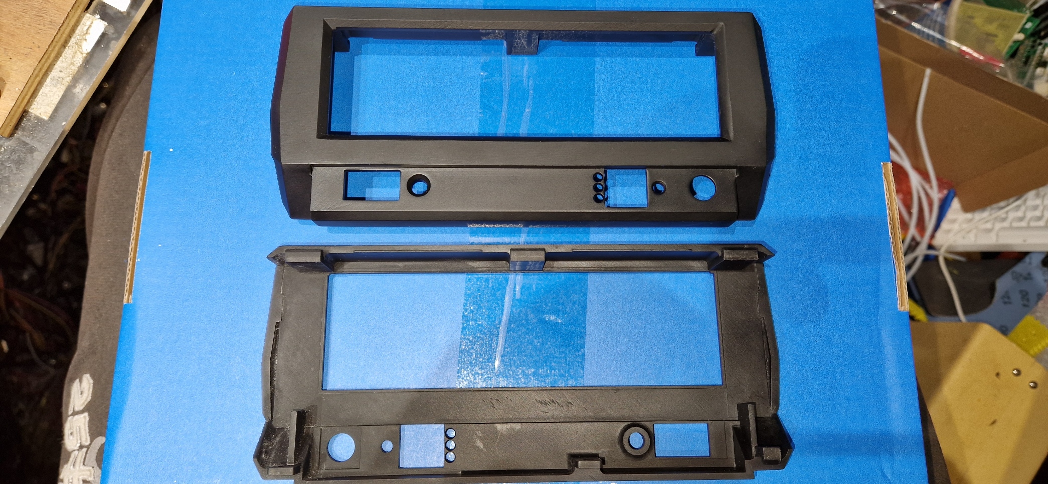

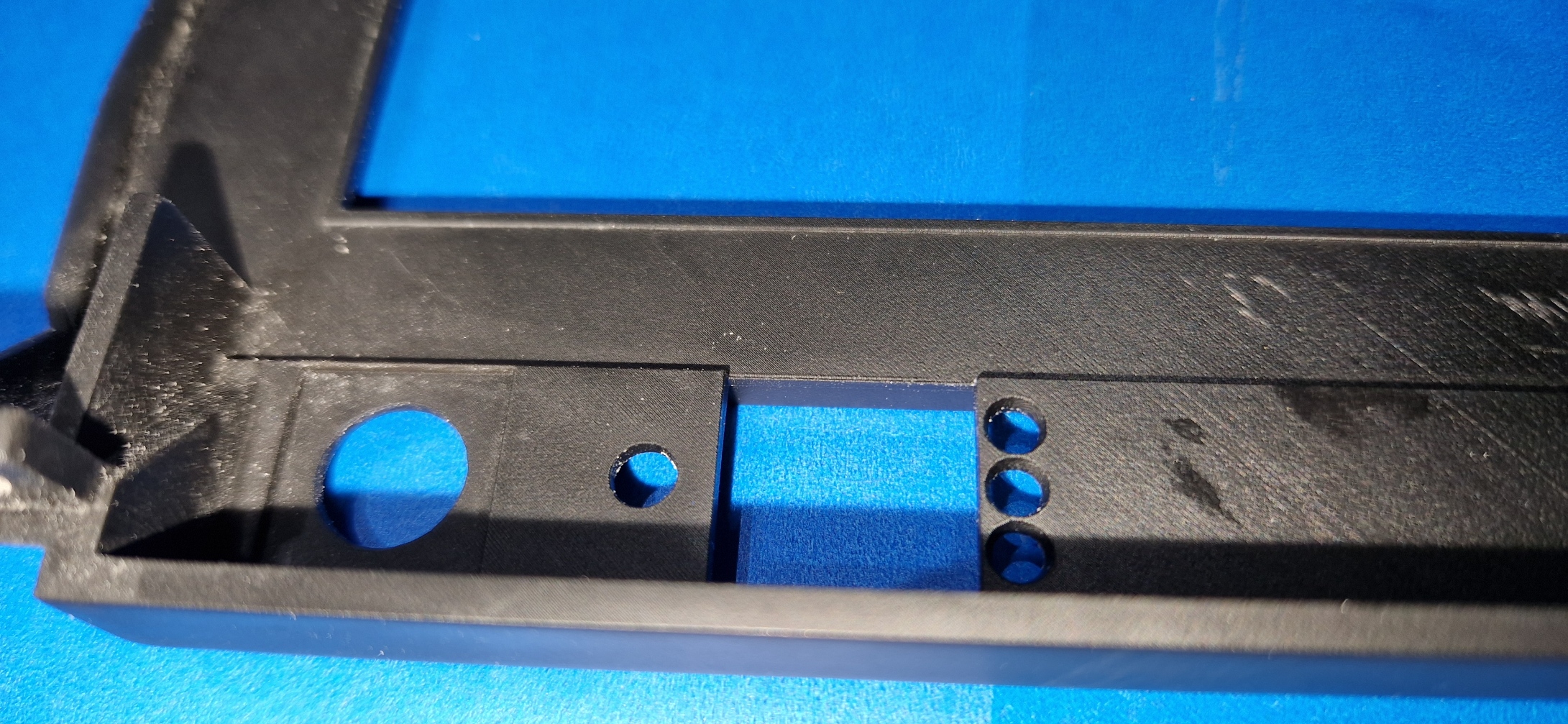

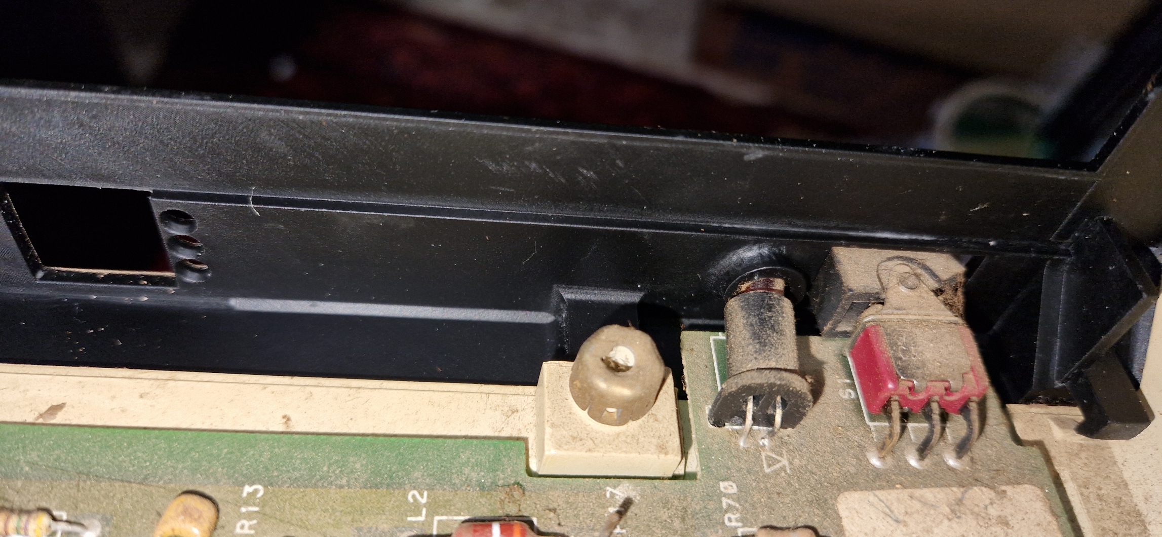

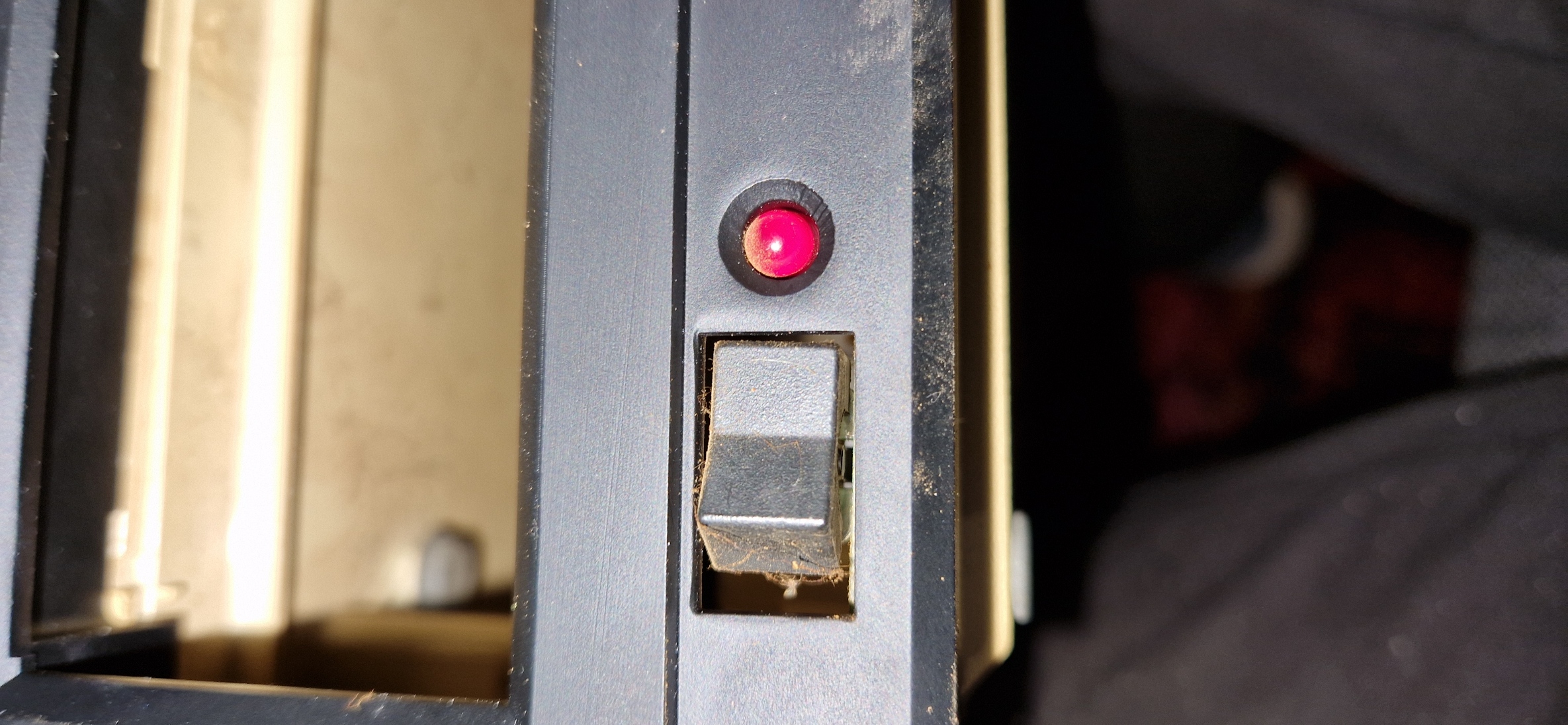

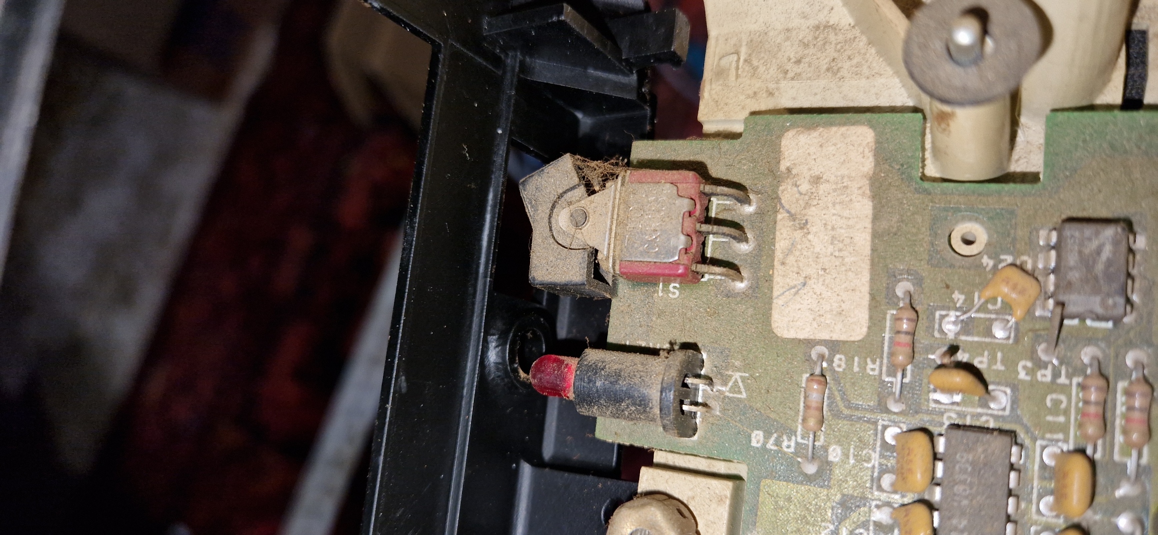

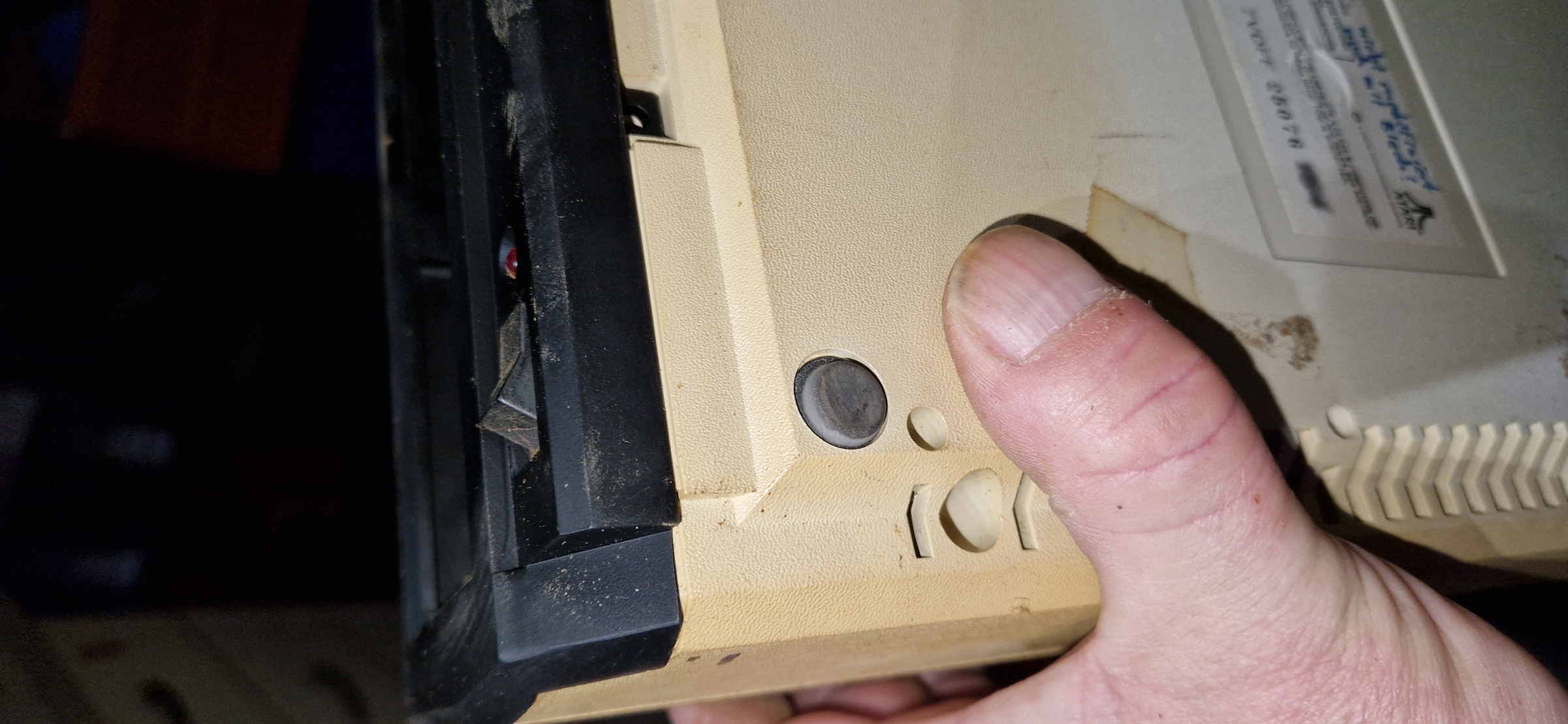

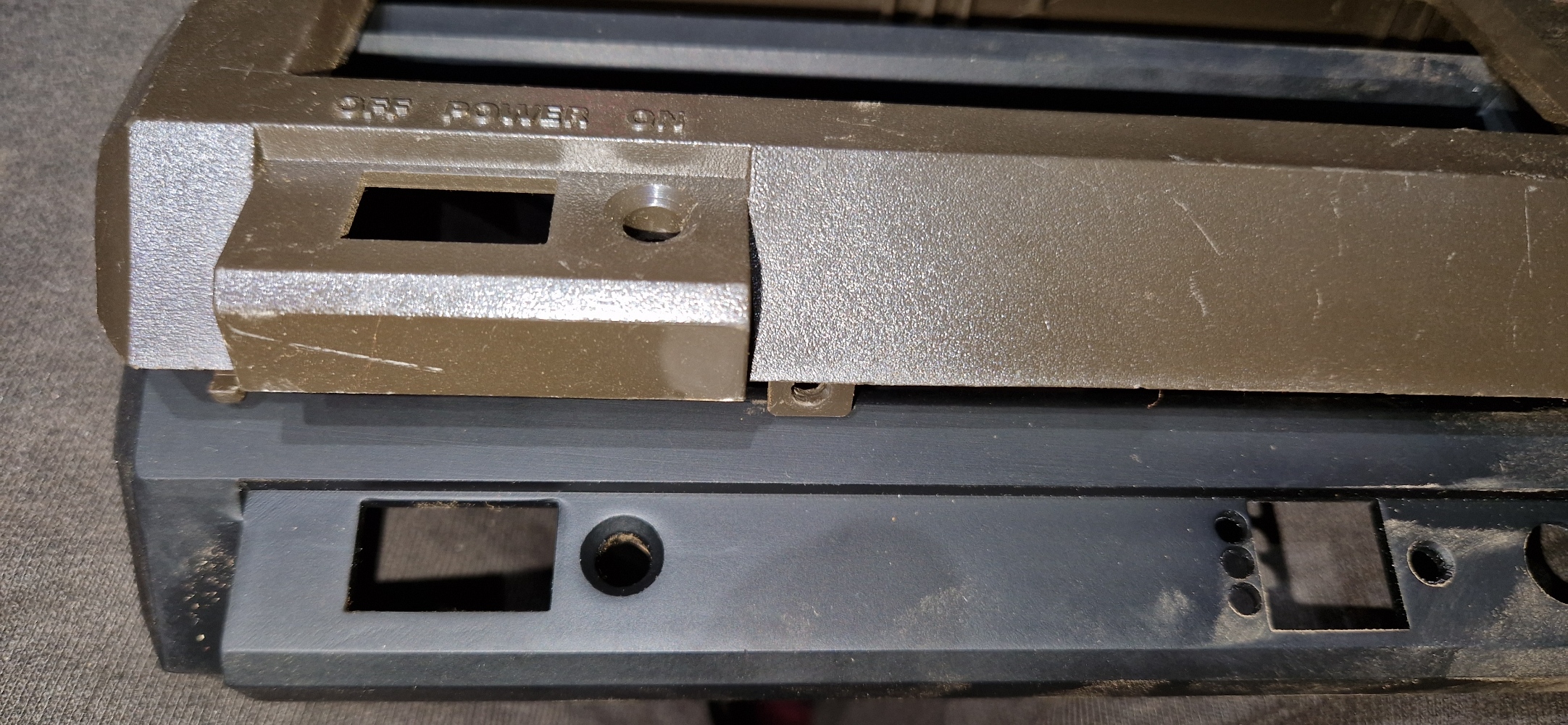

So mal eben ein verstaubtes 1050 Gehäuse genommen und die neue Blende "anprobiert":
Die oberen Klemmen müssten nochmal bearbeitet werden, man bekommt das Oberteil zwar gut rauf, aber schlecht wieder ab.
Die Rechte Seite sieht etwas komisch aus...
Und ein großer Fehler ist da auch:
Das Loch für den Netzschalter und für die Power-LED sind um ca. 5mm verschoben!
EDIT: Und die Beschriftung fehlt komplett!
@pancio Ther must be a bit of work on the model...
Schaut auf den Bildern:
Vergleich original und neue Blende, Schalter+LED... (Ja ich weiss, auch die tiefste Ecke meiner Werkstatt muss aufgeräumt und entstaubt werden
Also es fehlt nicht mehr viel und diese Blende wäre 100%ig perfekt.
Vielleicht setzt sich pancios Kumpel noch mal dran...
- pancio
- Beiträge: 321
- Registriert: 31.08.2021 07:31
- Has thanked: 309 times
- Been thanked: 312 times
As I quickly investigated , 1050s were made with two different PCB so probably you have the second one... I'll check and confirm it if I find other model...
BR,
pancio
BR,
pancio
ah, ok.
Then i will have a look at my other 1050s..
i didnt know about different pcb and even if, i would expect the same Position for LED and Switch.
