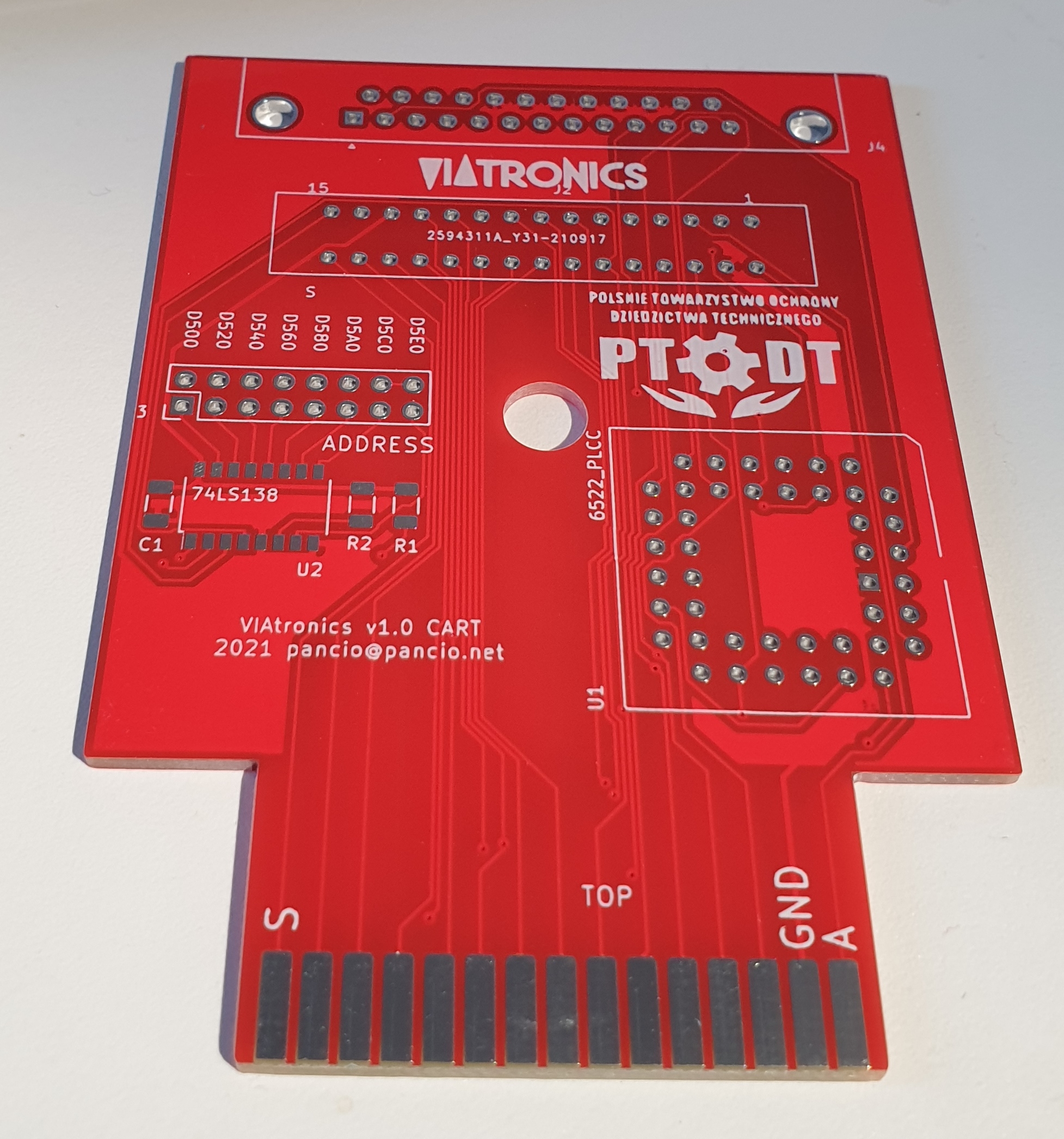

Introduction
Inspiration for this mode was nightly discussion with some friends and request to make device which will be capable to connect ant EPSON/IBM printer to Atari. We had MicroPrint on the market in the past but nowadays it’s rather not possible to find it and use with any printer. In case I developed VIAtronics – it’s combination of VIAtari (presented years ago) and Centronics (actually only cable from it). Idea is very simple: connect VIAtronics to CART/ECI with cable LPT (DB25) -Centronics (C36) and any printer which can emulated EPSON or IBM codes.
Hardware
PCB based on standard CART/ECI slot contains VIA6522 two 8-bits parallel ports with control signals. Additional IC 74HCT138 is use as address decoder. All required by printer signals are connected to DB25 female port. On the PCB you may find selector for device address which can be selected from $D100-$D1E0 or $D500-$D5E0 with $20 step.Additional four pin header are connected to PA/PB/CA/CB signals and might be use for other task depend of your idea :-)If you are using cartridge e.g. Koala Illustrator or some text editor, you may use it together with VIAtronics but you need to check addresses used by cartridge to avoid conflict with VIAtronics.Project is made as Free Hardware - full documentation will be available on my page: https://systemembedded.eu
Software
At this moment I use very simple program written in Turbo Basic XL which can send text/graphics to printer from memory. This is nothing spectacularly and anybody might write “driver” for any printer if you have instruction with steering codes. I checked EPSON standard on Star LC-20 whichwas very popular in ‘80-’90 last century...

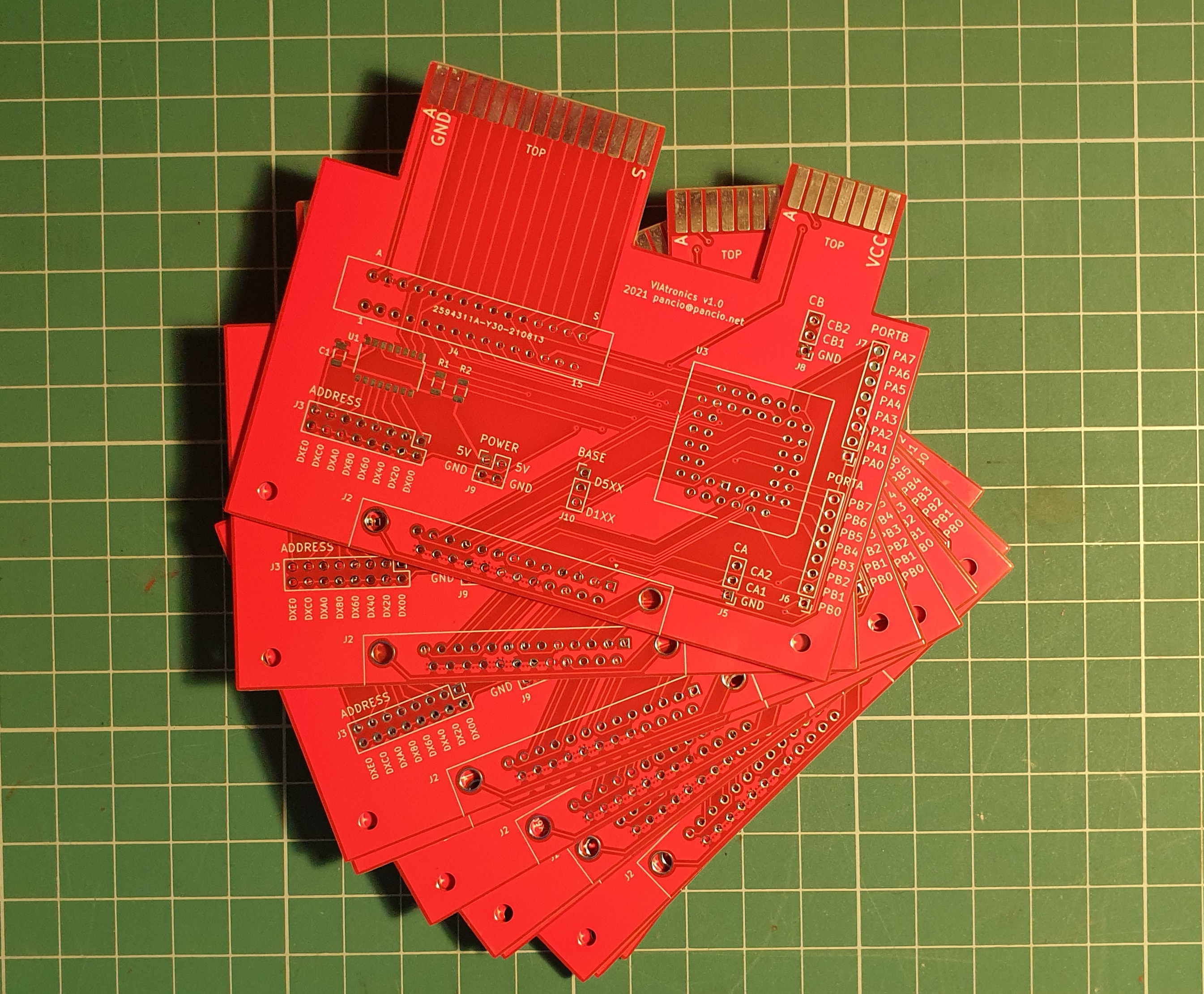

Today I received PCBs... I will assembly first piece today or tomorrow. I hope no issue on that!

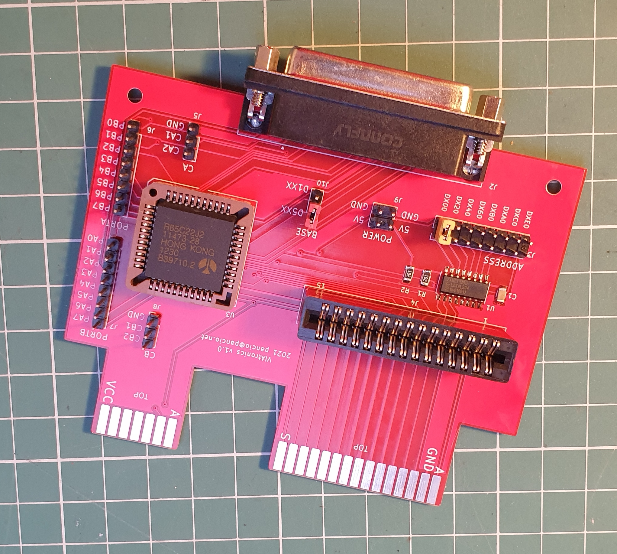

Good Evening,
I did it. First PCB was assembled...
...and I found one issue with ports description:
it hasn't influence on parallel port and will be corrected with new PCBs order.
Well, time to print.... (t.b.c.)

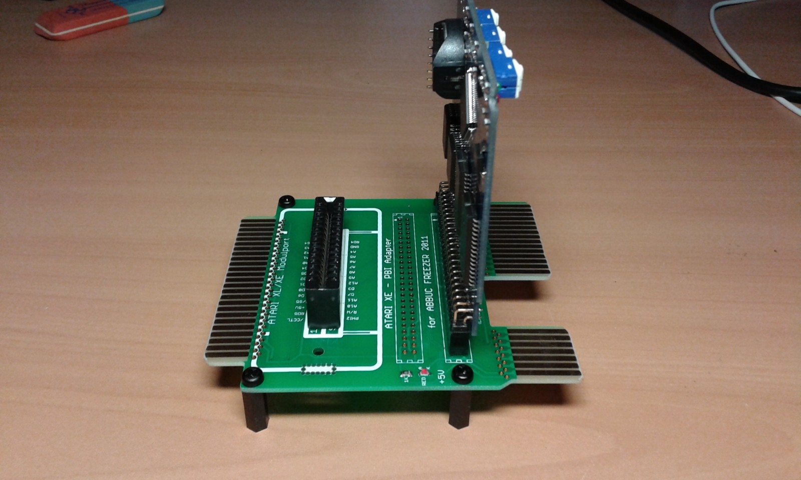

JAC!
Beiträge: 202
Registriert: 18.06.2021 23:13
Has thanked: 175 times
Been thanked: 201 times
Re: VIAtronics v.1.0
Beitrag von JAC! »
This is how it looks. A board with XE on one and XL on the other side. The actual board is plugged in there with a standard connector.
pancio
Beiträge: 321
Registriert: 31.08.2021 07:31
Has thanked: 312 times
Been thanked: 318 times
Beitrag von pancio »
Very practical and good design for both kind of edges... As I understand, we need female - female slot in order to connect it to A800XL? Is this PCB available to buy or gerbers to make it own hands?
pancio

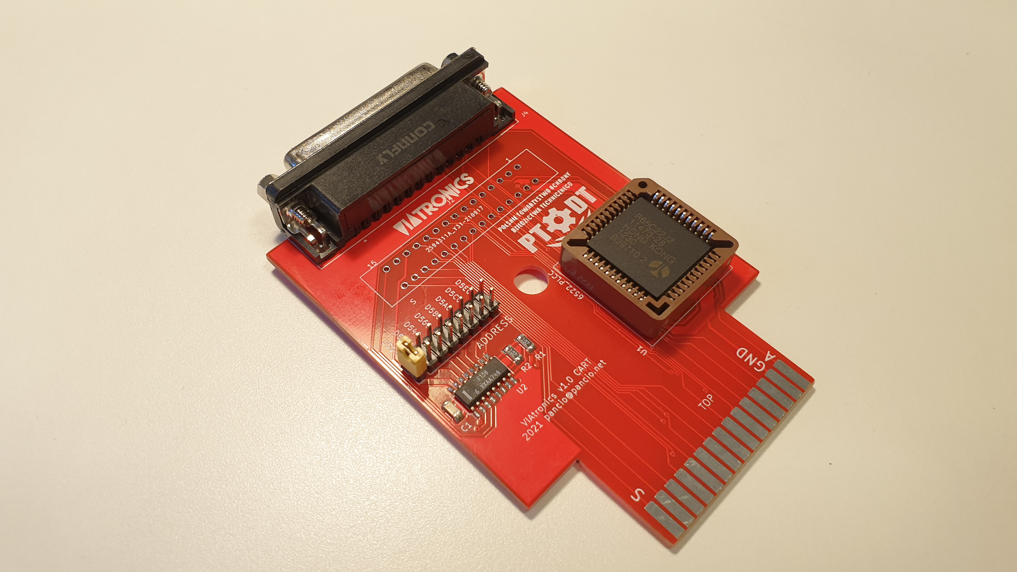

Hi Guys,
Today I received PCBs for CART version of VIAtronics:
VIAtari CART version PCB
I'll try to assembly it immediately and confirm work as ECI version soon :-) (I hope).
It's work! :-)
https://youtu.be/57TVK9HEm9g
