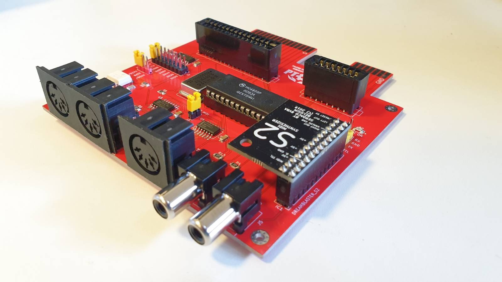

I would like to present new device for Atari XE series which can play/record MIDI files on Atari 8-bit computer. Idea was taken from SIO2MIDI
but I decided to use CART/ECI port to communication with MIDI devices because in case I may use SIO independently for load/save data during MIDI working. In case possible it to use MIDI
sequencer based on Atari with direct access to FDD and/or other mass storage device, for example with AVG CART.
Additional features:
- possibility to play external MIDI source like MIDI keyboard or synthesizer,
- MIDI IN/MIDI OUT LED indicators on board,
- serial communication with 31250 b/s, 125 kb/s or 2mb/s with PC (using e.g. FT232 dongle),
- fully transparent for other cartridges/interfaces (based on D1XX/D5XX address decoder),
- equipped with S2 DREAMBLASTER is ready to play (similar like SIO2MIDI,
First issue of MIDIcar v1.0 is dedicated for Atari XE series but I’ll prepare version for XL series as soon as possible.
I hope, good player will be prepared soon :-)

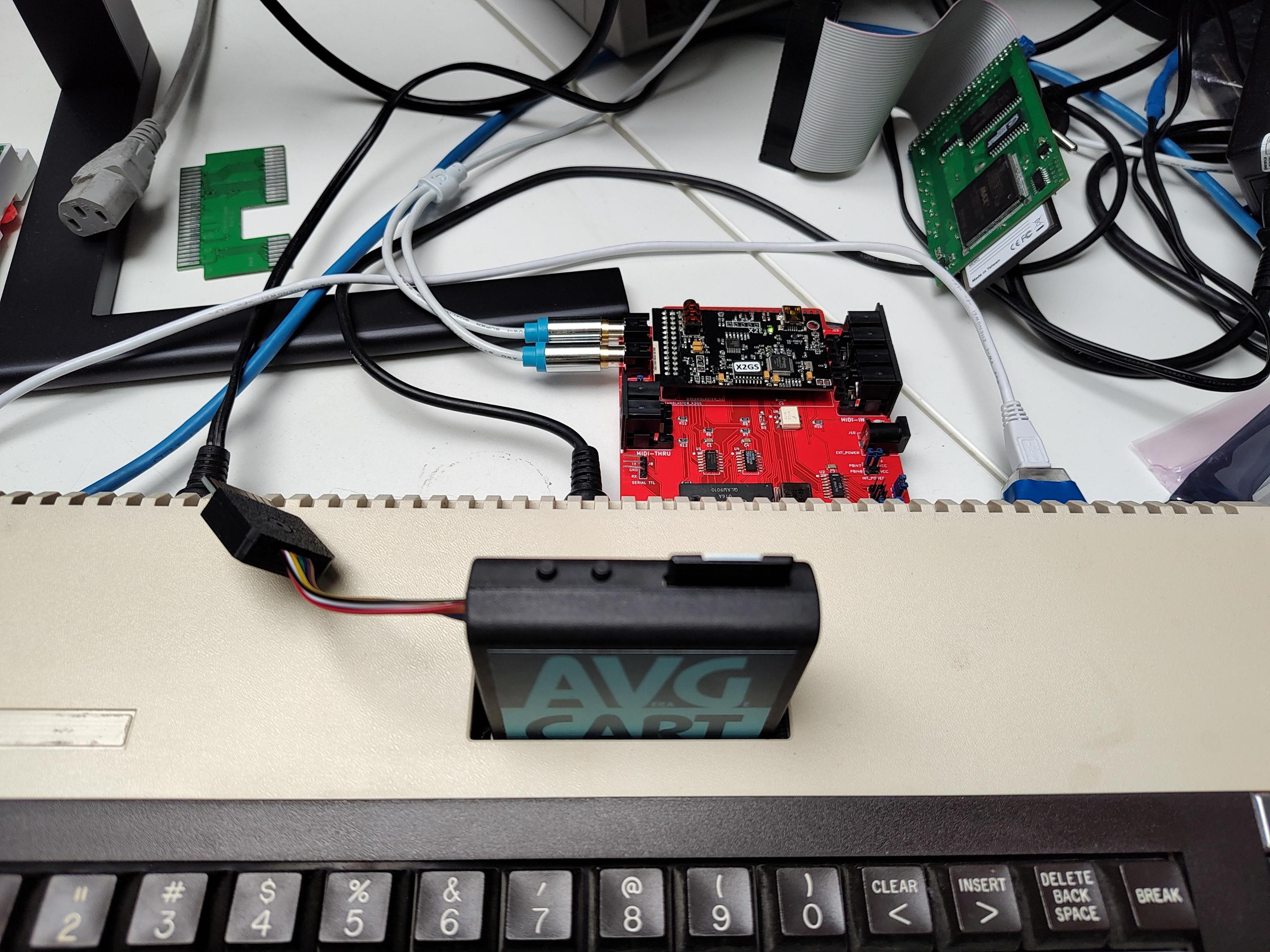

Version 1.0.1 based on CART/ECI was finished (better quality, good RCA sockets).
Just for fun I stocked two MIDIcar and try to play on both in the same time :-)
And they playing together :-)
signal-2022-07-03-145752.mp4
(19.24 MiB) 524-mal heruntergeladen
Next step... finishing XL version...

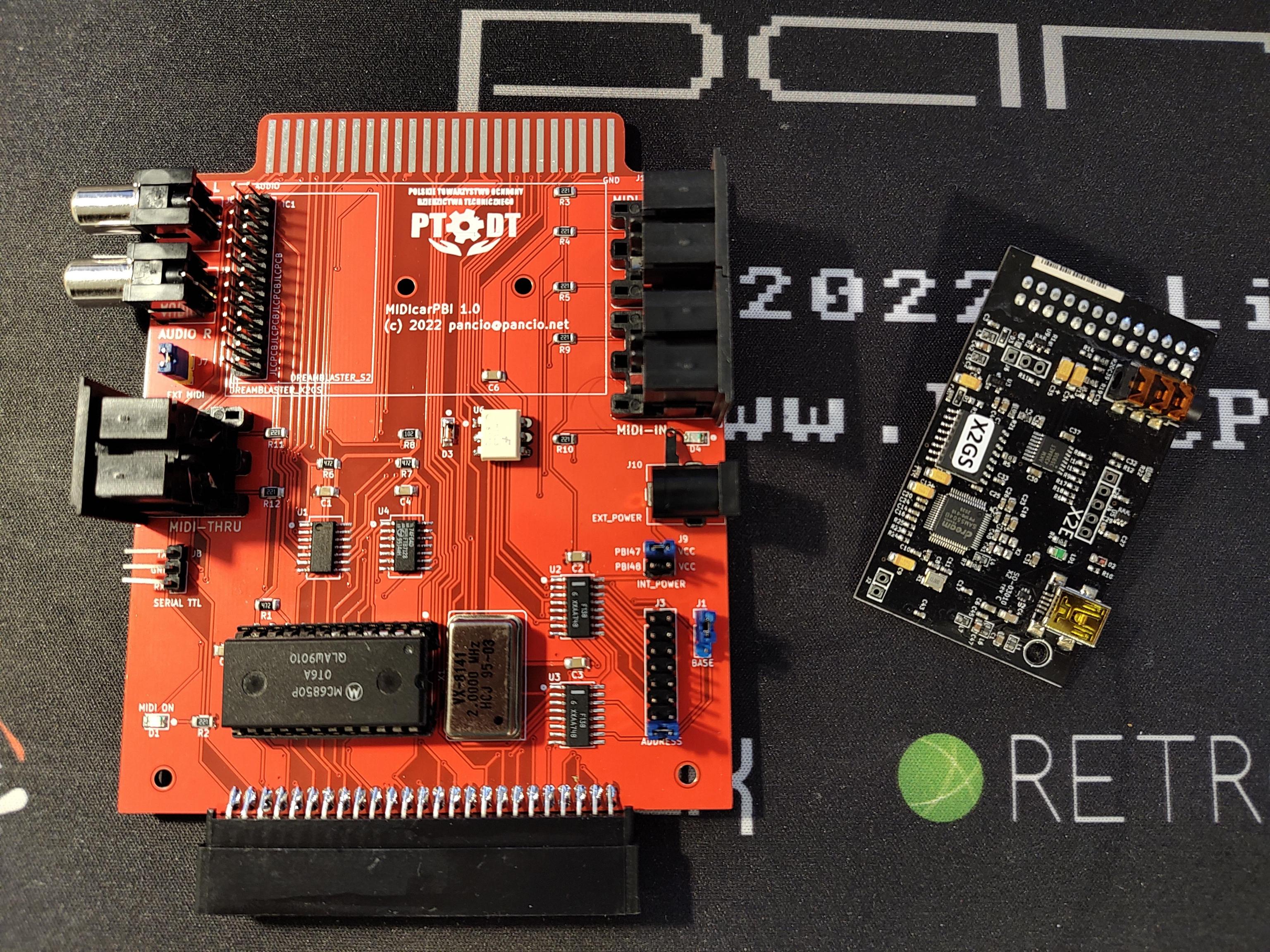

Hello Friends!
I pretty finished MIDIcarPBI version. I'm not sure the pass-thru PBI slot will work OK but we will see. If anyone has notices or comments, please let me know. I plan to send this to production this week :-)
PCB dimension: 120x100mm. On the bottom we will have 50pin PBI connector (I haven't 3Dshape for it!)
what changed...
- according known issue with AVGcart I decided to add better wire on power lines,
- full address decoder added
- possibility to power device from external power supply (Atari 800XL power modification not needed)

A few renders - just for fun (or resin case in the future):
revision 1.0.3 will be equipped with TTL<>USB-C converter based on CH340E for high speed serial...

Hello Friends!
I know... so much time... but it was happened :-) MIDIcar for XL computers :-) It's very stable and working without any issue with IDE+ under SpartaDosX...
Enjoy!

The MIDI Thru port is very close to the video cable. Won't that cause any problems if somebody tries to use plug a cable into the MIDI Thru port?
BTW have you tried to plug one MIDIcarXL into the back of another? And a third into the second? :mrgreen:
Sincerely
pancio
Beiträge: 297
Registriert: 31.08.2021 07:31
Has thanked: 268 times
Been thanked: 270 times
Re: MIDIcar – independent, easy to use MIDI player/recorder
Beitrag von pancio »
Hi Mathy,
Yes... sorry I know - hobby is very important but family too :-) The reason why XL version was made is that I don't know when I'll finish common model for both XL/XE with additional middle board as we discussed in other very good topic: viewtopic.php?f=3&t=1035
So, gerbers and full project files is available on my page - anyone is willing to do it by himself. I'm not sure, XL version will be made by us and available in shop. I may prepare three modules because have a free PCBs from prototyping process. If anyone is interested in - let me know privately.
According to MIDI ports positions... well it's compromise between PCB length and usability... there is no issue with connecting passthru cable but it's looking little bit strange :-)
not yet... because I've only one MCpbi assembled at this moment. Will try, be sure :-)
