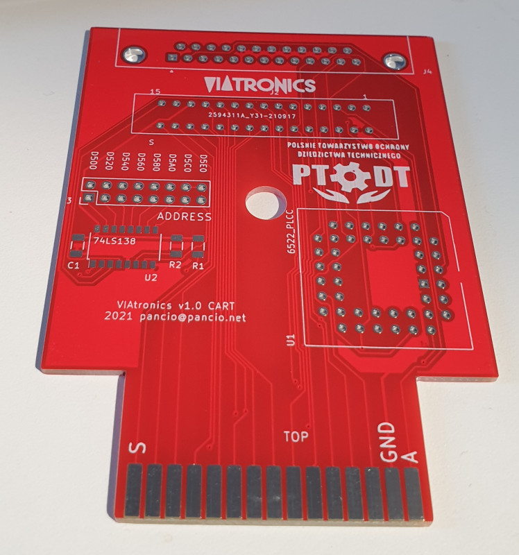

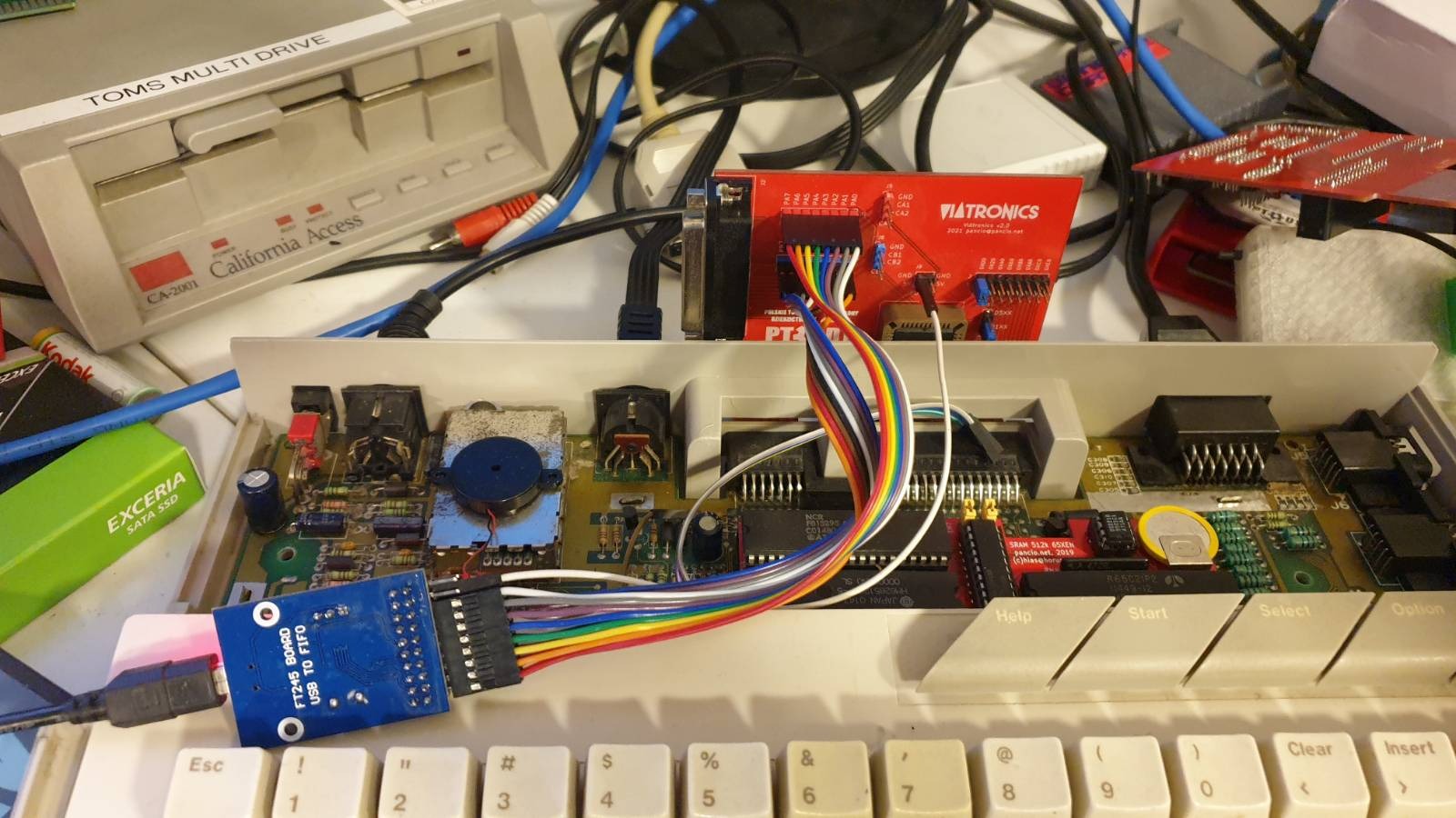

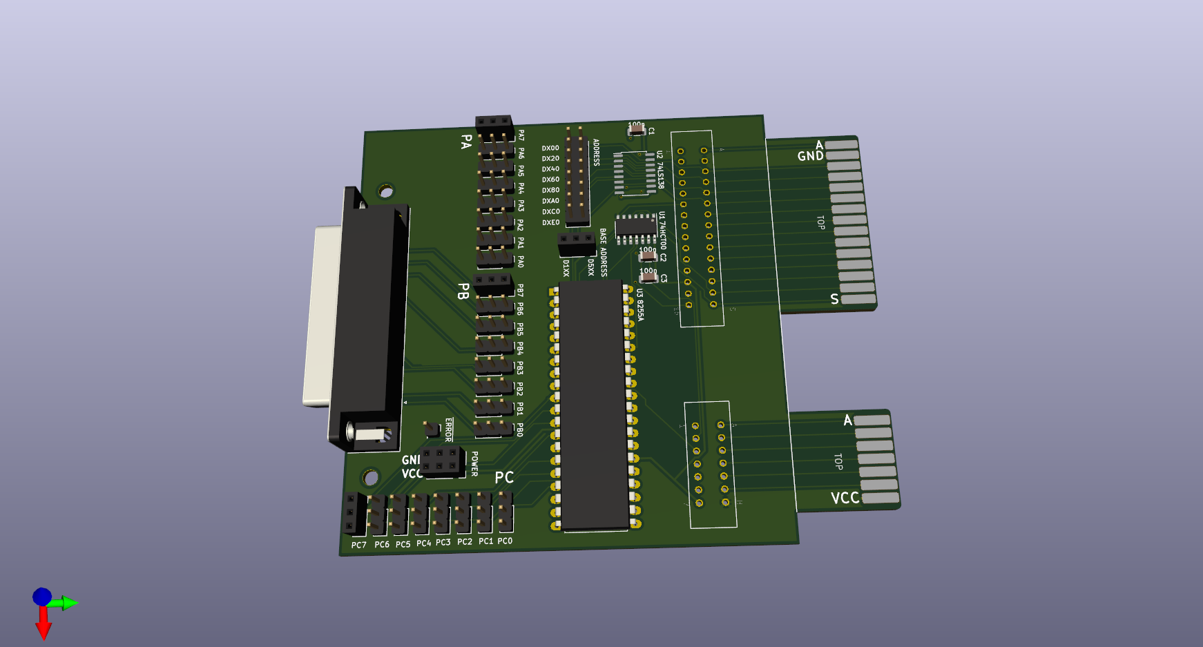

Introduction
Inspiration for this mode was nightly discussion with some friends and request to make device which will be capable to connect ant EPSON/IBM printer to Atari. We had MicroPrint on the market in the past but nowadays it’s rather not possible to find it and use with any printer. In case I developed VIAtronics – it’s combination of VIAtari (presented years ago) and Centronics (actually only cable from it). Idea is very simple: connect VIAtronics to CART/ECI with cable LPT (DB25) -Centronics (C36) and any printer which can emulated EPSON or IBM codes.
Hardware
PCB based on standard CART/ECI slot contains VIA6522 two 8-bits parallel ports with control signals. Additional IC 74HCT138 is use as address decoder. All required by printer signals are connected to DB25 female port. On the PCB you may find selector for device address which can be selected from $D100-$D1E0 or $D500-$D5E0 with $20 step.Additional four pin header are connected to PA/PB/CA/CB signals and might be use for other task depend of your idea :-)If you are using cartridge e.g. Koala Illustrator or some text editor, you may use it together with VIAtronics but you need to check addresses used by cartridge to avoid conflict with VIAtronics.Project is made as Free Hardware - full documentation will be available on my page: https://systemembedded.eu

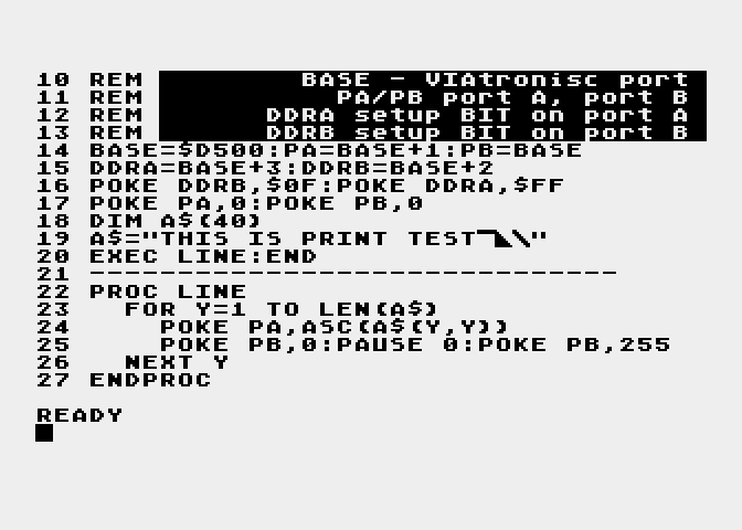

Software
At this moment I use very simple program written in Turbo Basic XL which can send text/graphics to printer from memory. This is nothing spectacularly and anybody might write “driver” for any printer if you have instruction with steering codes. I checked EPSON standard on Star LC-20 whichwas very popular in ‘80-’90 last century...
P. S.
I might say you some interesting information regarding software... Some very interesting program will be released soon... see:
https://www.youtube.com/watch?v=-Yzea2HfhkM&t=27s
It’s developed by my colleague Atari Fan and should support both Micro Print and VIAtronics interfaces for graphics printing.
Manual: Regards,

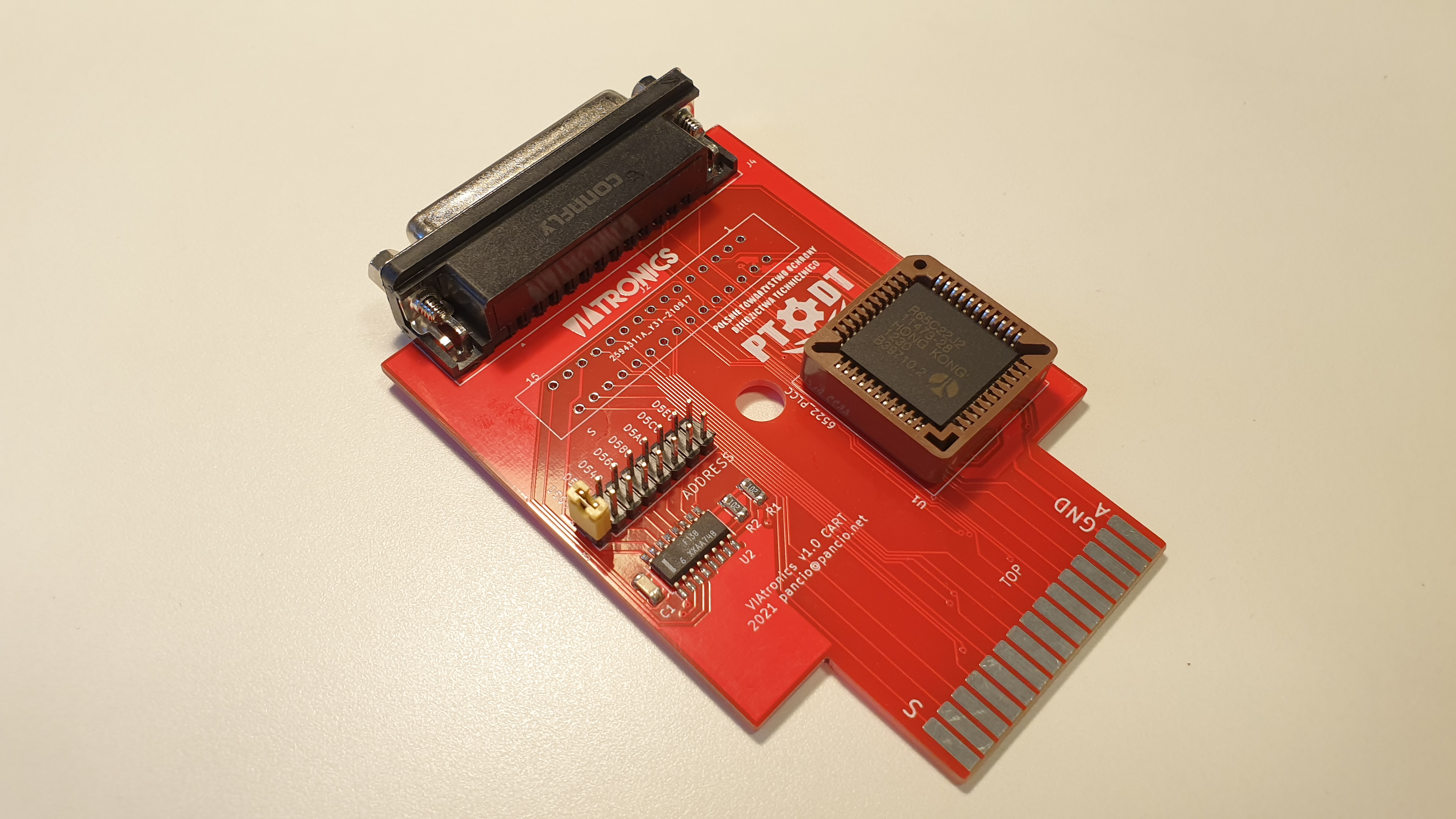

Re: VIAtronics v.1.0

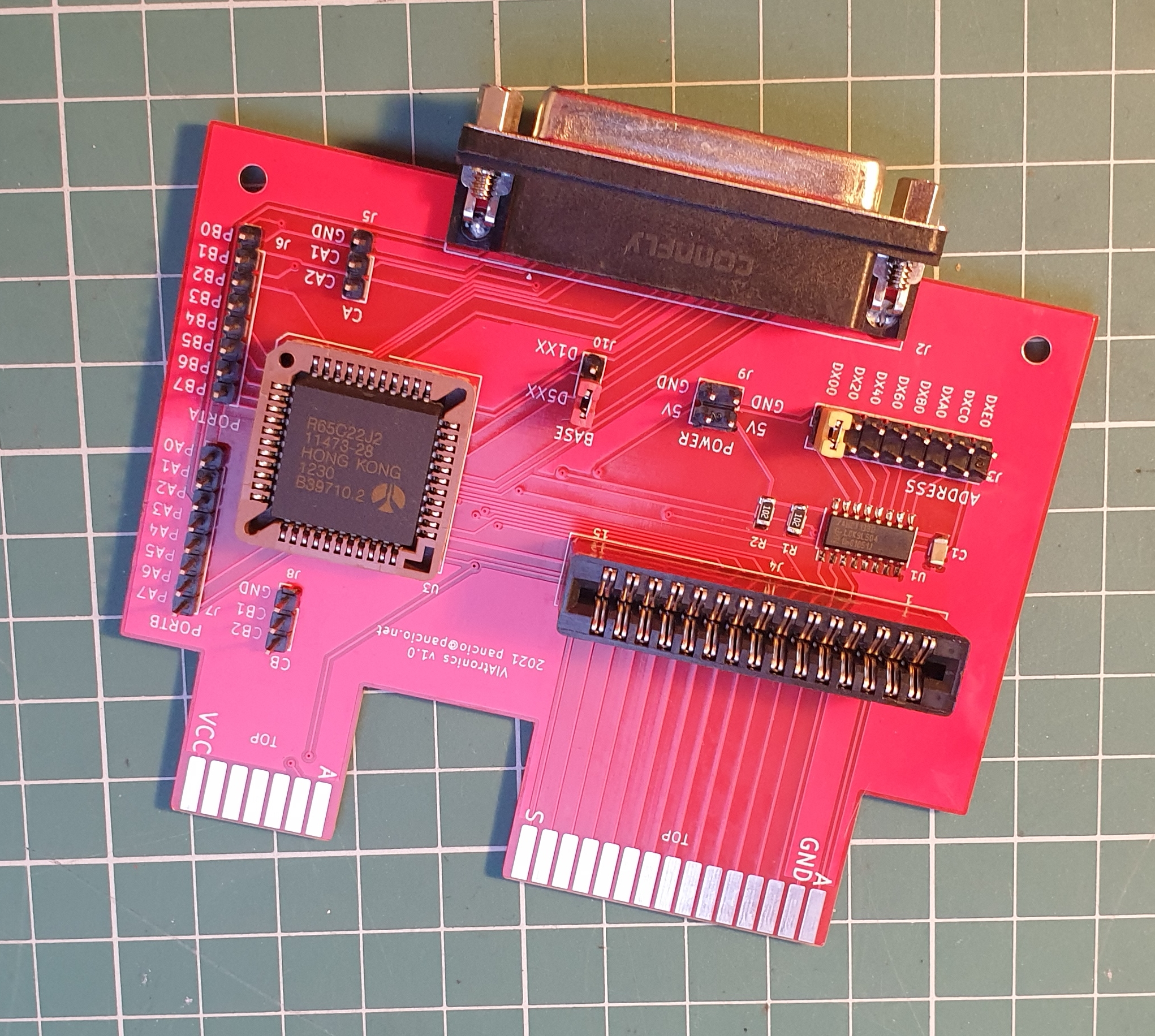

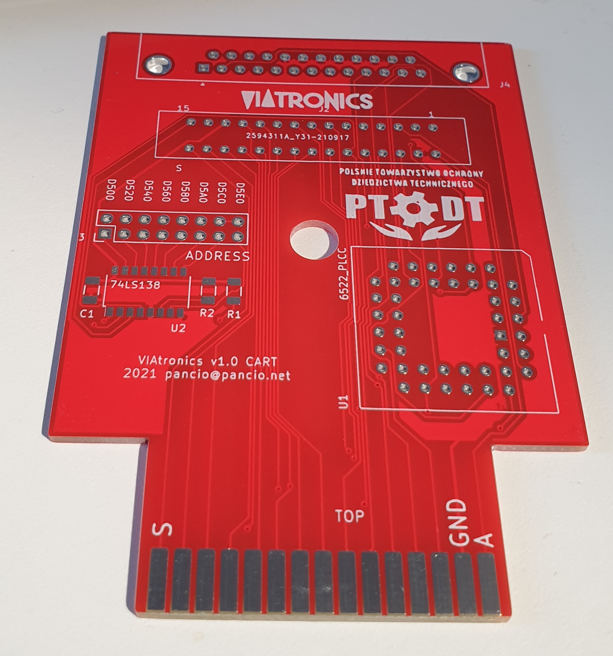

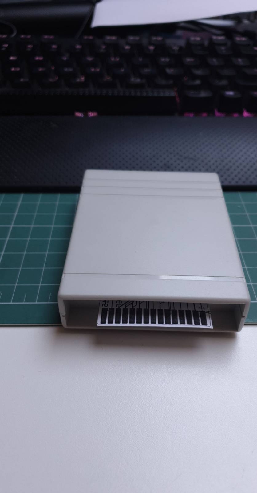

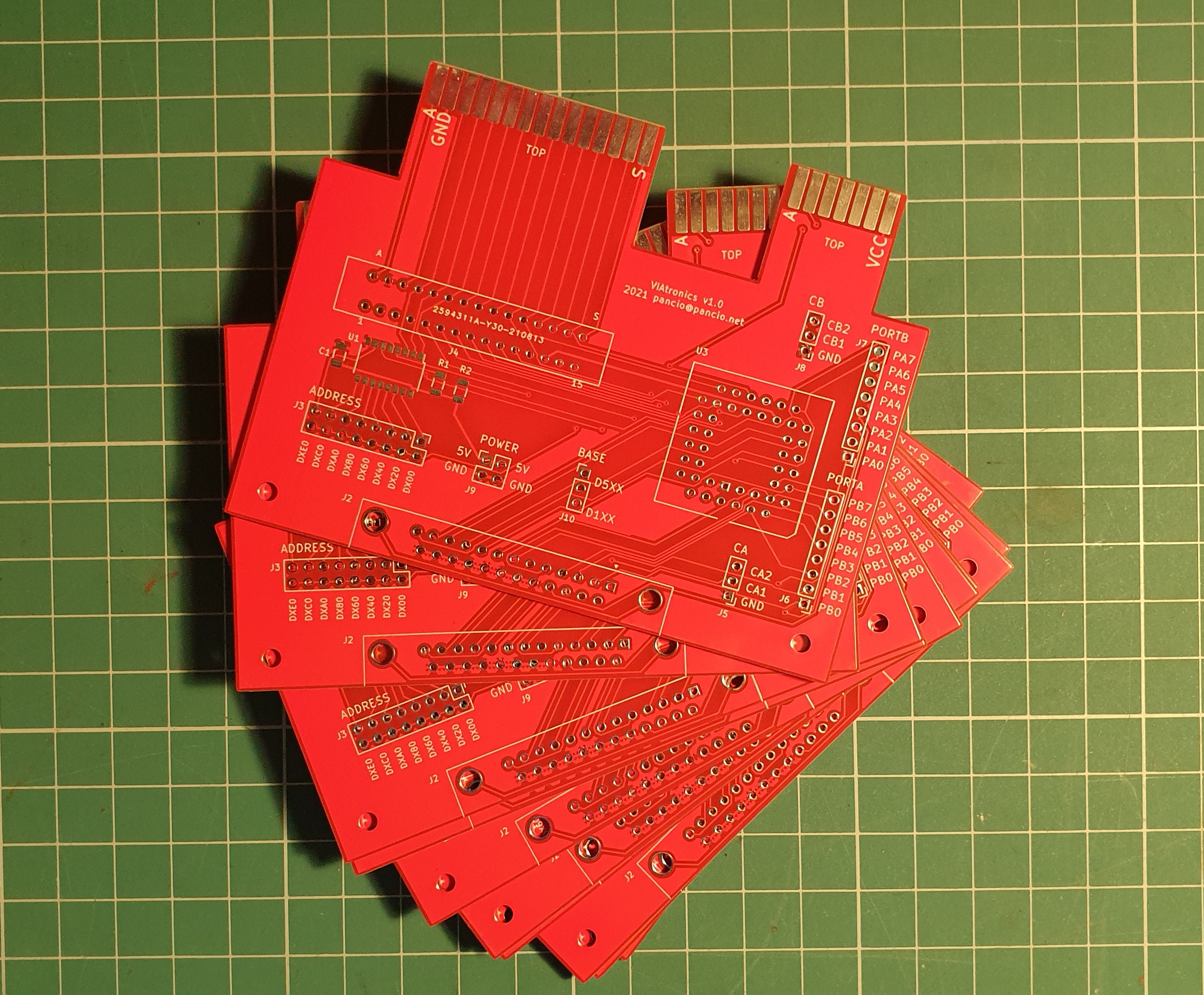

Today I received PCBs... I will assembly first piece today or tomorrow. I hope no issue on that!
Newest version of User Manual:
- pancio
- Beiträge: 321
- Registriert: 31.08.2021 07:31
- Has thanked: 312 times
- Been thanked: 318 times

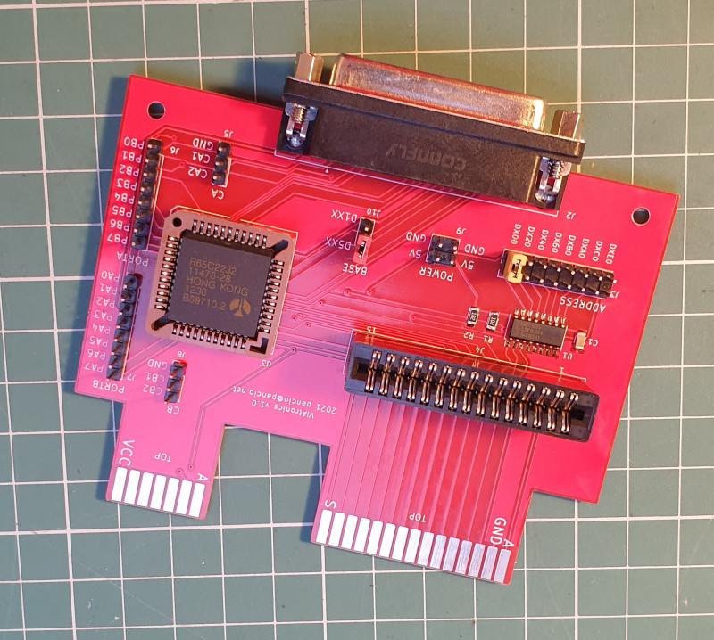

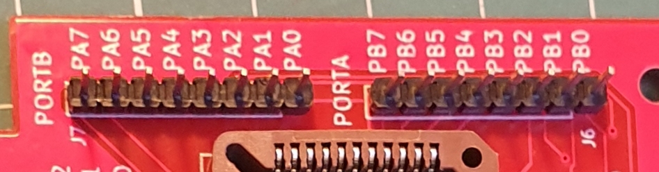

Good Evening,
I did it. First PCB was assembled...

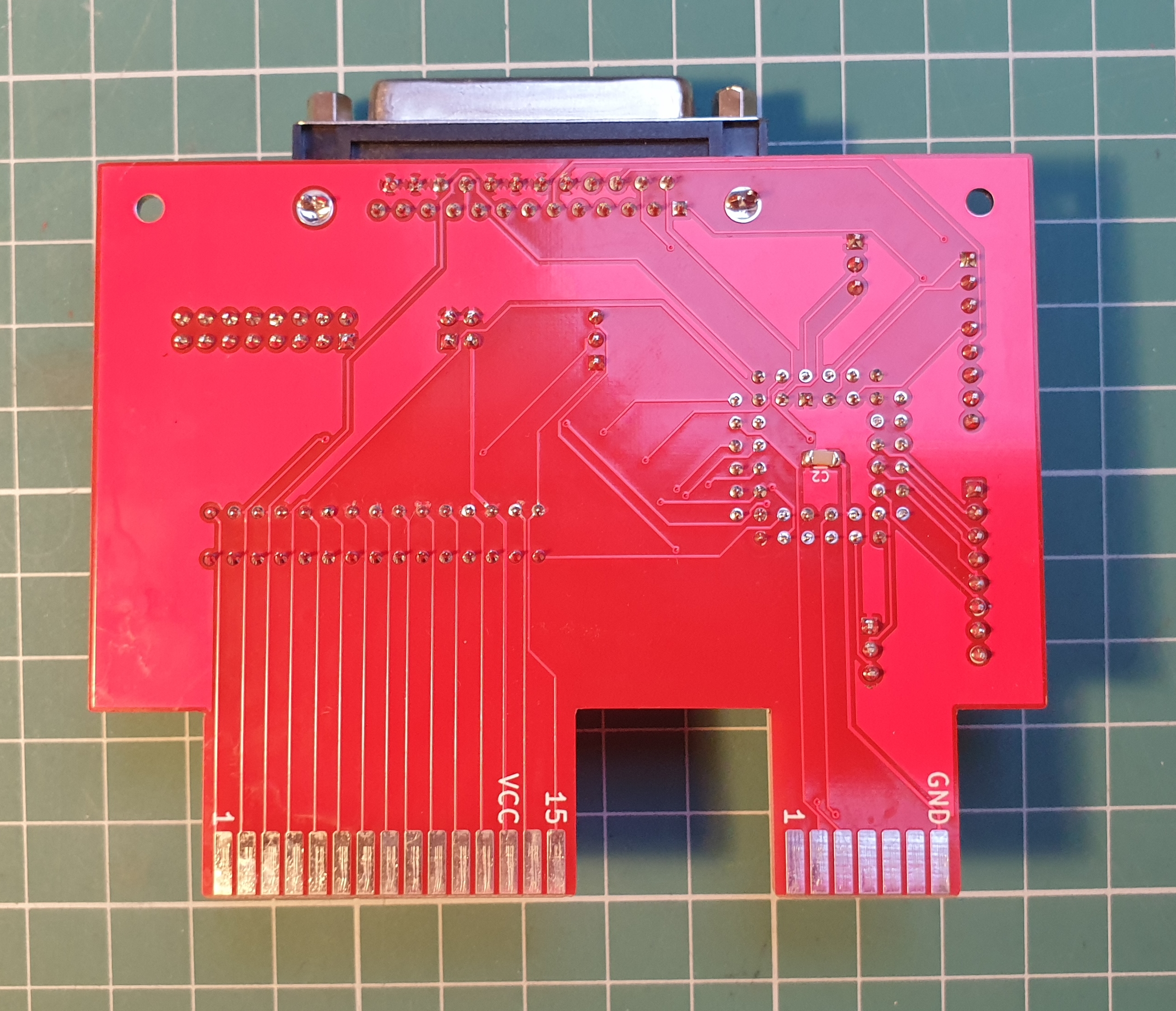

...and I found one issue with ports description:
it hasn't influence on parallel port and will be corrected with new PCBs order.
Well, time to print.... (t.b.c.)

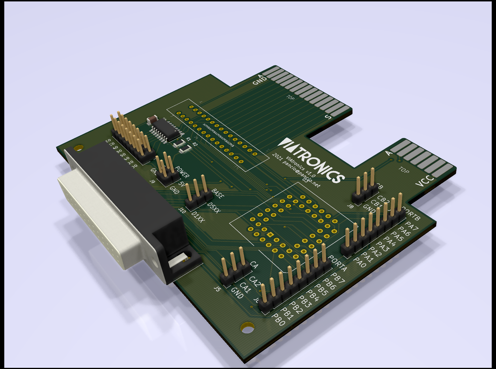

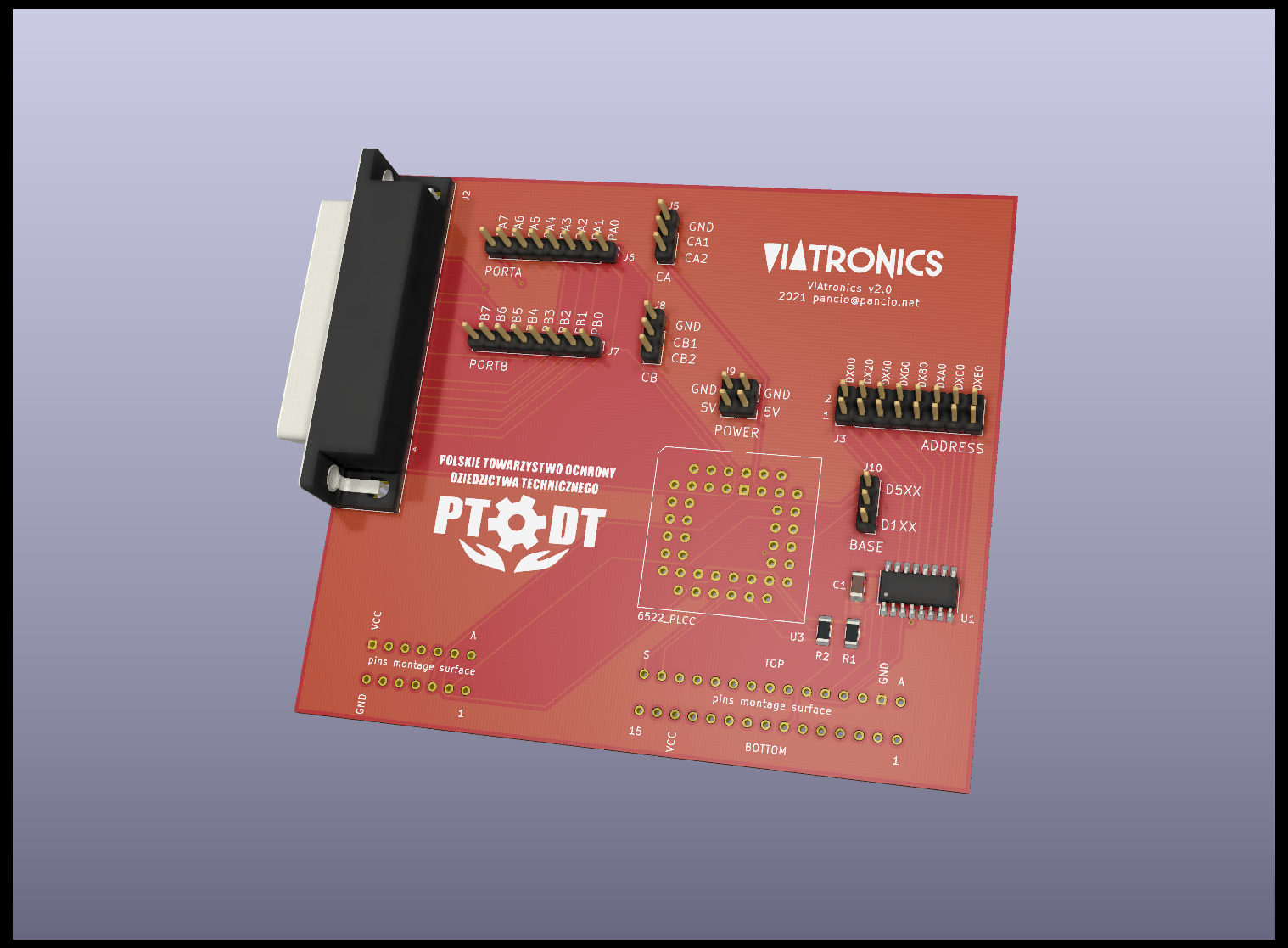

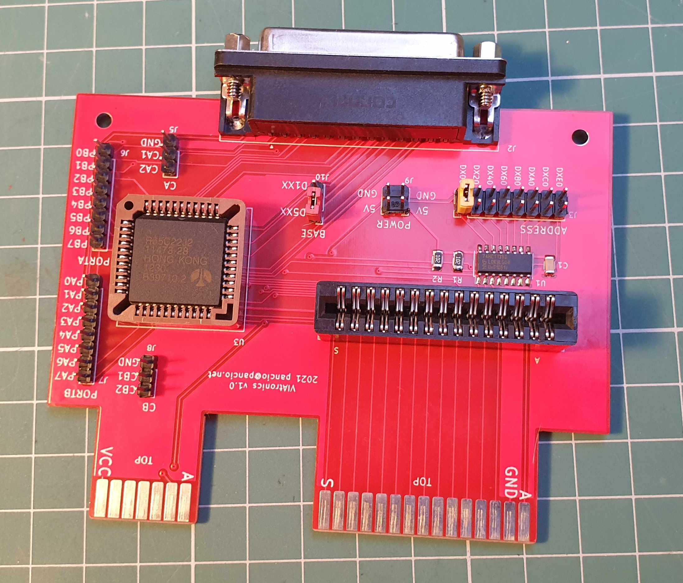

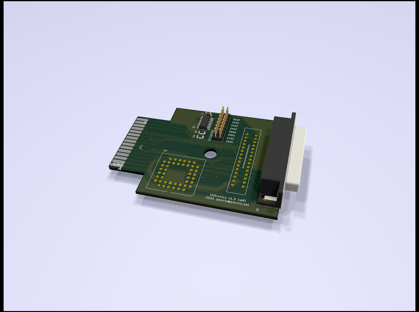

Hello, today I almost finished CART version for XE without ECI and for XL. Differences between CART/ECI version:
- lack of signals /IRQ and /RESET
- only D5XX addresses might be use.
I decided to leave CART slot but probably for XL models it will be little difficult to use it
If any doubts or advices, please let me know
I think a regular PBI version would be the best fit for the XL. No limitations and right position. For the TurboFreezer, we had created a "gender changer" so, the actual PBI board was the same.
- pancio
- Beiträge: 321
Hi JAC!
You have totally right but... CART version is cheapest, ready to use with all Atari 8 computers and is designed rather for print only (of course is possible to use signals thru DB25 with other stuff than printer).
PBI version (with gender charger) will be probably the best option and I planned to do it soon. Could you please advise me where I may find correct gender charger? It will speed up working on PBI version...

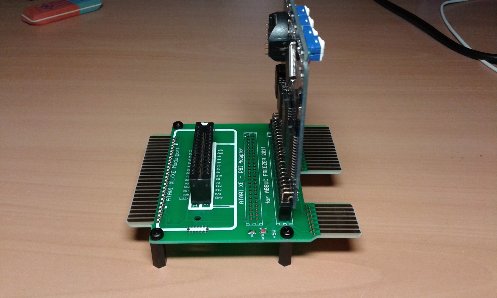

- JAC!
- Beiträge: 202
- Registriert: 18.06.2021 23:13
- Has thanked: 175 times
- Been thanked: 201 times

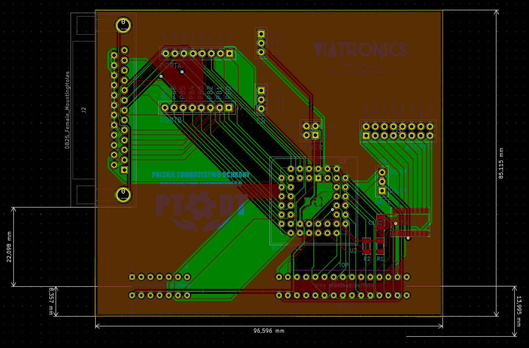

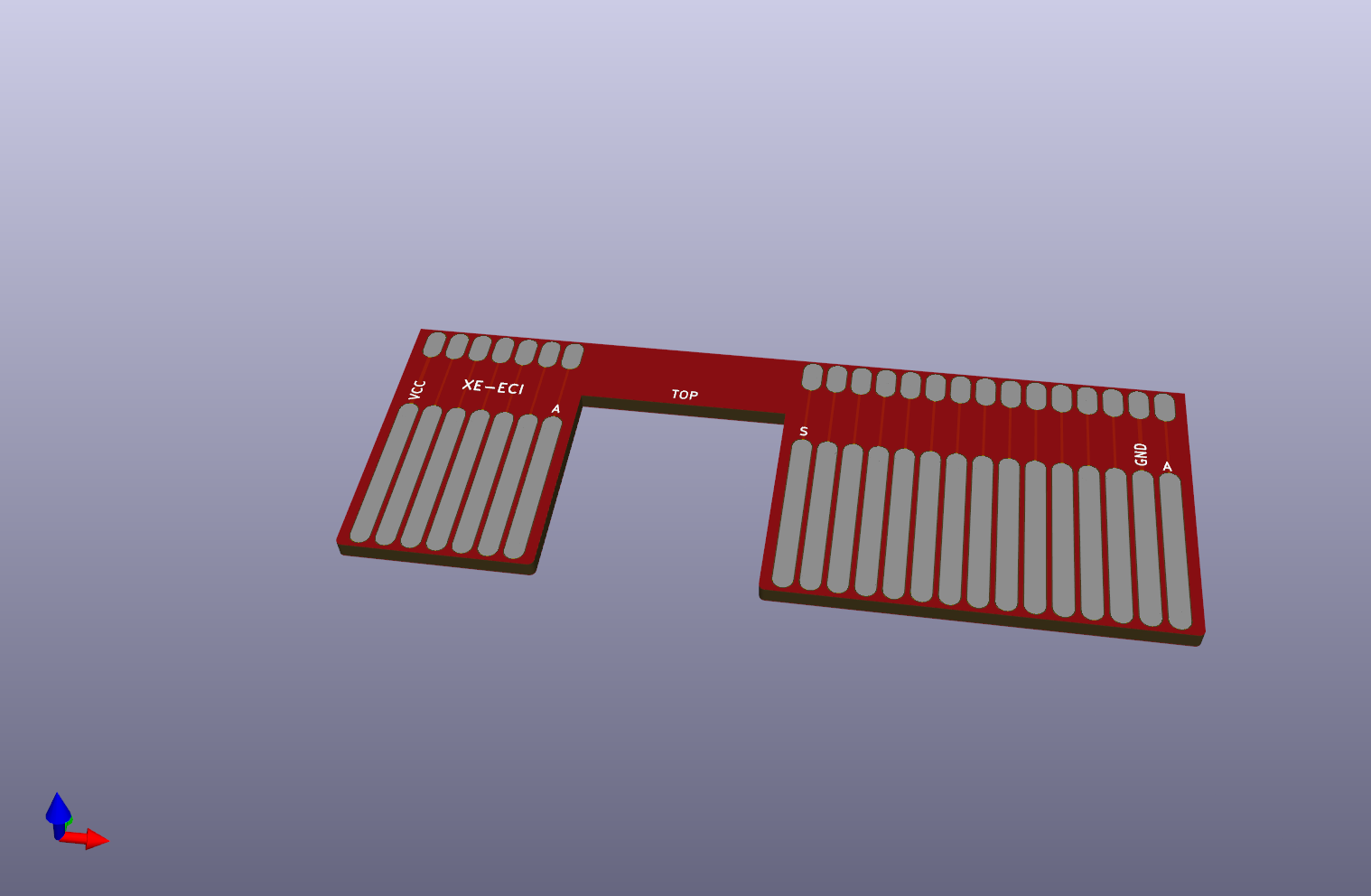

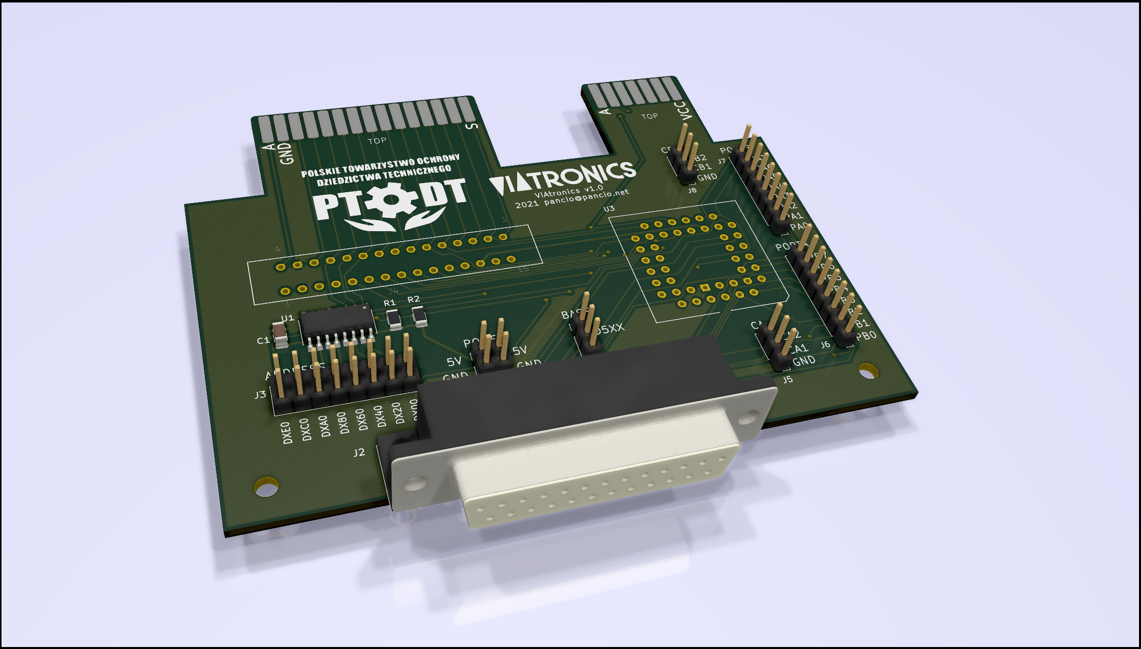

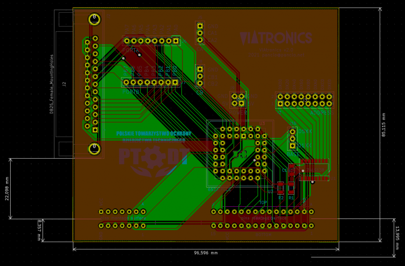

This is how it looks. A board with XE on one and XL on the other side. The actual board is plugged in there with a standard connector.
- pancio
- Beiträge: 321
Very practical and good design for both kind of edges... As I understand, we need female - female slot in order to connect it to A800XL? Is this PCB available to buy or gerbers to make it own hands?

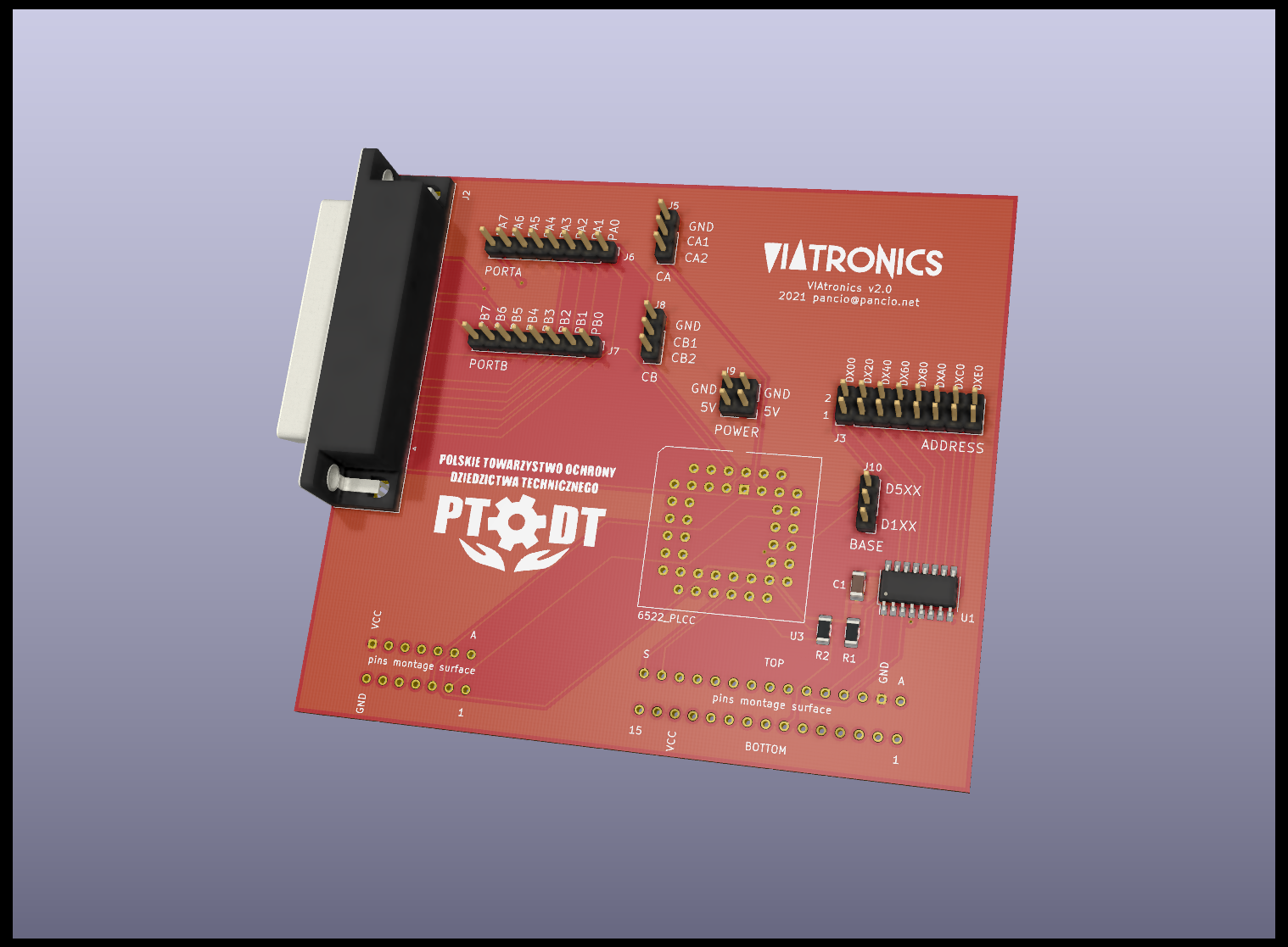

Has anyone footprint (module) for ECI (or CART/ECI) slot for KiCAD? I need it for newest VIAtrocics version with CART/ECI passtrue.

Hi Guys,
Today I received PCBs for CART version of VIAtronics:
I'll try to assembly it immediately and confirm work as ECI version soon
(I hope).

Hi Guys,
A few days ago I prepared little bit another version of Centronics for Atari. It's based on most popular, still available peripheral IC: 8255. It's more cheaper than VIA and very similar, so I propose to use it as alternative. Now I'm during tests. Software depends a few cosmetic changes, like set registers only. Rest procedures for printing will be the same...
Major differences in comparison with VIAtronics:
- 3 eight bit Input/Output ports,
- full CART/ECI pastrue
- configurable Centronics pins
I'll add full documentation to my page soon.
Have FUN!

According to someone needs, full pass thru version VIAtronics with vertical PCB was designed. I'm waiting for prototype to confirm it's working too as whole family.
It should be ready to test at the end of November.

- pancio
- Beiträge: 321
Hello,
Today I made some test with FT245 connected between Atari and PC on CART/ECI. I wrote simple terminal app (just for tests) and check transfers.. You may see result in short attached movies.
Regards,
pancio
Regards,
pancio
- Dateianhänge
simplescreenrecorder-2022-03-12_11.15.17.mp4- Transfer from Atari2PC whole memory
- (3.13 MiB) 544-mal heruntergeladen
simplescreenrecorder-2022-03-13_21.31.03.mp4- Terminal
- (9.92 MiB) 569-mal heruntergeladen
